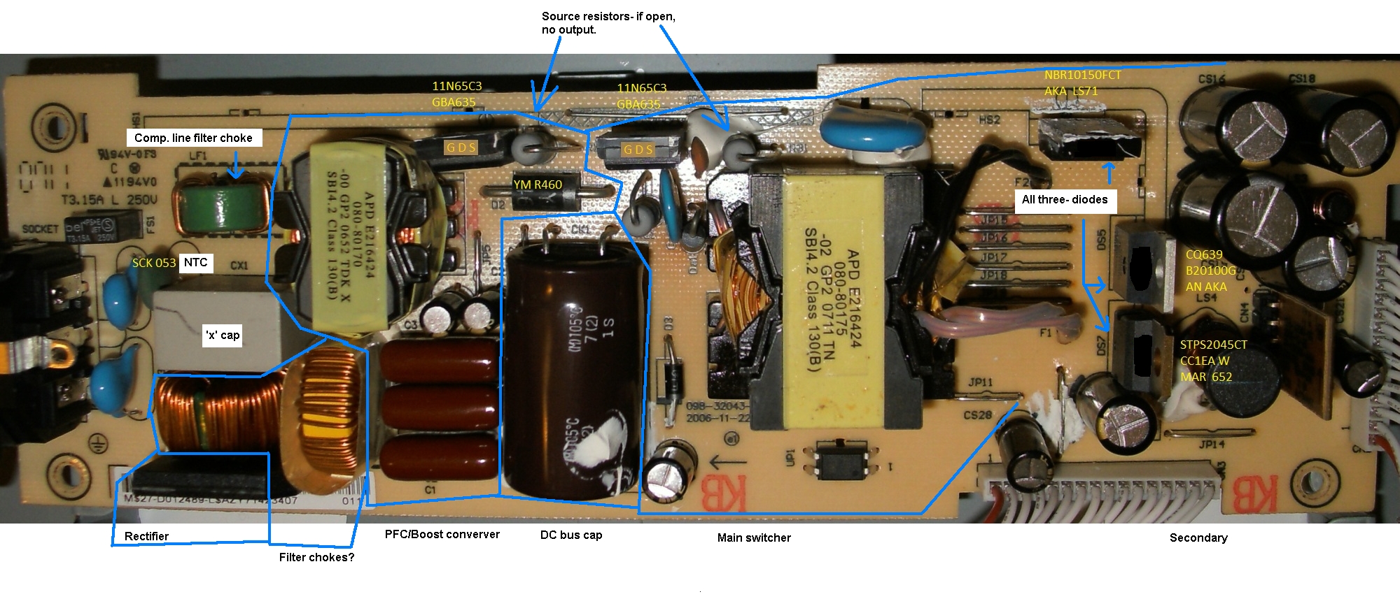

            I've been away on businees for a bit, but have picked up this project again. In the mean time, I ordered new caps, as well as some spare fuses from DigiKey for this monitor, as well as some others I'm working on. This weekend I installed a known good power supply in this non-working monitor from one of my other working L2410NM panels and it powered on and displayed video fine, so I've now confirmed that there are no problems with the inverter or video board. I also suspected that I may have accidently blown the first 3.15 amp, 250V fuse on this power supply when testing, so I soldered in a new one.
            • With the PS plugged in, I now show mains voltage of 169Vdc at the main filter capacitor with my meter set to 600Vdc.
            • I still do not have any significant voltage at the logic or interter card pins.
            Should I continue testing as kaboom mentioned, and test (or just replace) the diodes and FETs? Thanks.

              I'd check for a shorted output diode. If they check out good, replace the small electrolytic caps near the SMPS controller chip (I believe you identified one of them as 100uF, 50V) and see if it works. If it now works, replace the rest of the electrolytic caps.

                  It's more likely to be C23, 100uF, 25V. If you've already replaced it, it isn't necessary to replace it again unless you have a solid reason to suspect the replacement is defective.
                  A quick background on what happens at startup on these supplies. AC power is applied, the mains filter cap charges to full voltage (1.4 x line voltage). A low current path (bleeder resistor or constant current source in the SMPS controller) charges the Vcc filter cap to (usually) about 16V. At that point the SMPS controller starts.
                  The SMPS controller turns on the main power FET briefly, sending a surge of current through the primary if the transformer, causing pulses of current through the secondaries and a tertiary winding which provides Vcc for the SMPS controller. This is followed by additional pulses until the secondary voltage reaches the design value - usually 5 volts.
                  There are a few things that can stop this start-up cycle. If the Vcc filter cap is open, Vcc decays to below 10 volts and the process stops before the tertiary winding can provide enough voltage. An excessive load on the secondary will have the same effect. That can be a reversed cap, bad diodes, short on one of the loads, etc.
                  I'd have to see the part numbers of U2 and U4, but it appears to me that U4 is most likely the SMPS controller, mainly because of it's proximity to the opto-isolator.

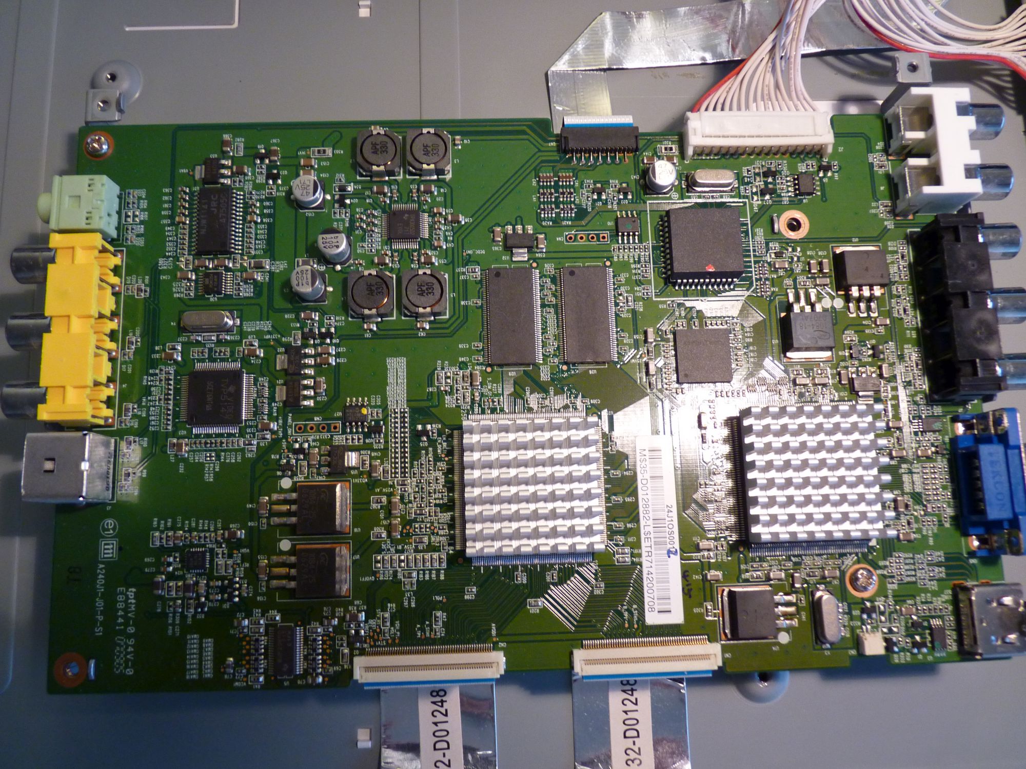

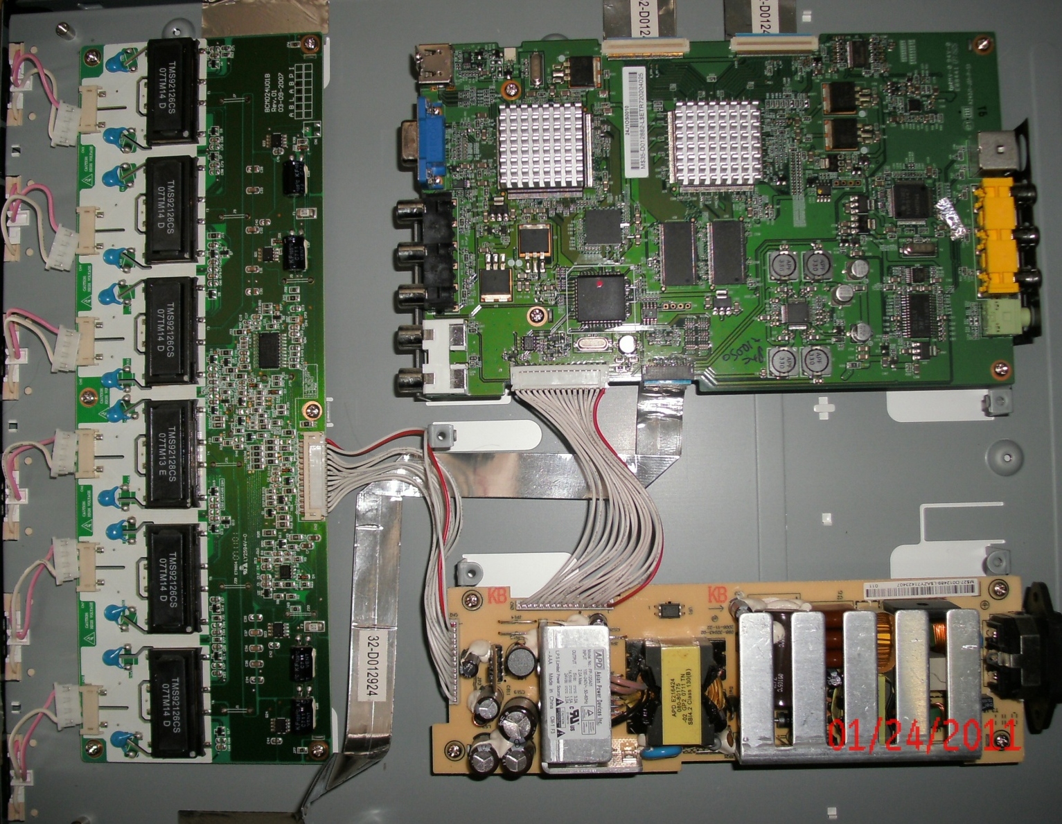

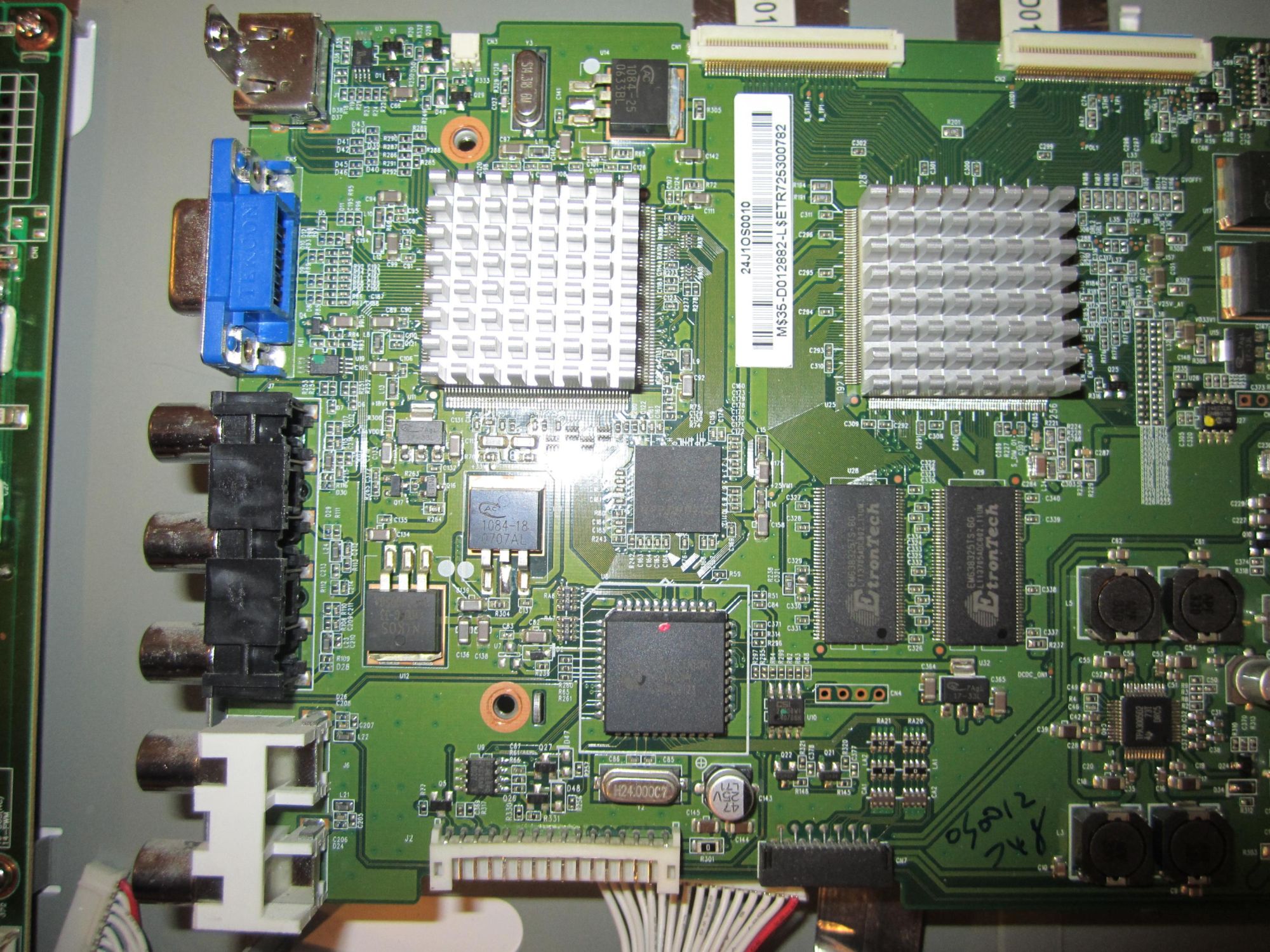

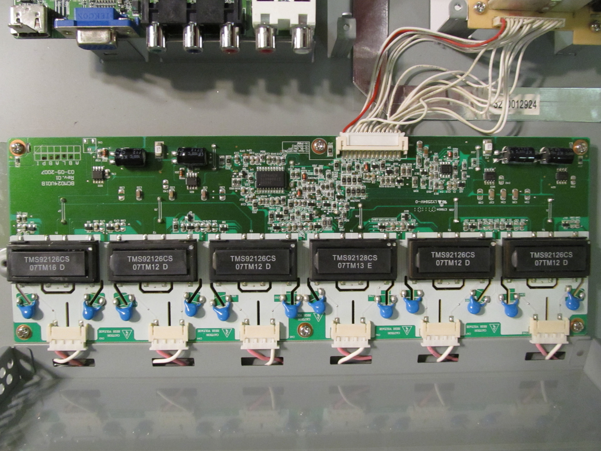

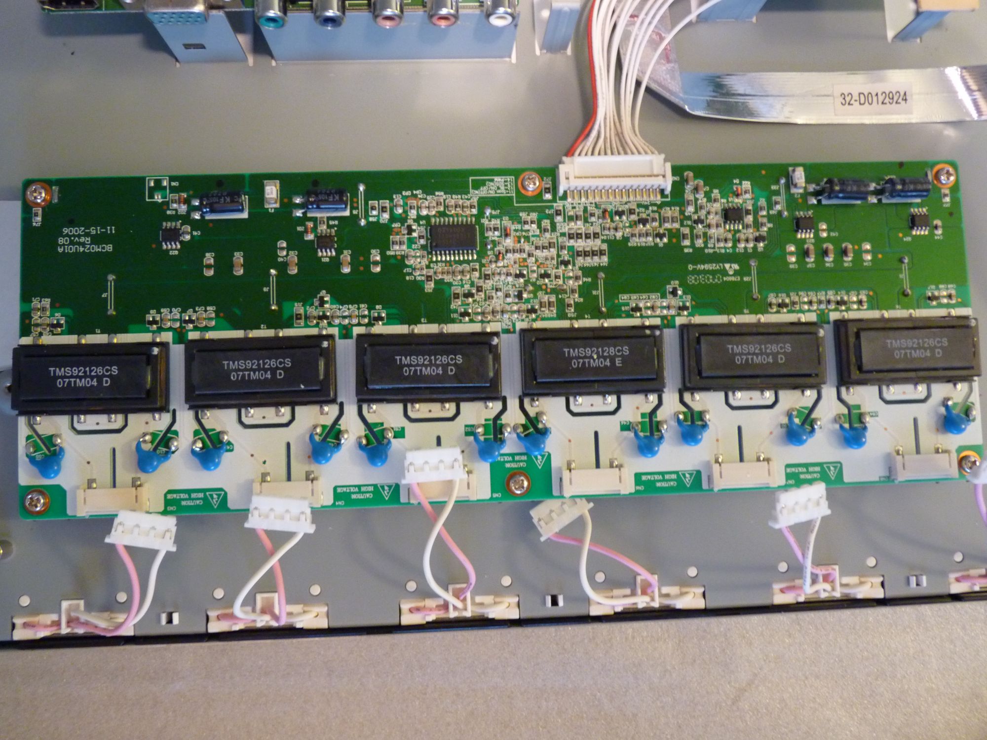

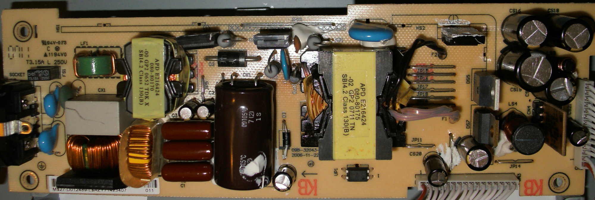

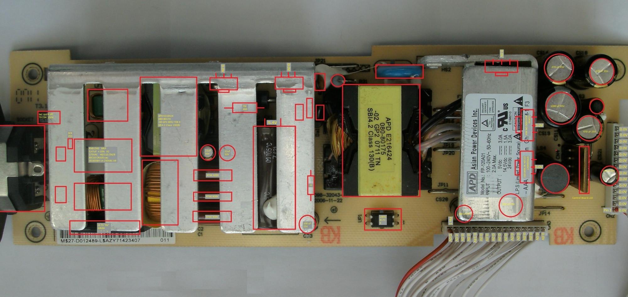

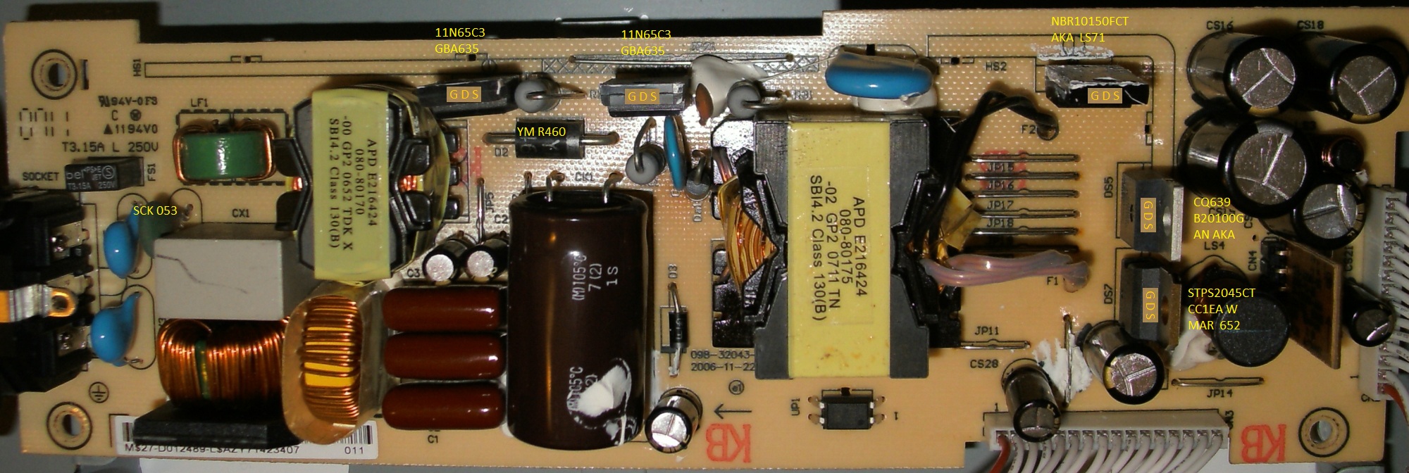

                                Below are more images of the monitor L2410NM boards, some were collected from earlier posts in this thread. I also noticed, my LCD flickering depends on the mains voltage variations.
                                Its strange though, why front led could be affected by wires running from PS to the Inverter board? The Main board sends signals to Inverter board via Power Supply board, but they are only related to display dimming and switching to power saving mode, in which cases front led still stays lit. This LCD can't be switched off by PC or its Main board when not in use for awhile - its design limitation, so front led is always lit, until Turn Off button is pressed on LCD.

                                  Well I dont think there is time now for you to edit your post but by including pictures that are not YOUR boards you have made it very difficult to comment

                                    Sorry, I have to use the same monitor for posting on this forum that I'm trying to repair. In post #34 all pictures were taken by me. In post # 35 I posted the same boards already marked by others with appropriate part numbers and heatsinks removed, which I can't do due to using this monitor. But I can take any measurements. All earlier posted boards have the same part numbers as mine and visually look the same, the Inverter and Main boards seems to be in good shape, they are given mostly for reference here. Since I suspect Power Supply, I posted my pics for it. But if you feel, the culprit may be on another board, I can desolder all heatsinks and take other pics.
                                    My logic is that Main board doesn't control flickering (display turns completely black for a few secs), and Inverter board doesn't control small speakers mounted inside this LCD's plastic case. Because flickering is supplemented by lost audio, it seems to be power supply problem. More, I can still type on the keyboard when display turns black, and when its lit again, I can see what was just typed in this post while it was black.

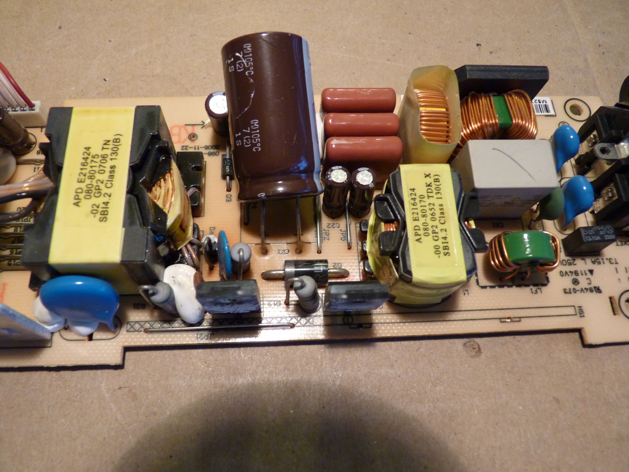

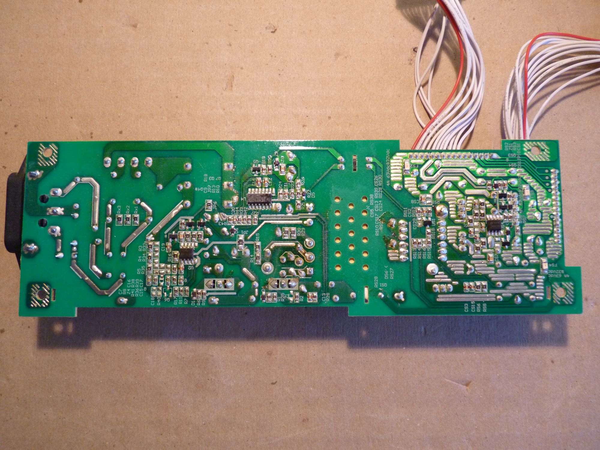

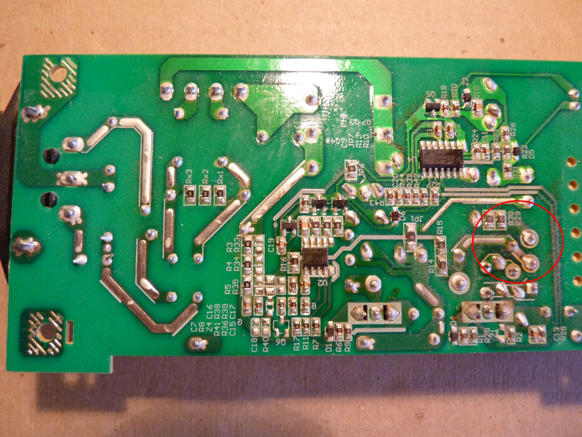

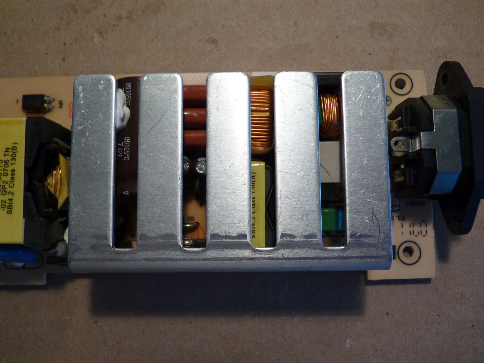

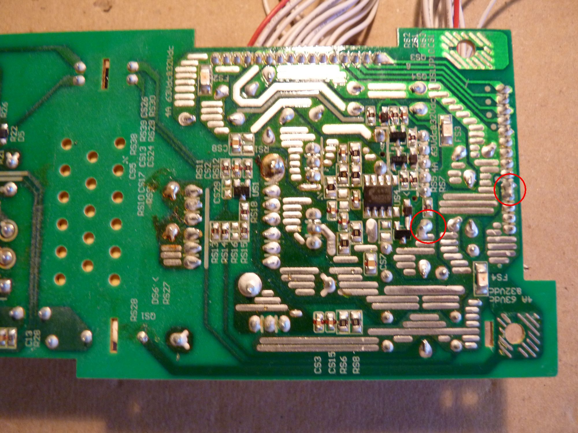

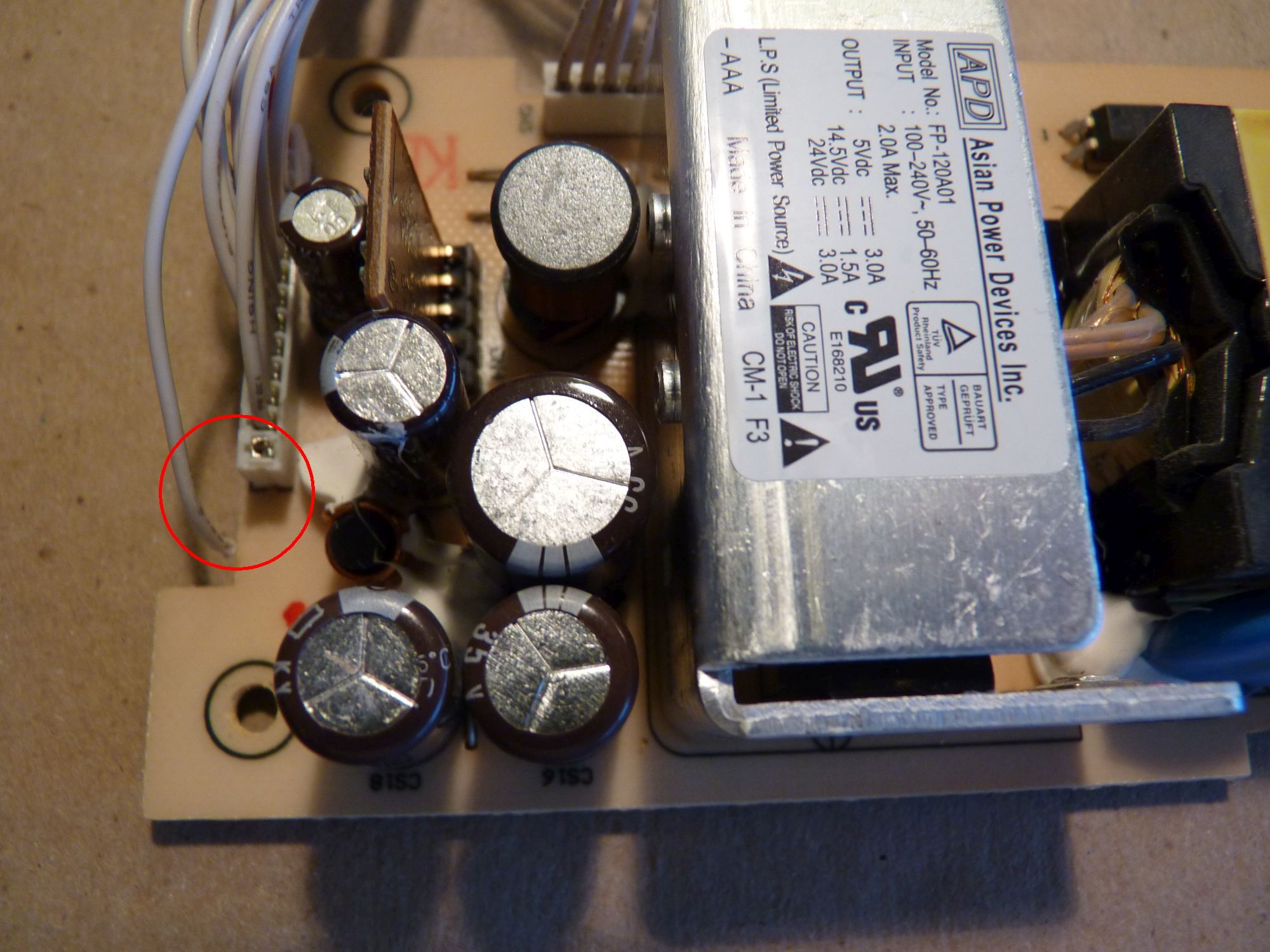

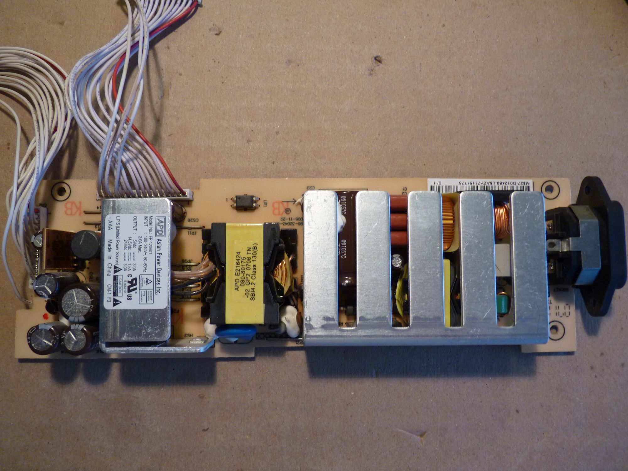

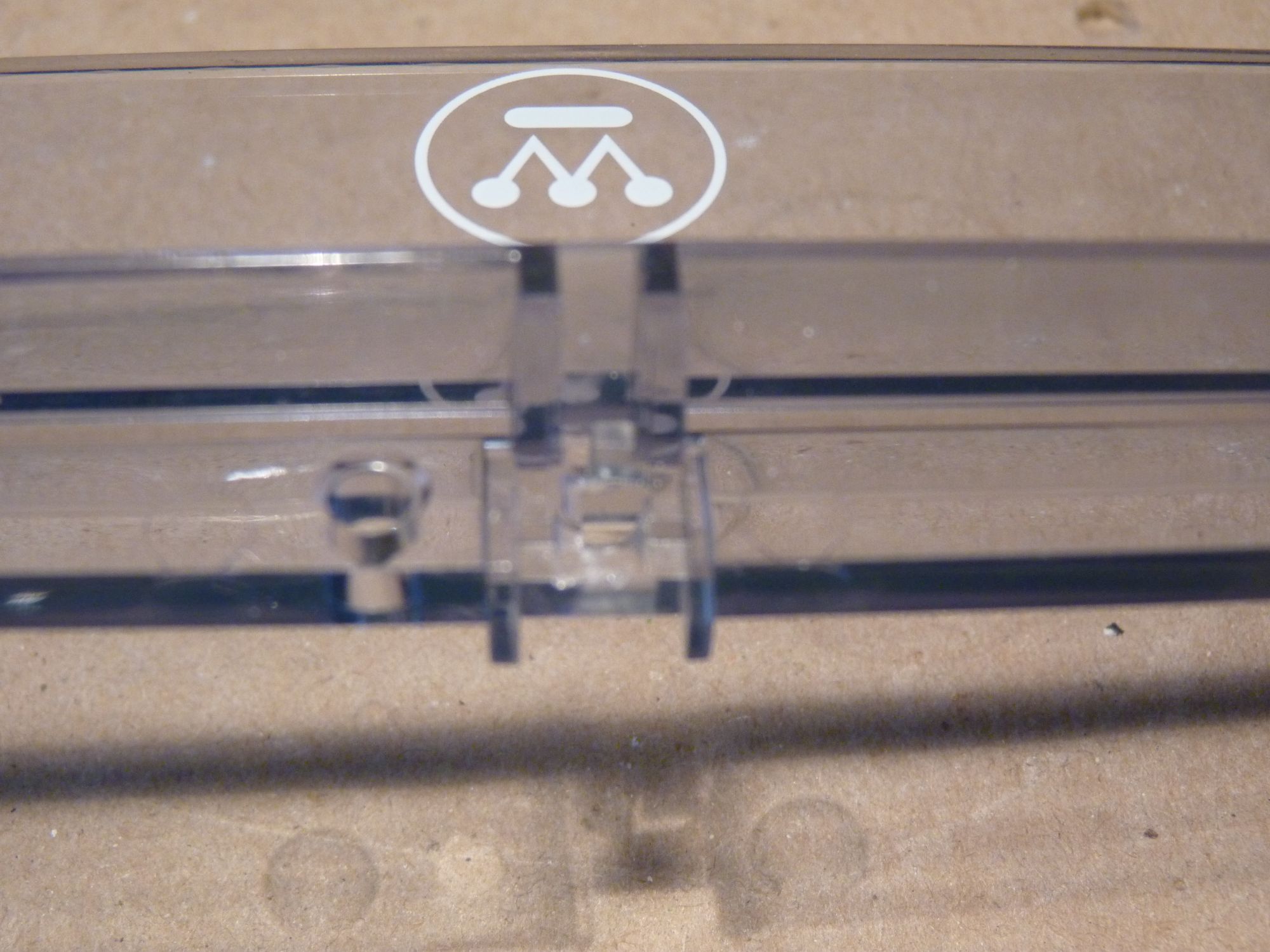

                                      I took the monitor apart again for some more "genuine" pics. Found that front led wire was accidentally cut too close to the led, so had to broke and remove the led from its sit. Can you guys suggest what led part number should I order now?
                                      Removed the heatsink from Power Supply board. The main cap KMG 120uF 420V measured 180V stable at idle, with resistance 200kOhm growing slowly towards 1+ mOhm when removed, and capacitance 135uF firm. I put it back for now. What else would you suggest to check to ID flickering cause?
                                      Is there a standard way to remove this white and yellow filler btw components? Why some of it white, and some yellow - due to different Temp rating? What I can replace it with to hold parts as it did?

                                          The symptoms are a bit different - no power versus flickering power, but everything else including diagnostics seems to be the same, as flickering is also due to intermittent power loss. Audio is lost too when LCD is flickering (getting dark), that's why I think of power supply problem.
                                          Front led - 3.73V white light, sit size 4x4x4mm, was mounted in a way impossible to remove. Monitor works OK with or without it. Can someone suggest a suitable led model?
                                          Voltages on all caps at idle:
                                          C21 - 0.4V, C22 - 19.3V, C23 - 20.3V, CK1 - 180.3V (under left heatsink)
                                          CS27 - 0V, CS28 - 0V (under right heatsink with Model Label)
                                          CS21 - 16.7V, CS16 - 28.3V, CS18 - 28.3v, CS19 - 16.7V, CS11 - 16.7V
                                          At idle only wires 5 and 6 on Main Board connector have voltage 16.6V , all other wires on main board and inverter board connectors are 0V. In post 7 above it was said: "From the label on the main power supply, it looks like this supply puts out 5V, 14.5V and 24V" under load. Than why so many wires are coming to inverter and main board connectors from power supply?
                                          Resistance measured on board with power off:
                                          C21,22,23 - OL
                                          All other caps - varies around 50 - 200kHms
                                          rectifiers (under left heatsink) - normal values as posted earlier in the thread
                                          rectifiers (under right heatsink with Model Label) - 0 btw G and S on all 3, other values are similar to posted earlier in the thread. But they seems to work OK for hours under load until flickering starts a few times.
                                          It was said in post 16 above:
                                          "Resistance across S and G looks like it's almost shorted. You may need to do two things:
                                          1) you will to need reverse your meter probes and re-measure the resistance across S and G for Q1 and Q2. If you get the same results, I would suspect a possible short. Step 2 below will verify it.
                                          2) since Q1 and Q2 are "in circuit", other components could be affecting your readings. If so, it may require that you remove the mosfets from the board to get more accurate readings."
                                          My question now is, how function of components set under left heatsink differs from the set under right heatsink? Does 1st set convert AC to DC, and the 2nd set drops source DC to 3 output voltage levels? The board seems to be divided on several sections, and other Power Supply boards are somewhat similar in design despite have different size. What's the main functionality of a PS board major sections - how this thing works?
