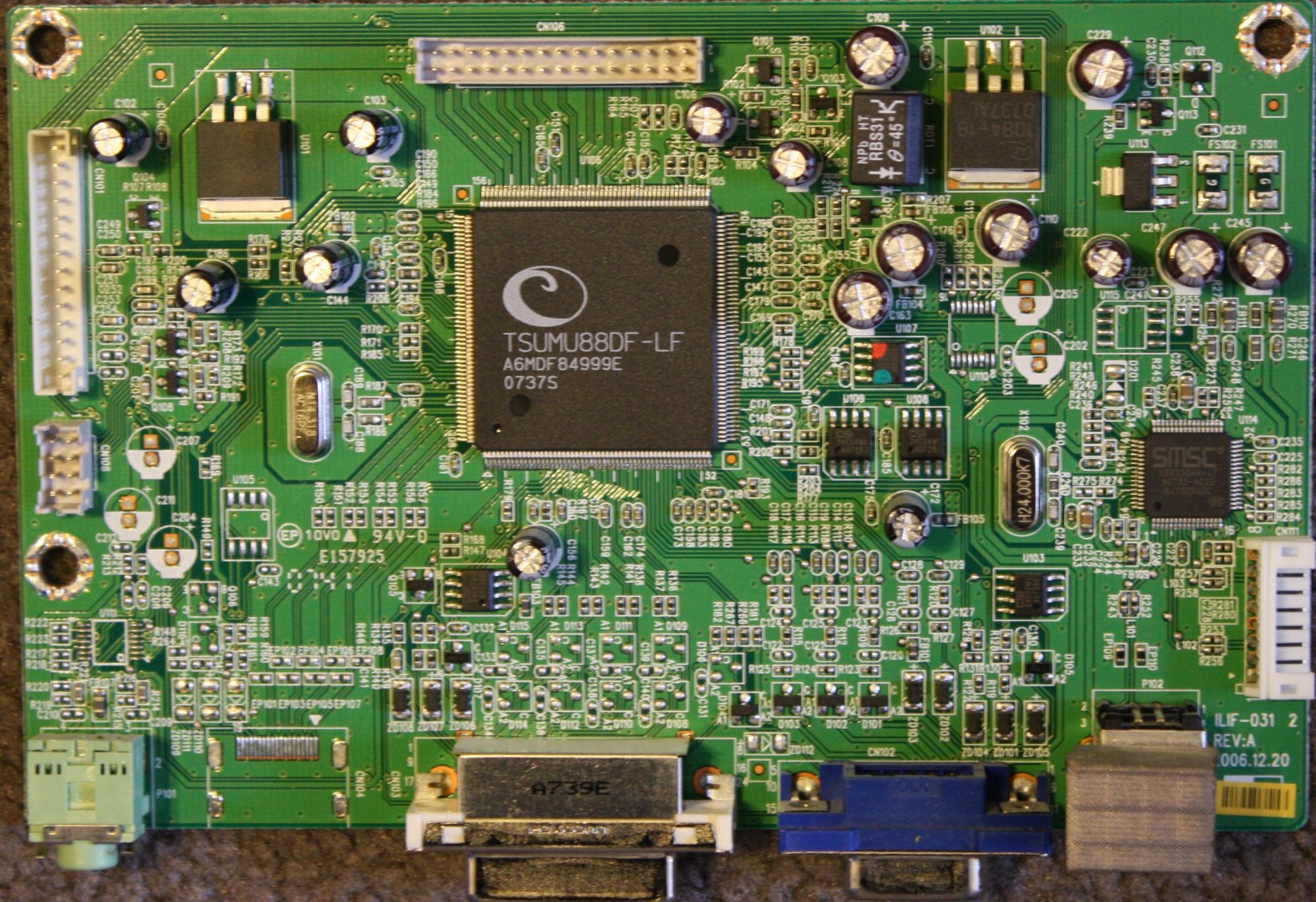

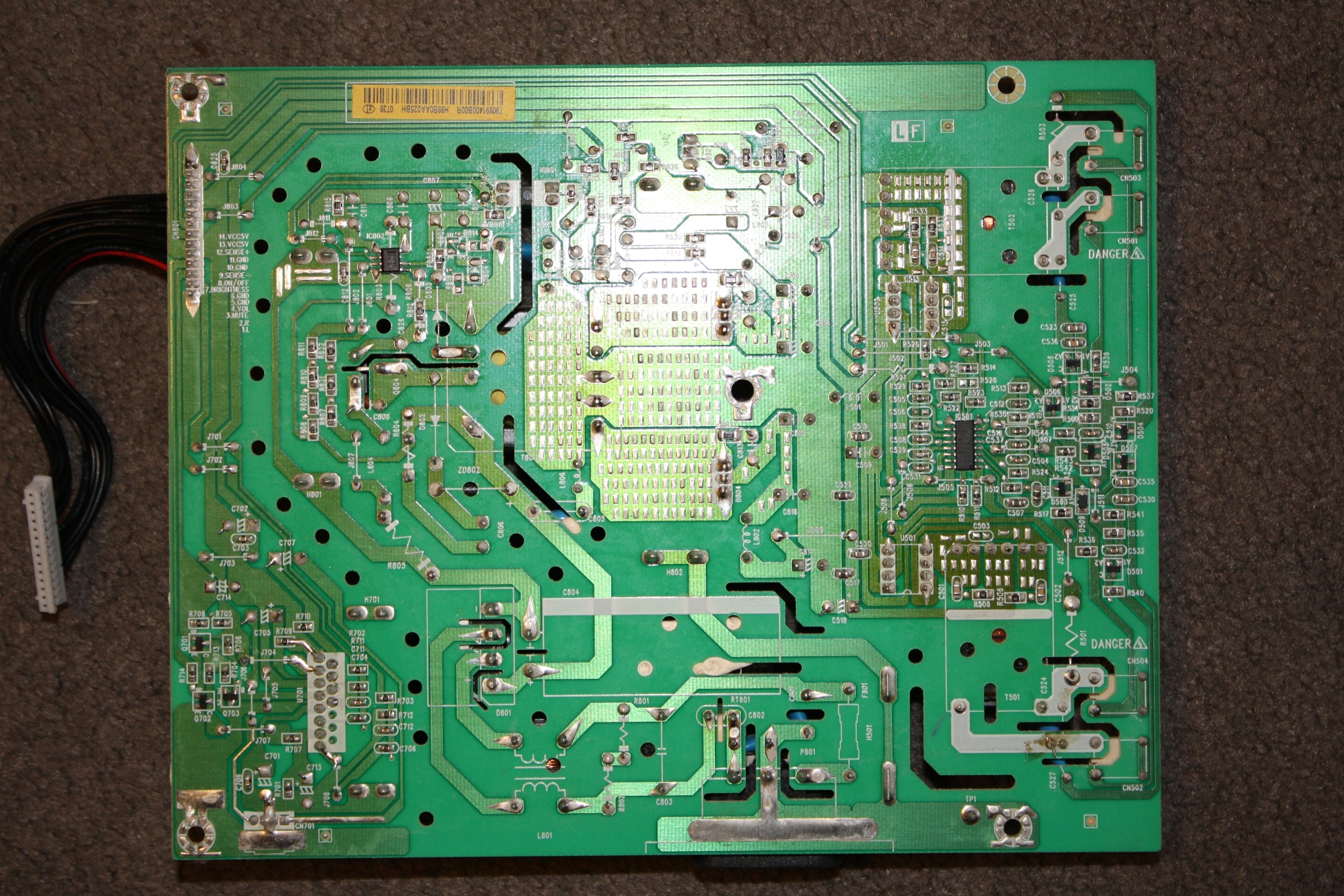

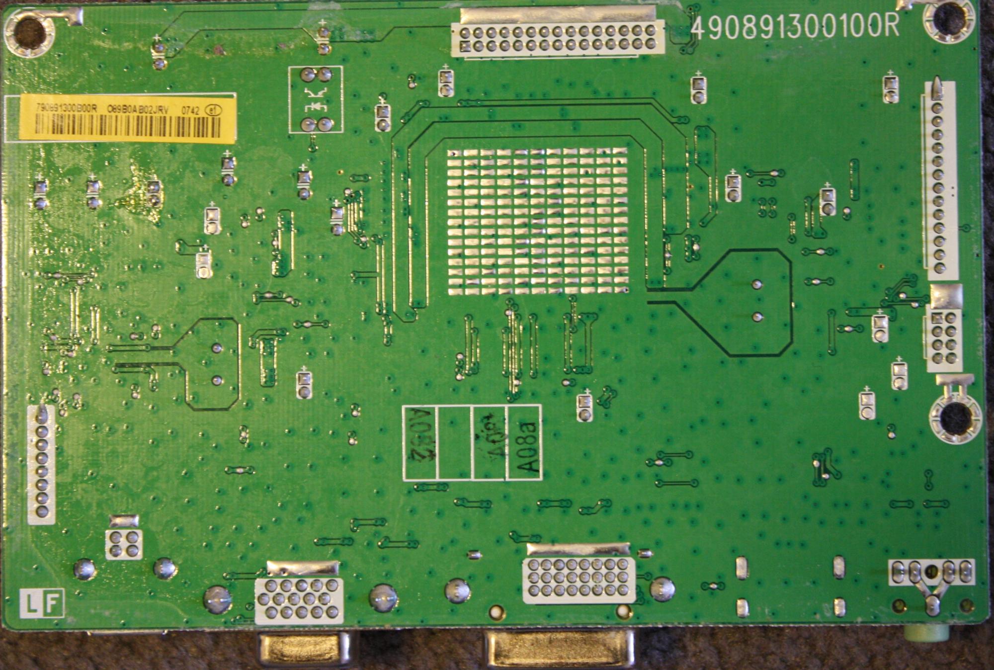

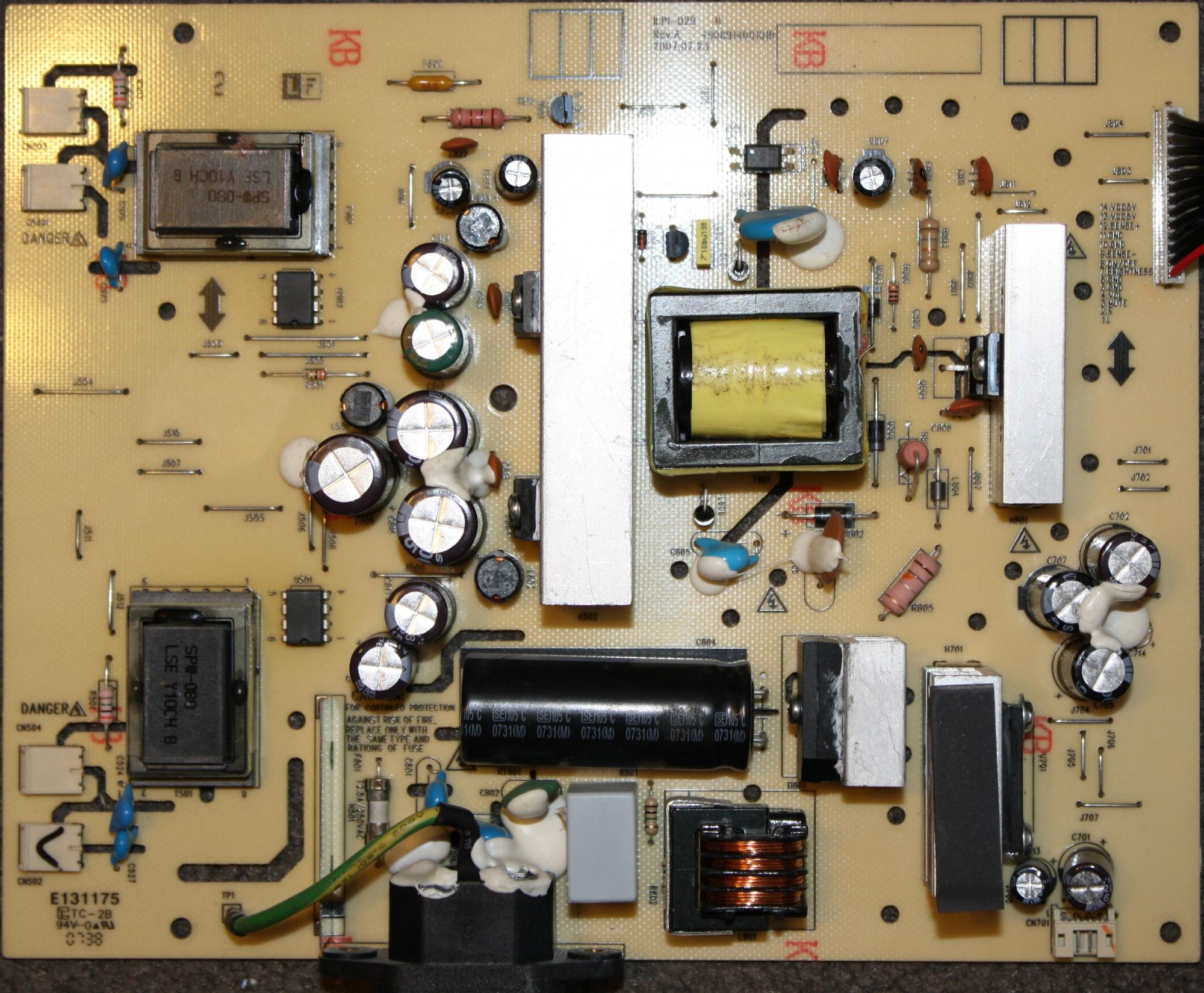

    Hello!
    I have a W2207 that turns on for a bout 2 seconds then the backlight goes blank. I can still see the picture on the display, but it's without any light behind it.
    I have taken the board apart and have attached pictures. It doesn't look like any caps are bad, but I could be wrong. I have a feeling that it's the inverter, but I don't know how to pinpoint this.
    Disclaimer: I'm a bit of a noob when it comes to this type of repair, but I would really like to learn how. I may not know the proper vocabulary for a particular testing method, but I'm willing to do whatever I can to get this figured out. I have a lot of patience, so I hope I don't annoy anyone too much if I don't know what you're talking about if you tell me to try something.
    Without further ado, please feast your eyes upon my boards. Thanks in advance for any help!
    (The PowerBoard Back picture will not upload for some reason. I'll try a new picture later)

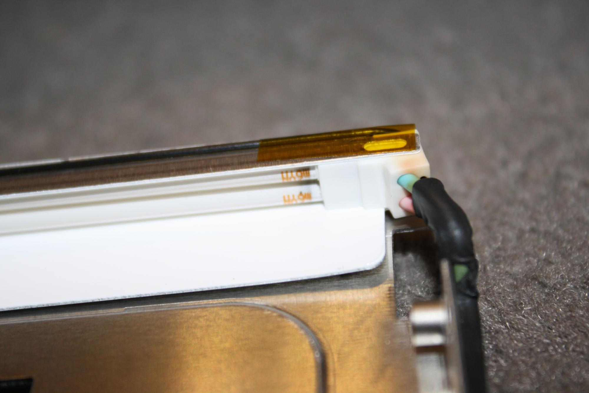

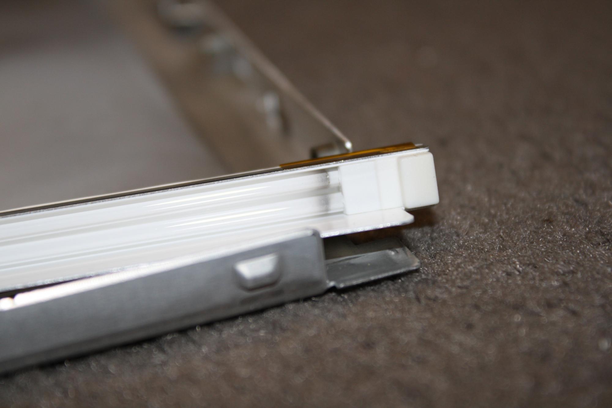

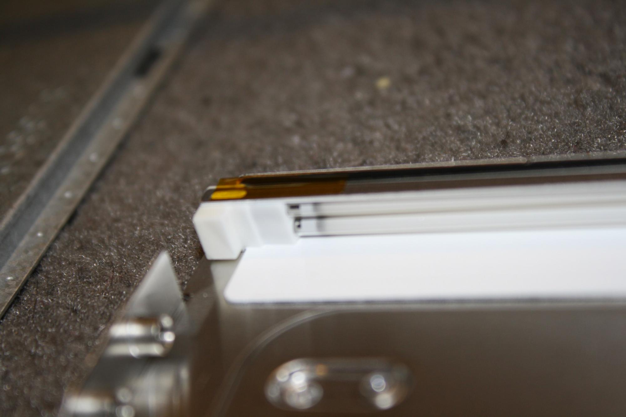

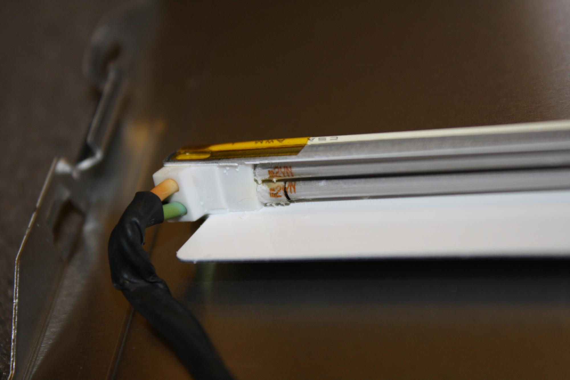

    Well, as I was getting pictures of the backlights in case they could be an issue, I found a broken CCFL! I don't know if it broke when I was removing it or if it was the cause the entire time, but I think that could be my issue!
    I have attached pictures of all the CCFL ends because there is a little bit of black on them. I have no idea if that means they are bad or if that's just how they are. I'll let you guys see it.
    Where is the best place to get replacement CCFLs for LCDs?
    Thanks!

      The very first thing I would suspect in this monitor,Would be a ccfl wiring issue.
      Do you have a known good ccfl you could substitute for testing?
      Al.

        If you look at my almost immediate update, you should see that there indeed was a bad CCFL! I am considering replacing all of them, as there is some black on the non-broken ones too.
        Where is the best place to get replacement CCFLs?

            2 seconds to black can be
            a) bad caps
            b) bad inverter transformer
            c) bad ccfls
            d) bad ccfl wiring
            All the above is explained in more detail starting with post #13 at
            https://www.badcaps.net/forum/showthread.php?t=10419
            Have a read through it and feel free to ask questions regarding the test procedures.
            edit: Darn, I type too slow. Good job in figuring out it was c).

                          Well, bad news.
                          After replacing the CCFLs, I still have the same 2 seconds to black problem. I would like to test the transformers, but I'm honestly not sure which parts are the transformers and which pins I need to test.

                            no help from me on the transformers, but the caps in the first few pics look like Su'scon.. replace on sight in my book..
                            • TVo
                              • Jan 2011
                              • 31
                              Re: HP W2207 Backlight Problem
                              They are Su'scon... Damn, I really wish I had an ESR meter. Can't justify it quite yet. I'll take that into consideration, after I've had a go at testing the transformer, just to check. What about that big fatty Cap? Are those readily available?

                                Looking at your photo, it looks like each inverter transformer has two pins (marked 7 and 8) on their secondaries, which feed a pair of ccfl's. Can't tell if there are more pins on the secondaries (which is why we usually ask for a photo of the bottom of the board). Assuming 2 pins and with power off and your meter set to resistance, measure across pins 7 and 8 of each inverter. If the difference is greater than 3%, then you may have a problem.

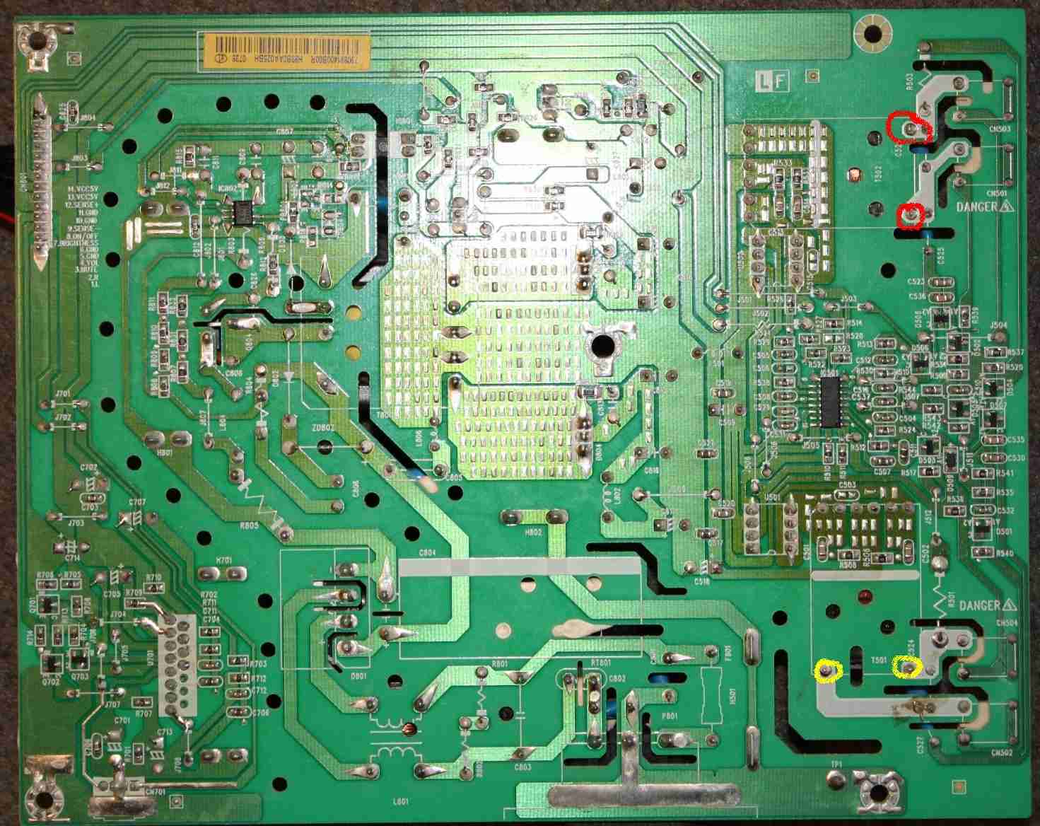

                                  Bah, I had meant to attach a photo of the back. I think it error'd out last time.
                                  Here's a back photo.
                                  • retiredcaps
                                    • Apr 2010
                                    • 9271
                                    1) Put your multimeter on 2000 ohms (if manual). Power off and unplug the lcd. Wait 2 minutes.
                                    2) Measure the 2 red dots. Report ohms.
                                    3) Do the same for yellow dots.

                                      Go ahead and measure across the 2 pins (7 and 8) of each inverter transformer and report your findings.

                                        You should check your work with a known good single ccfl and rule out a bad install/wiring. That is, unplug one ccfl at a time and substitute the good one (you don't have to disassemble anything, just stretch the cable to the good ccfl).
