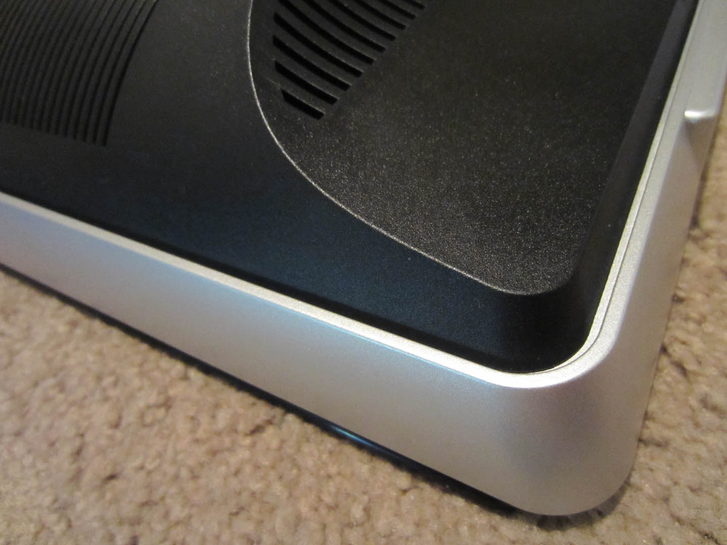

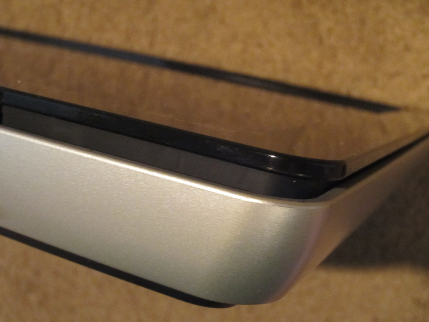

                                I know it's been a few years, but did you ever get around to making some pictures on opening up this pig?
                                I got the same model. Trying to fix it before I resort to eWaste. The power button slowly blinks when turned on, and you hear slight repetitive high pitch voltage noises from inside. The screen never gets a chance to power up, so it seems it's something with the initial powering. I want to check the inside to see if the caps are bad. Most likely since this monitor is now 6 years old.
                                I got the stand off, but now I'm staring at a screen with no more visible screws to remove. I just feel like shaking it and banging it against the table to crack it open.
                                I see there's a whole black back plate that doesn't want to be removed. There's a silver bezel/band around the side. Then there's a black front plate around the LCD.
                                What do mean by the "inner black bezel"? Are you talking about the whole back black plate? I don't want to start prying at this thing in the wrong place and end up either cracking the plastic, or worse cracking the LCD or CCFLs.

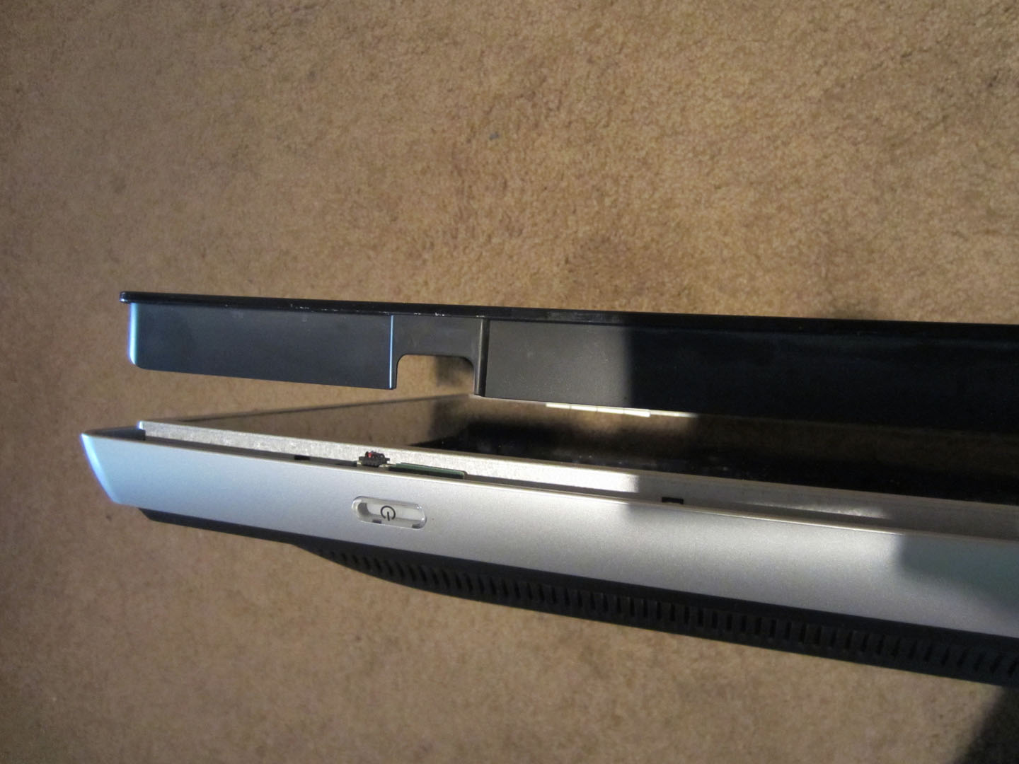

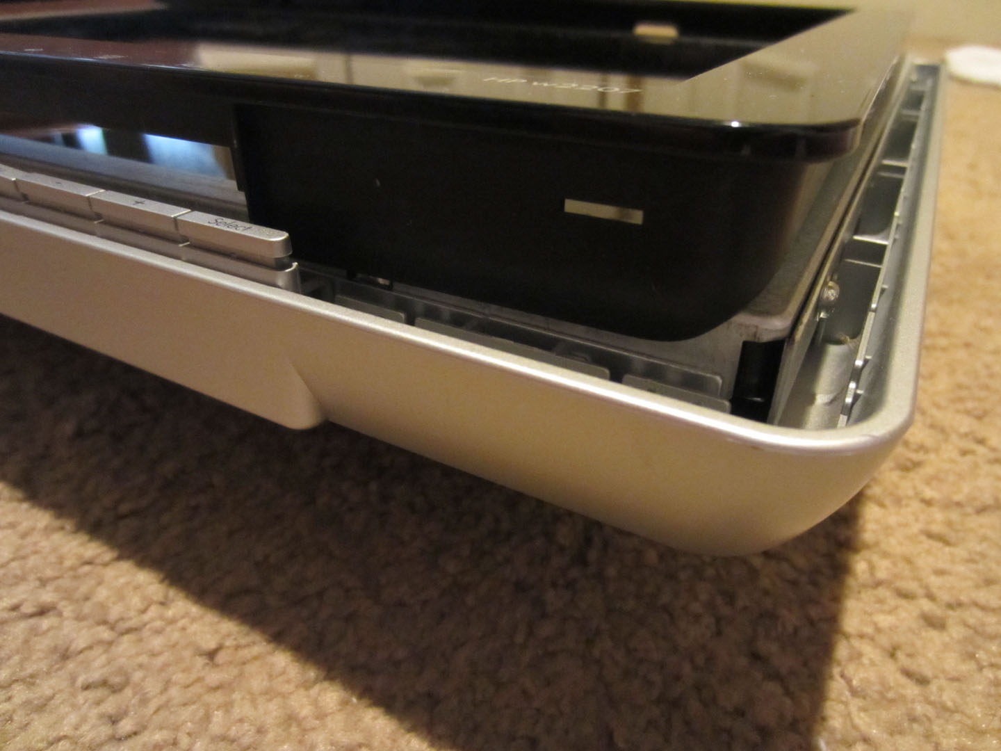

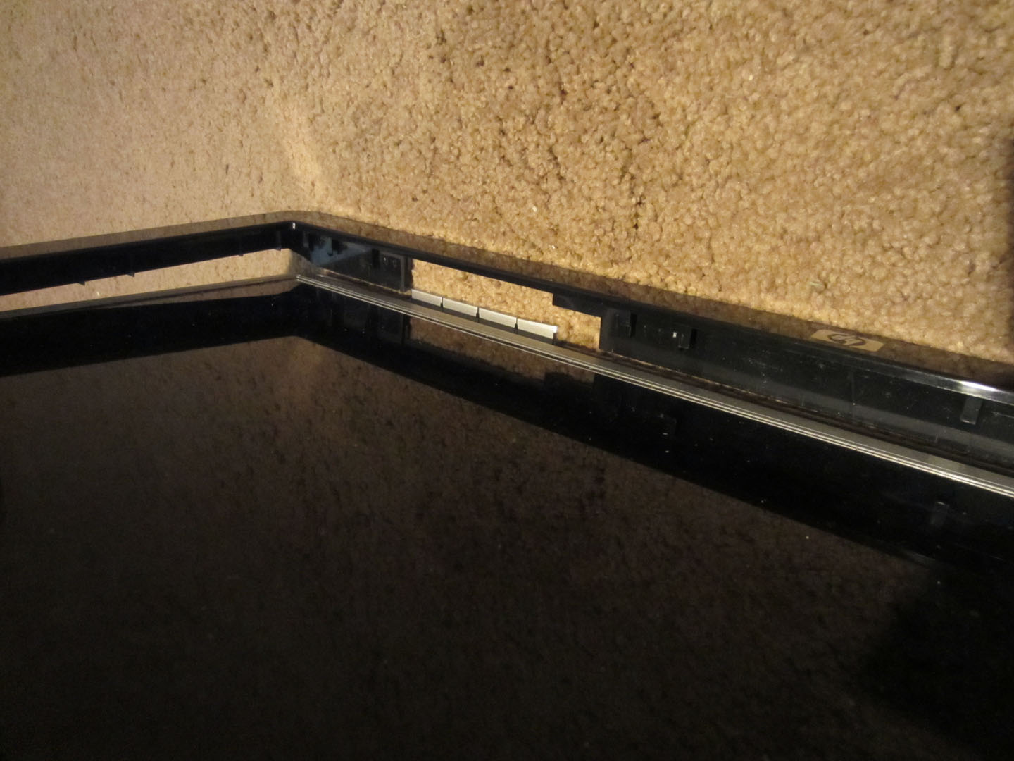

                                  #56
                                  Re: HP W2207 Backlight Problem

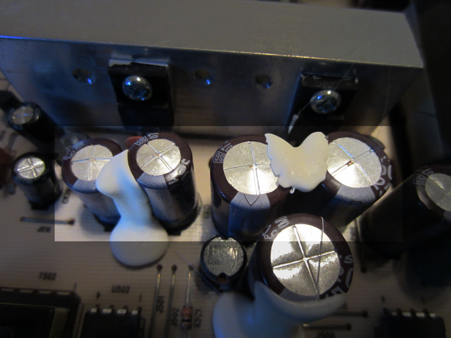

                                  Okay, after ripping up my fingernails, I'll heal in a few weeks, I finally got the front black bezel off. It appears you just have to pry it straight out. At some points I thought it was going to crack. The corners were difficult. After the bezel came off the rest was self explanatory.
                                  I pulled the power board and sure enough I found 4 bad caps, 2 big, 1 medium, and 1 small. I'll look into replacing them at some point. Hopefully more components aren't shot.
                                  I've seen whole power boards selling for about $25-$30. But I figure they'll have the same crappy caps and will most likely fail in the near future. I'll most likely buy the caps from badcaps.net again. Here's a few pictures of the front bezel off.
                                    Purchased the caps from here. Got all 25v 1000uf.
                                    Replaced the 4 bad ones and the monitor powers on now!
                                    The whites don't seem too vibrant. The lamps are most likely worn.
                                    But a $12 fix for a free monitor, I can't complain.
