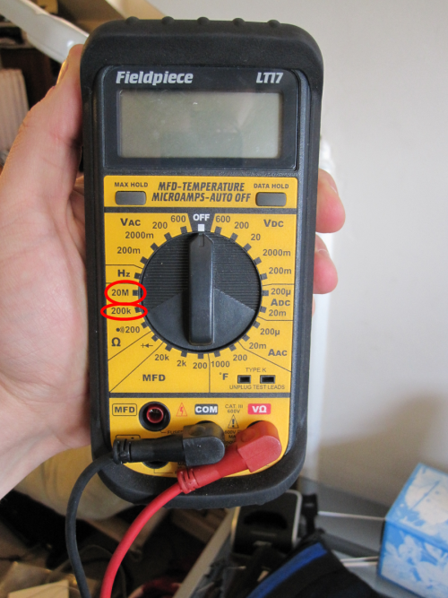

      Hey, sorry about the delay. I finally measured the ohms of the locations you highlighted. I have my device set to 200k and was unable to get ANY reading. I even tried 20M and only got 0.00 on both.
      • retiredcaps
        • Apr 2010
        • 9271
        Re: HP W2207 Backlight Problem
        Use 2000 ohms (as per post #18).

              Sorry I keep dragging this out. It's been a while since I've been able work on this again. I'm attaching a picture of my multimeter in hopes that someone can tell me which setting to use. When I measured it using the circled settings shown in the picture I didn't get a very good reading.
              Thanks if anyone can tell me what to set it to to measure the inverter.
              • retiredcaps
                • Apr 2010
                • 9271
                Most secondary inverter transformer readings are around 1000 ohms or 1K. With your multimeter set to 200K, that would mean the reading should show up as 1 on the right hand side of the display. A reading of 1K will probably not be sufficient resolution to tell if your transformer is good or bad.
                In order to do this test, you will need to borrow a multimeter that is autoranging or a manual one with a 2000 ohm range.
                PS. Most manual range multimeters have ohms ranges of 200 ohms, 2k, 20k, 200k, 2M, and 20M. I can't recall seeing one like yours with such a wide gap in the ohms range. I suspect it was to allow the MFD range so they had to compromise.

                  Awesome! Thanks for the reply. I'll see if I can't find a meter with the 2000 range.
                  • retiredcaps
                    • Apr 2010
                    • 9271
                    #29
                    I was in the hvac-talk.com forum and saw reference to your multimeter, Field Piece.
                    Looks like it is a fairly specialized meter and thus doesn't have the same ranges like electronic multimeters.

                      Resurrecting this thread yet again!
                      Ok, so I picked up an inexpensive DMM that can measure at the 2k range. Here are my findings:
                      As per retiredcaps instructions here:
                      Linky
                      I measured the red circles:
                      .478
                      and the yellow circles:
                      .484
                      That looks to be within the 3% threshold.
