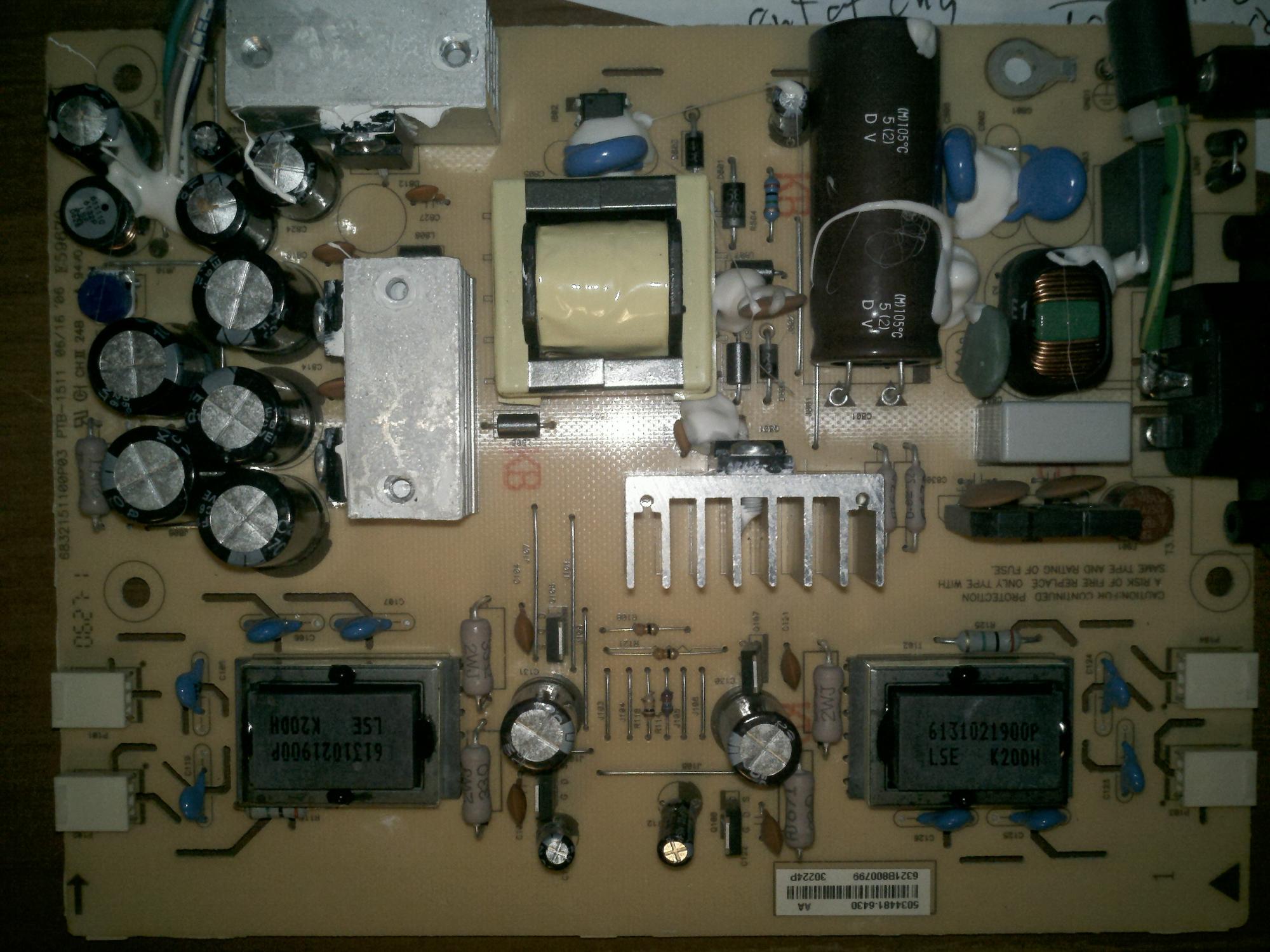

    dell 1740fpt
    Power light comes on dell logo appears, test icon appears screen goes blank. When screen is showing logo ccfl's light, when screen goes black they go off. Any thoughts?

    1) Clear focused pictures of your boards using manage attachments will help. Please do not post inline.
    2) If you hookup a computer displaying your favourite wallpaper, can you see it by shining a flashlight on the display?

      Re: dell 1740fpt
      Yes you can see either logo or wall paper, with bright light. Checked all caps, good. Transistors appear good, no shorts, or burned resistors.

        You have 2 seconds to black. Possible causes in no particular order are
        a) bad caps
        b) bad inverter transformer
        c) bad ccfl
        d) bad ccfl wiring
        See (starting with post #13) for all the details ...
        https://www.badcaps.net/forum/showthread.php?t=10419
        edit: How are you checking the caps and concluding they are good? ESR meter?

              • Lumberjack777
                • Dec 2010
                • 464
                Re: dell 1740fpt
                You sure that's not a Dell 1704FPT not 1740FPT? I couldn't find any manuals or drivers for a "1740" at Dell
                If it is a 1704FPT then the solution is the same as the one found in this recent thread https://www.badcaps.net/forum/showthread.php?t=11807
                The inverter comes with a 22uF 50v cap, when it should be a 2.2uF 50v. The caps are mismatched. In my case it took out the inverter transformer too.

                          Ok let me try this agin it is a dell 1704fpt not a 1740fpt. duh! Thats why I check my replacement parts more than once before I change them. I replaced all the caps with new capxon, tit, for tat, whatever value and style the board had is what I replaced it with, regardless as to if it checked good with my vom. Yes I know thats not a certain way to check but at this point all I can afford, caps are cheap compared to the uncertain check of a vom when I try to problem solve a odd board problem. As for the pic I will check resolution and re attach. Right now I am away from my main storage drive. Thanks for your patience while I try to learn.

                            • Lumberjack777
                              • Dec 2010
                              • 464
                              Re: dell 1740fpt
                              Ok, good. I just repaired a Dell 1704FPT 2 days ago. In my case the inverter section of the board had a 22uf 50v capacitor, when it should have been a 2.2uf 50v. (located at C112) Those 2 small caps need to be matched. (2.2uf 50v)
                              Here's what fixed it for me......
                              1. Replaced capacitor at C112 (the 22uf 50v) with a 2.2uf 50v
                              2. Replaced the transformer at T102. (ring tester showed primary had shorted)
                              3. Replaced resistor at R125 (even though it tested good, it had really gotten hot and the whole area was brown) This is probably optional
                              Good luck

                                • michaelahess
                                  • Oct 2010
                                  • 11
                                  Re: dell 1740fpt
                                  I just got a dead one of these as well. Won't power up at all.
                                  I see three leaky caps in the upper left. I figure I'll replace those.
                                  The two caps at the bottom are also different, 2.2 left 22 right, should I replace the right one?
                                  And since it won't power at all, should I check anything else or would those caps be the most likely culprit?
                                  Thanks!

                                    Re: dell 1740fpt
                                    Capxon makes some of the worst quality caps around. My standard answer below (regulars may skip).
                                    https://www.badcaps.net/forum/showpo...84&postcount=3
                                    Check the fuse. A good fuse should measure less than 1.0 ohms.

                                    • michaelahess
                                      • Oct 2010
                                      • 11
                                      Re: dell 1740fpt
                                      Fuse tests good. I'll order up some caps. Would it be wise to replace all the larger 470uf 35v ones as well?
                                      • selldoor
                                        Slow Learner
                                        • Dec 2010
                                        • 7870
                                        Re: dell 1740fpt
                                        Yes if they are capxon, There are other tests you might want to do first - this is only a 17inch screen if the ccfls or transformers have gone how much would you spend to repair it? Please can you update your profile with Country and mains voltage.
                                        Next test would be voltage on the BIG cap CARE required as HIGH voltage. All connected up and switched on set meter on 600vDC put red probe on positive leg and black probe on negative leg and post results.
                                        Another easy test is on the inverter transformers secondary windings.
                                        Power off ( for 5 minutes at least) Set Meter on 2000 ohms and measure secondary windings cant see the pin numbers but is the two on the outer ends -Post results
