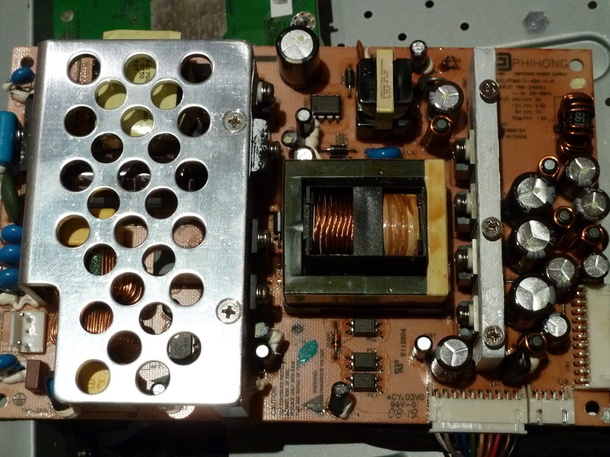

 I just recapped my power board for the 3rd time. This time I purchased all low ESR panasonic, and nichicon caps that were recommended from this site. And I replaced every cap this time. When I had not low esr nte caps on the board it would give me a blue led and show video for a short time, now with the new caps it's back to doing absolutely nothing, no led, no video, no electronic hum. I am pretty much out of patience at this point, is there anything that I could possibly be missing?

 Re: Hanns-G HG281D, LCD Monitor no power
 This is pretty much the same thing PlainBill said in post #123.
 If you have no power LED, the first thing to check is to see if you have 5V standby voltage. If yes, then check to see if there is 5V DC on the main/logic board. The logic board will instruct the SMPS to start via PS_ON or some equivalent pin.--- begin sig file ---

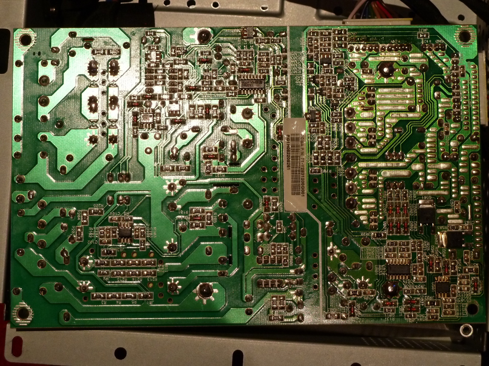

 Hello Badcaps Vets,
 I picked up this Hanns-G HG281D monitor at work, no power problem, no blue led, nothing. I read through all the threads and haven't ever done any soldering ever. I'll look through the youtube links.
 Would it be smart to just order the caps suggested for power issues as mentioned in earlier threads? - (C603,606 and 707 & couple more small one) Also what other smaller caps are suggested to replace for power issues? I'm attaching some pics there is some glare from all the lighting to used if they're not clear enough please advise and I will retake during the day.
 ThanksComment
 No. Luck at the post just above yours. Start by taking voltage readings and then we can proceed from there. It might end up that you will need to replace caps, but what if you just have a blown fuse?--- begin sig file ---
 Okay, here is an update with my Hanns-G 28" LCD monitor.
 I first replaced the caps on the power board and it did not do anything for my LCD. I experienced the same symptoms as before, shakiness and shutoff after a minute or so. I gave up for a few months but then decided to replace all the caps from the main board and BINGO! The LCD works just like new again.
 Fixed my power supply issue using this site, THANK YOU to everyone who posted! Now it seems the logic board is not working despite replacing several of the electrolytics on the the logic board (granted used ones, but it didn't make it worse or better). Monitor turns on and stays on, but it will flash a solid red image every 3/4 of a second if set to 1920x1080, other resolutions will either go blank (most likely cause the monitor does not support them), and for other resolutions the screen will flash slower or faster, but still remains a solid red. No image of any kind shows up other than wavy lines and seems worse when using the HDMI compared to using the VGA input. Will take pictures, but I am working on this monitor after someone else, so many of the solder joins are pretty bad shape, even after trying to clean them up.
 Outside of it looking rather dark, I got it to work. Ended up touching up all the pins on that huge IC in the middle of the HDMI/VGA board, then I did more clean up on some solder joints that looked bad on the power supply plus fixed some bad traces, then I took the board at the very top of the LCD and redid solder joints here and there and too my surprise it's working, BUT, I OWE IT ALL TO THIS GREAT WEBSITE FOR ALL OF ITS SUPER AWESOME INFORMATION!!!Comment
