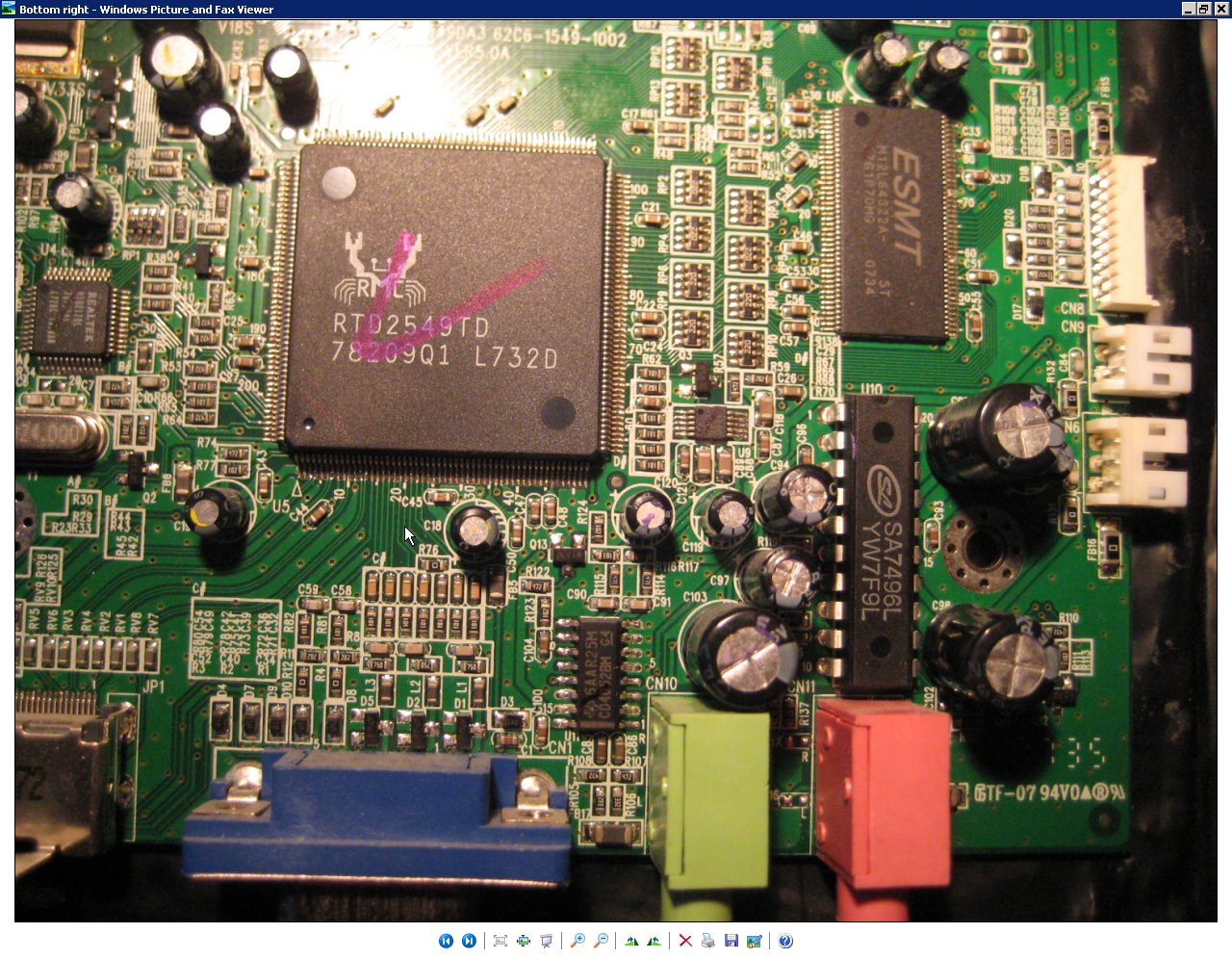

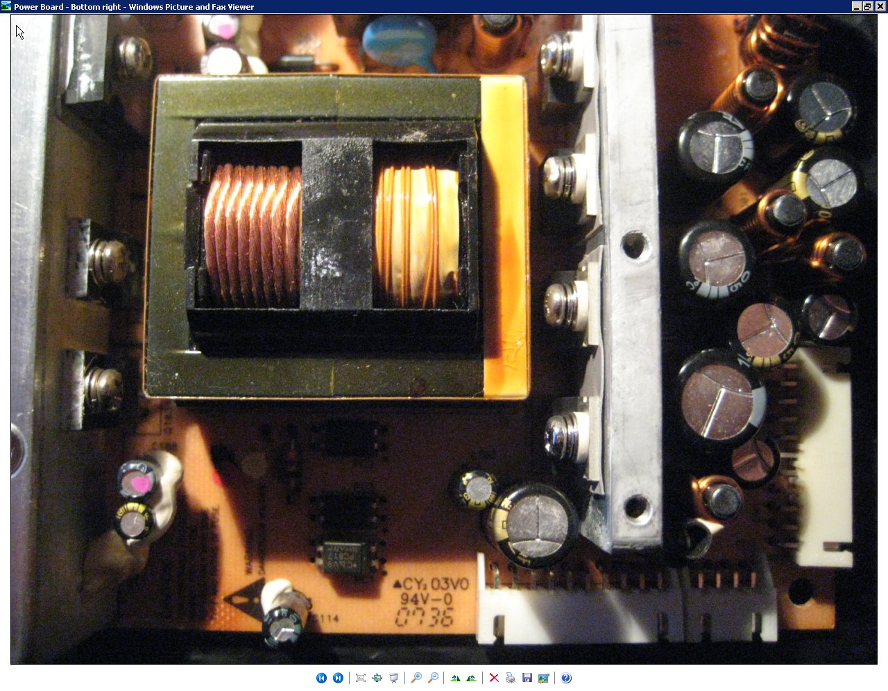

It is possible that the 7 electrolytic caps clustered around V33S and V18S are dried up and causing the fluctuating voltage. As I have mentioned several times
this particular monitor runs temperature hot and warrants a complete recap of both the power board and main board.
