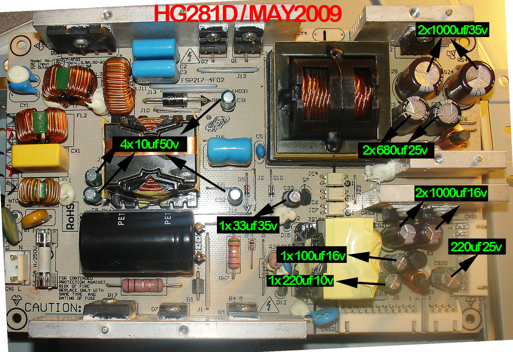

OK. I've just found 3 dry caps (C603,606 and 707). Going to buy repair kit and replace all of them. Thanks to every body for your support.
