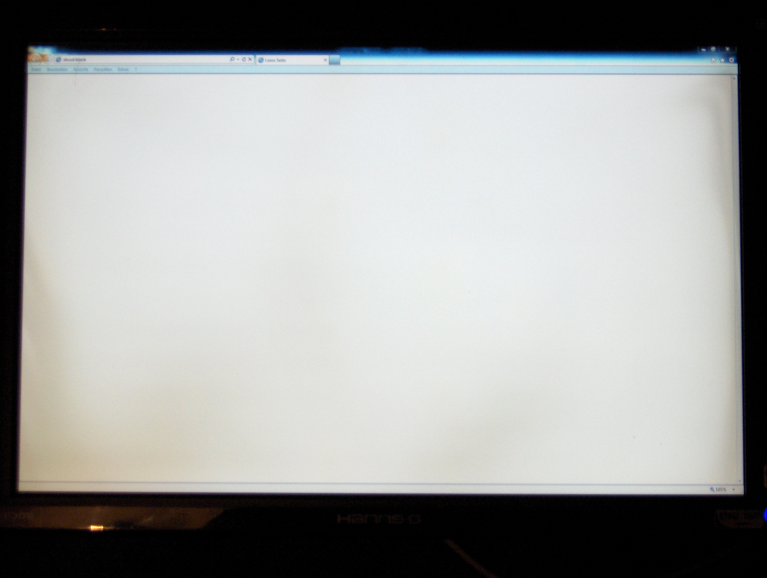

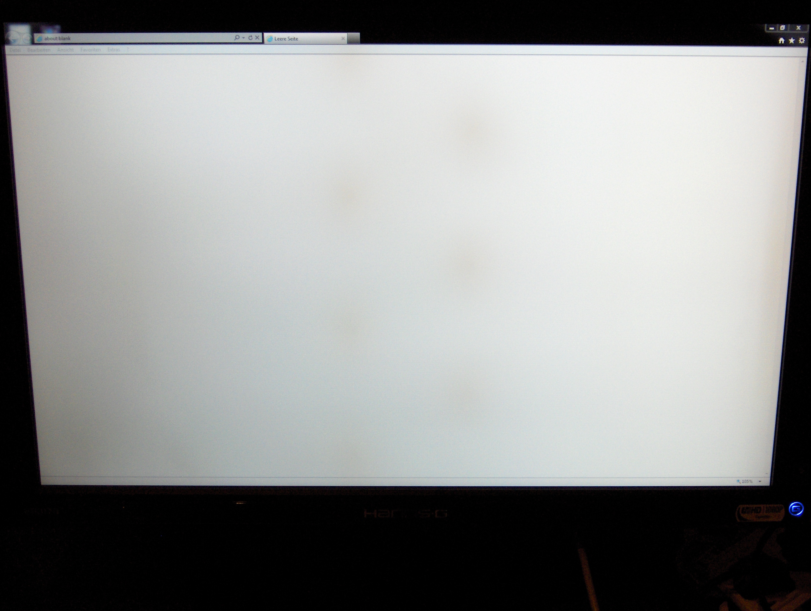

      I got two of these displays - both completely dead - for a small amount of cash and decided to fix them for use at home for wife and kids PC. After a full recap with Panasonic FR / FM / FC I could resurrect both of them. But the result was very disappointing: they suffer from major brown spots on the sides and also in the middle of the screen. And it appears that these spots come up there where the panel isn't sealed with a tape that joins the panel with the bezel.
      Somebody correct me if I'm wrong but the panels can be dumped as there is some dirt / dust between some layers of the panel which is nearly impossible to clean (in DIY).
      So I'm just curious if anybody here ran into these problems too with this screen`?

        Maybe they were in a smokey environment.
        Not impossible to clean but may be difficult - could it be just the bulbs?
        Please dont dump them they could be used for test purposes or the bulbs as replacements or for testing. If you dont want them offer for sale or give them away.
        If someone has a cracked screen they may be glad of one.
        Do you have "freecycle" in Hesse.

          Re: Hanns-G HG281D, LCD Monitor no power
          Hmm...any success stories here of tearing apart a panel and cleaning it?
          Well I will keep them for now, got enough space in my house here for storage hehe.
          But anyways big disappointment to see them in this condition
          The display on first pic is indeed from a household with heavy smokers, but second is from non smokers house.

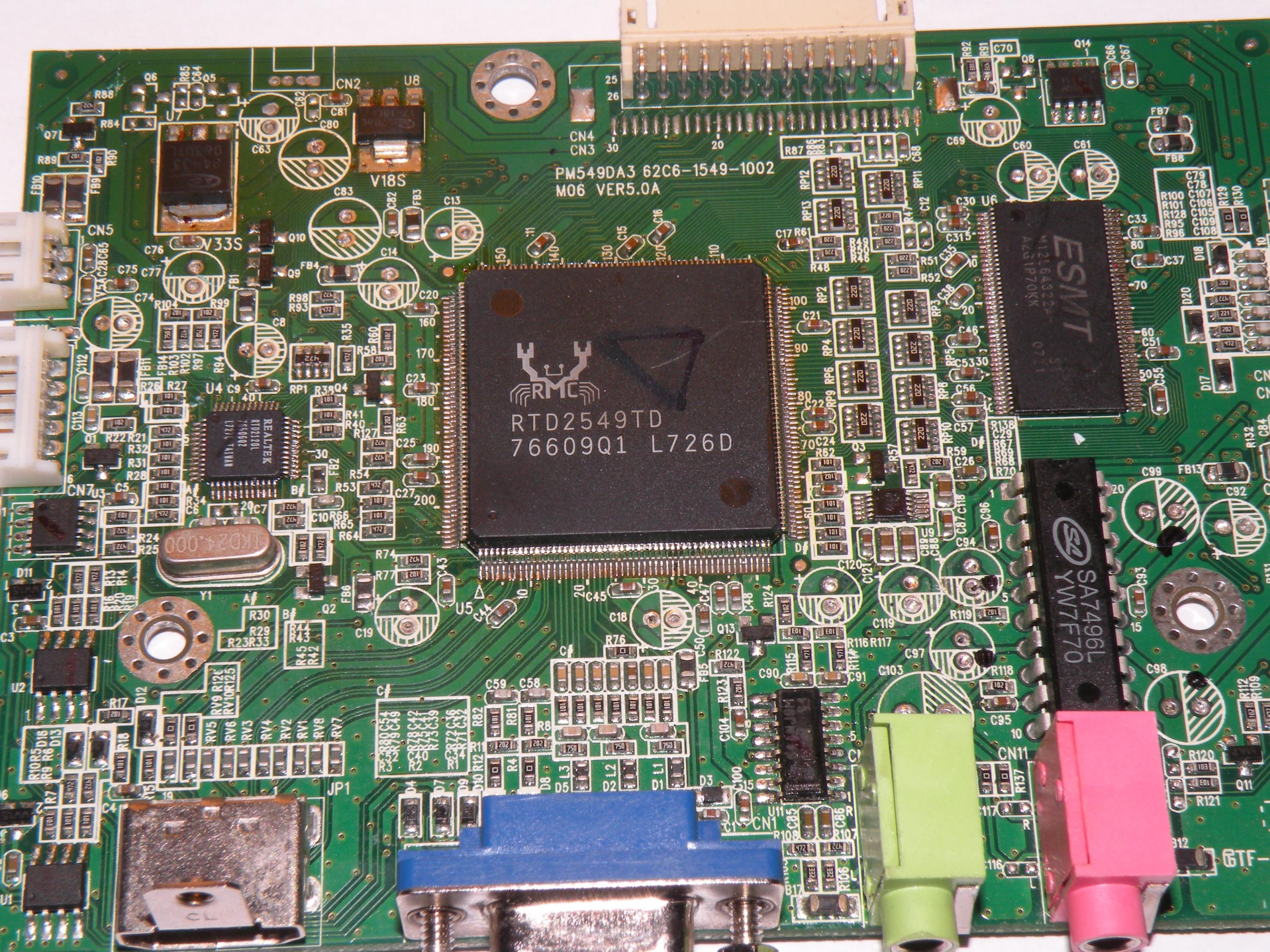

                      Hi All,
                      I'm new here, but I have the same old problem with my monitor like most of you.
                      I was trying to replace all the caps on the main board and I had a really problem removing the 10uM 16v caps. Now I'm worried that my circuit board could be damaged. Is there any way I can tell the condition of the board before I will solder the caps back.
                        post a closeup in focus well lit picture front and back of the damage zone
                          There is no visible damage, what I'm worried about is a heat damage.
                          On attached pictures I marked three spots with dots and circles where I have no continuity between negative side and another negative spot. All the other caps spots seem to be good. I hope the pictures are ok.
                            Well there is no sign of heat damage -I was expecting bubbled boards and lifted traces! I have been trying to see where the traces go but on two cant tell (too populated) may go to those small resistors and the other two you have clipped the picture before they end. You trace them out them check for continuity.
                              It takes A LOT of heat to damage a board. An iron that is not hot enough can damage the board much easier than a very hot iron.
                              That's because those are likely coupling caps for the audio amplifier (that SA7496L IC). It is highly unlikely that those caps will ever cause a problem with the operation of the monitor so you don't need to replace them.
