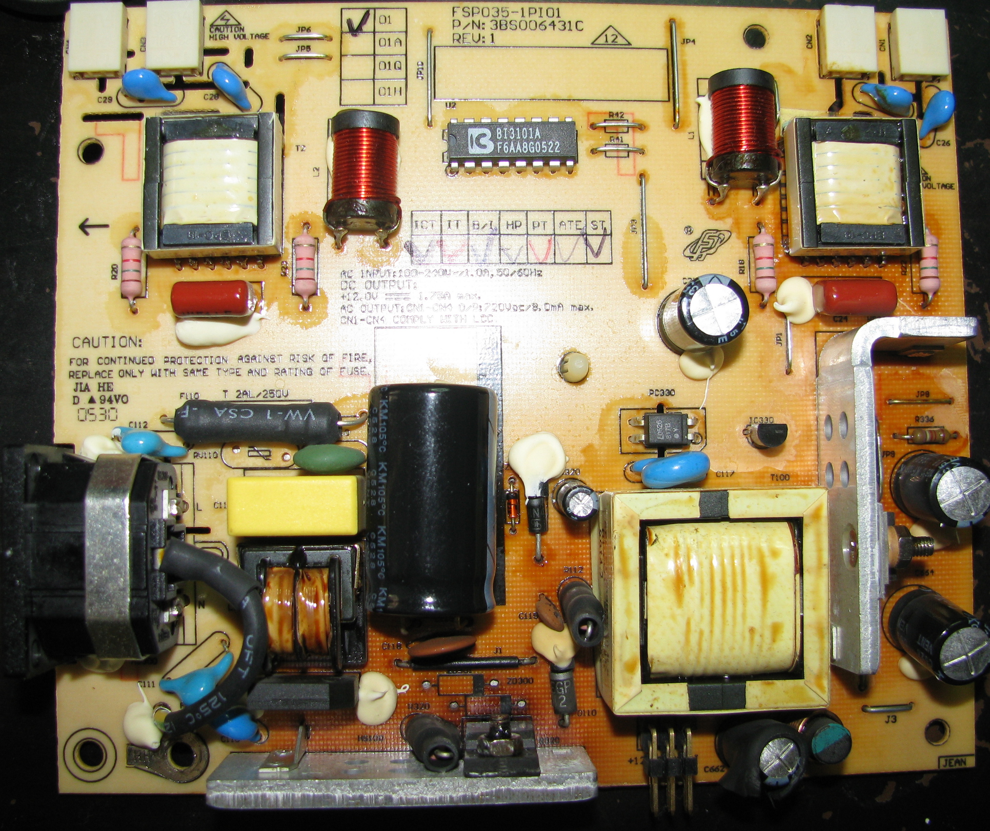

                Sorry to jump in and Necropost here, but I was browsing idly on this model and came across something appearing the same as what I have going on here, and thought I would toss some pictures into the mix.
                The monitor is one I picked up for recycling, and the power board looks kinda bad, so I was considering ditching this monitor. It looks like it might be a bit of work, and the board may be done with due to what appears a lot of leaked electrolytic fluid all over the place.
                There's a lot of darkening around the Q320 and the main cap is done with.

                    Lots of the caps have failed by the looks of the bulging ones !!!,is the staining really from the big cap?? not so sure about that.These boards do get very hot and discolour, the inverter drive transistors on th back of the board usually go short circuit, other faults are the Inverter transformers and the Brown Poly caps next to to them.So a lot to check if you are considering repair ??
                        Wow, I don't have decades of experience, but I have seen my fair share of pictures here and I have NEVER seen one like yours before.

                            Ok - so you need to clean the board up a bit then let us know if you want to have a go.
                            I would test the inverter transformers as these can be expensive to replace relative to the cost of a used working or semiworking 19".

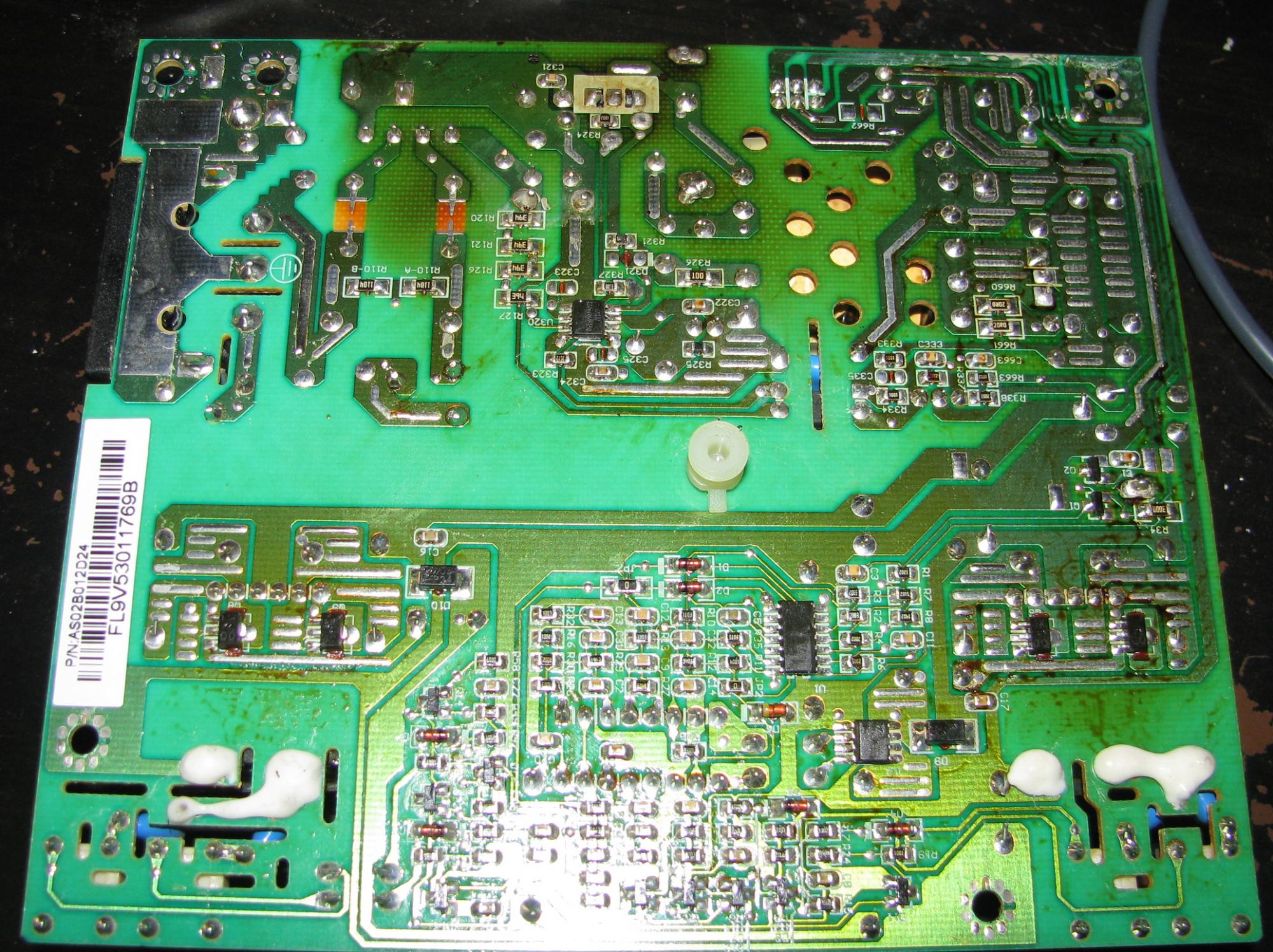

                                  I did try a light rinse and aggressive dry, which did remove some crud from surrounding contacts. I may decide to just try the dishwasher trick described in one of the posts on the electrolytic leak discussion.
                                  Is anyone sure the edges of the board won't absorb any of the water between the layers of the PCB? it looks like it may be a bit porous.
                                  Its looking like it may be a bit more work than I want to get into with around a month to go before I have to pack the car and move. I just hate to ditch a possible good monitor it could be made to work again.
