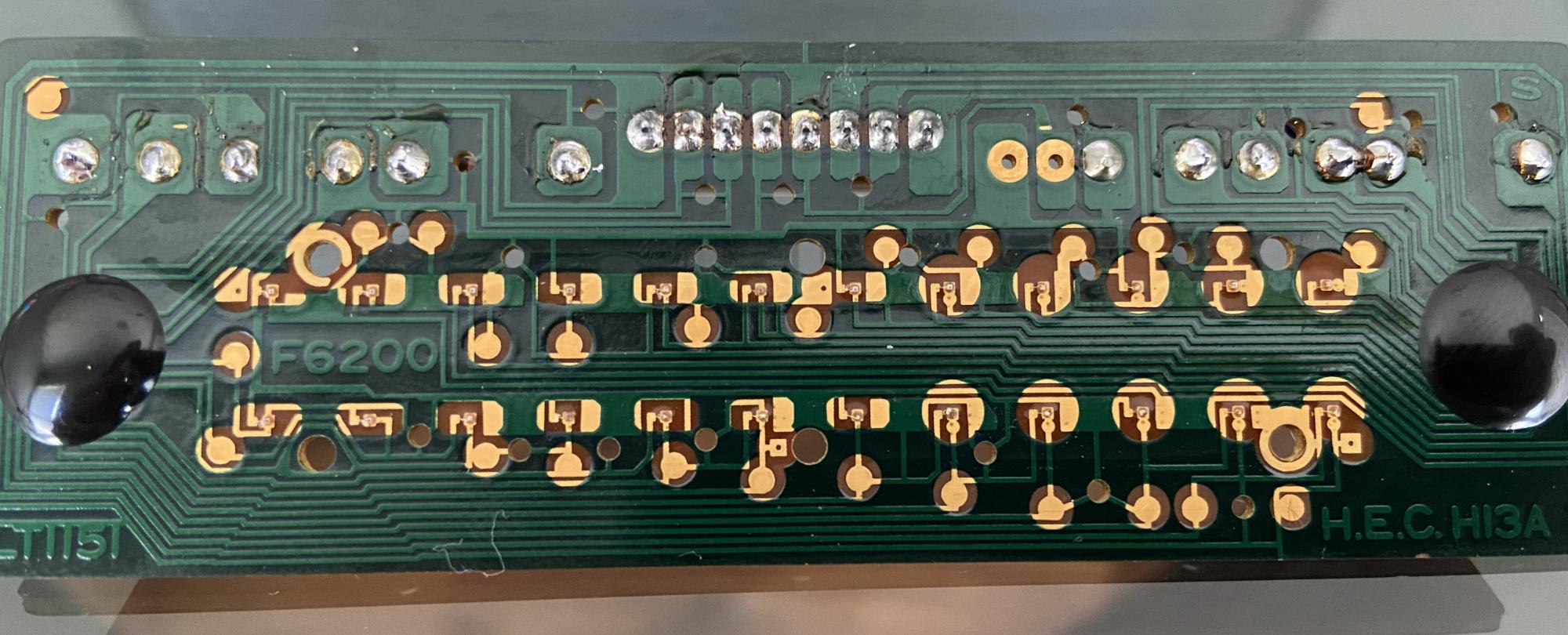

    Re: Strange malfunctioning LED audio peak level meter problem
    The led's are the size of a grain of salt. I touched a couple and they went out too. I'm going to have to find an old computer running windows 7 so I can use the only usb microscope I have (Veho Discovery VMS004).
      well you probably need to replace the lot - so the brightness matches
      i would be tempted to build a new one possibly using a chinese vu meter module as a base and making a new led board to match the original spacings.

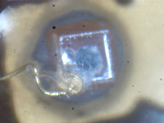

        Thanks. The more I look at it, the micro sized led's would be beyond my capabilities. Still looking for an old windows 7 pc to use my microscope. Lol
        From what I can see with limited magnification it appears that there are tiny single strand wires coming off of the leds!!

            Veho Discovery vms-004 usb microscope
            Worked years ago on old laptop I had. Windows 10 doesn't have a driver

              Read a review on amazon ao got it to work with my camera app!
              • JimBanville
                • Aug 2020
                • 118
                So I can see the microscopic wires and pads dislodged from the led's. Thanks! Now...how to reaffix them? Its insanely small.

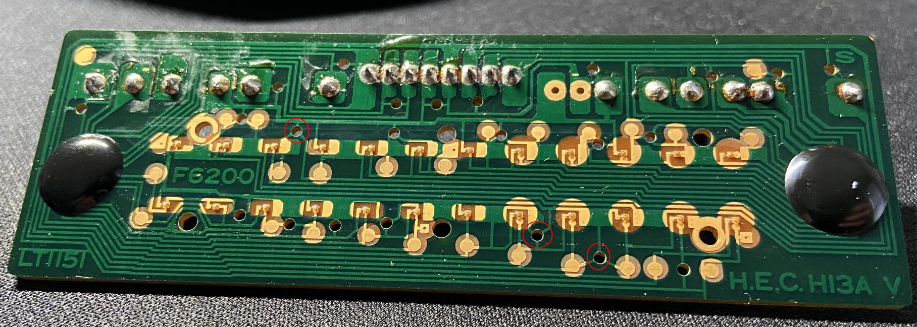

                  pics

                    #29
                    Pic
                      you cant fix them, you have to scrape them off the pads and solder tiny smd leds

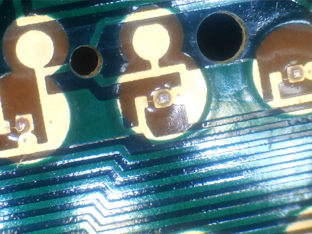

                        You can test each LED as suggested, and also use high power magnifying glass each bonding wire of the LED.
                        I also see strange trace layouts.
                        I am also surprised that exposed bonding and die last this long, but since they cannot put black blob on top like they did for the IC since they are LED, they could have put on clear sealer instead on the LED's.

                          Ok. I'm probably going to relocate this board and run jumper wires from it to individual wired-led's mounted into the plastic housing that mounts to the cassette player's face.
                          My understanding is that 1 signal goes to one side (let's called it "+" side) of the 1st, 4th, 7th, and 10th led's of both top and bottom rows. Now the other side (let's call it "-" side) of the 1st led goes to the + side of 2nd led. The - side of 2nd led goes to + side of 3rd led. The - side of 3rd led goes back to the IC. This same scenario is repeated for all the groups of 3 led's. There are 4 sets of 3 led groups on each row.
                          Can someone recommend wired-led's? I'll need some green, amber/yellow and red. They should fit into the plastic housing.

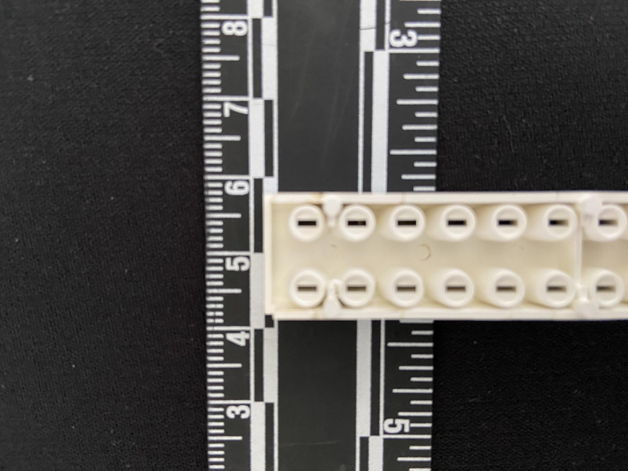

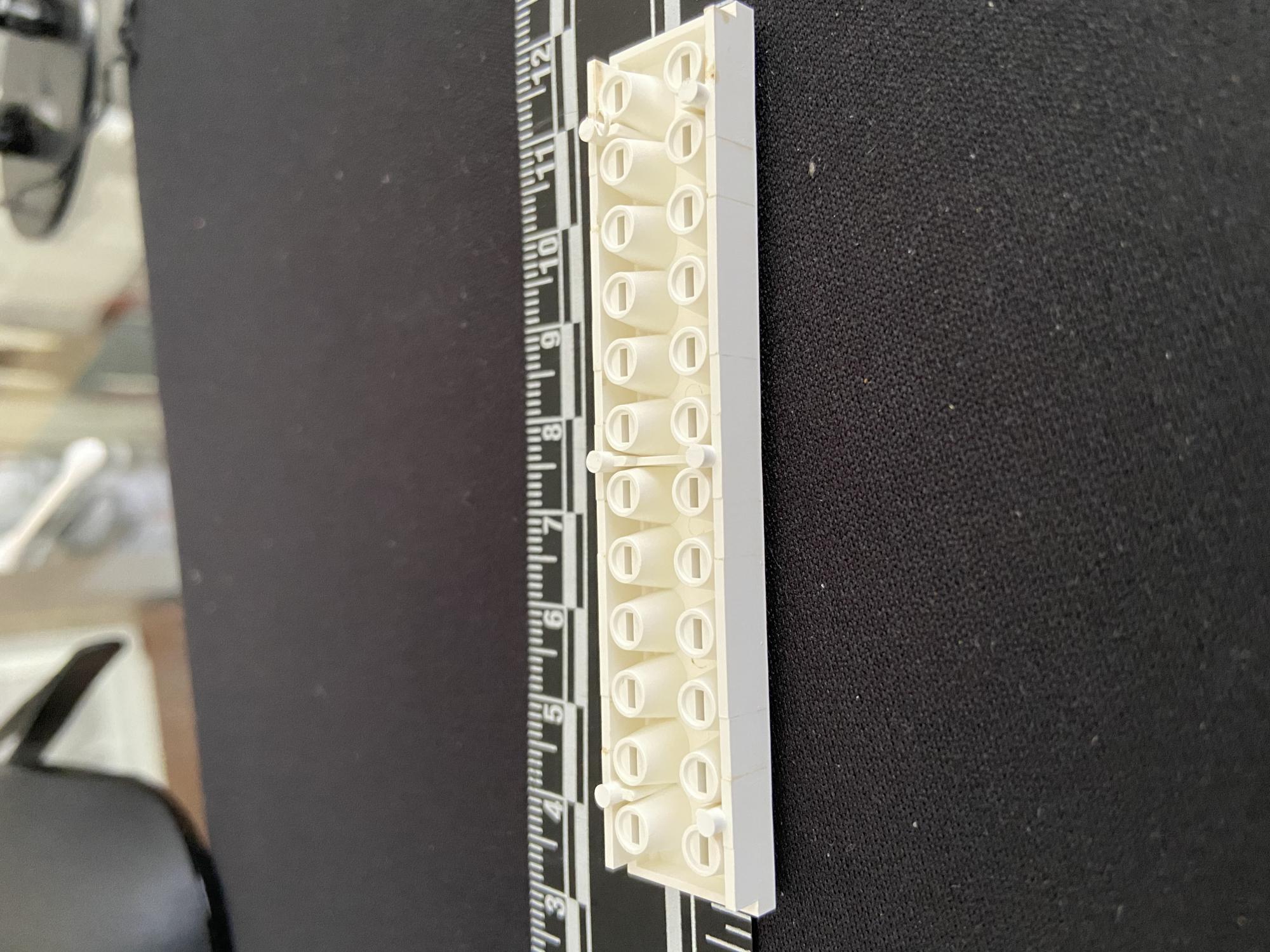

                            #33

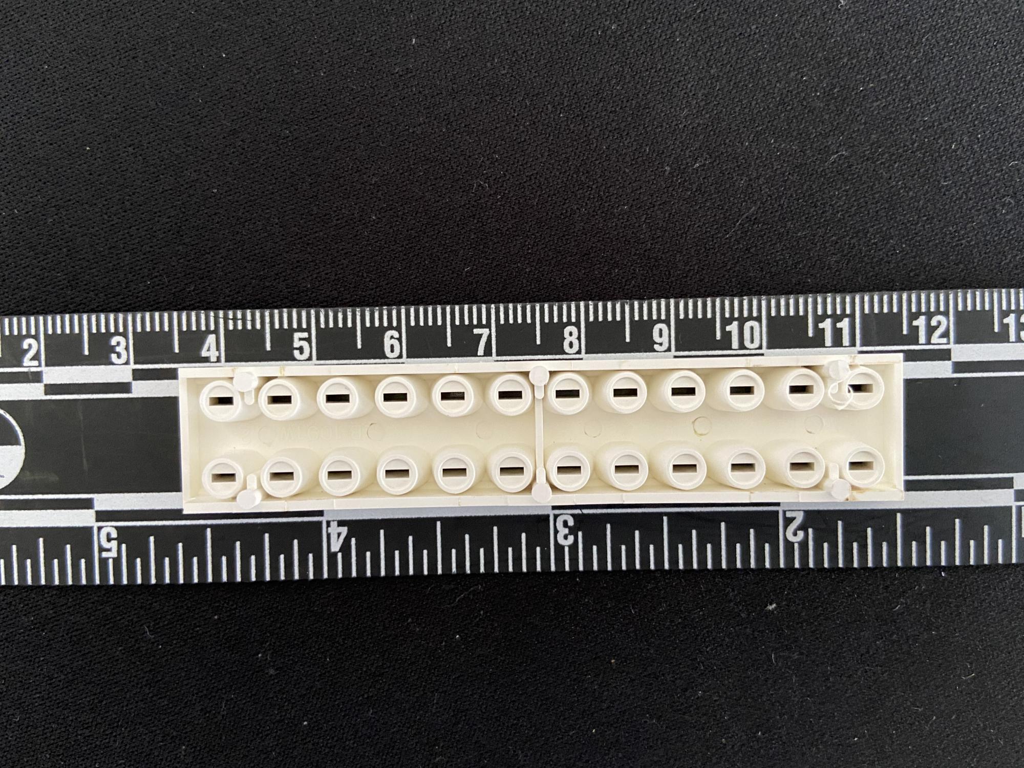

                            Plastic housing

                              Unfortunately I have neither the tools nor skills to both view, manipulate, and solder those microscopic wires in place.
                              I CAN solder some jumper wires to some of those larger exposed traces and test points to some wired-led's.
                              Based on how these traces are laid out, I should only have to connect 9 jumper wires to the board. 1 of those 9 wires will break out into 8 wires itself, which will go to one side of the 1st, 4th, 7th, and 10th led's on both rows. The remaining 8 wires connected to the board will connect to the "other" side of the 3rd, 6th, 9th, and 12th led's on both rows. The remaining led wires would connect together depending on where they fall in the arrangement.
