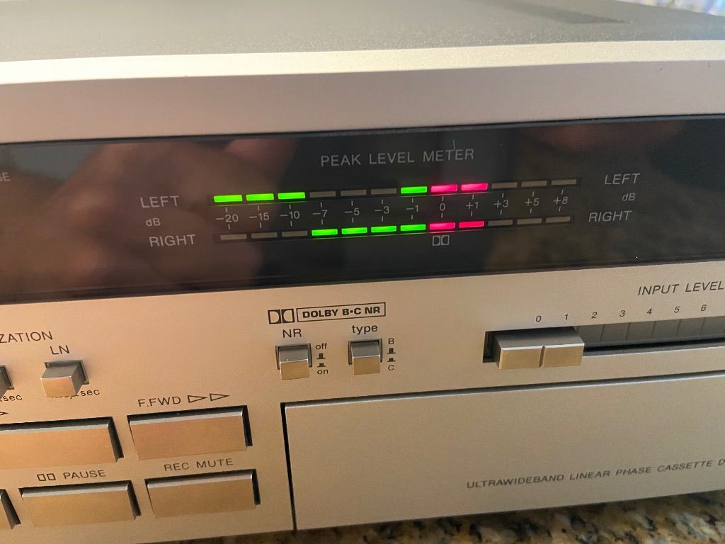

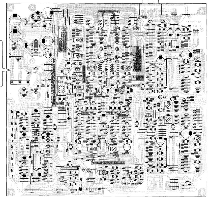

    So, I just got this old Harmon Kardon TD292 cassette player. It plays, but there are two groups of three LED's, one on each channel of the peak level meter, that aren't lighting up. I've done some minor electronic repair, but I can' figure this one out. I've taken it apart, but I don't see anything out of the ordinary. I don't know what "drives" these groups of LED's. These LED's light up individually, but I'm assuming there's something "assigned" to drive them in "three's", yes? The housing the LED's are in is mounted to a small board in a way that you can't see the individual LED's nor their connections to the little board they're on. Any ideas where to start?

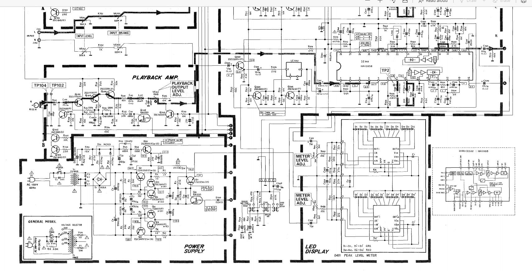

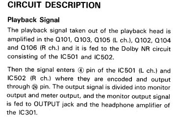

          Ok. The biggest ones are pair of DOLBY chips (one for each chanel I guess).
          From tha manual...
            Re: Strange malfunctioning LED audio peak level meter problem
            Show us good clear pictures of the inside of the unit and the boards.
            The LED meter assembly should have the LED driver IC's on that board, so check for bad the solder joints first.

              Judging by the schematic you provided in your startpost, the 2 driver IC's are indeed located on the PCB holding the LED's. This PCB is connected to the mainboard through a 8 wire flatcable of some sorts. The connector is the one on the lower side of the mainboard shown on the photo in post 3, just below the text 'Meter Level Adj'.

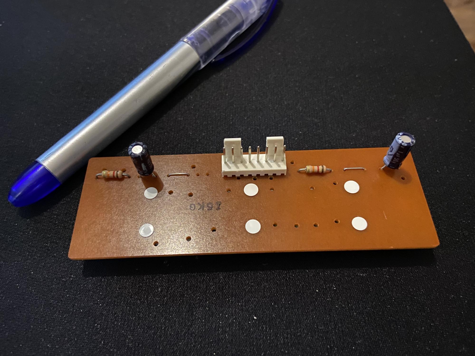

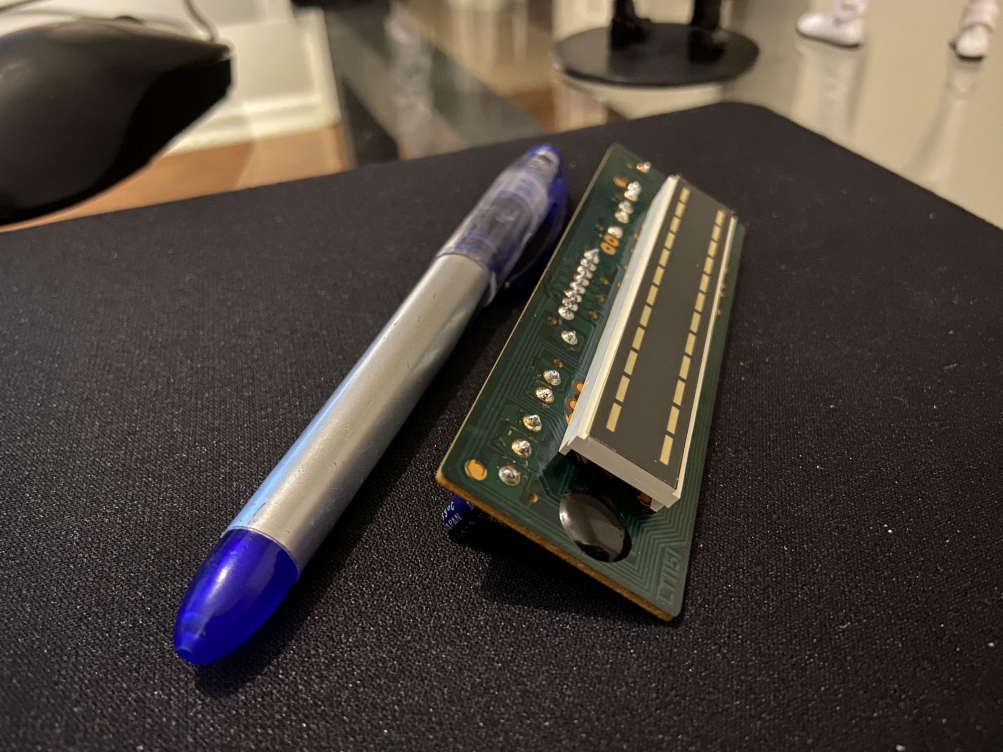

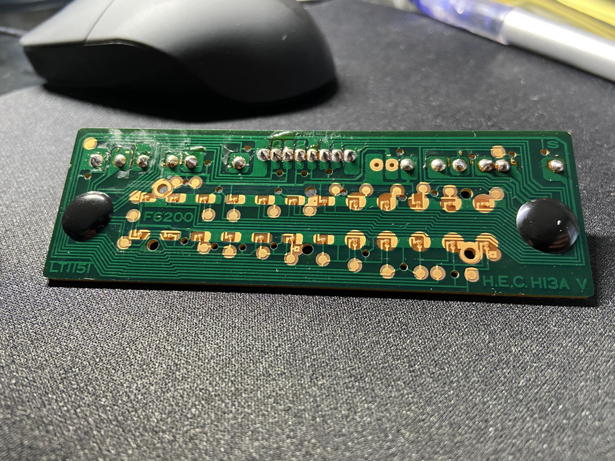

                        Pics of led board
                          Yep, one of those encapsulated (Black blob) IC on PCB.
                          It looks like the LED's pins are mated to the PCB using pressure to make contact with the PCB pads.
                          If you flex the board you may see the LED come and go.

                            So what do u think I should do next? IC problem? Dead LED's? Bad led connections?
                              Did you try flexing the board while power up with signal so you can see flexing will cause the LED's to come and go?
                              https://www.badcaps.net/forum/attach...3&d=1597194394
                              Those white plastic dots look to holding the LED assembly to make contact with the PCB.

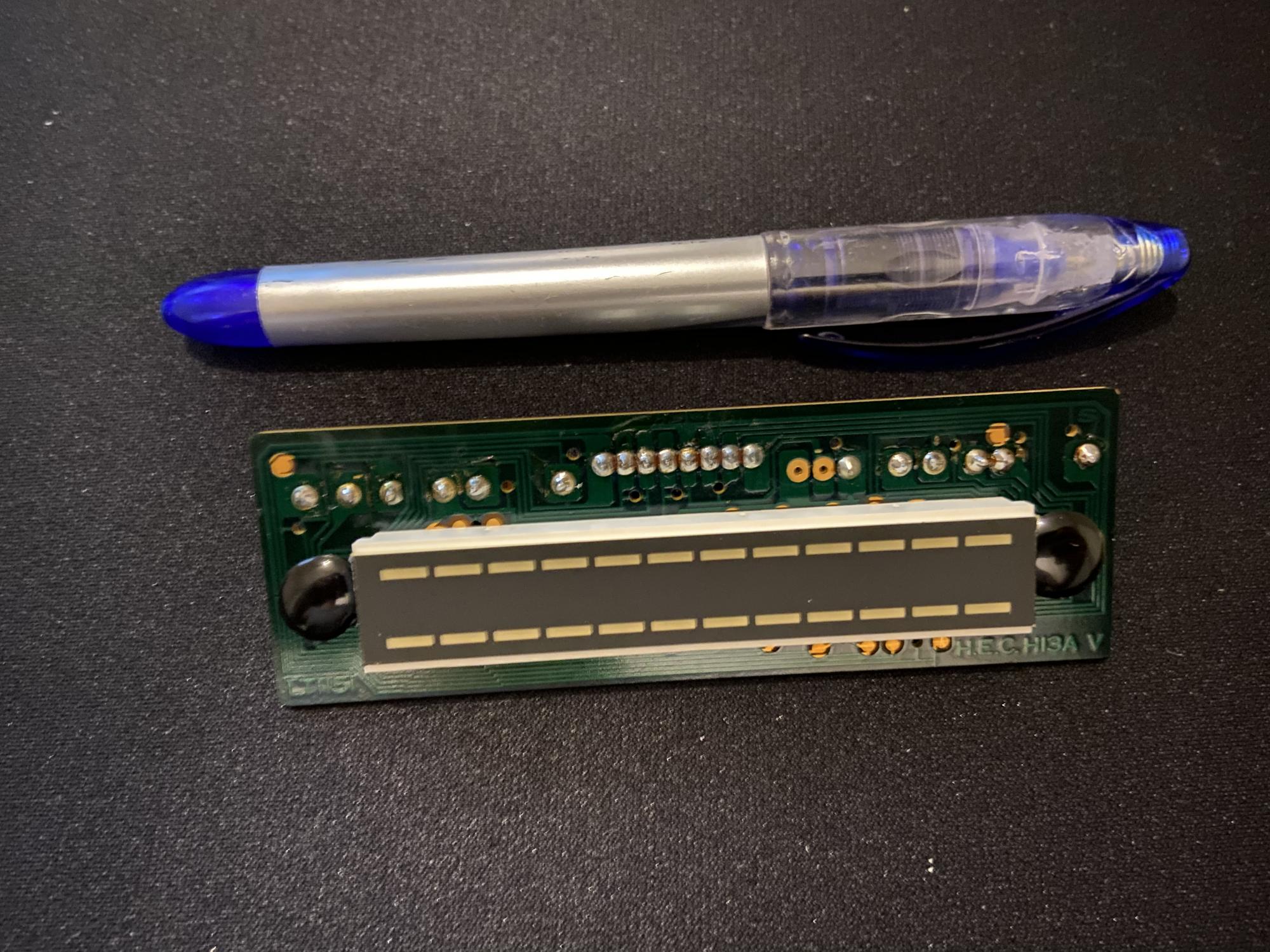

                                What I have done when desperate to repair vintage gear is VERY CAREFULLY remove the LED diffuser assembly to access the naked LED's on the PC board. This means cutting/remelting or removing the six plastic pins and pulling off the LED diffuser straight up. If you slide it sideways it will kill all LED's by shearing off the bonding wires. I expect raw LED dies on the PC board with a tiny bonding wire.
                                You could also just carefully peel off the diffuser overlay to see what's inside.
                                I would solder in 0603 LED's to replace the defective ones.
                                edit: to get troubleshoot kind of displays to work in the shop we used freeze spray drops on an LED. I think they get a bad connection to the die, the bonding wire doesn't quite work.

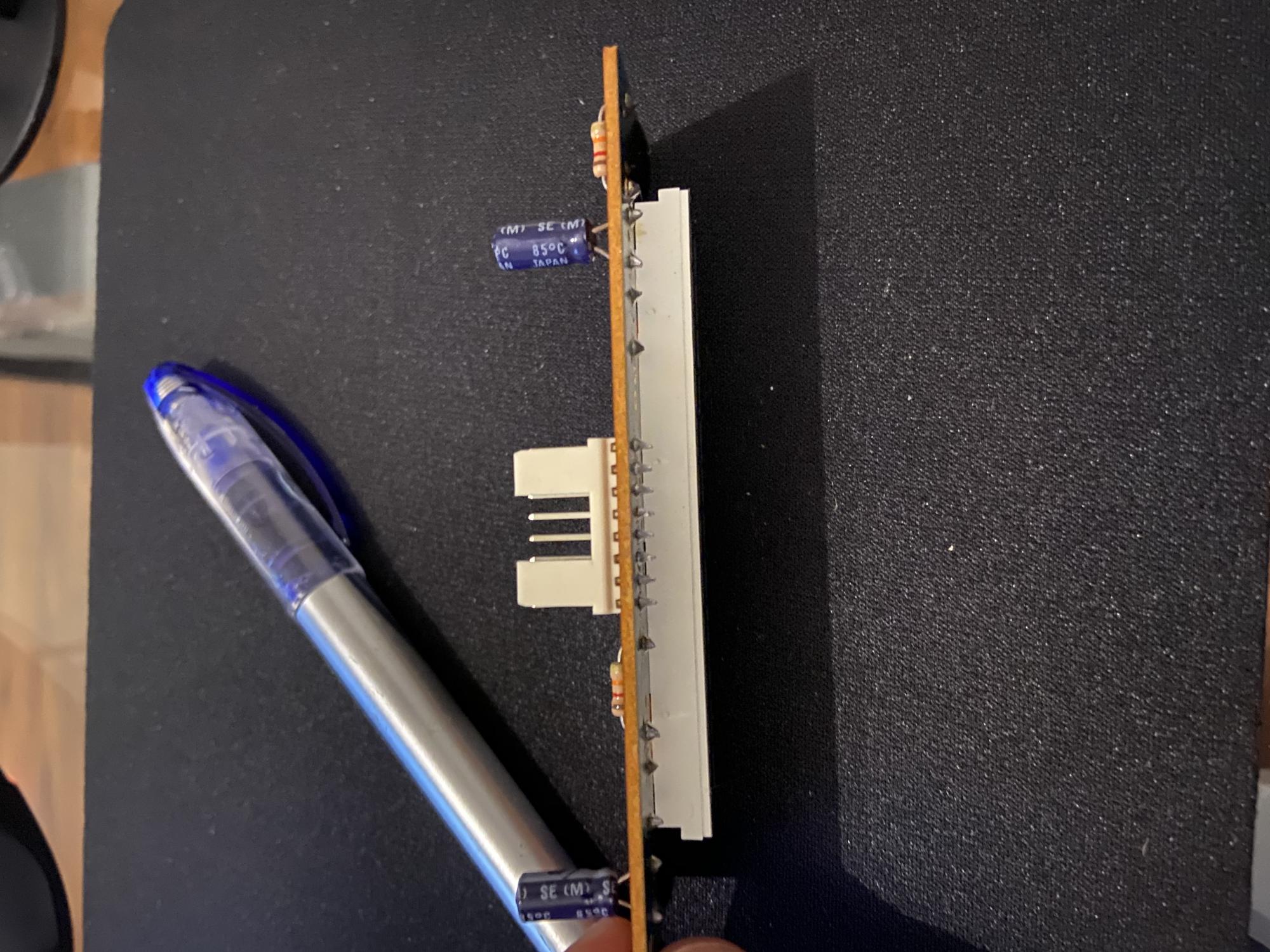

                                  https://www.badcaps.net/forum/attach...1&d=1597194394
                                  I wonder what you will see if you look straight from the side view.

                                    I tried flexing it. No joy.

                                      Cover came off easily after I used a razor blade to slice the white plastic tabs off the back.
