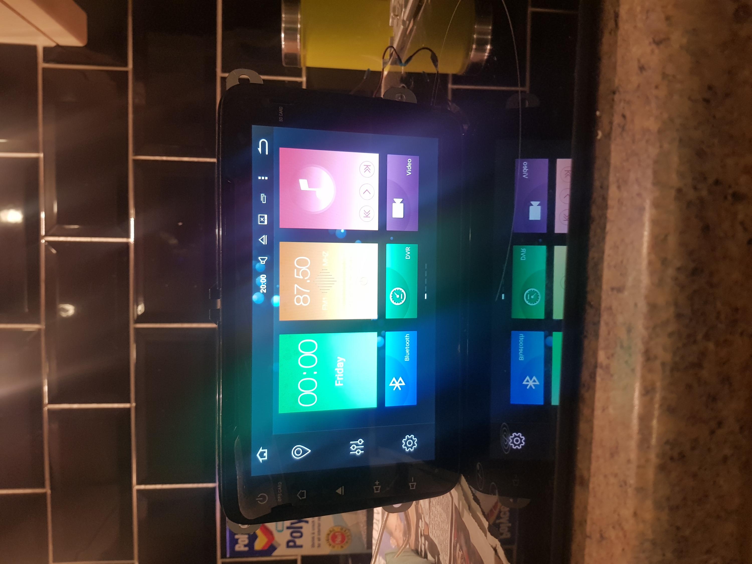

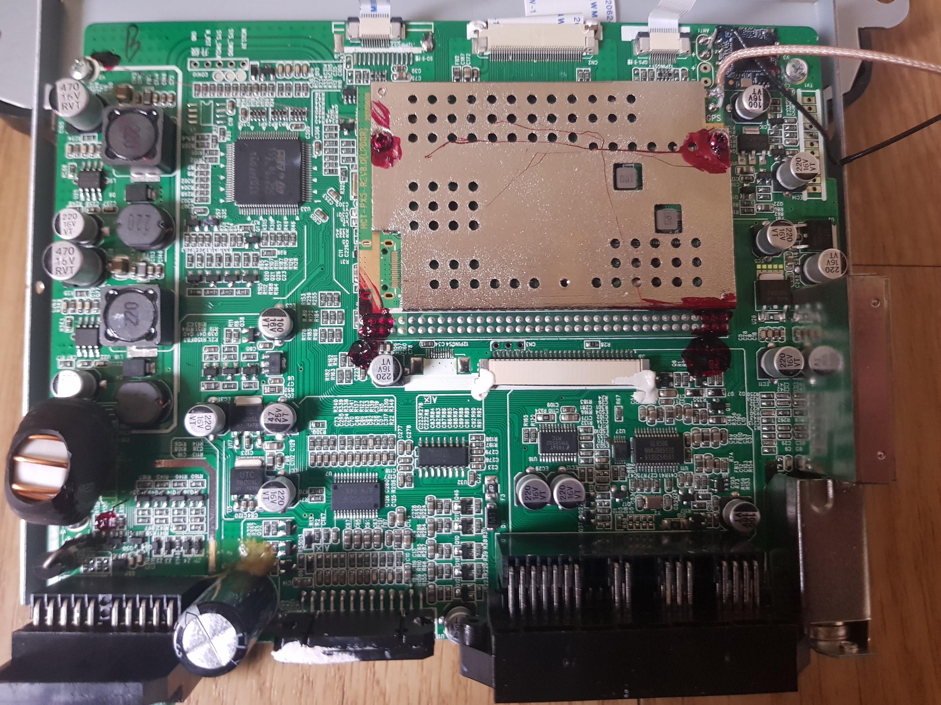

    Not something I have ever attempted before, but knowing I dabble with TVs, a friend of mine asked me to have a look at this for him.
    I dont know what brand it is, think its just some cheap chinese generic rubbish
    Someone has apparently bought it brand new, wired it up wrong somehow, blew fuse on unit, fuse in car, amd said it smoked slightly and could smell it.
    Replaced fuse, but no signs of life, is there anything I can do or is it just fit for the scrap?
    Wouldnt know where to start personally so any help grately appreciated.

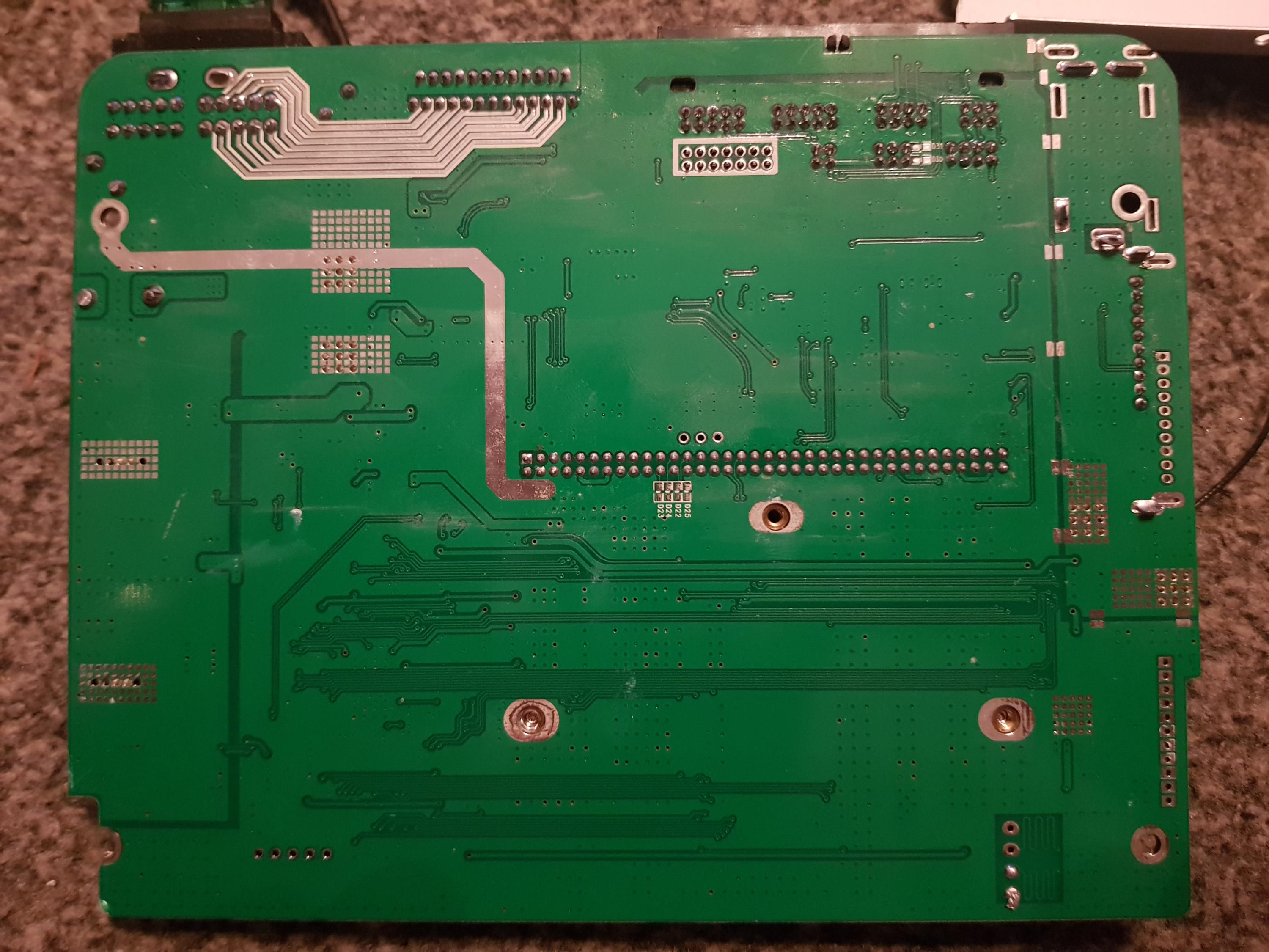

    Re: Double Din Car Headunit Brand Unknown
    have you removed the pcb and checked if there is any trace damage on the underside of the pcb

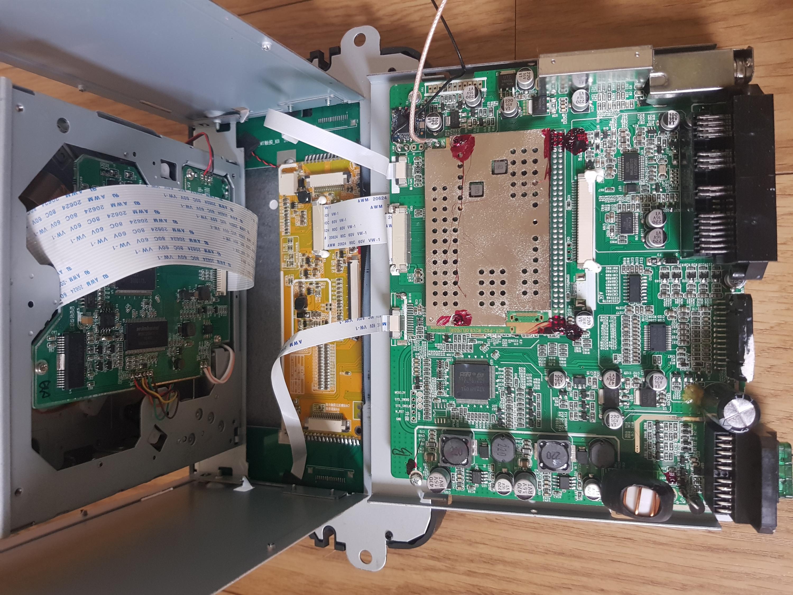

      I havnt mate as yet, all ive done is open it up to take pics, ill do that next and report back

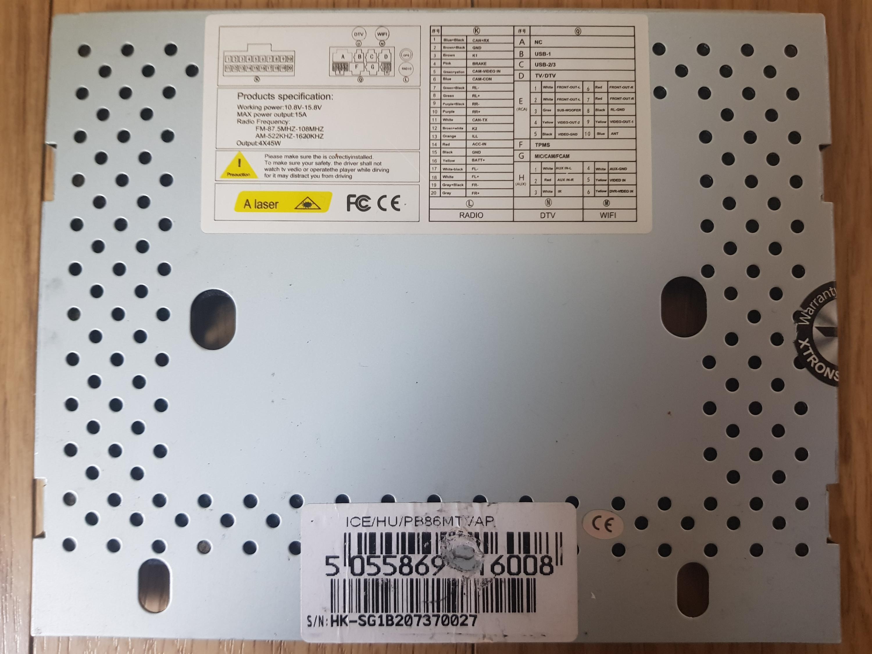

          Seems to be a Xtrons pb86mtvap, There is a diode D2? near the fuse, have you checked it? Check the resistance between ground and power input.

                Heres a pic of the underside, looks ok to me, but im no expert
                  yes underside looks fine time too check what r_j suggests now
                      Many times they use a diode across the 14 volt input for protection, If you supply reversed voltage, the diode conducts and blows the fuse, or in some cases the fuse will also short. You may get lucky and it's only a shorted diode.
                        Was exactly that, thankyou very much for your help, and to everyone who replied, much appreciated
