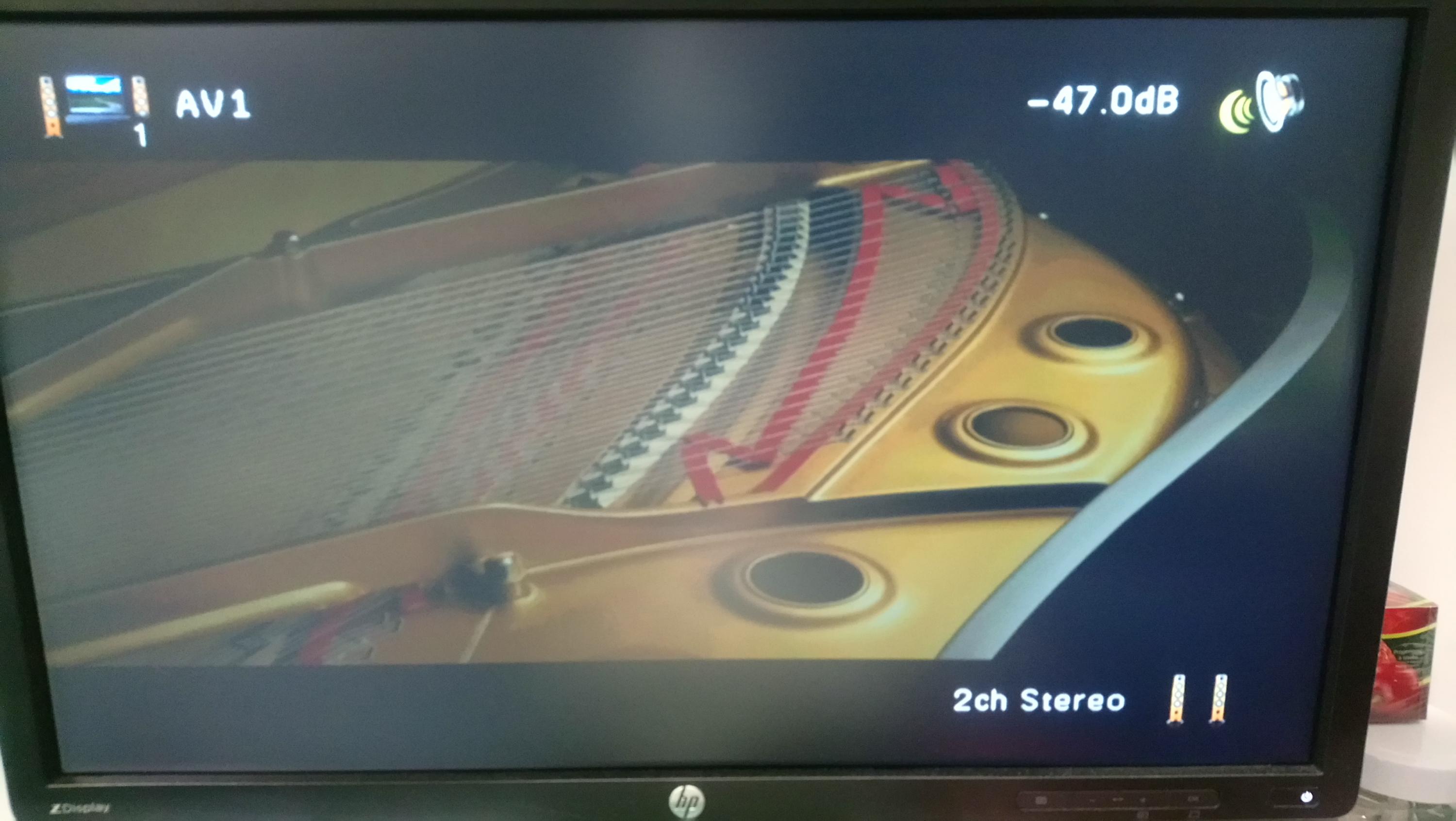

    This is gonna be a fun one, here we go.
    AVR powers up, displays menu over HDMI correctly, all settings work etc.
    I can switch the inputs and adjust the volume level, but none of the speakers will produce any sound whatsoever. Last time I came across such problem it was a faulty Texas DSP BGA chip but this AVR is much different in construction.
    Did anyone come across this issue? Where to go on with this? It has some really weird power stages as well, never seen that before on any AVR.

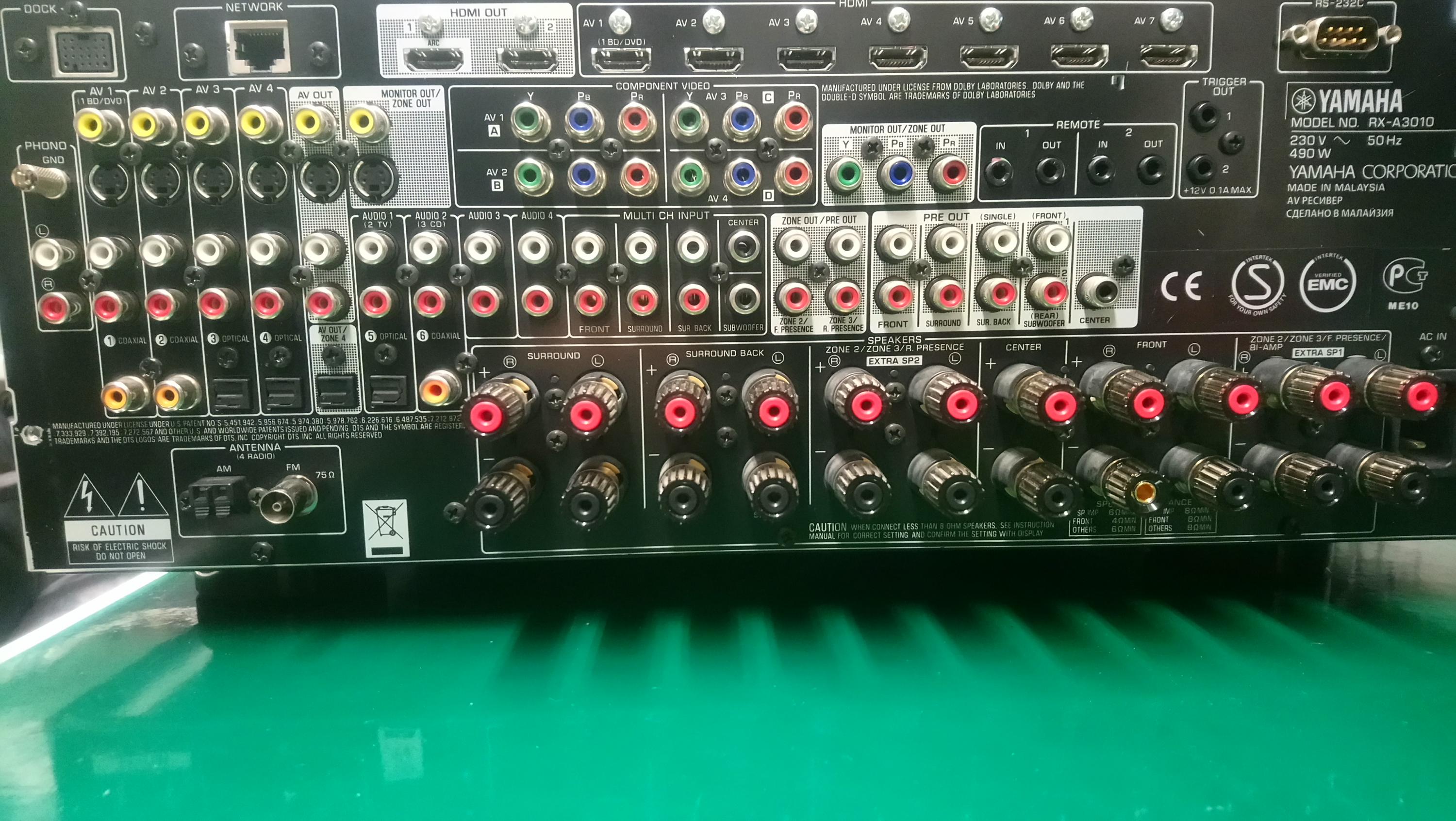

            Re: Yamaha RX-A3010 working, no sound output
            As suggested, do you hear the speaker protection relays click on about 5 seconds later after turning on the receiver?
            Do you get audio at the line out jacks?
            Pleas upload the pictures of the rear panel also.

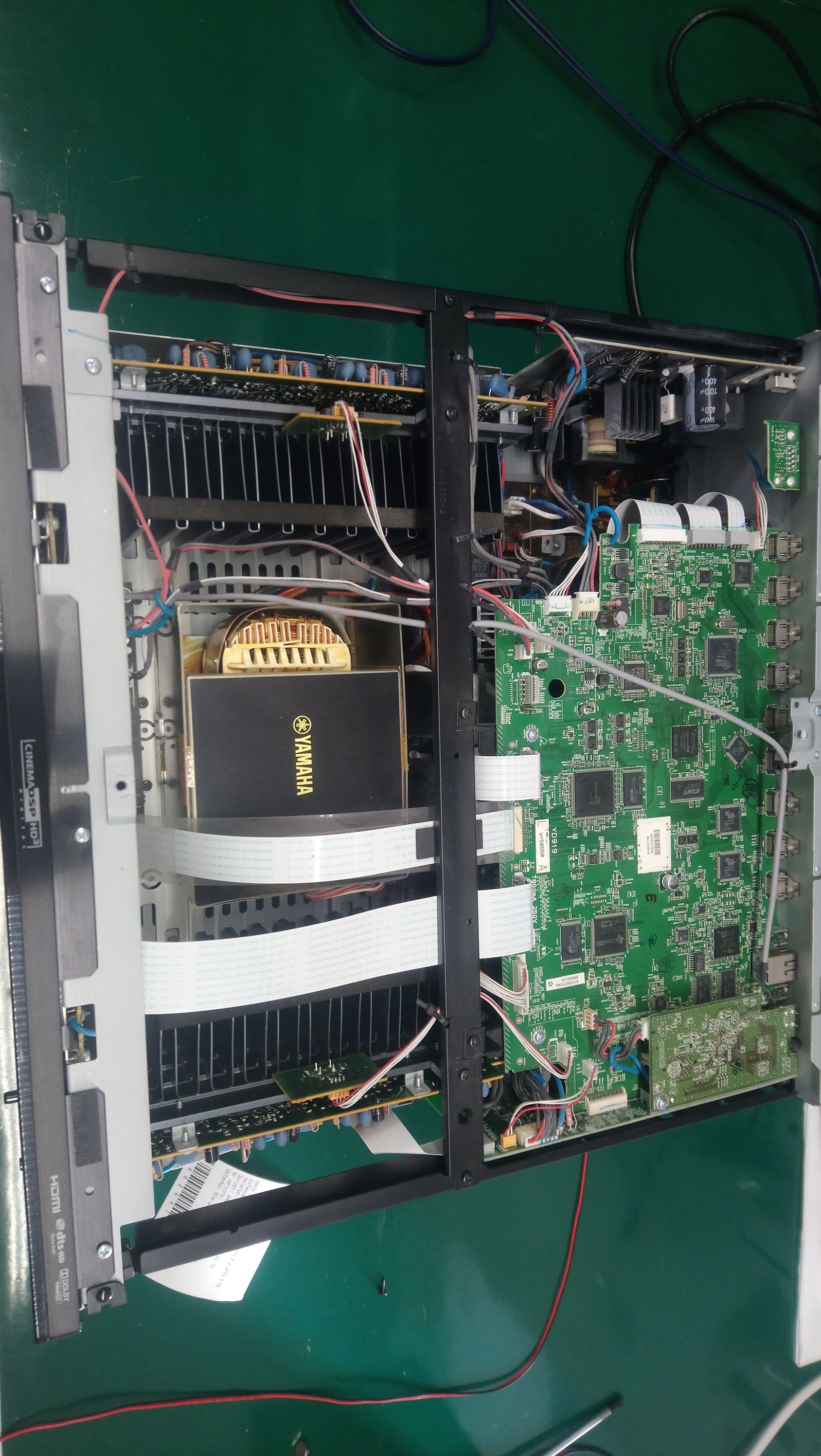

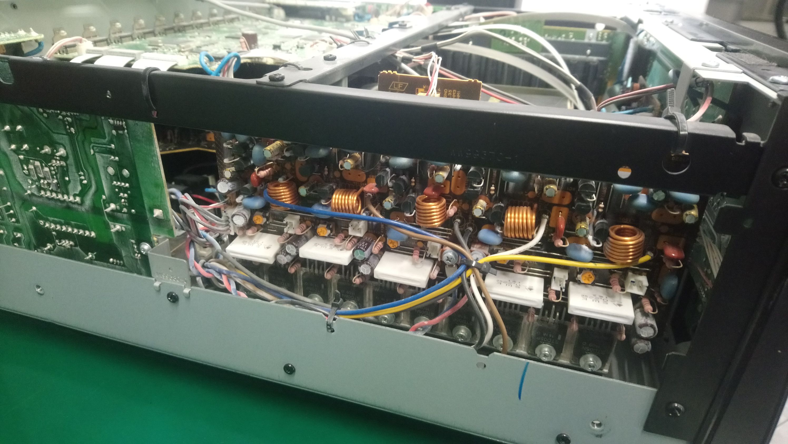

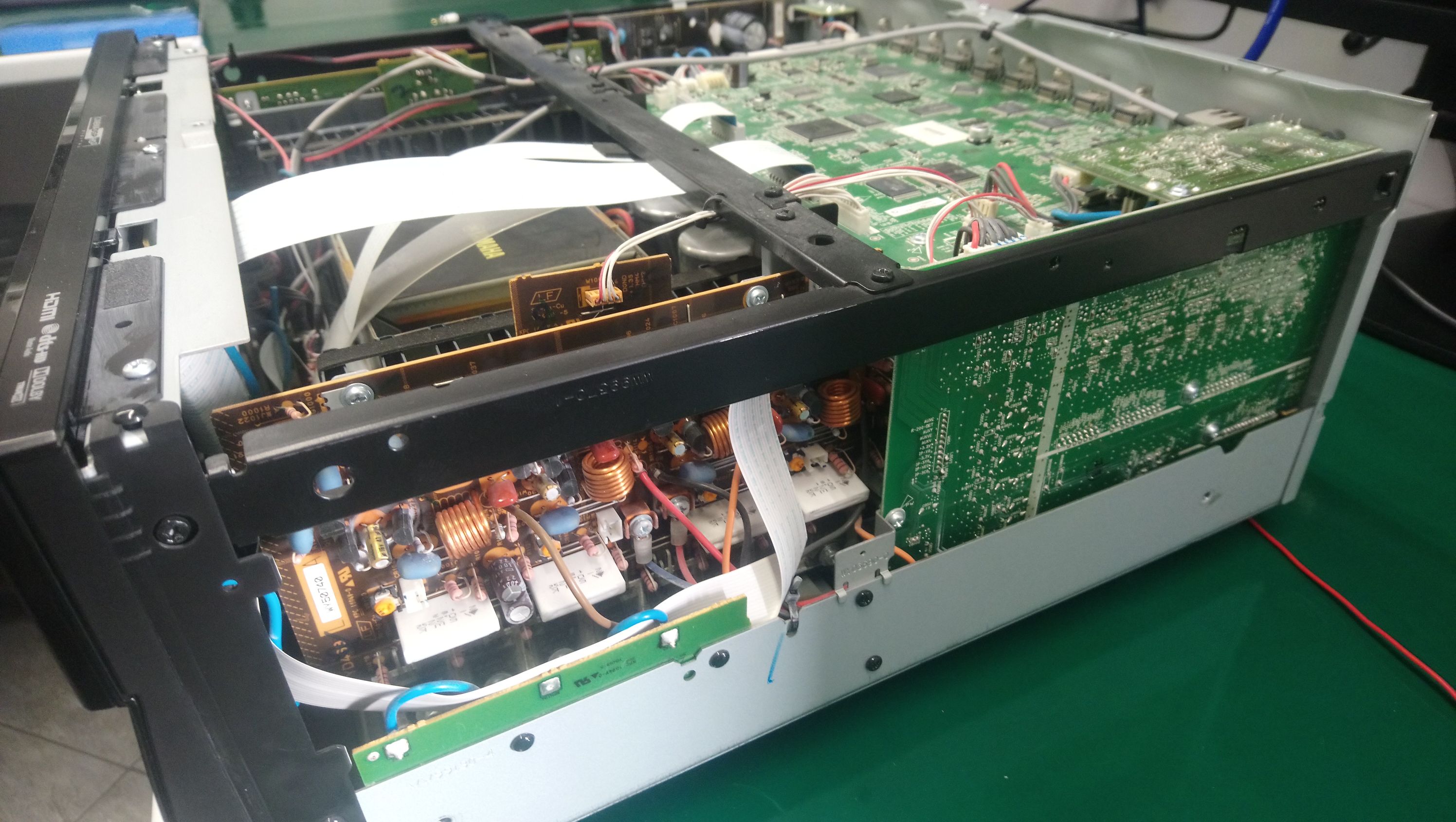

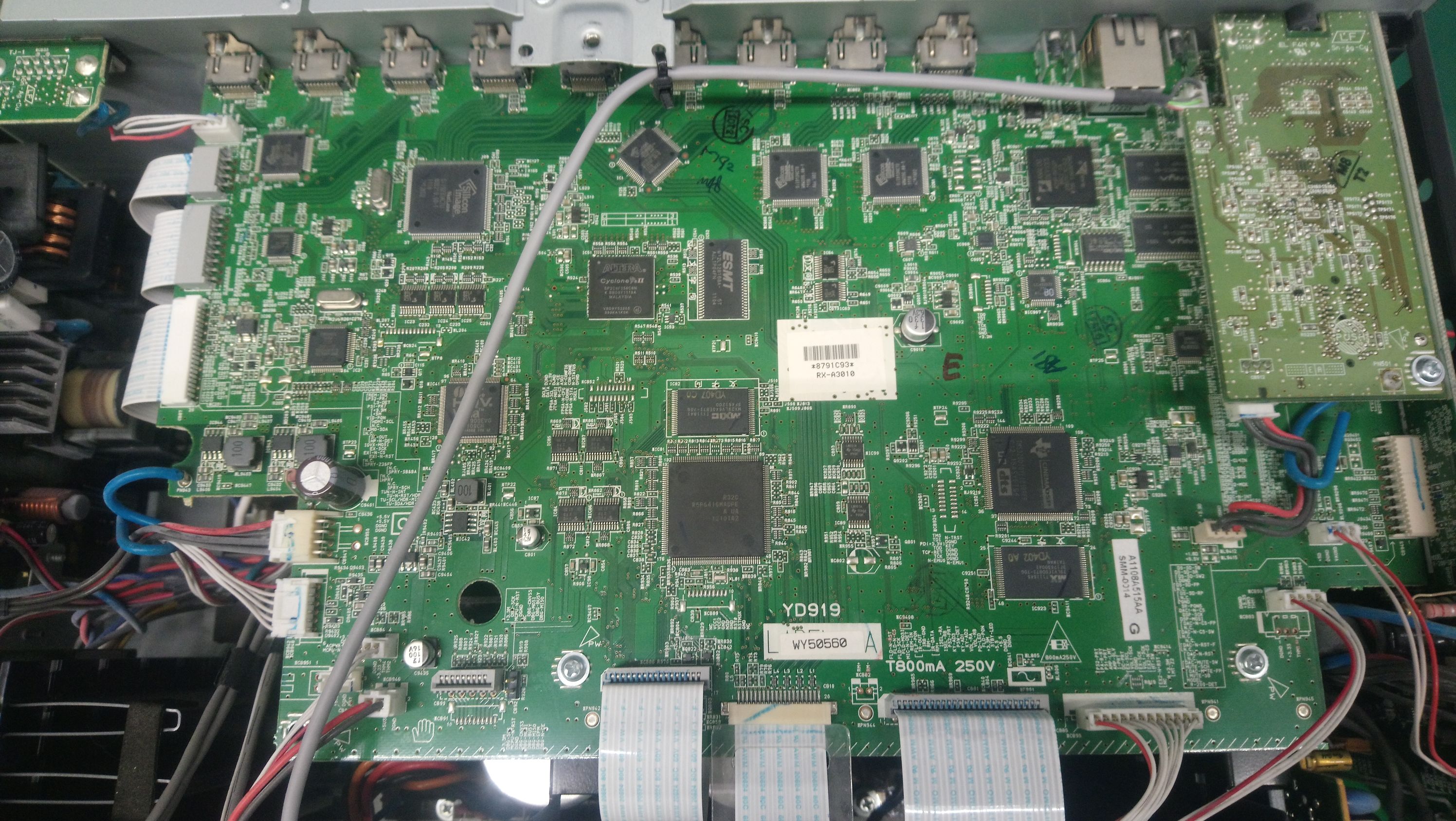

                  I sincerely apologize for not responding in such a long time, kinda abandoned the unit partially disassembled under the table. When it's turned on I can hear exactly 5 clicks. 3 clicks shortly upon powering on, then 2 clicks few seconds later (the ones for speakers I assume). Pure direct mode does not produce any sound either. This unit I find quite difficult to work with, packed tight and quite heavy.
                  I have checked bias voltage of all the output pairs, all of them have 10-15mV of bias at the calibration connectors, so the current between the pairs seems right. This appears like pre-amp / control section problem to me.
                  How could I safely inject it with direct audio to the amp section without destroying it any further? I really find this unit intimidating to repair, there are so many stacked "inner" boards with no access for any measurements.
                  Here you go:

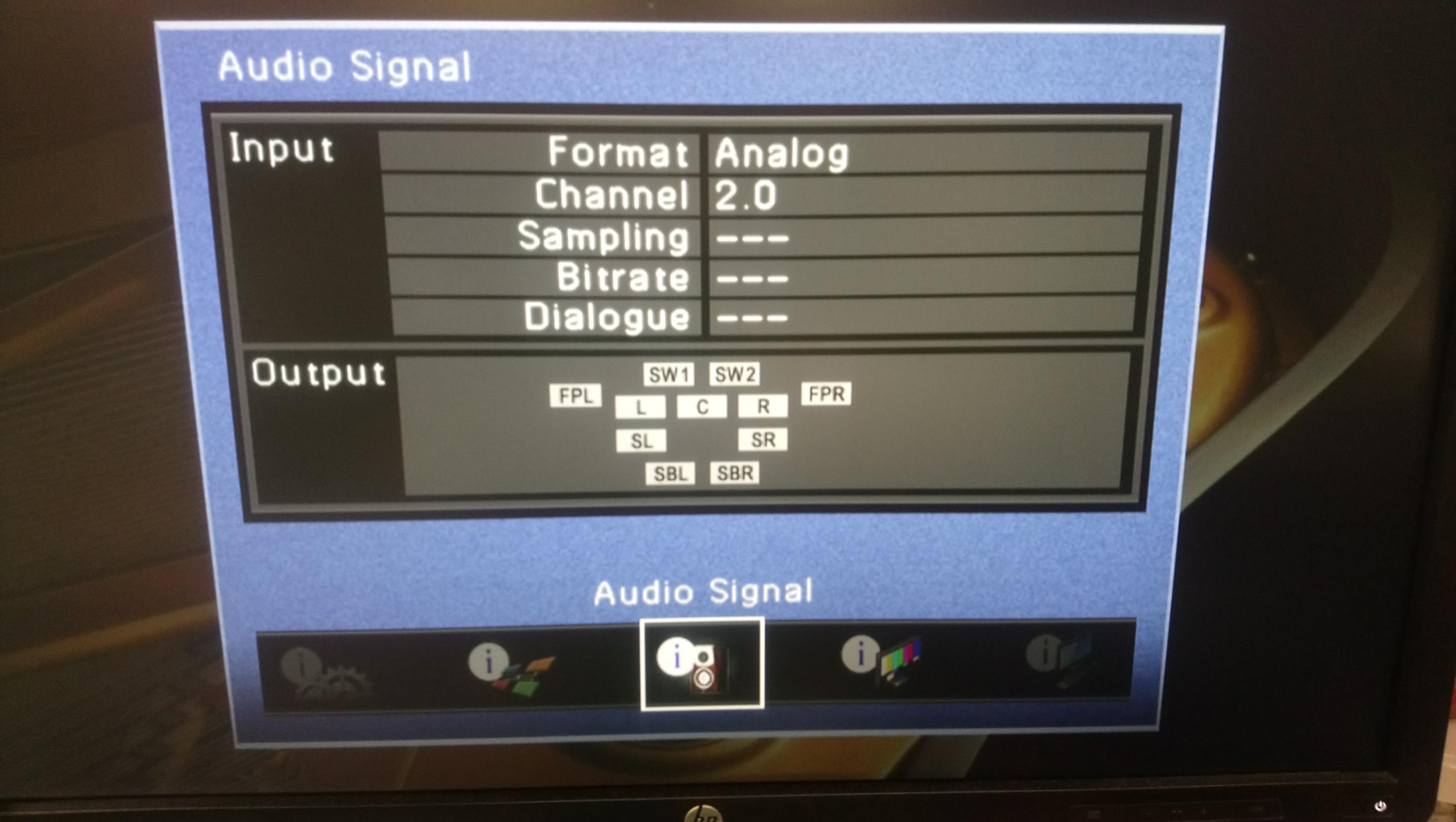

                    so what does the "status screen" display on the tv when you have a signal input. There is data about the type of input, bit rate, etc...

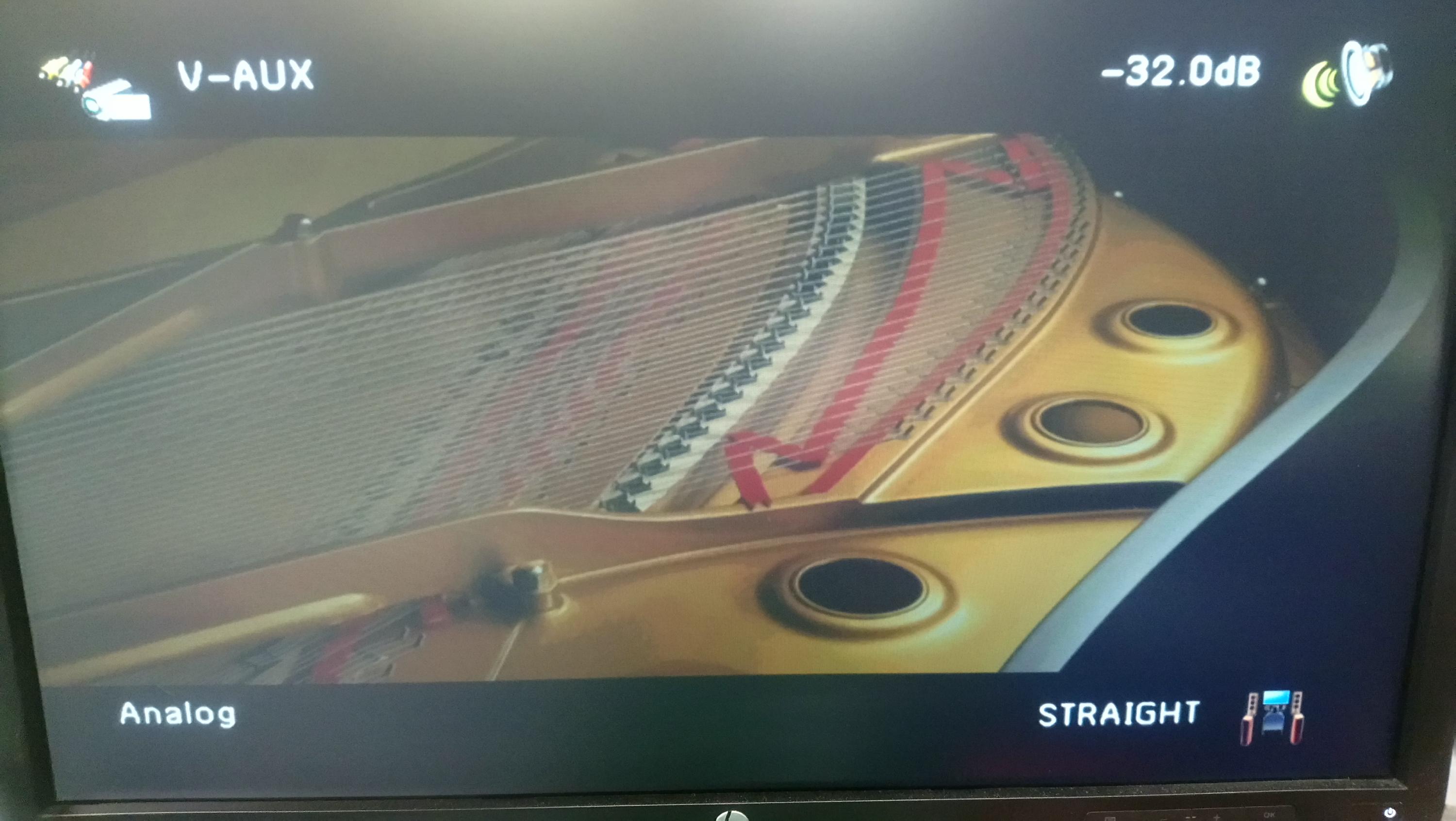

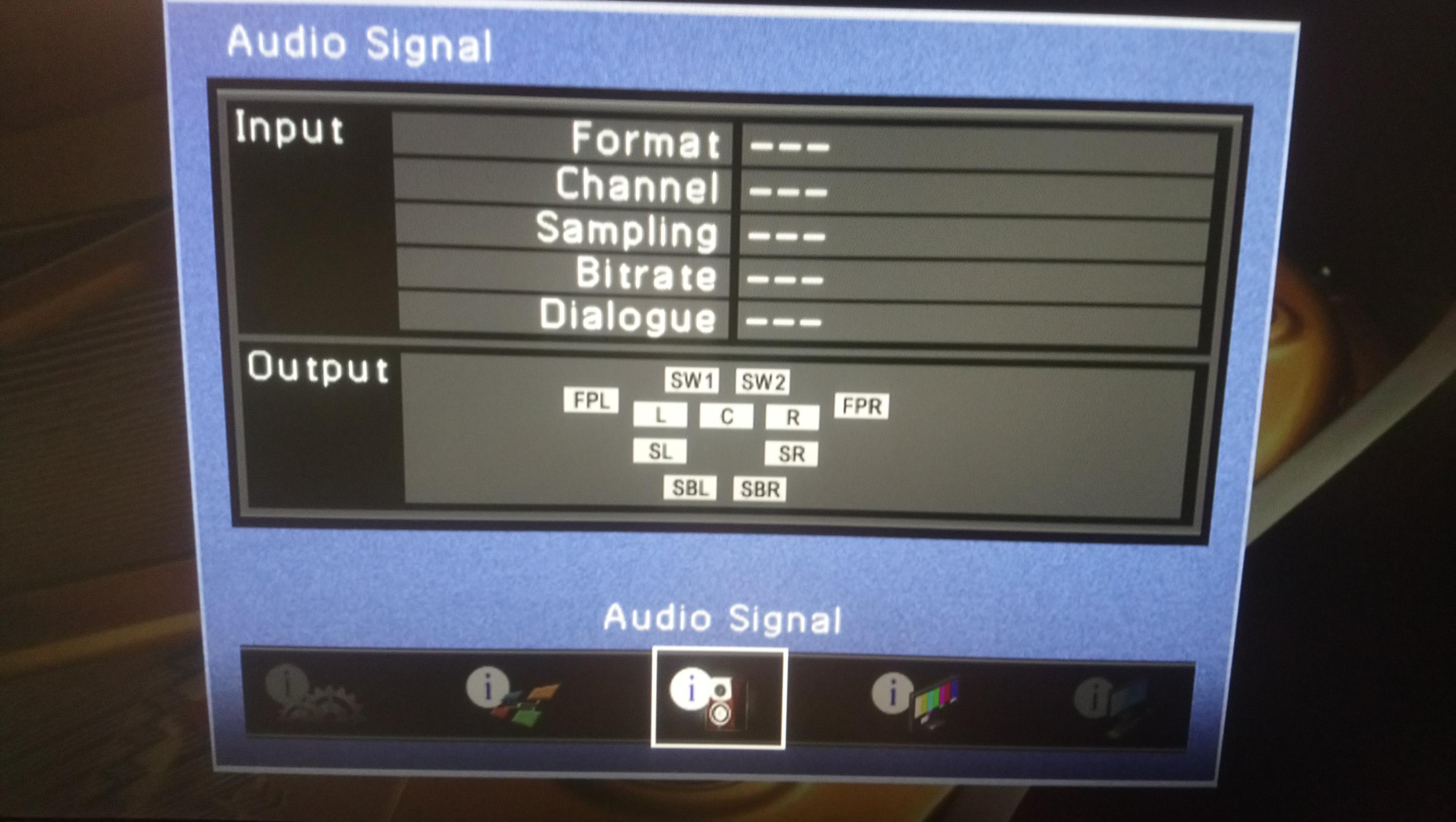

                      Is this what you're looking for? Images made while connected with analog stereo input via front RCA, playing stereo music into it.
                          somewhat yes..... although the analog input doesn't provide much detail. If you can, please try inputting a digital input (ie. dvd or bluray). This may check the front end decoding / signal detection / conversion. I haven't looked at the signal flows (especially associated with my a1010) as to whether all signals are digitized and then handled in the digital domain then finally output / converted to analog at the output stage.
                          Also, as suggested by the previous poster, does the speaker check / setup / test signal work?
                          Further, what comes out of the headphone jack? Does the unit indicate a change in terms plugging in or out of the headphone jack?

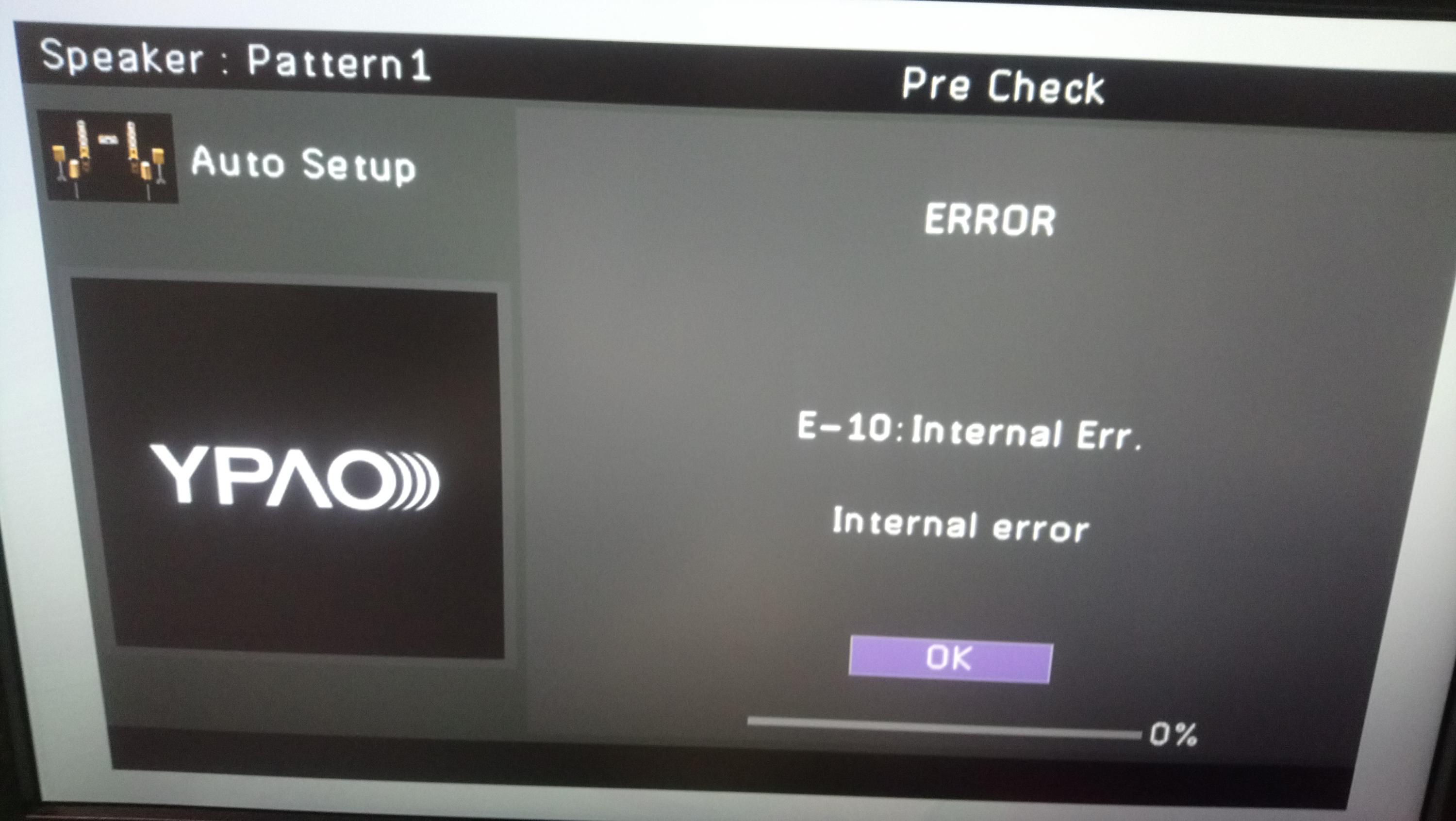

                                I've used coax input this time to test (known good source that actually works on my onkyo right now) and this was the result, to me it did not recognize it at all. I correctly switched it from analog to coax in setup of AV1 input.
                                Plugging in headphones results in relays switching, I assume speaker cutout. So it does recognize them, yet no sound from headphones.

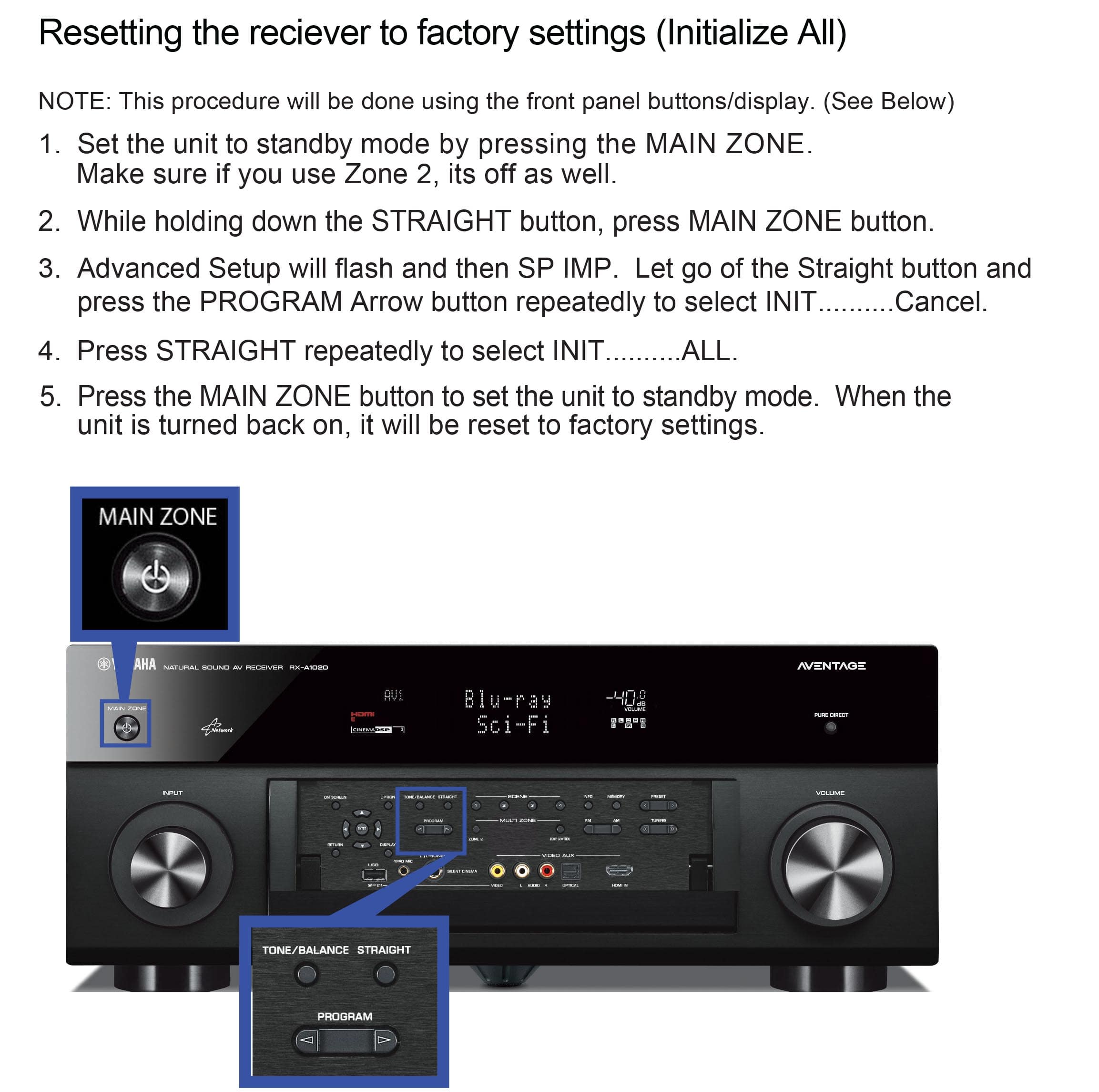

                                • R_J
                                  • Jun 2012
                                  • 9514
                                  Try this reset: this is for the RX-A1010 https://usa.yamaha.com/support/faq/a...sual/9441.html
                                  • FrozenHaxor
                                    • Jun 2015
                                    • 260
                                    • Poland
                                    Alright I will try that shortly

                                      hopefully a full reset will help. there isn't much to go on for the err10 other than an internal error but doesn't point to any specific area which would have been nice. Guess yamaha wants the service work.... :-) Your "coax" test is somewhat telling that the front end has issues (ie. pre processor)... again an hdmi input might be better as then your are dealing with a specific "standard" and you may be able to narrow down where that is on one of the boards. Further, the hdmi standard has things like "5v" associated with it that might point you closer depending on what the result is.
