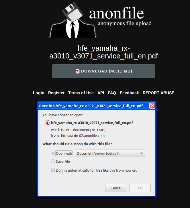

        anonafile wants to install virus's before you download anything.

          eventually, the link does down load a service manual but it certainly is disturbing to have to jump past so much "garbage".

            Sorry guys, I'm using strict adblock and do not see any internet shit.
            I tried uploading the manual on the forum, but no luck with the file size limit and thought this free file upload service was fine.
            I do not know if I'll be able to remove the link now, and just to stay safe - download the manual from here https://www.hifiengine.com/manual_li...rx-a3010.shtml ( requires free registration ).
            p.s. the edit option for the previous post has expired
            Here is what I got on the anonfile link when I click on the "download"... I was not aware there was spam, malware or garbage. Again, I'm sorry about that.
            And I highly suggest that everyone should have an adblock installed on all devices!

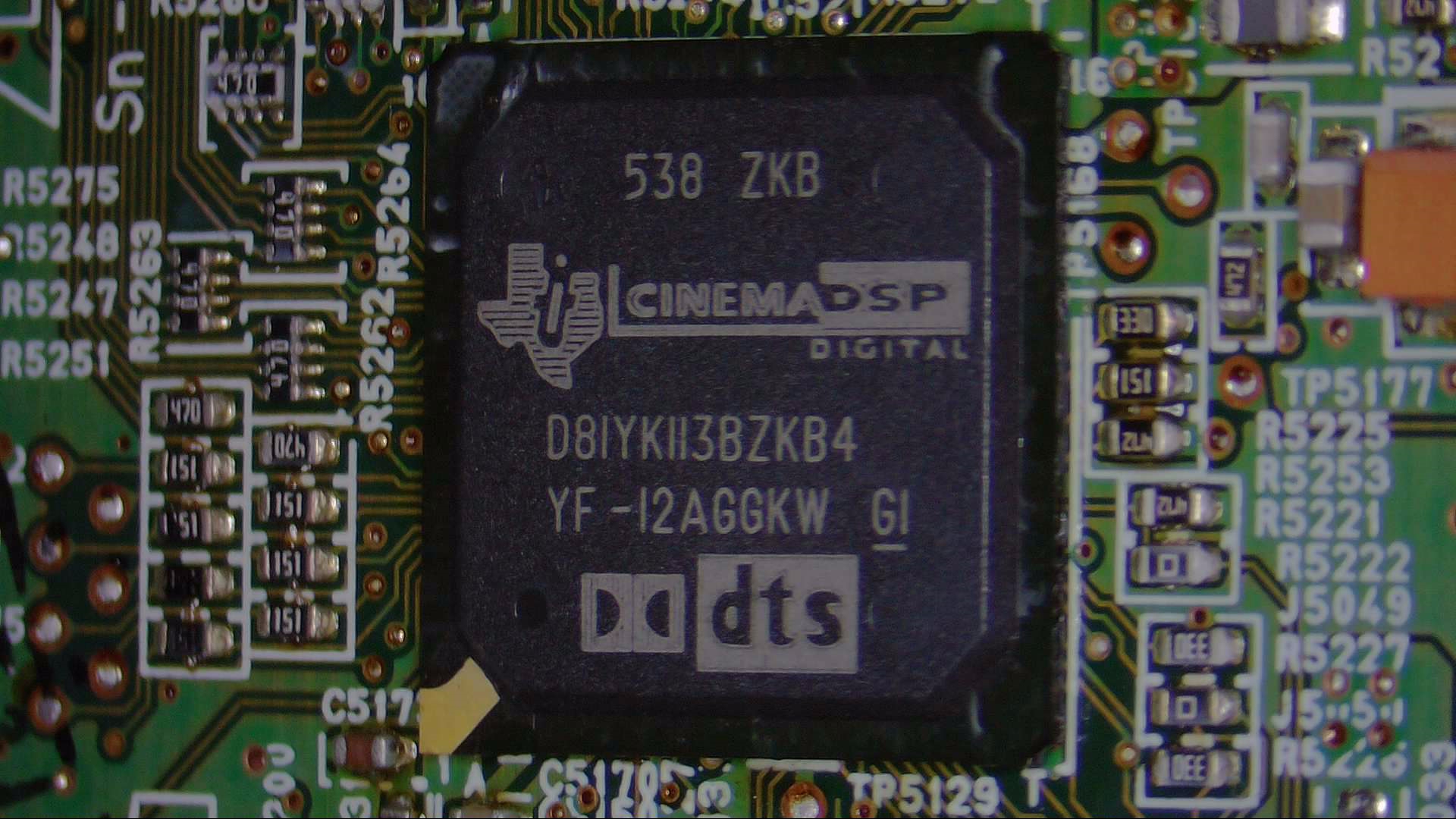

                        Is it a Texas Instruments ic ? Post a pic of it, there were revisions that were known to be bad.
                            Here is the list you have in mind - https://cdn.badcaps-static.com/pdfs/...12b2bc512f.pdf
                            a family of faulty DTS ( dsp ) ICs
                            The ops yamaha uses d81yk113bzkb which indeed is affected.

                                Here you go:

                                  Unfortunately, most likely the dts chip is a goner. If I remember correctly, it is possible to install a new chip without having to program it in advance.
                                  Damn, I thought Yamaha were not using that faulty dts... ONKYO used to have "extended" warranty due to that problem, but I haven't heard other makers to do that... still, if you have all the documentation ( original invoice and receipt I guess ) you can try to ask for a free repair due to the acknowledged faulty texas instruments chips.

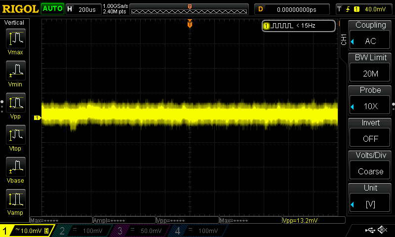

                                    What a fail with those chips, this is unbelievable. I don't think it's gonna be possible to buy a replacement since Texas only sells them to some "certified" manufacturers.
                                    Rails tested with a scope, ripple of 20 mV is present but the test method is not ideal, most of the noise is injected by ground clip here. Looks acceptable.

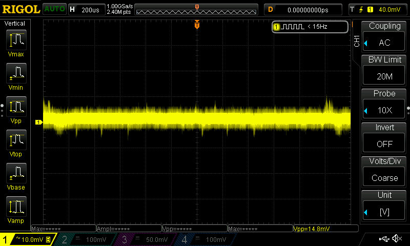

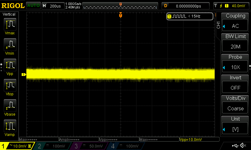

                                        Last test left a sour taste, wasn't done properly so I dug out the proper short ground spring probe ends and redid the noise tests. Main DSP rail has average of 10mVp-p of noise. The input rails to the board have no more than 12mVp-p either. Looks like this is not my problem. I think this chip is just dead.
                                        1,3V DSP supply
                                        3,3V board input rail
                                        1,8V board input rail
