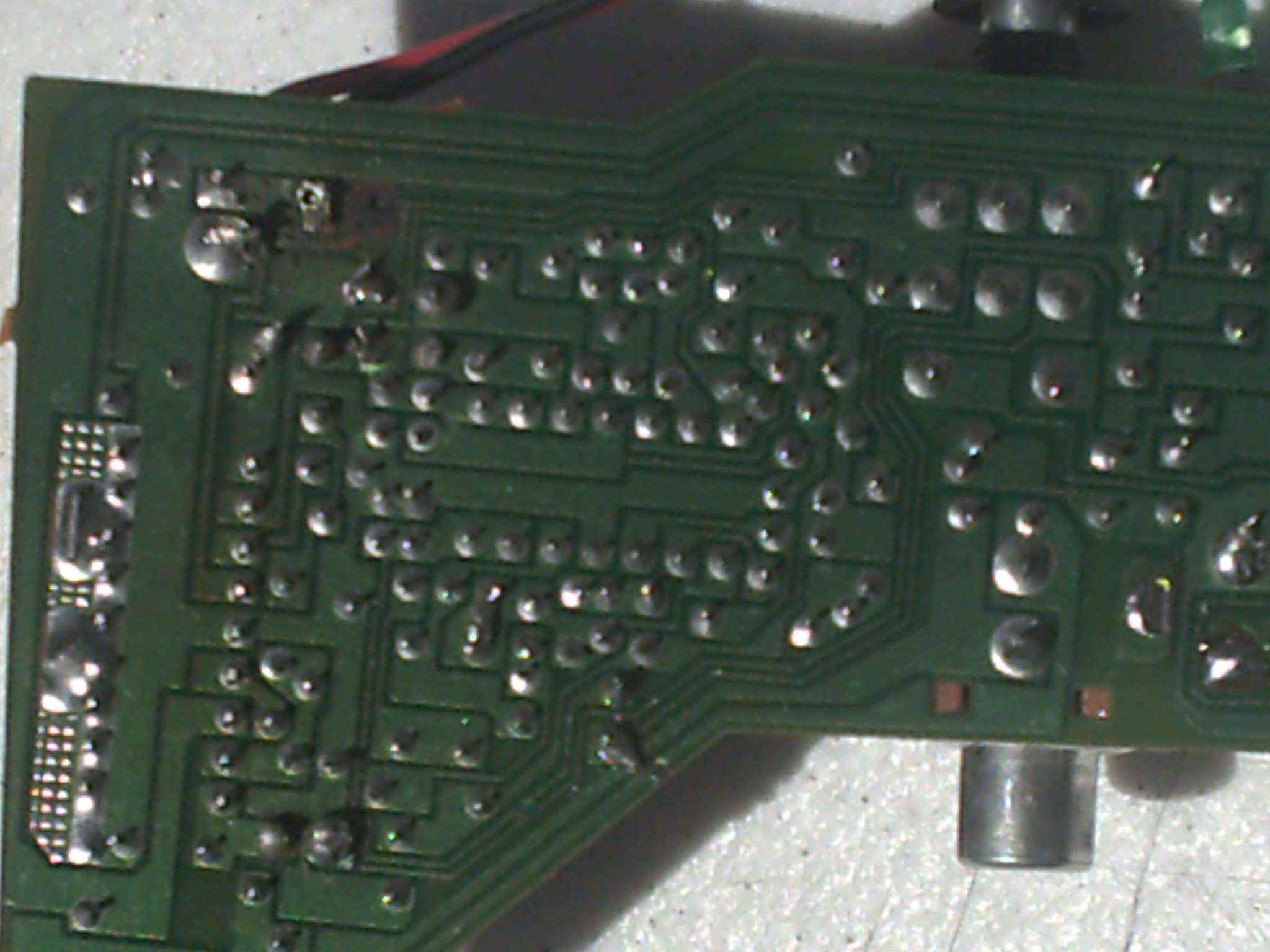

    Messed this up by trying to work on this small shit, lost patience and screwed it up, lifted these 2 pads. Do you think It can be fixed with copper tape, not sure how to attach or ?
    Yeah, should still be fixable fairly easily. No need for copper tape or anything exotic. Just use some wire or jumpers to connect the component on the other side. This is not FPGA, antenna, or some other high-frequency circuit, where changing the trace length/position will mess something up.
    • nomoresonys
      • Jan 2013
      • 12283
      • U.S.
      Re: Harmon Kardon HK206 PC speakers
      Thanks Momaka, I can't tell where I need to attach the wire, I think I need to scrape some green mask off to expose good copper but I can't tell where.

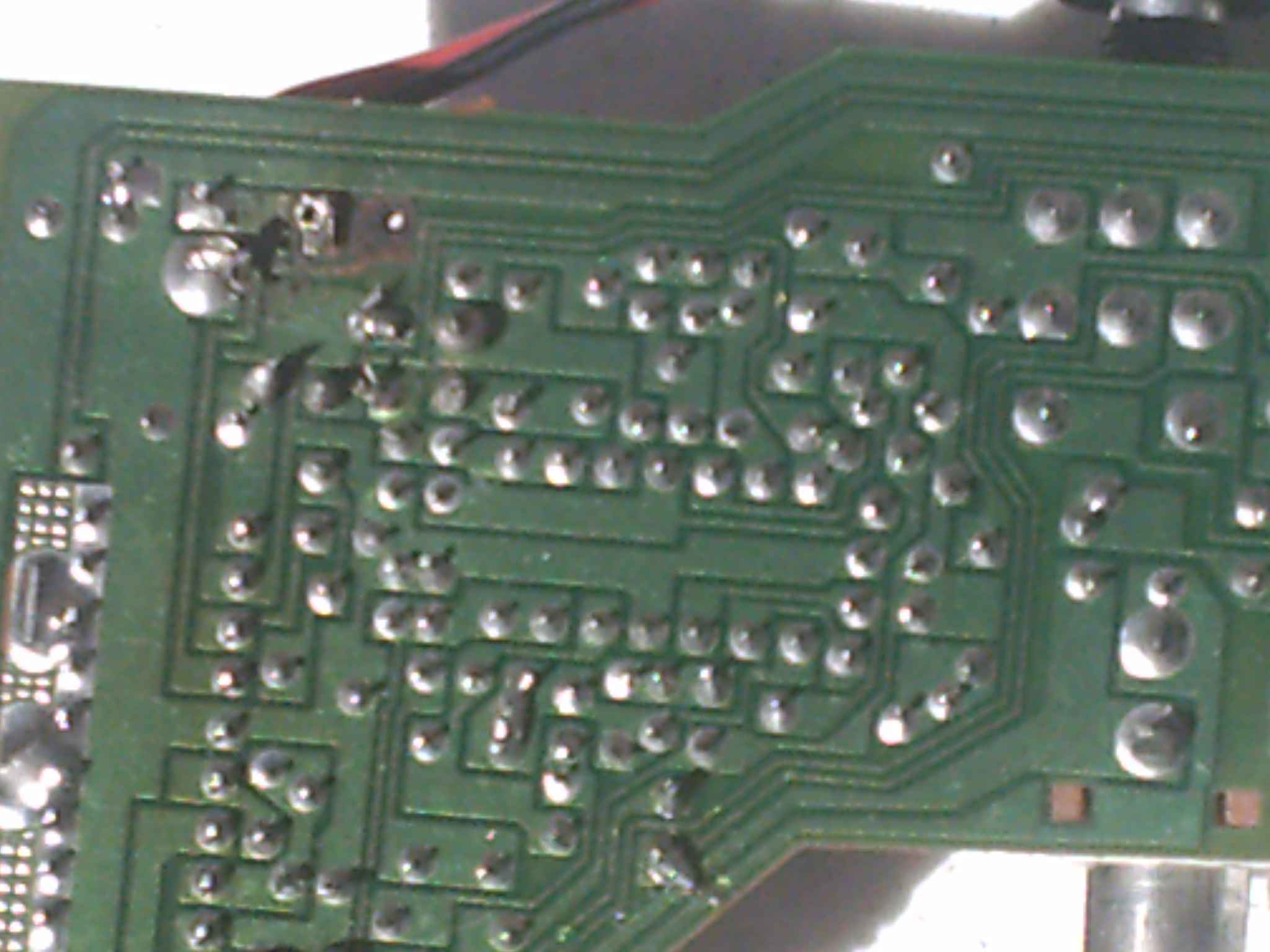

          It's right there post #20, the 2 circled pads are gone, my camera is down, I'll try to get a good picture with another one but it might not give good detail.

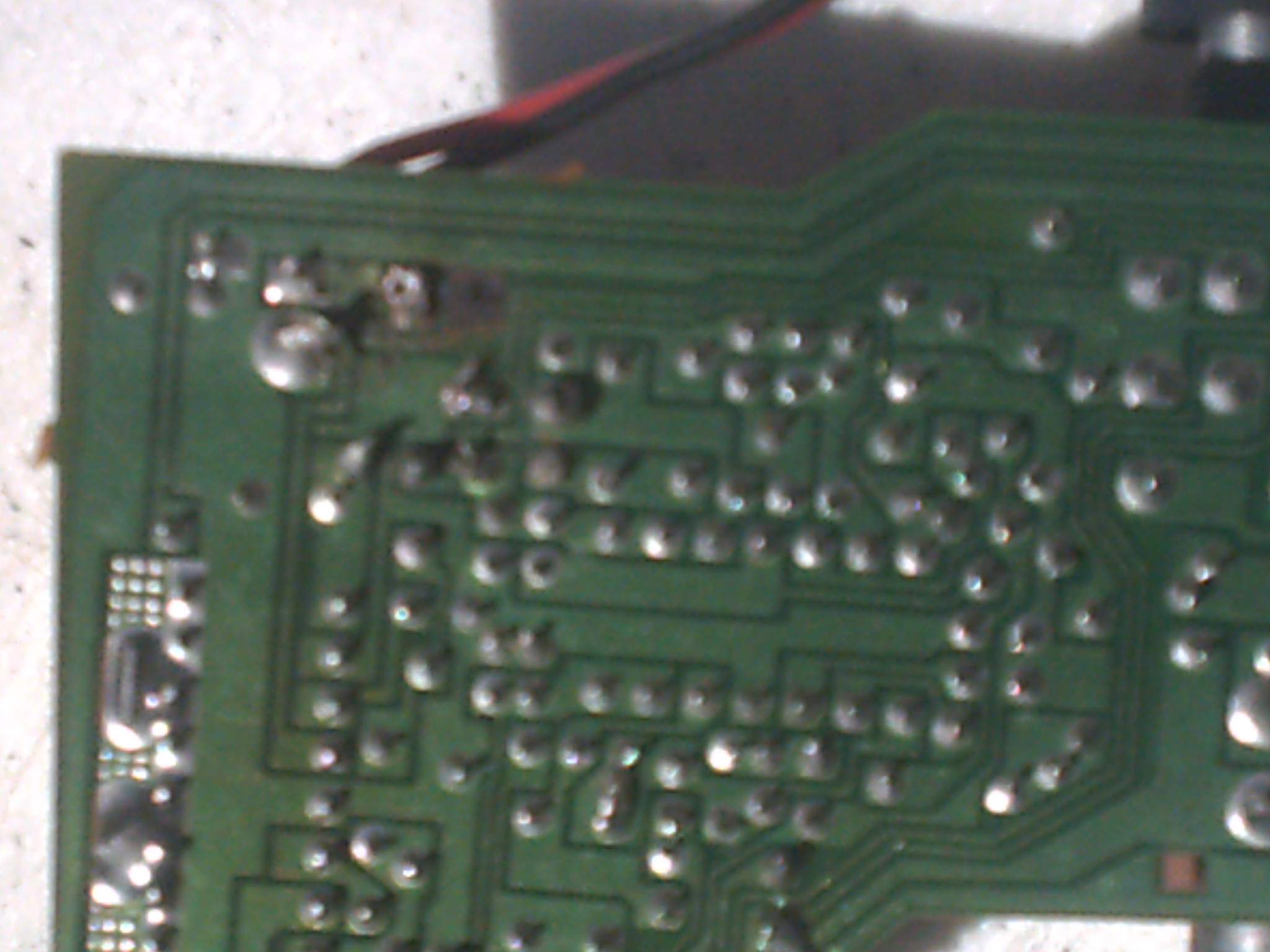

            Pictures:

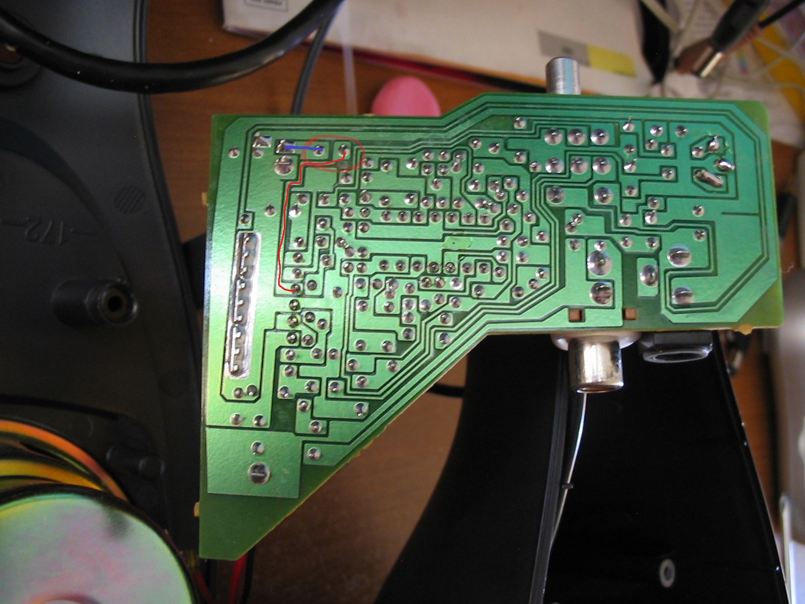

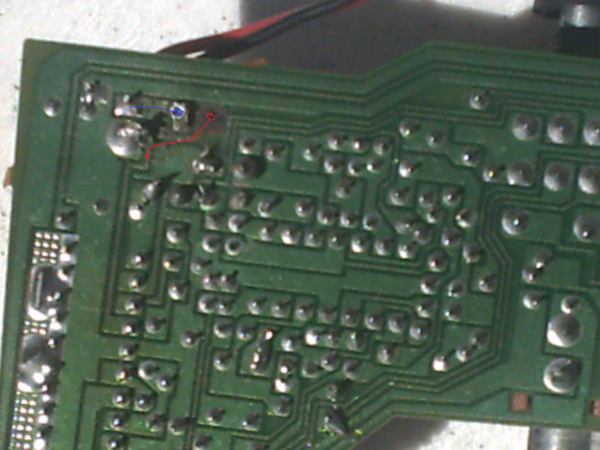

              Here you go, I've drawn on both diagrams to help you see where the jumpers/wires need to go.
              I'd solder a solid link directly the the leg of the other component for the left hand pad and a wire to the back of the other one. You can scratch the solder mask away off the thin track if you want but it's unnecessary work.
              You might need to hold the component down with a dab of hot glue/rtv silicone on the other side of the PCB.
                Ok, thanks, I'll try to undo the mess I made of this poor board.

                    #29
                    Finally got it fixed, a big thanks to Diff, Momaka and everyone for sharing the knowledge.
