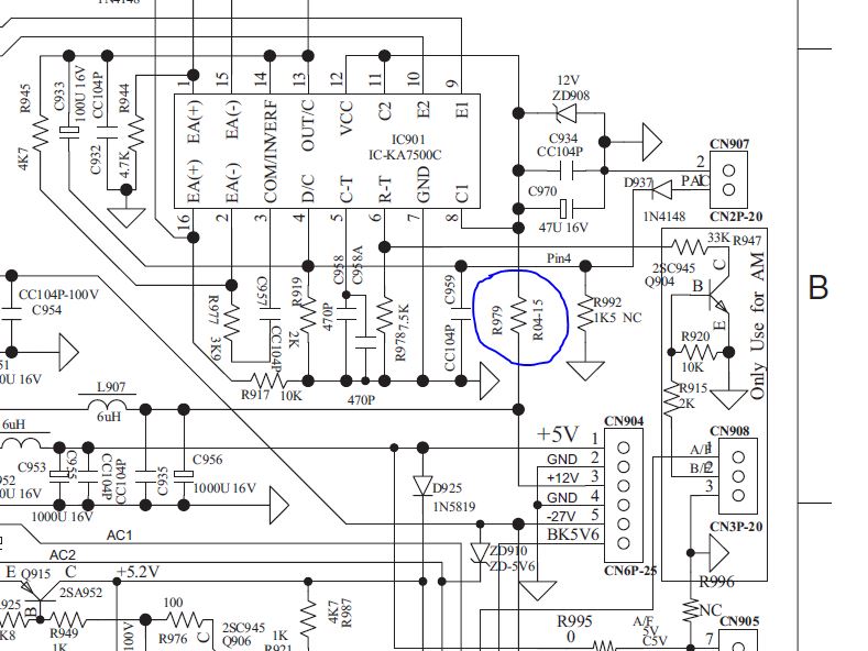

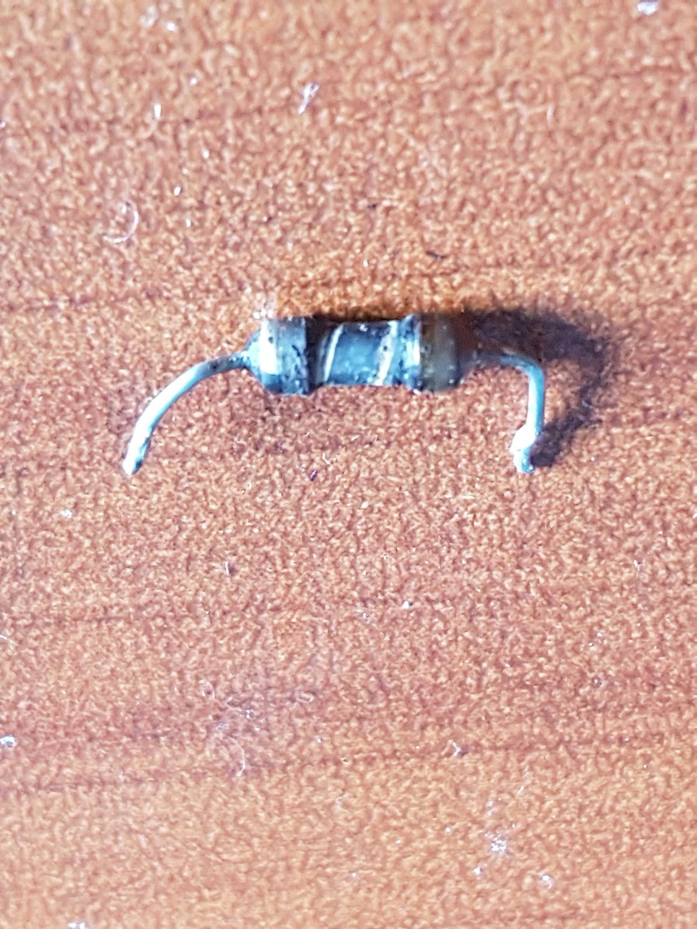

    Guys, im confused about this resistor. Its fully burned. I cant check the colors as well. When i checked service manual, this is what i see
    I check with parts vendor, even they dont know what value is this

    post more of the schematic and the fried resistor, maybe someone can deduce the value from context and what it looks like now.

      Also pictures of the board.

        Guys, heres the schematic diagram for HTS-3366 Phillips. The resistor part number is

          First guess would be 15Ξ© (brown, green, black, gold?), which does seem to correlate with the resistor having few spirals. Depending on the tuning of the SMPS, it may dissipate more than the ΒΌW that the resistor looks like it was rated for...

            Yes it has 2 spirals. 2 spirals usually is 10 ohms? I can see the resistor legs goes to pin 12V

              It is 15Ohm 1/2W

                  When I look at that schematic, the value of the resistor has to be low, but it isn't that critical, as the blown resistor is used as a fuse. I guess the zener diode may have shortened, causing the resistor to blow. 15 Ohm sounds about right to me.

                      How much higher Voltage? It has 12V zener on one side of the resistor so it should be within 12V on the Zener side.
                      What do you get on the 12V line feeding the resistor?

                        The voltage on the other side of the resistor can't be higher than 16V, and with good engineering practice wouldn't be much above 12V, even. I suspect that the zener was used for transient protection more than regulation.
                        Either way yes, a ΒΌW 15Ξ© maybe in the danger zone -- I only guessed this because of the physical appearance of the resistor with no ruler reference. A Β½W resistor is probably safe for most uses, and a 1W resistor will give you enough leeway for other things to burn first before the resistor burns again, that is, if the zener or other downstream devices don't short out...

                          Regarding the value... does the resistor show any resistance on your multimeter? Sometimes, resistors can get pretty cooked buy still read in spec. That's because most (quality) resistor can usually handle twice to 4 times their full rated power before burning out.

                            its a fuse .

                              It's a 15Ξ© 1/4 watt resistor, you can use 1/2 watt, Philips schematics have always been strange.
