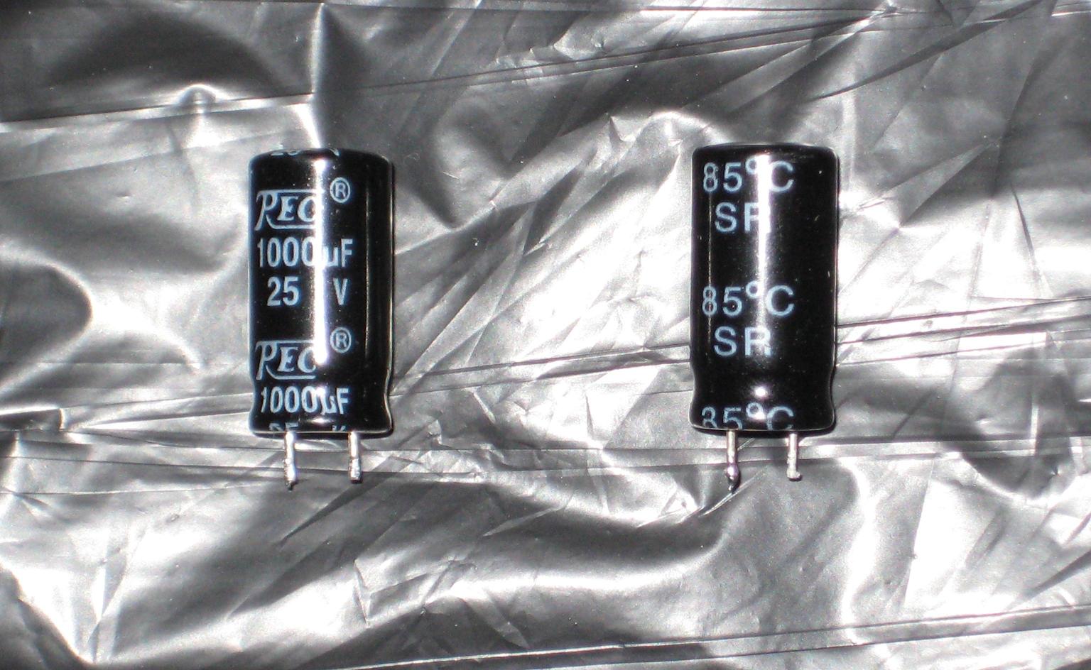

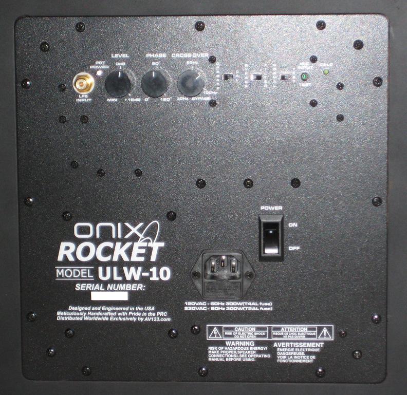

    I purchased the subwoofer 'Rocket ULW-10' around 2005 and recently was experiencing a humming noise coming from the sub. So I researched the problem on the internet and it was suggested on various forums that this could be a capacitor issue.

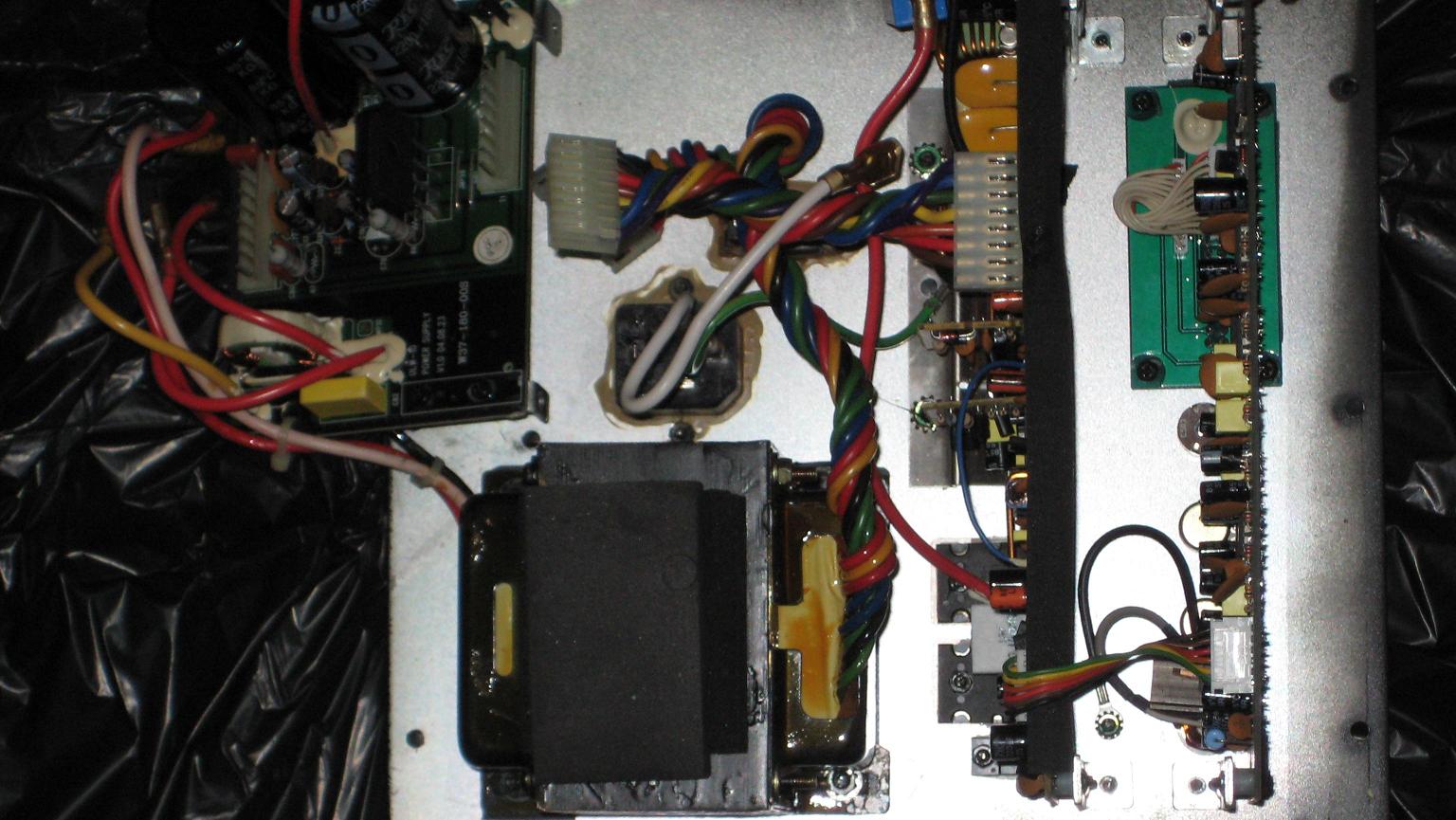

    After checking the audio source and for grounding issues, I then decided to open up the subwoofer plate amplifier. What I discovered was that 2 of the capacitors on the power supply board were blown.
    The 2 capacitors had the following specifications:
    'PEC' or 'REC' , SR , 1000uF , 25V , 85C
    Now I am assuming from looking at the power supply that it is a linear design and not switch mode design.
    What would be a good replacement for these capacitors ?

    Here's the datasheet, for someone more experienced than me on finding replacements.
    • atari
      • Mar 2009
      • 8
      Re: Subwoofer Power Supply Problem
      I had searched the internet and could not find any information on the capacitors. When I called technical support at Onix (subwoofer manufacturer), they did not know either and did not have the service manual since the sub was discontinued.
      So, thanks jpdoe for finding this information on the REC capacitors for me. I see in the data sheet that ripple current for my capacitors is 925mA, however it does not state what the esr values are for the capacitors. Should I be looking for low esr capacitors ?
      The subwoofer is a sealed design (non ported). Also, the plate amp does not have any vents, it fits inside the sub's cabinet in a sealed hard plastic box, isolating it from the speaker. Now I am concerned about the heat build up and I would like to know if its safe to stay with a 85C capacitor ?

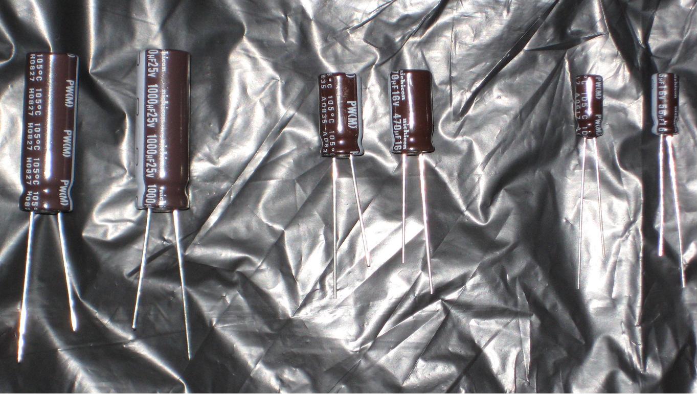

                  I am hoping that I will get an improvement in either the power or sound quality. Can you guys tell me which side the filter capacitors are on that I am replacing - primary or secondary. In a SMPS, I know the primary is connected to the AC power and secondary is next to ATX connectors, but on this linear PSU circuit it is not clear.
                  Now, if I replace the 85C caps with 105C caps then I should not need to make any holes for ventilation. As for the digikey link that toasty sent, the size of the capacitor has to be 10mm in diameter, the panasonic FM capacitors are 12.5mm.
                  Today, I searched digikey and mouser and these are the capacitors that I found that were above the original capacitor specifications.
                  REC , SR , 1000uF , 25V , 85C , 925mA , 10x20mm
                  1. Nichicon UPW1E102MPD6 (1000uF , 25V , 105C , 1815mA)
                  2. Nichicon UHE1E102MPD (1000uF , 25V , 105C , 1910mA)
                  3. Chemicon ELXZ250ELL470MEB5D (1000uF , 25V , 105C , 1690mA)
                  Also, would I get an increase in amplifier performance if i replaced all the capacitors except the 2 large caps in the PSU with capacitors of a higher capacitance and ripple value ?
                  • PCBONEZ
                    Grumpy Old Fart
                    • Aug 2005
                    • 10661
                    Any of your selections are good.
                    There is also an FC that matches PW exactly. (EEUFC1E102L)
                    My choice for an unvented PSU would be the PW or the FC.
                    It depends on what you mean by 'performance'.
                    You aren't going to get more power by replacing filter caps but you just might get rid of that AC hum.
                    By cleaning up the power you might also be able to 'crank it' a little more before the quality goes to crud.

                        I looked at the PSU board again and the other 4 small capacitors are all 85c made by TREC - Transcend Electrolytic(Shenzhen)Co.,Ltd.
                        (2X) REC , SR , 47uF , 16V , 85C , 124mA , 5x11mm
                        (2X) REC , SR , 470uF , 16V , 85C , 440mA , 8x12mm
                        (2X) REC , SR , 1000uF , 25V , 85C , 925mA , 10x20mm
                        It was late at night when I went through all the data sheets and I was looking for replacements for all the other caps listed above. Those data sheets can make you go crazy with all those rows and columns, thanks for catching the error.
                        I think I will replace all 6 capacitors on the PSU board since they are all 85C. The PW series that pcbonez suggested looks good, and hopefully they will last much longer than the orginal chinese caps.
                        Thanks guys for all your help.

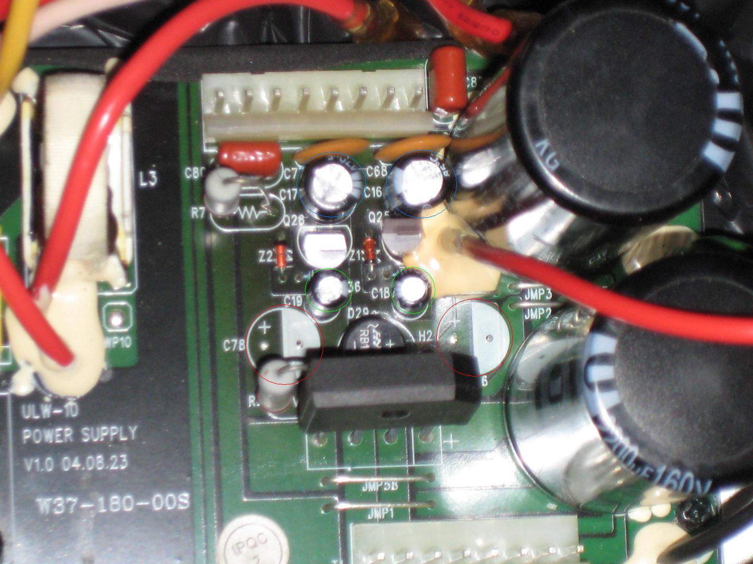

                                  I just finished replacing all 6 capacitors on the PSU circuit board. All TREC caps were changed to Nichicon caps. The only problem encountered, was that the solder pump could not fit to clear the some of the capacitor holes, so I had to use the method suggested on this site of using a steel needle.
                                  The picture of the power supply shows which capacitors were changed, all 6 are circled. The capacitors with red circles were the blown caps, the caps with red and blue circles were fine.
                                  After testing the subwoofer for 2 hours with music, it is clear that the background hum is completely gone. Now the bass sounded good even when the volume was cranked to 3/4 on the dial, however it is hard to say whether the new capacitors with higher ripple current made a difference. The other thing I noticed with the subwoofer after 2 hours was that the plate amp shown in the photo was extremely warm to the touch.
                                      The amp will get warm to the touch because it is conducting heat through the plate. Since it is a sealed unit, that plate also helps dissipate the heat.
                                      Since you are using 105c low ESR caps, they should not blow because if overheating issues like the 85c have blown. I have a Yamaha sub that does the same thing. It should only heat up when you are playing music and pushing watts out of the sub.
