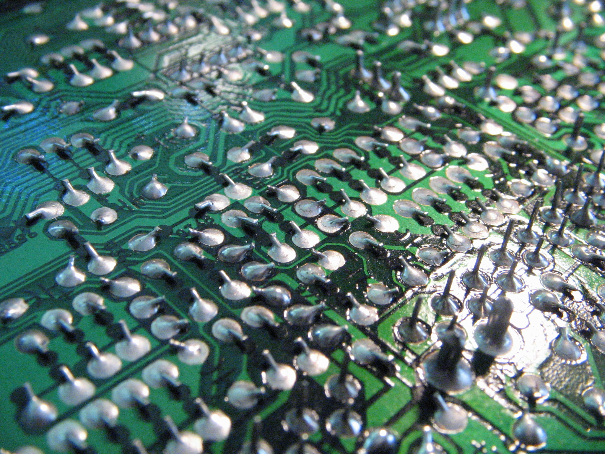

    You need to inspect the joints carefully, or just reflow the lot in that area.
    Take a careful look at the joints in the center of the attached photo, from my STR-DE545.
    You should be able to see the cracks around the joints, halfway up. I reflowed all which looked suspicious, adding a touch more solder to each one to give some fresh flux. Most were around the main power ICs which generate a fair bit of heat. If that does not fix it, you may have a faulty component instead.
    -David VanHorn

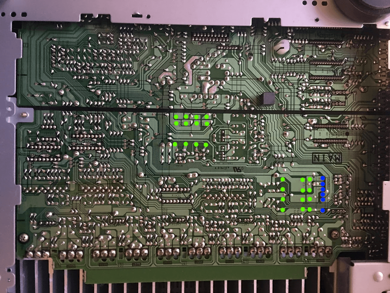

                Originally posted by Furball
                Result
                4mins work with the soldering iron and job done, all points can be got at via the removeable panel underneath.
                It took longer to disconnect and remove the amp from the AV rack than it did to solder up the relays
                So far its been running for about 20mins and hasnt clicked or dropped a channel once so recon its cured, also the centre speaker output quality has improved by 50% at least, I just hadnt realised how bad it had got
                Many thanks to Ethan and the others who have contributed and for anyone else with the same problem heres a pic of the underside of the amp with the relay points that need touching up in RED, the YELLOW dots are a set of connectors that I also touched up as they looked a bit rough.
                I've also added it as an attachment just incase the host of the above drops out
                Right time for a film I recon
                Furball

                        Thanks for the pointers, peeps! My STR-DB940 would work fine for the first 5 to 10 minutes, but would then "click" and the front channels would just stop working.
                        I used Furball's and Ethan McF's images to solder the 16 legs.
                        I turned it over, opened up the bottom side. The solder joints didn't look bad at all, but I thought: "It's going to take 5 minutes, so it's worth a shot". (It took about 15 ).
                        Anyway, I must say, I really didn't think I knew what I was doing or that it was going to solve the problem, but I put a bit of tin on each of the legs (tried to get the tin solidify at the base of the legs as much as possible). And as it turns out, it works! I haven't had the front speakers fail on me yet, after a week. So again, thanks!
                        tl;dr: front speakers often stopped working, I put tin on the base of the 16 legs and it's been playing perfectly for over a week now.

                          Dear Furball,
                          I just wanted to tell you what a huge help you have been, I love this Receiver and the issue was multiple ticking and center channel intermittently dropping out cold, I was elated to have it back and working.
                          A Couple of pointers: I invited a friend who is an electronics engineer, and he did the soldering. What he taught me is to be very delicate with the soldering and that it doesn't matter if the points looked ok, because in the beginning he was reluctant to re-solder the points. Secondly, he used a bright reading lamp and a magnifying glass to solder. So a few beers later.. happy chappy I am ..again.. HUGE thanks for helping me repair and enjoy my STR-DB9-940-QS :-) hope to catch you one day for a beer!

                                    Thanks for the picture and all of your information! This weekend I have pulled my STR DB940 apart and touched up the solder joints as mentioned. My relay is now quit again!
