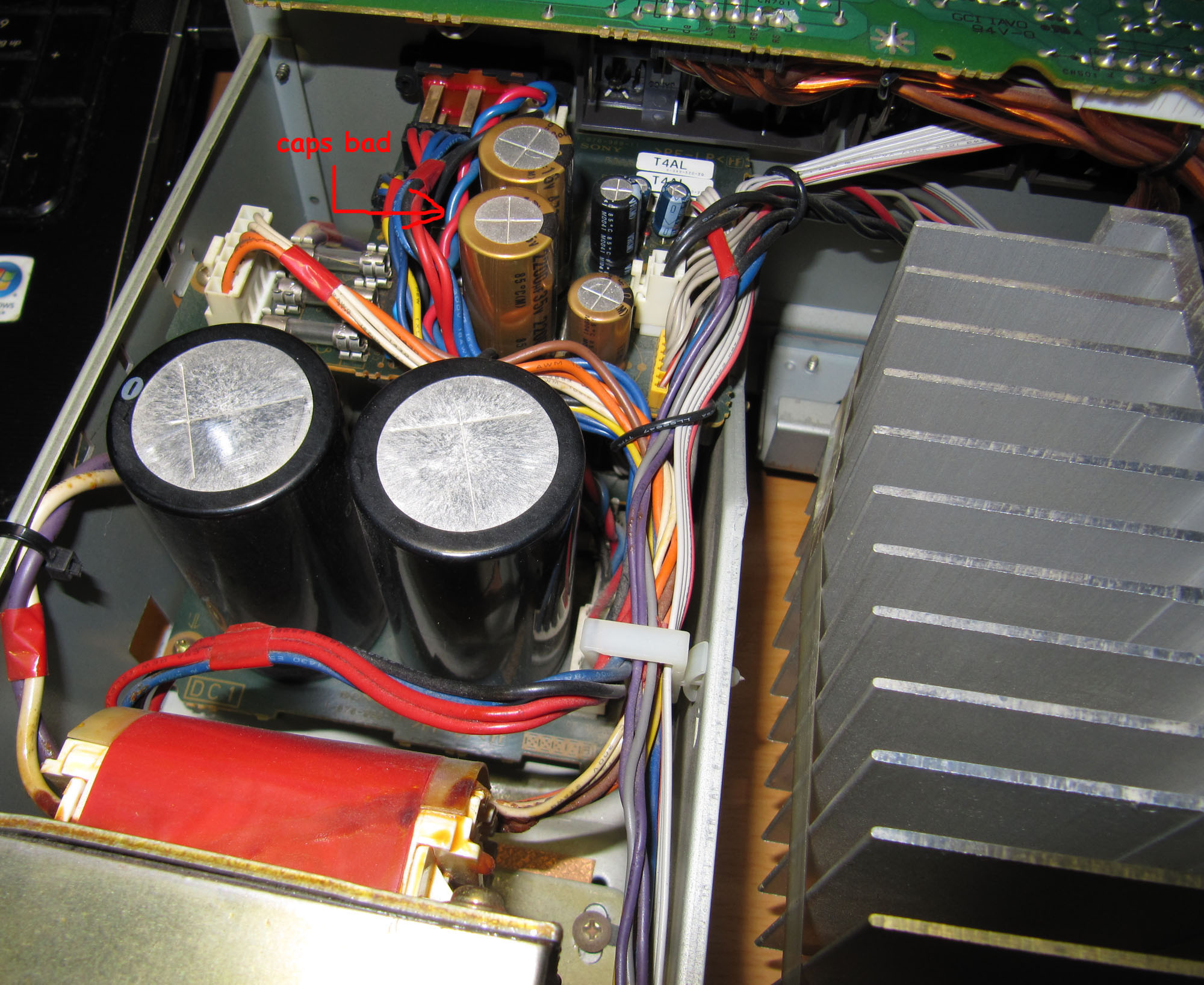

      I have bought a second hand Sony STR-DB940 that was advertised as being in working status but it turns out it can work only in stereo mode / 2ch direct mode.
      When I try to send a test tone it tries to burn down the speakers! Same happens when I just set it on 5.1 input mode , dobly prologic, custom sony soundstage etc.
      There is a terribly loud sound coming from center and rear speakers and the volume of this sound is totally independent from the setting of the volume control.
      So there is something definitely wrong there:

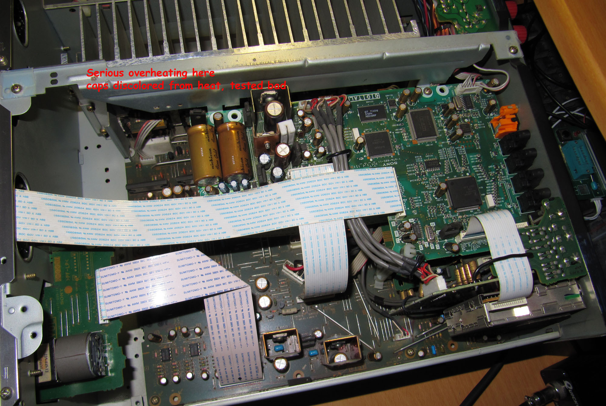

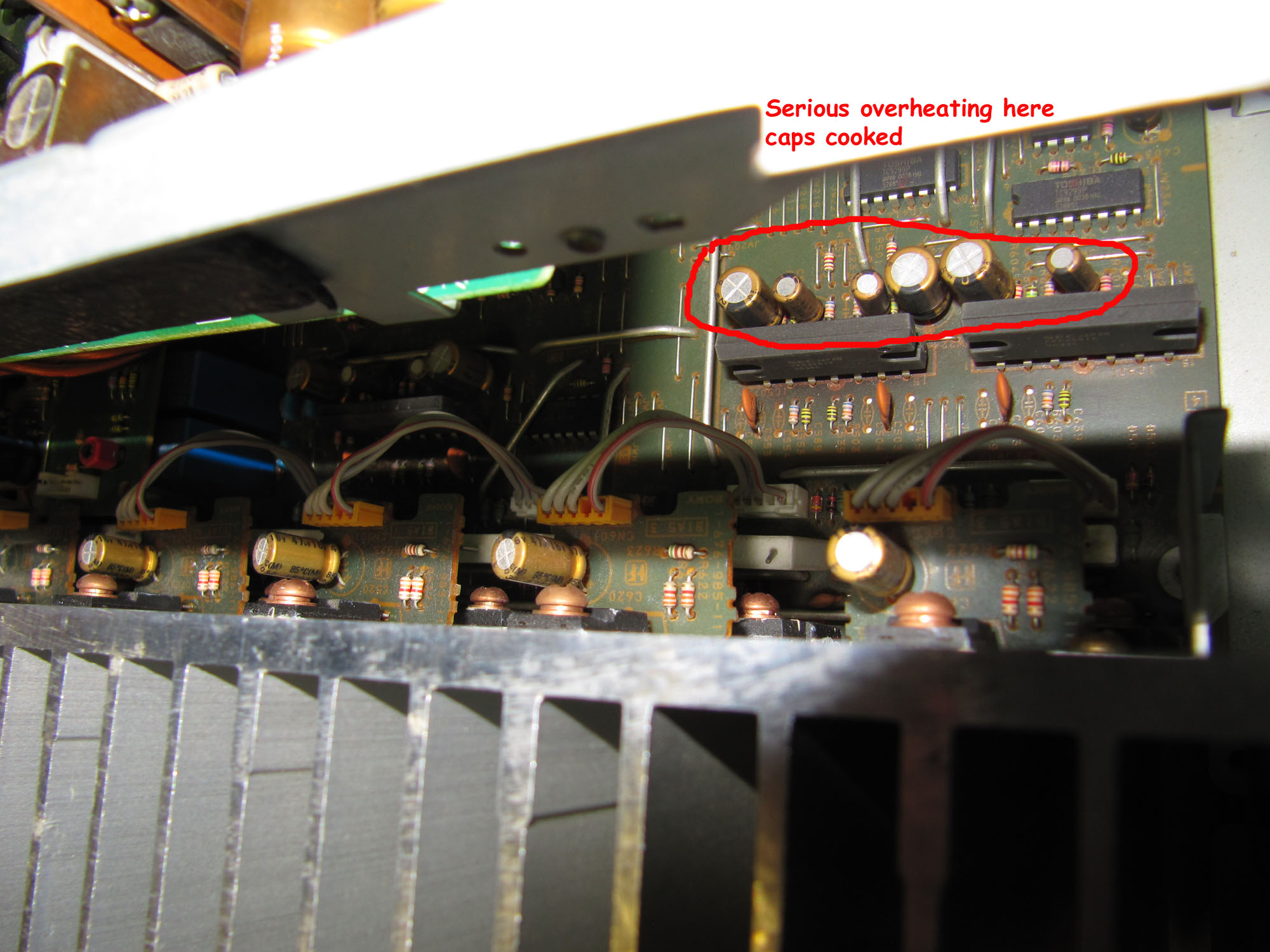

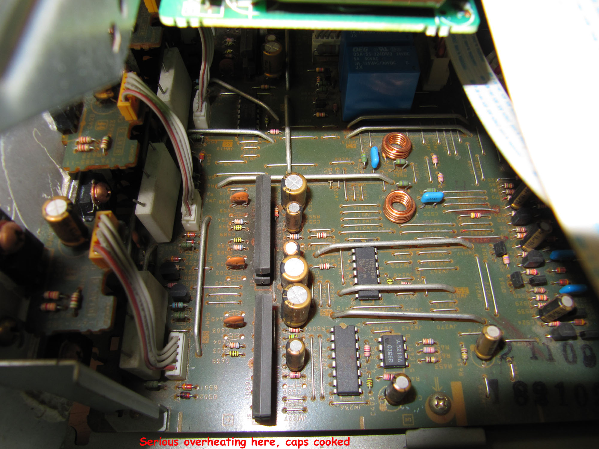

      I opened both the cover of the amp and the service door on the underside and upon closer inspection noticed some possibly cold solder joints on the AMP pcb. But the digital board had serious discoloration due to heat and some roasted capacitors around the area of 5V regulator and 3.3V regulator.
      I took out the caps and they are indeed bad.
      While it was on mains and powered on I couldn't keep but notice that this area was getting very hot.
      I know that there is already reference about those 2 issues.

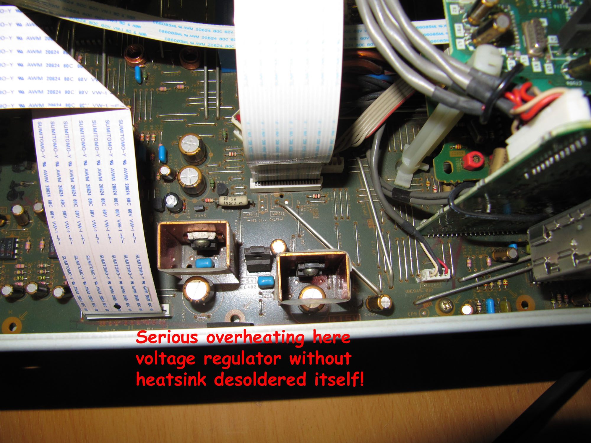

      But what I discovered and couldn't find reference in any online forum is that there is also an aera on the AMP pcb that gets so hot that the regulators can get cold solder joints and this can cause issues too.

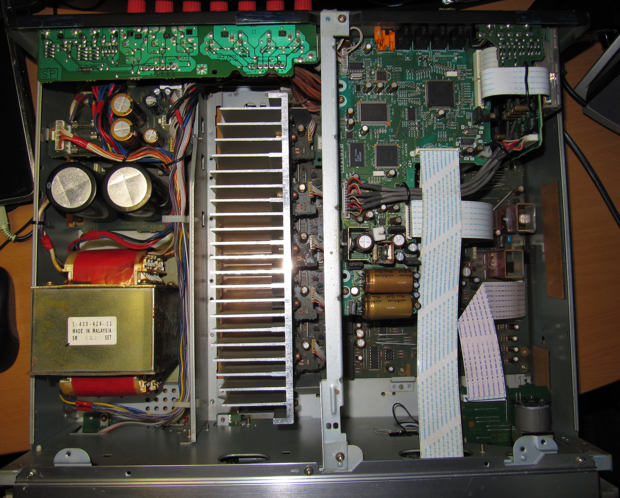

      This area is not accessible, without totally removing the AMP pcb outside the amp and this required practically removing , FM tuner, digital board, svideo board, rca video board and the output speaker board.
      Then, one can carefully remove the amp board and have access to the area of the regulators and especially the -5V that is mounted without a heatsing because Sony engineers did a terrible job designing this thing.
      But wait, there is more!
      IC501 and IC701 also have cold solder joints on my unit and the board has signs of overheating.
      Finally, I decided to desolder the 3 remaining boards: the board of the 2 huge primary capacitors 15000uF 71V, DC1 and the AC board and DC2 board. Surprisingly I found cold solder joints on DC2 as well and pcb discoloration.
