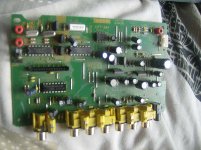

            That would probably be best. The OP indicated it was the bottom board, so try to get especially good pictures of that. I'll do a little searching and see if I can find something helpful.

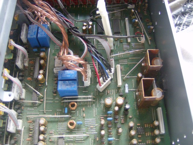

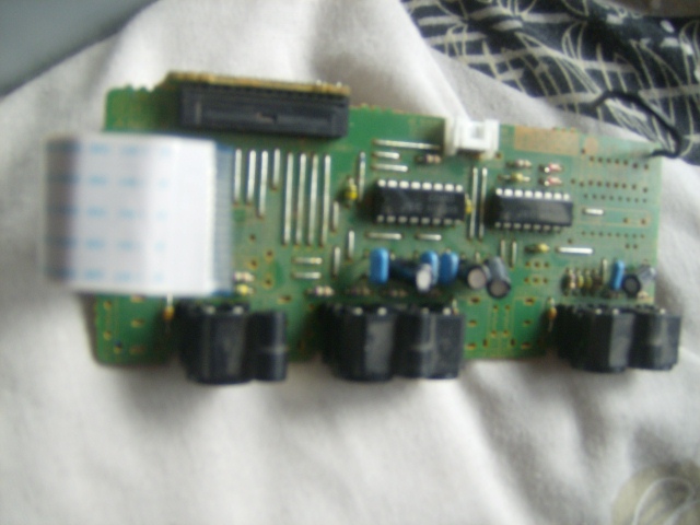

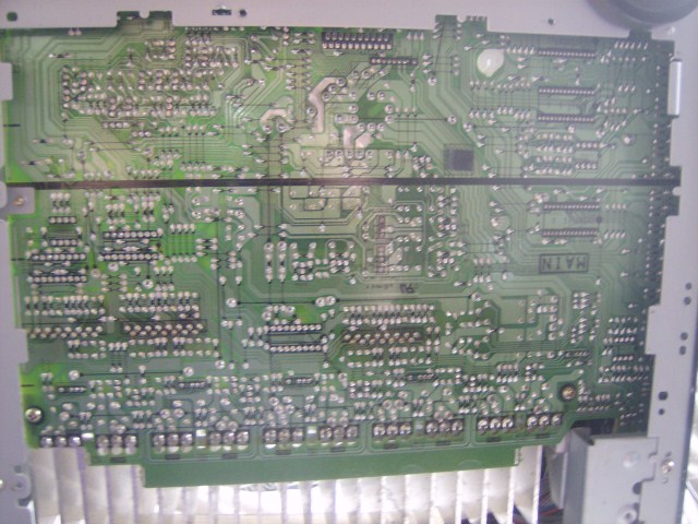

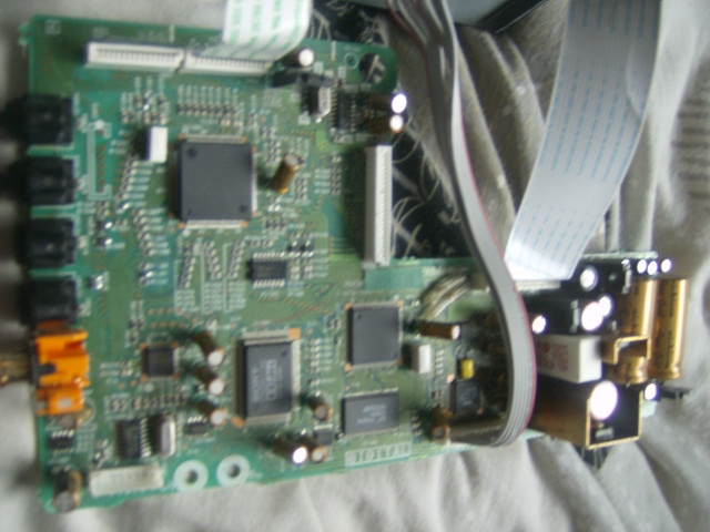

              Here are some of the images ive taken, ive found the 4 blue things on the main bored!
              Ethan

                Ahem!! That's board!!! Now all you have to do is get to the other side of the board and solder all the pins on the relays. You've already done the hard part - getting the receiver apart. Don't make the mistake of skipping pins 'because they look ok'.

                  So the blue things, just solder all the 16 legs again, because there are only 4 legs per relay.

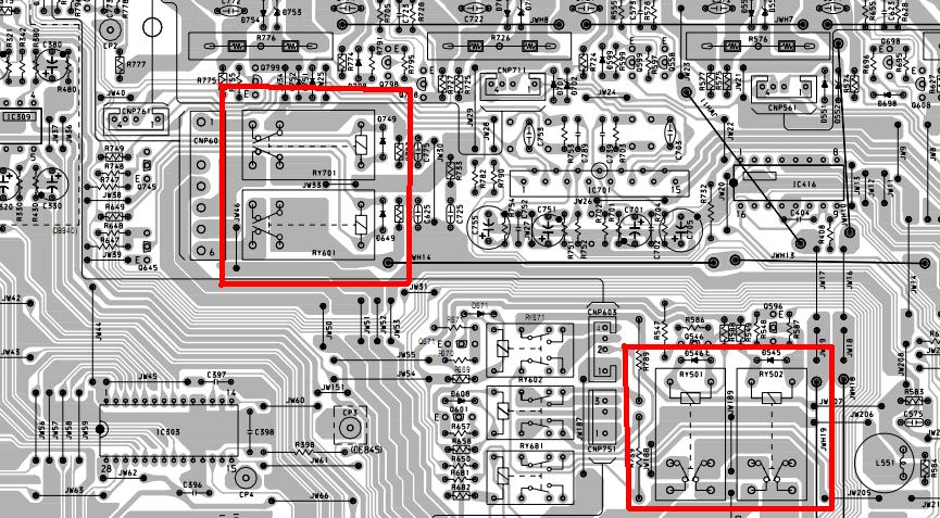

                    Sorry just realised after checking throught the service manual, there are 6 legs per relay, so 24 in total.

                          This old thread suddenly came back to life. Resoldering those four relays is what I did. It was a long shot that paid off. Your mileage may vary.
                          One tip. I didn't make any notes whatsoever about what connector went where. In hindsight, that would have been a good idea. Most of them fit only in one place, or could be determined by cable reach, but in one instance I had to make a guess.
                          A service manual, which I didn't have, but you do, would have been helpful.
                          Another thing, it took some headscratching before I realised that the bottom mainboard had to come out with the big heatsink for the power transistors still attached.
                          Good luck with the repair attempt

                            Hey, i didn't need to take the board out, i took the whole thing apart to take photos, then realised that the underneath of the case unscrews to show the underneath of the mainboard. i re soldered the 4 relays, and it works now, well, so far so good, the digital board gets warm thought, don't know if this is normal or not, but other than that, saved me alot, thanks to this forum.

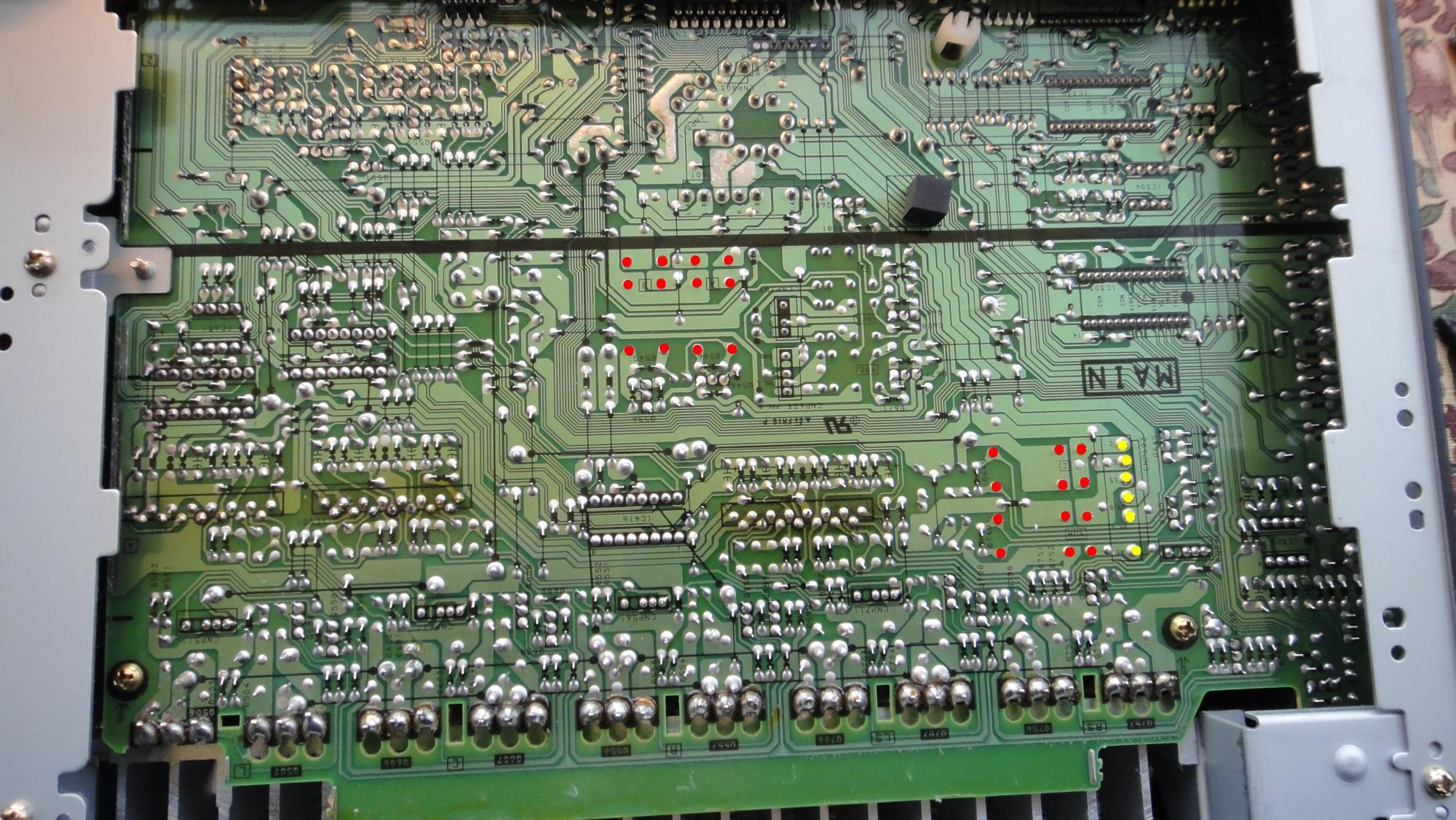

                                      Result
                                      4mins work with the soldering iron and job done, all points can be got at via the removeable panel underneath.
                                      It took longer to disconnect and remove the amp from the AV rack than it did to solder up the relays
                                      So far its been running for about 20mins and hasnt clicked or dropped a channel once so recon its cured, also the centre speaker output quality has improved by 50% at least, I just hadnt realised how bad it had got
                                      Many thanks to Ethan and the others who have contributed and for anyone else with the same problem heres a pic of the underside of the amp with the relay points that need touching up in RED, the YELLOW dots are a set of connectors that I also touched up as they looked a bit rough.
                                      I've also added it as an attachment just incase the host of the above drops out
                                      Right time for a film I recon
