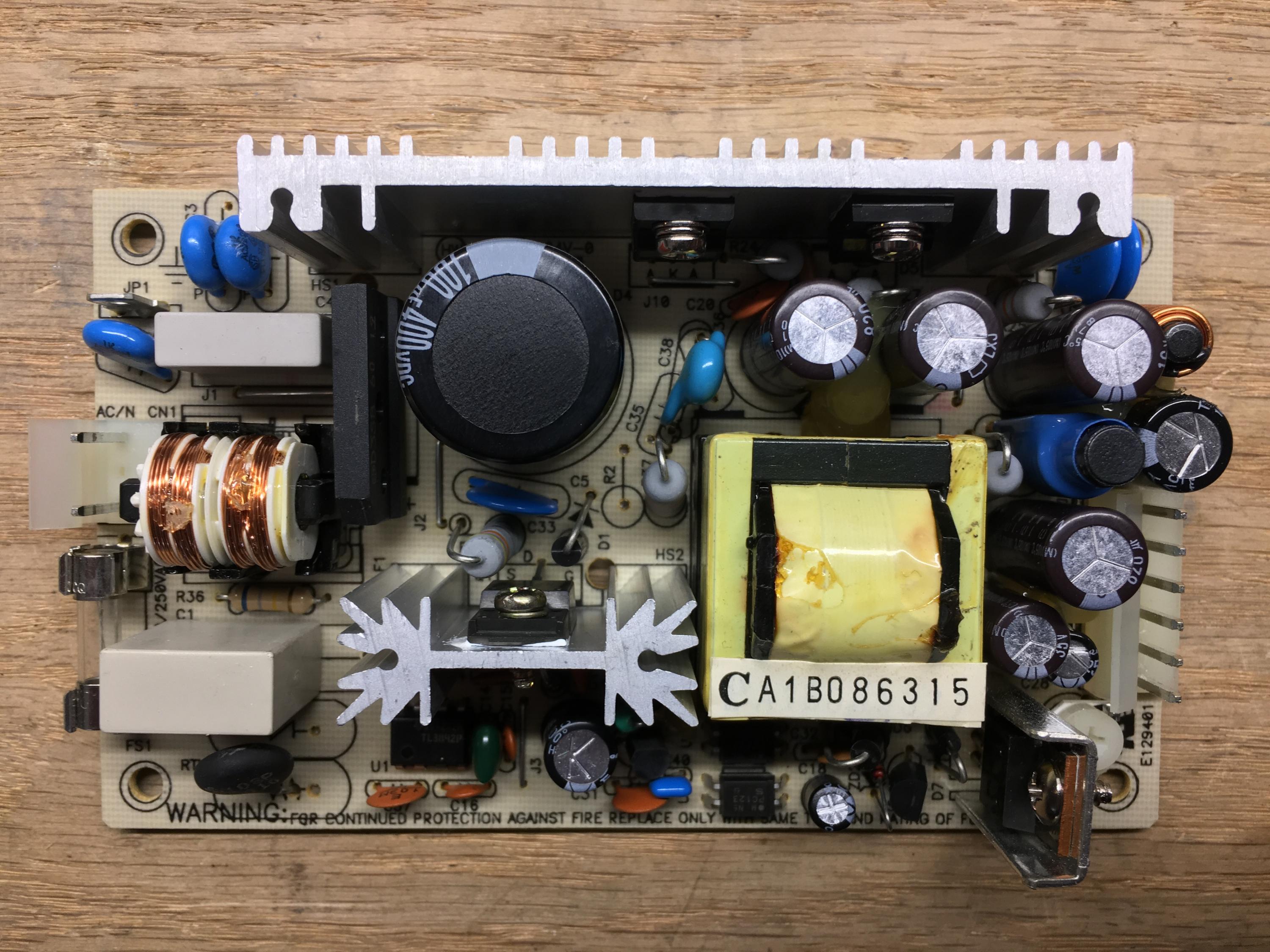

    open it and UPLOAD some foto's of the power supply section.

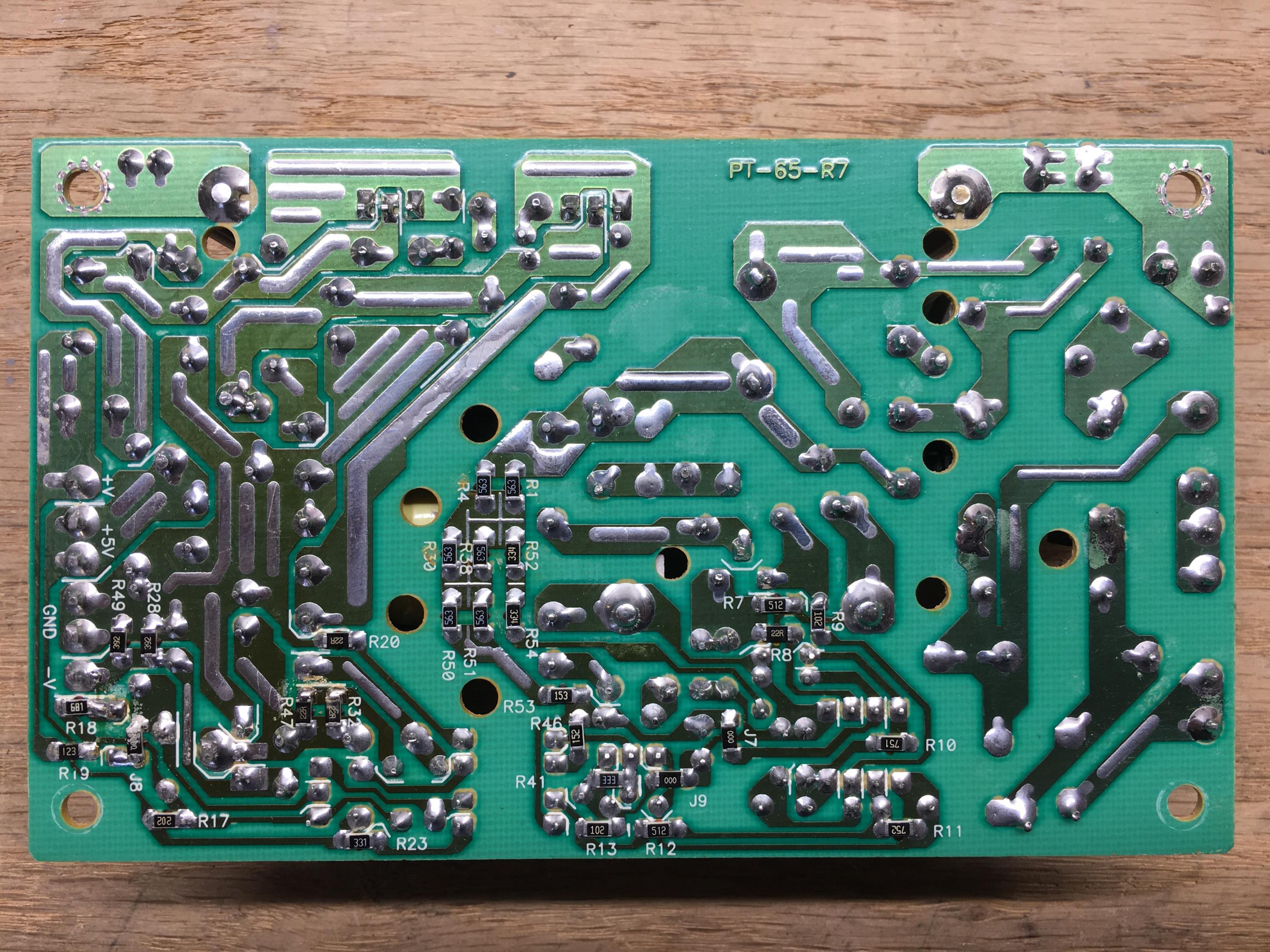

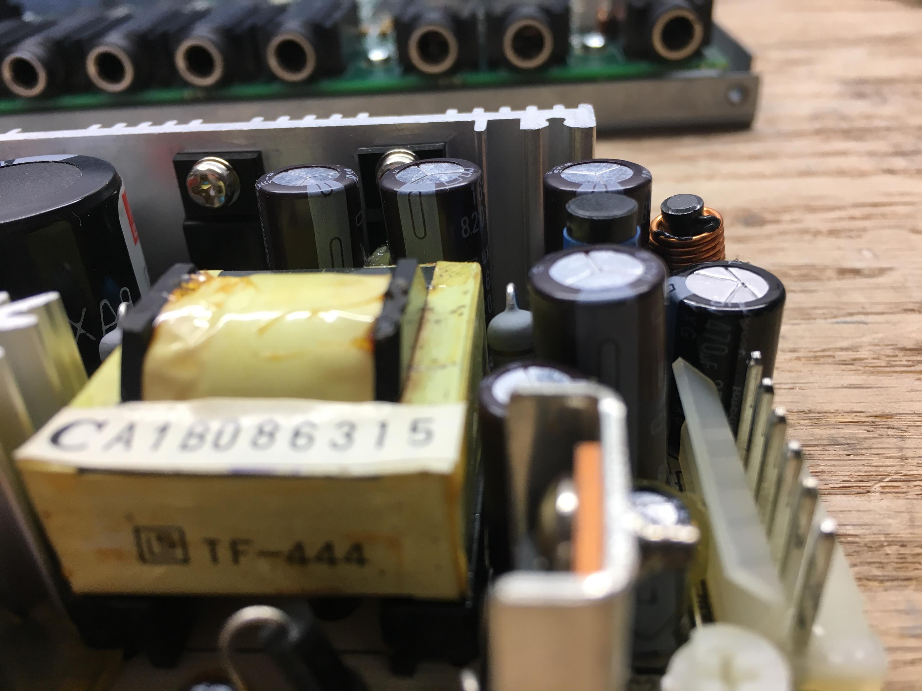

        Re: Novation SuperNova 2 Rack - Freezes up.
        Sorry for the delay... here's the pic's. Power supply board and the processing board. I've ordered what from research I believe is a replacement psb and it'll be here monday so we'll see what that does.
          very nice, perfect soldering - very clean on top.
          caps could be aged, but nothing visible.

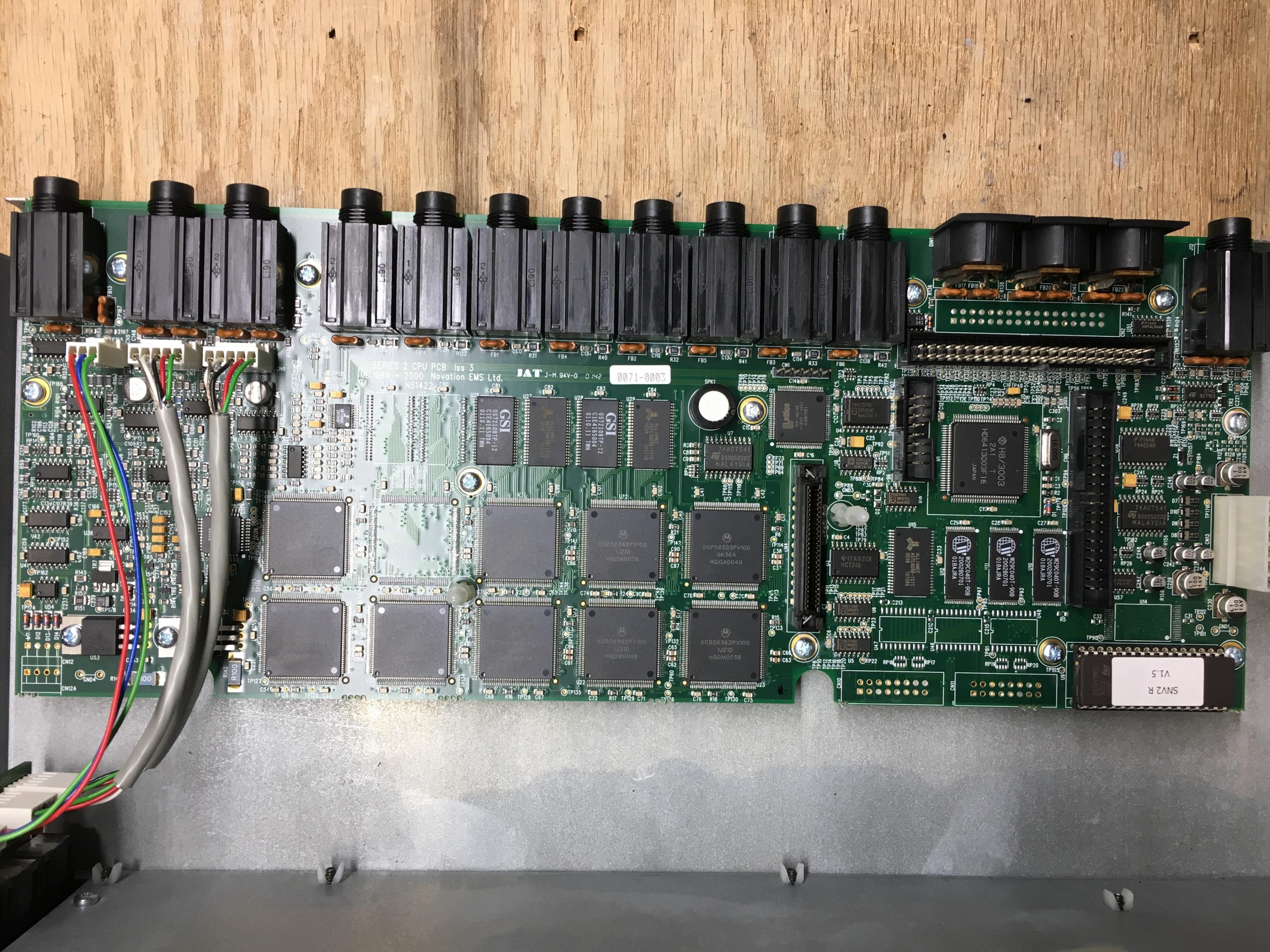

            Well the replacement PS arrived today and that was not the problem... issue remains. Must be on the processing board. I think I'm going to send this in to Novation for repair evaluation/quote. I love the sounds I've been able to make this thing make!!!
              Photos of that, perhaps? Bad caps could be lurking in there too.
              Odds are good they farmed out the power supply (or got it from some OEM), so just because that has jap-caps, doesn't mean they didn't cheap out on the ones on the main board...
                Here's the main board. I didn't pull the front panel board but here's a stock pic of what this unit looks like from the front. That's a LOT of rotary pot's. Anyway I've opted to send this to a service center that works directly with the OEM of the unit. They just received it the other day so we'll see. Again... this is a really sweet '80's synth and my total cost of ownership will simply be the shipping and repair cost so...
                  On the bottom left of the board, looks like there are 2 voltage regulators?

                    Thought I'd update and close out this thread...
                    So I sent the unit into an OEM recommended repair facility (American Music and Sound
                    A Division of Jam Industries USA in Southhaven, MS). Now there's a few threads on Gearslutz about how crap Novation products are and how bad the service is at AMS. I can't speak to the Novation product quality issue as I have no real experience there. I can tell you that this synth that I picked from the dump and is basically 20 years old is working perfectly with only minor repair required so...
                    Here's my experience with AMS: I got an RMA and sent them the unit. I followed up to confirm they got it and then followed-up a week later to see how it was progressing. I was told by the service leader that it was on the bench and a tech would be looking at it that day. I didn't hear anything for a few days so followed up again - normally was getting someone on the phone right away but that day it was a long time and finally just left VM and followed-up with an e-mail. From that day forward I was in e-mail contact with the actual tech working on my machine.
                    We had several exchanges about the issue and what he was doing... long and short of it was it needed the firmware (ROM) flashed because it had become corrupt and it needed one rotary pot replaced. Total = 2 hours labor (inspect, diagnose, repair) and $2.50 for the part. As this had none of the knob heads/covers on it he also asked if I had knobs for it stating that he had just enough spares for it and would include them for free if I needed them. I told him I did not and would greatly appreciate it!
