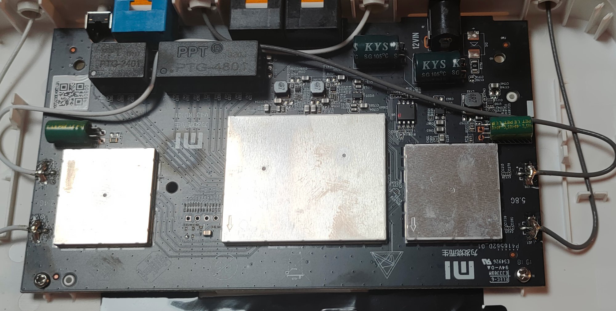

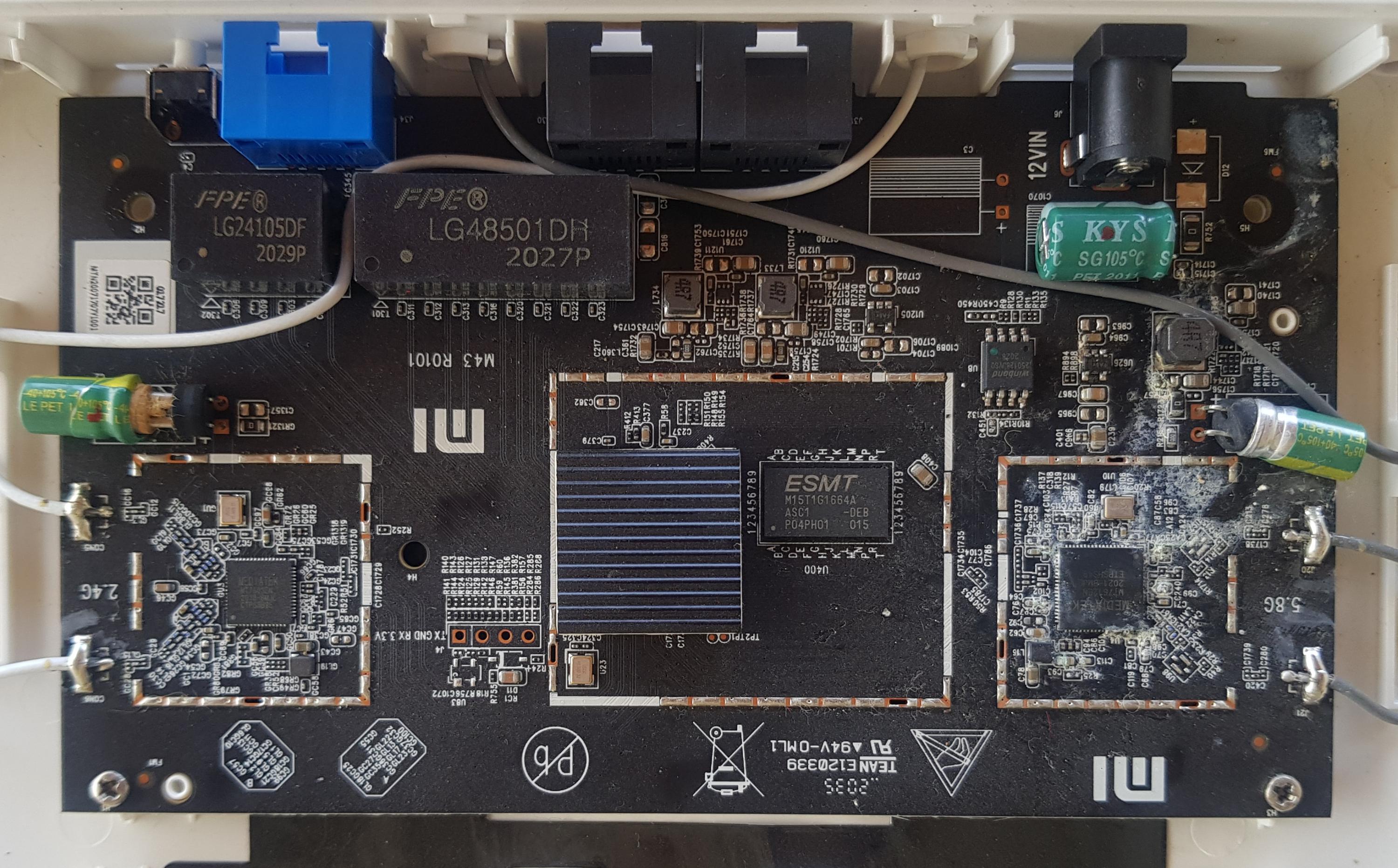

    I'm using Xiaomi Router 4A gigabit edition as wireless repeater. It worked fine for 2 years or so, but last week, wireless started to disappear.
    When I unplug/replug the power, it was working fine for a day/half a day or so until it freezes again.
    After testing with different power supply adapters and concluding it wasn't the issue I finally opened the case and this was the situation:

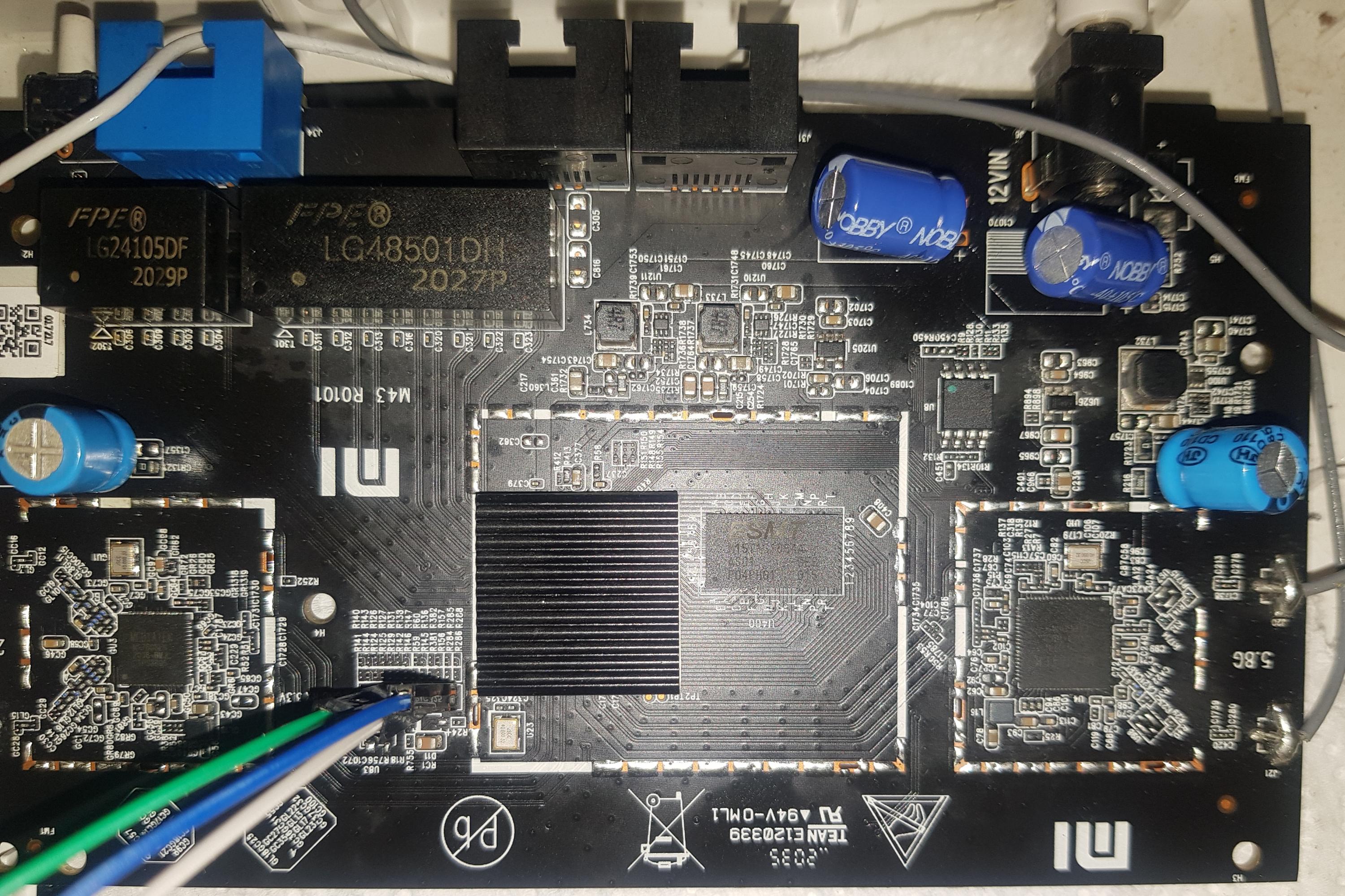

    Anyway I proceed to clean up the mess and replace all caps but unfortunately it made the situation worse. Now router can't even boot, either it freezes during kernel messages, or it boot-loops again during kernel boot.
    I'm very inexperienced not sure whether I f**d up something else on the board while soldering or where to start probing with multimeter etc. Any help is appreciated.

    [B]freezes around here though not sometimes it goes a little bit further[/B]

    Re: Xiaomi router freezes at boot after re-capping
    "NOBBY" ??
    wtf is that?
    do it again - use panasonic FR or rubycon ZL or some other decent low esr caps
    and you added an extra cap not in the original picture - that may have been unwise unless you know what it connects with.
    • Per Hansson
      • Jul 2005
      • 5895
      • Sweden
      Agree with stj, I would also clean the board because it looks like shit, electrolyte might have leaked on it and that is conductive...
      • hinisa
        • Apr 2021
        • 19
        • turkey
        Originally posted by stj
        "NOBBY" ??
        wtf is that?
        Unfortunately there's only 1 place in town who sells small caps and only this no-name crap.
        Extra cap is "cost optimization" by Xiaomi. It's populated in older revisisons
        I actually also have the older revision and I've checked before installing they're exactly same caps (kys 470uf 25v), only differ in quantity.
        Already cleaned in the 2nd pic.
        • Per Hansson
          • Jul 2005
          • 5895
          • Sweden
          The original small caps looks to be LOW ESR 105°C rated capacitors.
          Your replacement look to be general purpose 85°C capacitors.
          If you are unable to get better capacitors a test could be to stop the boot process and load a firmware image via TFTP server and see if the unit works.
          Because it is possible the firmware became corrupted when the caps got bad...
            • 30953
            if that uses a 12v psu then you could possibly scavenge some 16v caps from an old motherboard.
            • eccerr0r
              Solder Sloth
              • Nov 2012
              • 8685
              hmm
              "LE PET"!
              • csh
                • Mar 2015
                • 38
                • Croatia
                Interesting, I got the same router but the first revision from 2019, bought early 2020. Been working 24/7 first as a router, then as dumb access point, flashed with openwrt. Rock stable, newer any problem with it.
                This is the second forum post with blown caps on the newer revision (there is one post also on openwrt forum).
                On newer revisions Xiaomi omitted shielding from the SOC and wifi chips and one of the larger caps on the input.
                Could it be that OP's router blew the caps because of one cap less on the input?
                I opened my router today, all caps are OK, no bulging, measured in place as 925 uF for larger input ones (470 uF, 25V) and the ESR of 0.08. The smaller caps are 470 uF 10V, measured 954uF and 0.12 ohm ESR. Both pairs are in parallel so the measurement is not accurate.
                • harp
                  • Jun 2022
                  • 596
                  • Planet Earth
                  I think that is not anymore problem capacitor and their quality, but previous leaking spillage under cristal, ic and small component... on many point you can see joint plague, and function of these is highly questionable, connections is unreliable or broken or partialy shorted due to stalled residue under its legs. It is realy no point to repair such condition, maybe is firmware corupte and so on...
                  It is good reminder that 24/7 router should hang on wall respect to capacitors
                  • Agent24
                    I see dead caps
                    • Oct 2007
                    • 4940
                    • New Zealand
                    Love the deranged names of these caps. Nobby? LE Pet?
                    Ironic that the one called KYS was the only one that wasn't dead...
                    -David VanHorn
