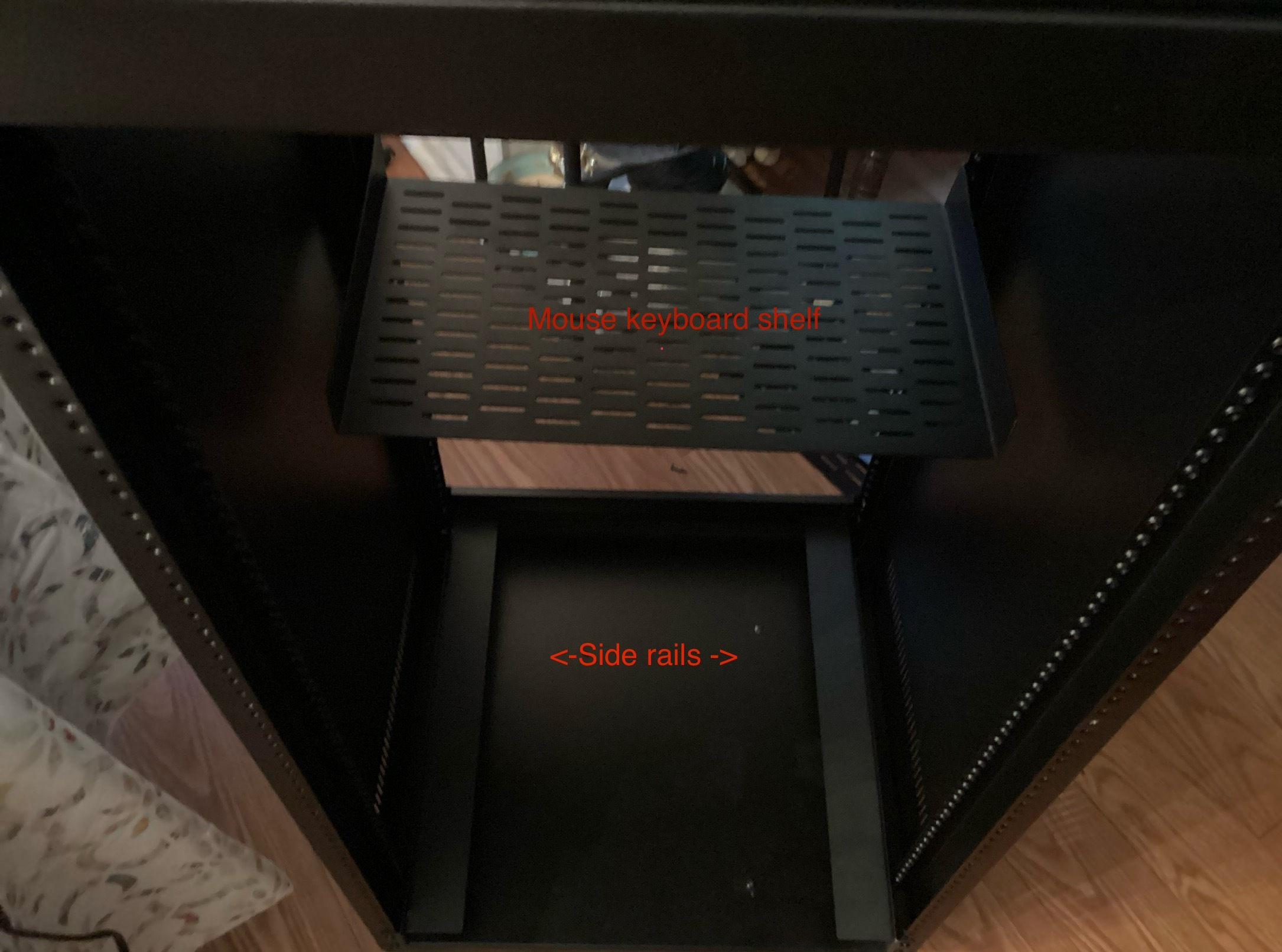

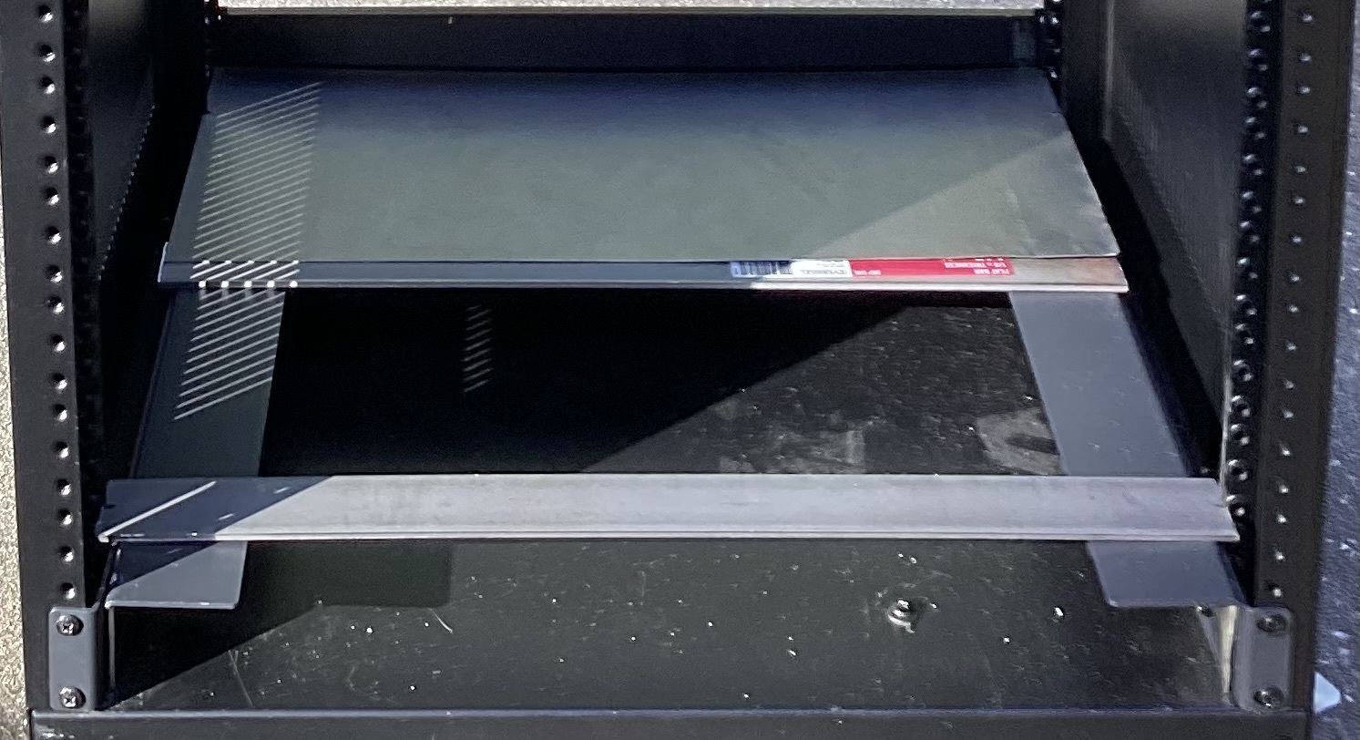

                    I had some time to work on the computer rack shelf and used “Brand New 1U Rack Mount 4-Post Server Shelf Adjustable Rails” that I mentioned I had to modify the slide side mounting a little bit but the selves that I bought for this are not going to work on this adjustable shelving rails because of way it is made but it is extremely stable for putting two tower computers and a battery backup on it which is the more important thing and this is the reason for the over kill of this part of the project the rest of is going to be easier than this part
                    The other reason for the shelf being made to be over kill is so I have a place for the computer cables that would be hanging off of computer rail cart which I did not want to do because it is difficult to move to another location this is the motivation for the over kill of the shelf mounting needing to so stable
                    https://www.ebay.com/itm/152487027533 these are the shelves that I am referring to below ( one note the picture is not exactly what I received in the mail from the seller in the picture it shows the ends of the shelf is open it is not it has a rail that goes around the hole shelf which is better than the ends open because if that was the case I would have cut them to fit )
                    The two shelves that I bought are not going to be wasted I have another project that I going to do that I going to incorporate then into just have not thought to much about it yet I need to get this done I could cut them to fit but these are good quality shelves and this is one reason I do not want to cut them down to fit
                    I did put one shelf in for the mouse and keyboards for each computer just above the computers then the 8 channel battery testing machine then a 2u face plate where the battery holders are going to be mounted but they will be removable so that I can have one for 18650 and one for 21700 battery cells then a space for the single battery cell battery testing machine and a place for the battery pack to sit while testing it

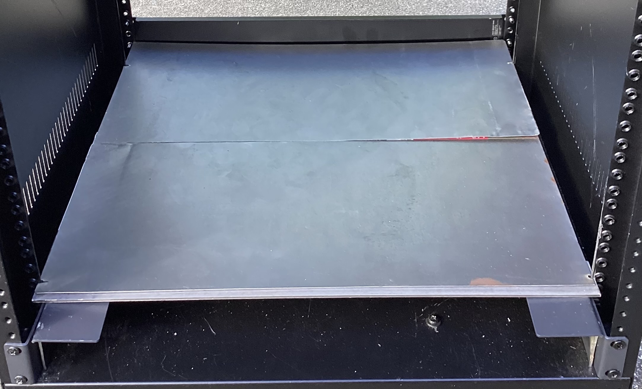

                    So I need to decide weather or not to use a plastic cutting board as the shelf or cut a piece of sheet metal cut to size
                    I just priced two sheets of metal 18-1/8 “X 18-1/8 “ 20 gauge roughly $31.00 each and this includes shipping
                    plastic cutting board is around $9.00 no shipping I might go with this option
                    I would just have to make a jig to be able to cut it straight
                    I going to make a decision in the next couple of days to which direction I going to with this

                      Here is a picture of the side rails installed and the keyboard and mouse shelf mounted this shelf might get moved up a little bit depending on weather or I decide to use the plastic cutting board or not

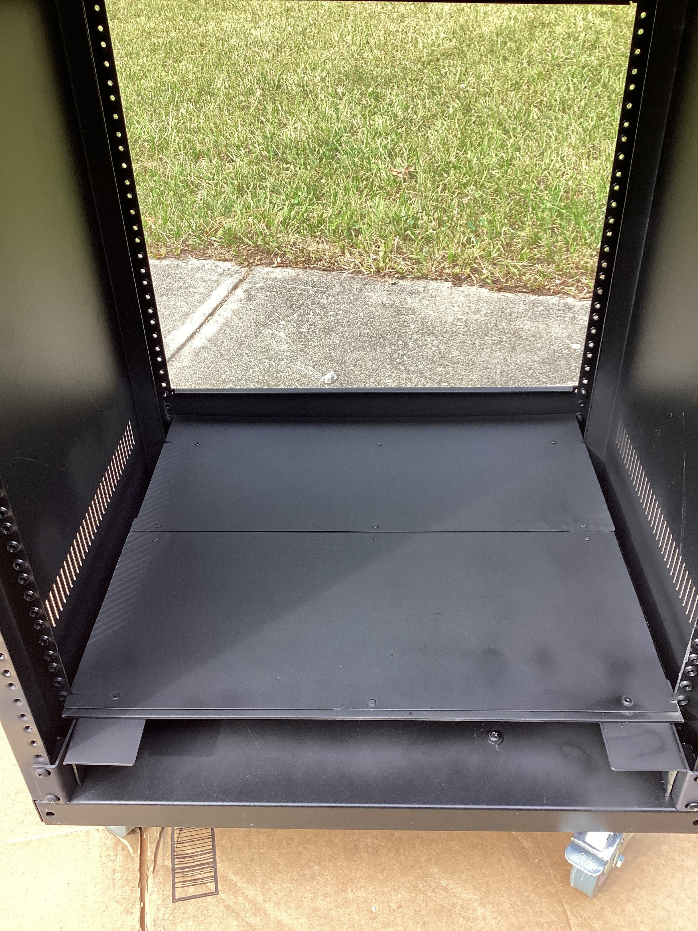

                        I have decided to go with the metal shelf but because it is very thin metal I have to put support rails across the other way to make it sturdy hopefully I have some time to work on it this weekend

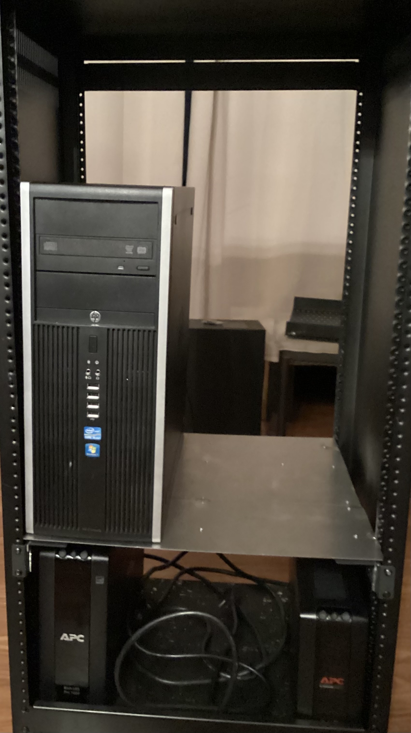

                          Well I had time to work on the computer cart and put it together and spray paint the shelf here are some pictures of it being completed
                          I started putting the two computers and battery back up and put the eight channel battery tester back on this computer rack cart and then figure out how and where the next shelf will go and go from there
                          Well thing did not go as planned I have enough room for the two computers however the battery back up and line conditioner is not going to all fit so I have to make another strong shelf above the two battery backup and line conditioner on the bottom shelf and the two computers above that and then the eight channel battery testing machine
                          Now I have to decide weather or not to attach the other computer rail rack cart that I was going to use in the shed but I am considering buying another desk top computer rail rack cart and not use the wheels on it

                            Here is what it going to look like when the other computer and battery backup and line conditioner are put on the shelves and then the eight channel battery testing machine goes on the very top space I might have to shim the computers in the middle to get them to be level but I have the hardest part done and to me it looks really good it being modified
                            The hole reason for doing this project was to make the most of the space that I wanted to use for this battery testing machine for the testing center and not have it take up so much bench space in my shed
                            I have decided that I going to use the other computer rail rack cart for the single battery testing machines but that is going to another very challenging project as well because of how many battery testing machines I want to use in it
