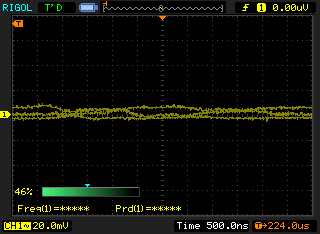

    I have blew up a diode, twice a while back, when I have tried to use the scope in the primary.
    You are right about the diode orientation.
    I want to clarify something, that may be important, I'm measuring the PS, out of the receiver. I hope, that is OK. It is not connected at all, to the receiver.
    I have managed to take some snapshots. I have touched the plastic wrapping, with the tip.

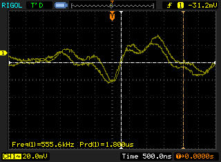

      Are those waveforms you measured all you get? Does that waveform repeat? Can you zoom out a bit and see if there's anything else?

        I have mounted all together and applied 5V at D921 and the standby LED turned on, but the receiver, still did not turn on. The amperage started to go higher, from 0.07A and the standby LED turned off.
        D920 is not disconnected. There is no short that way. Measuring over 5 Mohms.
        I have to pay more attention, to those wave forms.
        At the anode of D911, should I get AC right?

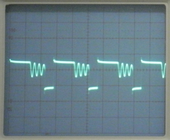

                On the cathode of D911 you should see DC with some slight ripple (it will be smoothed by C918)
                On the anode of D911 you should see a pulsed waveform, likely similar to the one in the image I have posted.
                If you have nothing at D911 anode, then IC91 is not switching for some reason, or TF91 is bad.

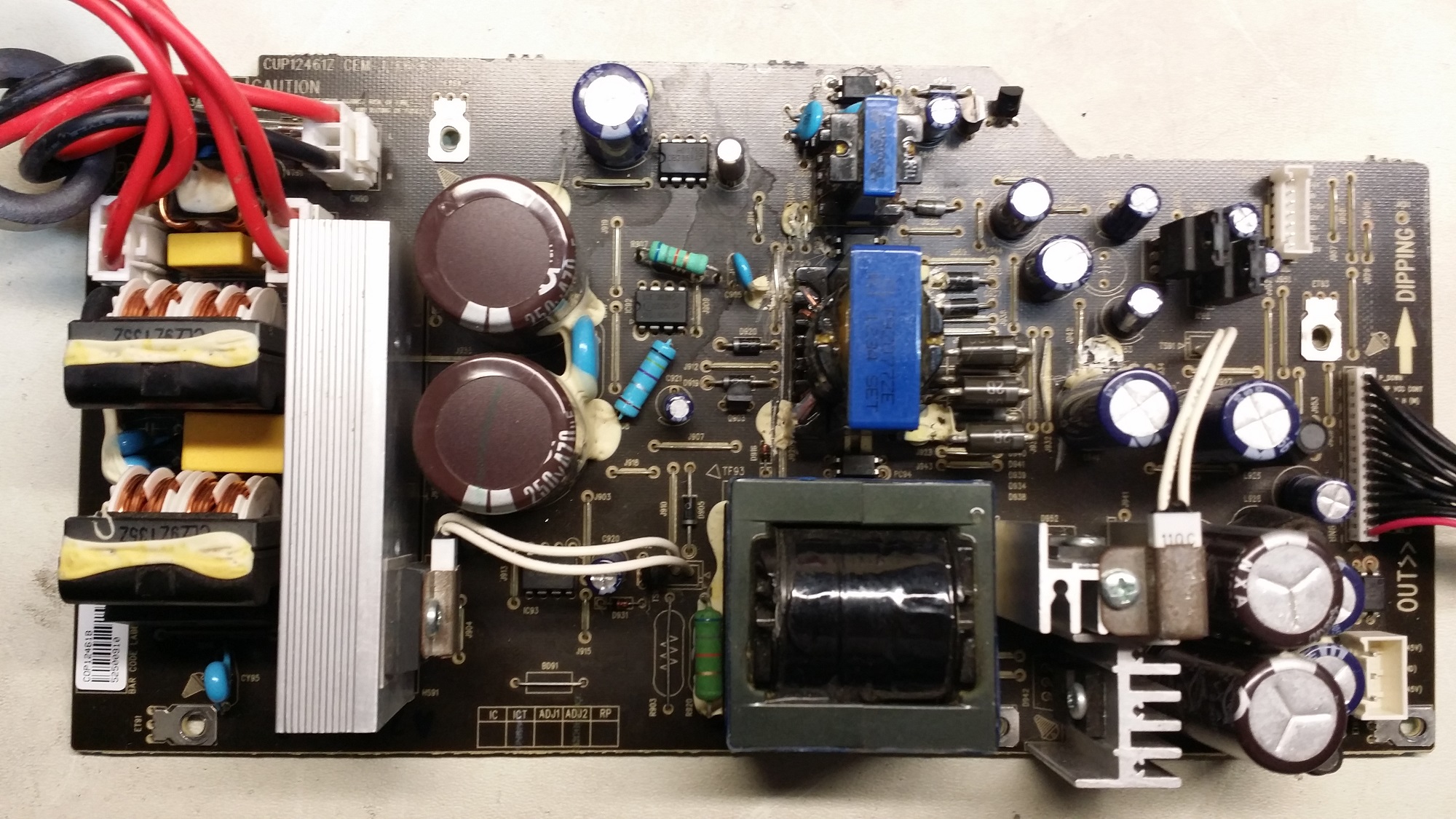

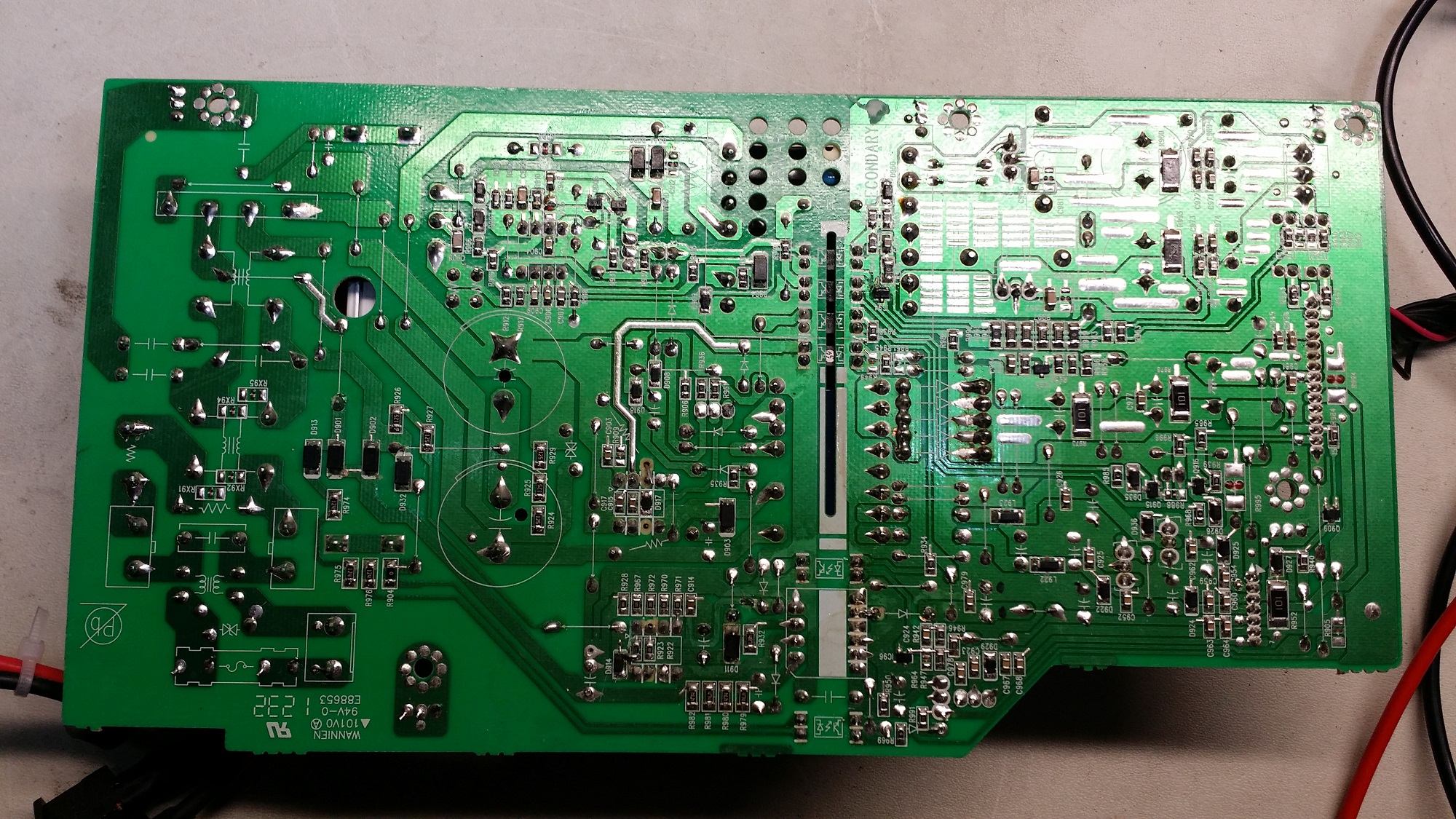

                I wonder, could you post some new up close and clear photos of the board around IC91, both sides? Just in case there is some new problem I'm missing? It's hard when I can't see the board.

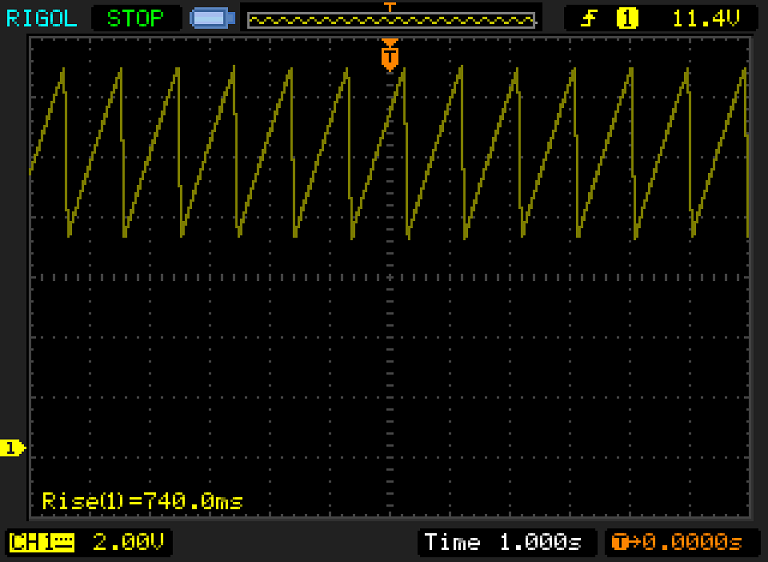

                            You are right, I have bought the IC from Aliexpress. Nobody else sells these anymore.
                            Since I can't use the scope on the primary side, I'm out of luck seeing what is going on there.
                            Do you have a recommendation, on what should I buy for my Rigol DS1052E, to be able to use it on the primary side? Right now it i hacked to be 100Mhz scope.
                            The new optos, are on the way. I will replace it, as soon as it arrives, but I wouldn't think, that it will make a change, since I have tested it and it shows OK.
                            I'm measuring the FB voltage again and what I have noticed, that if I use the range + Min/Max I'm getting 3.83V and if I use the second range, I'm getting 2.99V.(hitting the range button once, on Fluke 189)
                            VDD on the IC, is 12.3V.
                            Top picture is not the best, shadow from the sun.
                            I can retake it inside, if you need it.
                            D943 and D920 are removed, at one side.
                            Viewed from the bottom, the bottom white strip is the transformer and on the left side of it, is the IC91. Opto is above the transformer.
