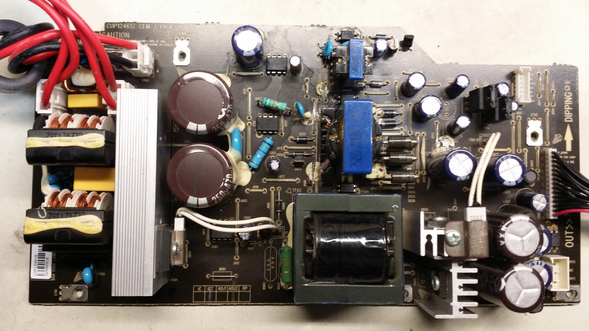

                  #48
                  Re: Harman Kardon AVR1700 not powering up
                  Can we get some more photos of the PSU in its current state?
                  -David VanHorn

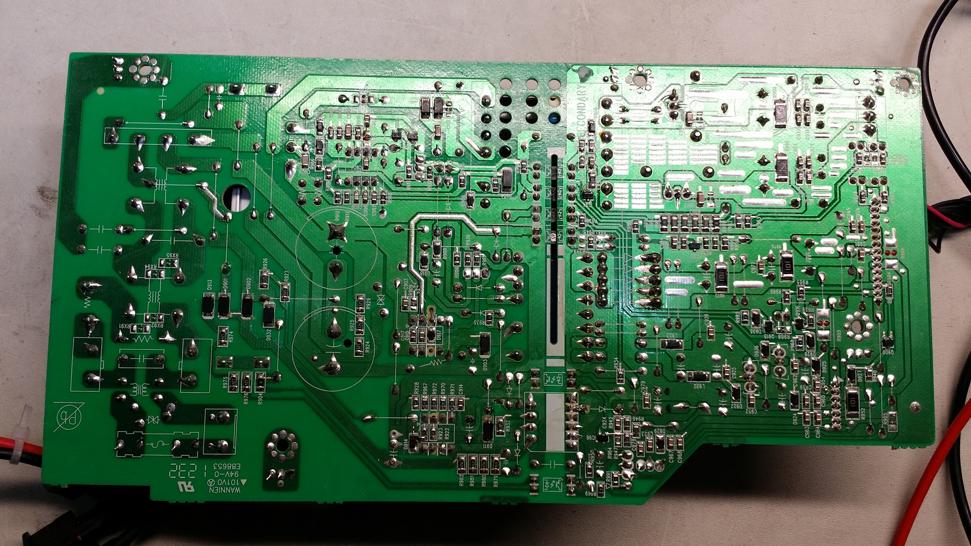

                      #50
                      At C902, I have 326.3V.
                      Pictures are not the best, taken inside with phone.
                      In some spots looks messy, because I have tried removing, that white foam thing.
