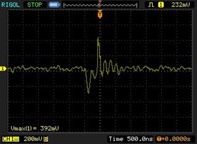

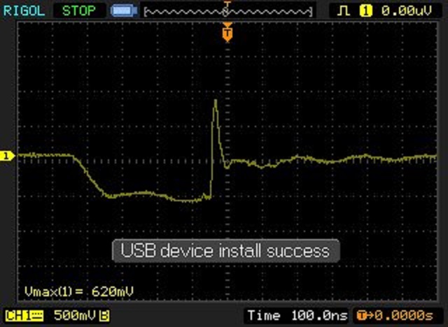

    I have took some more measurements.
    With ground connected and probe near the transformer(trf_close).
    Second is at the anode of D911(d911_diode).

      Re: Harman Kardon AVR1700 not powering up
      I've re-attached your pictures here as JPG so they're easier to view. If you attach more, please convert them to JPG if you can so the forum can show them.
      Well, the chip is indeed running at 50kHz as it should be (from the first picture), so at least it's doing something right.
      Can you zoom in on the transformer waveform from the first picture and show it at the same 500nS timebase as the diode one?
      You are using x10 probe?
        This way, I could actually see something, on the screen. That is, why I did not go lower on the scale.
        If I convert the pictures in jpg, they will show on the forum? Thanks for that. I will do that, in the future.
          You may need to adjust the trigger level or voltage per division? In any case, once the wave is captured, you can zoom in?

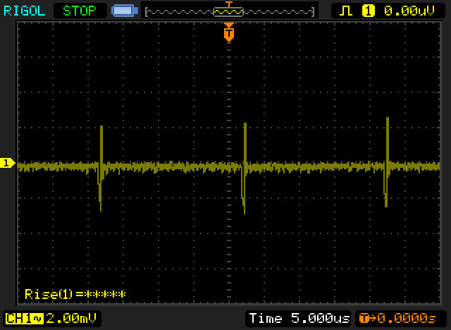

                    I hope, that I did it right.
                      That waveform doesn't look particularly good. There should be more oscillation there. Can you try again but see if you can capture just one of the pulses? I'm wondering if the scope is averaging out the waveform and making it look wrong (can happen). Try reducing the timebase setting and re-capture.
                      Can you also provide screenshots of the waveforms for each of the output pins of the transformer?
                      Make sure you measure them with reference to the secondary side ground, not the primary side ground you as you have been using for the others.

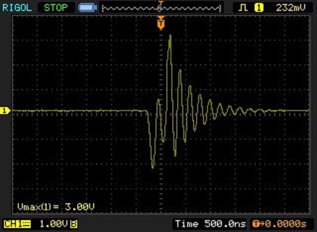

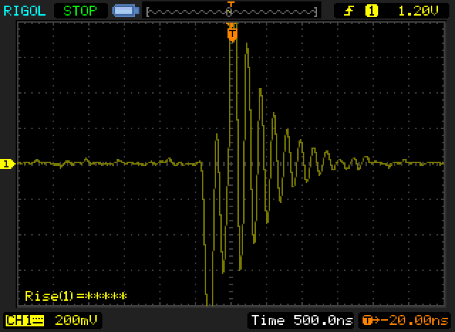

                        #111

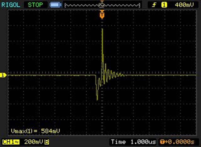

                        I don't think the second time is any better, but I have tried. I actually, touched the core.
                        At the secondary, I took measurements at the diodes, D921(second picture) and 943(third picture).
                          You did nothing wrong, it's just that the transformer oscillations are being dampened by something. Your new screenshot of that pulse proves it.
                          From the screenshots, it looks to me as though there is a problem in the output feeding D921. You can see how the oscillations die away much faster than at D943 or D911 in your previous screenshot.
                          Either there is a shorted turn in the transformer on that output (unlikely) or D921 or something after it has gone shorted\leaky.
                          Have you tried replacing D921 at all yet? I know you said you tested it and it seemed OK, but it could be failing under load.

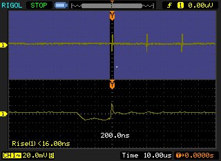

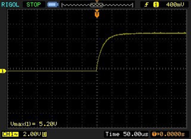

                            I have removed D921 and measured it again (first picture).
                            I have got the optos in and replaced PC92 opto. I have got the wrong package though. I have got by mistake, surface mount and I had to turn the legs outward and soldered it, at the bottom of the pcb.
                            I did not have time to do much today, but I have measured quickly the primary side of the opto (second picture). I don't have a before picture, to compare it too.
                              Running without D921 will likely produce false results as it supplies the feedback circuitry, so the overall circuit probably still won't work. The waveform does look better, though. What does the general transformer core waveform look like now?
                              The feedback pin of IC91 has an internal pullup resistor to an internal 5v supply, so it makes sense you see 5v there. The opto would start to pull this low when the shunt regulator IC96 turns on.
                              Try replacing D921 with a brand new diode and see what happens.
