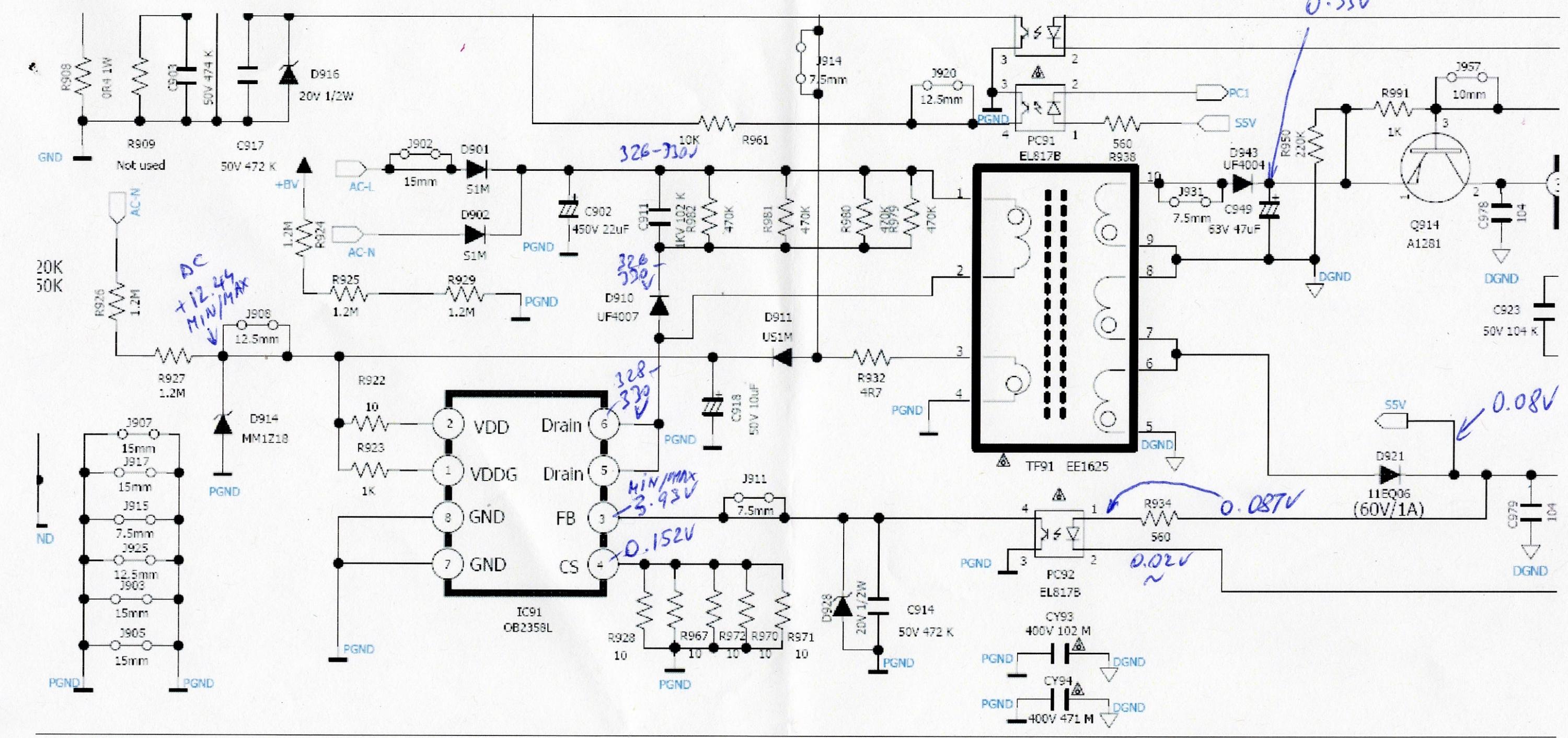

                Found broken wire, at TF91 pin #1. Now I have 323V, at the the drain pins of IC91. Most likely, I did that when I have tried cleaning that white glue.
                C918 it was already replaced by me, at the beginning.
                D911 and R932 are good. Though I don't understand why there is no voltage present at D918.
                At D921, now I have 0.157V.
                I haven't had time, to check out everything, that you guys have pointed out. Hopefully tomorrow, I will have more time.

                  IC91 is not operating (switching) thats why there is no voltage being induced in the secondary windings, at d921 (K) you should have +5 volts.
                  Since there is no voltage being produced by the transformer there is nothing for D920 to rectify to produce the 16 volts at D918

                      Here are the voltages, that I'm getting at/around the transformer.
                      Primary:
                      Pin #1= 330V(slightly oscillates)
                      Pin #2= 330V(slightly oscillates)
                      Pin #3= 0V
                      Pin #4= 0V(GND)
                      Secondary:
                      D943= 0.33V
                      D921= 0.07V
                      After D920, I'm getting only 0.0100V slightly oscillating. So IC92, is not powered up because of this.
                      What is weird, that if I measure this diode in circuitry, is shows both ways. If I remove it, it is OK. One way is 1.9V and the other way is 0.4V.

                            I am not sure right now what might be causing that, but IC91 is the priority anyway. So, leave D920 out and forget about IC92 for now.
                            That you have 0v at Pin #3 of TF91 is not good. Are you checking there for DC or AC? You will likely not get DC.
                            Measuring for AC voltage there across Pins 3&4 if you didn't already. If there is really nothing, you may have a broken wire on Pin 3 or 4 as well? I think you said Pin 1 was damaged before.
                            Have you tried to see if IC91 circuit runs normally now if D920 is out of circuit?

                                I have removed the transformer and I'm measuring 0.23 Ohm, between pin #1-2 and .61 Ohm at pin #3-4.
                                On the other side, I measure 0.08 Ohm at pin #5-6 and 1.10 Ohm between pin #10-9.
                                To me, it seems like it is OK, no interruption in it.
                                I have took some measurements, in that transformer area. Please see the scanned document.

                                  Re: Harman Kardon AVR1700 not powering up
                                  This is a nice receiver.
                                  just a quick look, it seems U91 is trying to make it past start-up.
                                  U91 likes around 16V for power, and UVLO is about 10V and you are getting around 12.4V
                                  Your readings around D920 would make me check D918, C921, Q903 etc. for shorts. C921 should get some voltage on it if the transformer is outputting anything.
                                  Note the schematic seems wrong, shows DGND between pins 8,9 and pin 5 on the xmer, which would short it out?
                                  Only other thing is if the transformer ferrite core is cracked or loose.

                                    Transformer has no open winding, that's good. But it may have shorted turns. You'd need a ring tester to check that.
                                    Do you have an oscilloscope? You can hold the probe over the transformer core (no electrical connection) and see the waveform. If you can do that, upload a capture or photo of the waveform.
                                    I still think you need to try a known good, brand new opto-isolator too. I still don't trust the ones from a PSU which already blew up.
