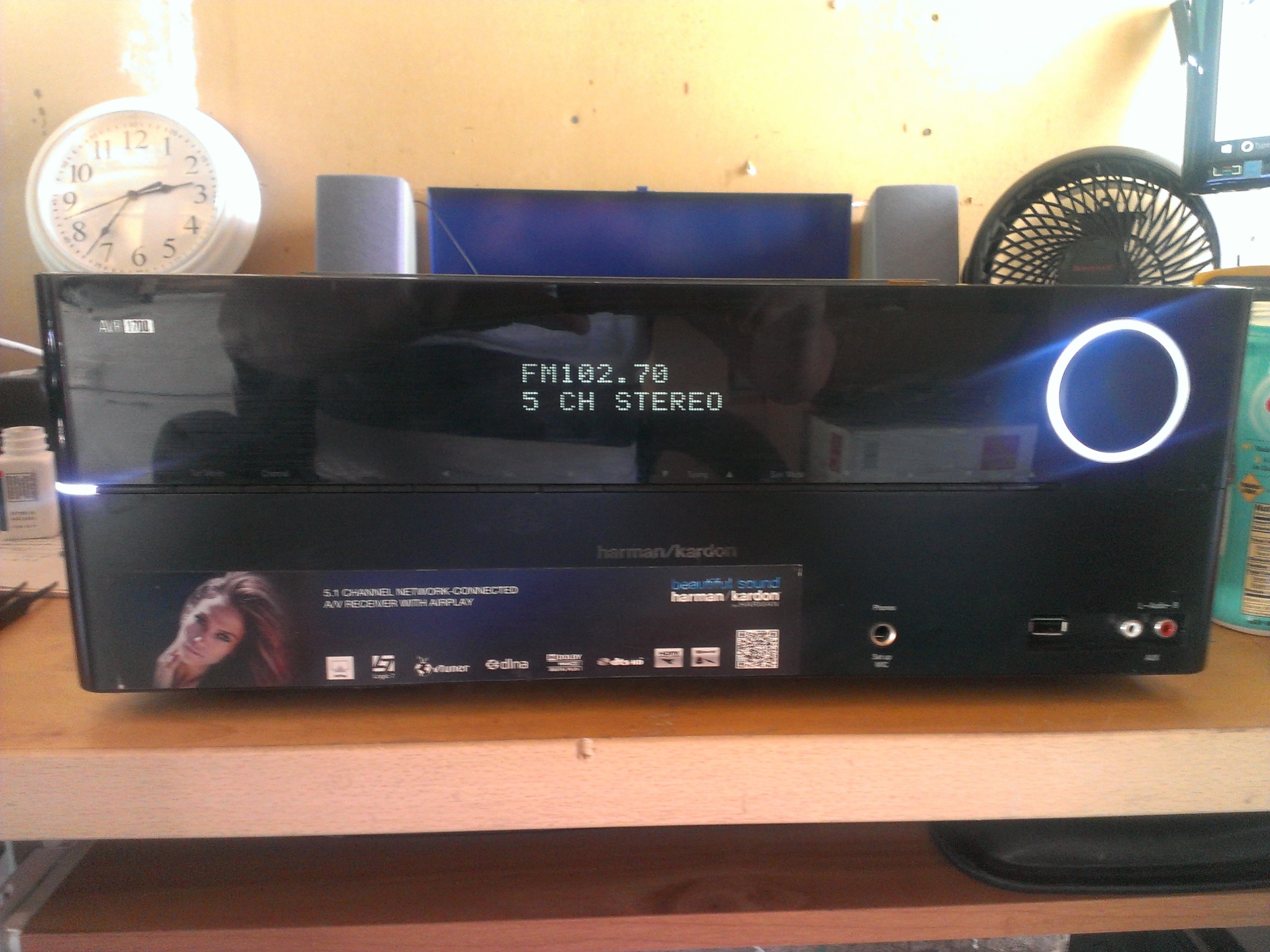

                              #134
                              Re: Harman Kardon AVR1700 not powering up
                              Here is the result, of finding a leaky D918:
                              • tibimakai
                                • Jan 2012
                                • 3680
                                #135
                                After replacing it, I had 11.8V there(IC92 pin #7 and at Q903). All the voltages came up at the connectors.
                                Though, the power for the amp, is only a +/- 25V and not +/- 45V, as expected.
                                HDMI audio/video works well too.
                                I still need to replace, those two resistors and clean up everything.
                                The PS is very messy, after all this work on it.
                                It's been a while, since I started on this receiver, I don't even have the original screws anymore, need to find some, that match with the rest.
                                Thank you very much, for all your help with this receiver.
                                I appreciate it a lot.
                                Tibor
