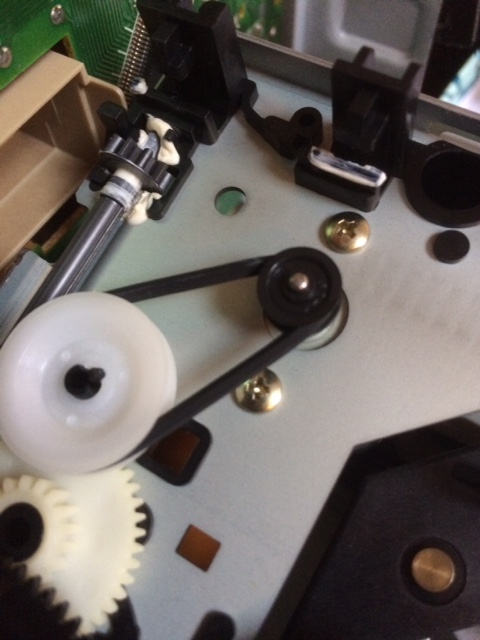

            Re: Teac CD PD-H400 Tray Opening Intermitantly
            I can see it now
            It is still intact but I assume that it is worn/perished/stretched
            Any suggestions how I determine the correct size?
            Many thanks
            Philip
              • 31063
              is it tight?'
              a foto would help
              • Wishiknewmore
                • Mar 2013
                • 13
                • England

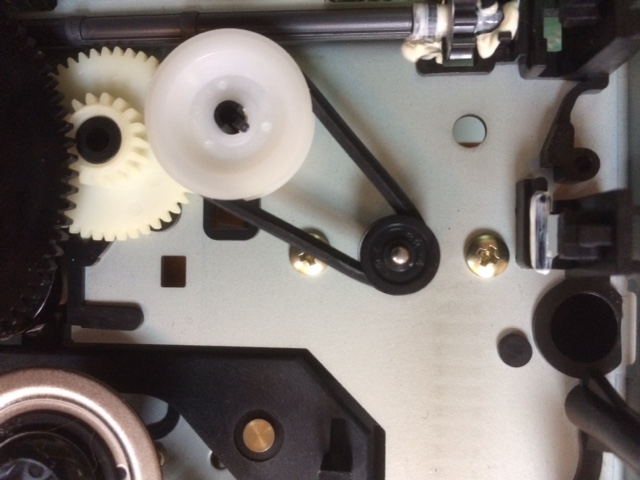

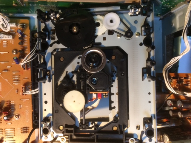

                See attached best photos I can do
                I would not describe as tight as there is not a straight line --it seems to bow a little
                suggestions?
                Thank you
                  • 31063
                  for now, take it off and clean it and the rollers with ipa,
                  then try to work out the diameter so you can find another.
                    Sounds a bit odd but i saw a video the other day on how to measure belts the person took the old belt of then used dental floss he wraped it around the two pulleys like the old belt went tied a knot when it was tight he cut the floss and measured it then ordered the correct lengh belt i will try to find the video and link it.
                    • rhomanski
                      nowhere man
                      • 5157
                      • U S of A
                      That's one way I've used. If I had a good belt left, I'd just squeeze it together and measure it. Then double it and pick the next smaller standard diameter. Remember it's stretched out a bit. That looks like a square belt too.
                      You need to know where to get one too. Those chinese belts only last about 6 months. I put them in a cassette deck that is probably the hardest one you'll ever see to change belts in. I was not happy when it quit working because of those brand new belts.
                      sigpicThe Sky Is Falling
                        • 31063
                        i just take them out of pc drives that i bin.
