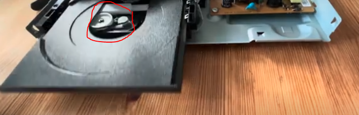

    Sony DVD player stuck tray (DVP-SR310P)
    I have a Sony DVD player with a stuck tray. It seems that moving or pressing on the tray makes it work.
    Anyone knows why?
    Thank you.
    • 31255
    99% of the time it's the belt connecting the motor to the tray gears.
    you will find it at the front after you remove the tray completely
    otherwise maybe the motor needs oiling or replacing.
    but the belt is the main issue in most cd/dvd mechanisms
    • bogosort
      • May 2022
      • 78
      Thanks for the reply. Hopefully removing the tray is not too difficult.
      • lotas
        • Jan 2016
        • 4801
        • Russia
        There is no need to remove the tray, then you need to install it correctly, pull out the tray all the way and immediately turn off the power to the DVD (pull out the plug from the socket), now push the tray in with your hand for better access to the belt and remove it with tweezers, change it to a new one and apply power.
