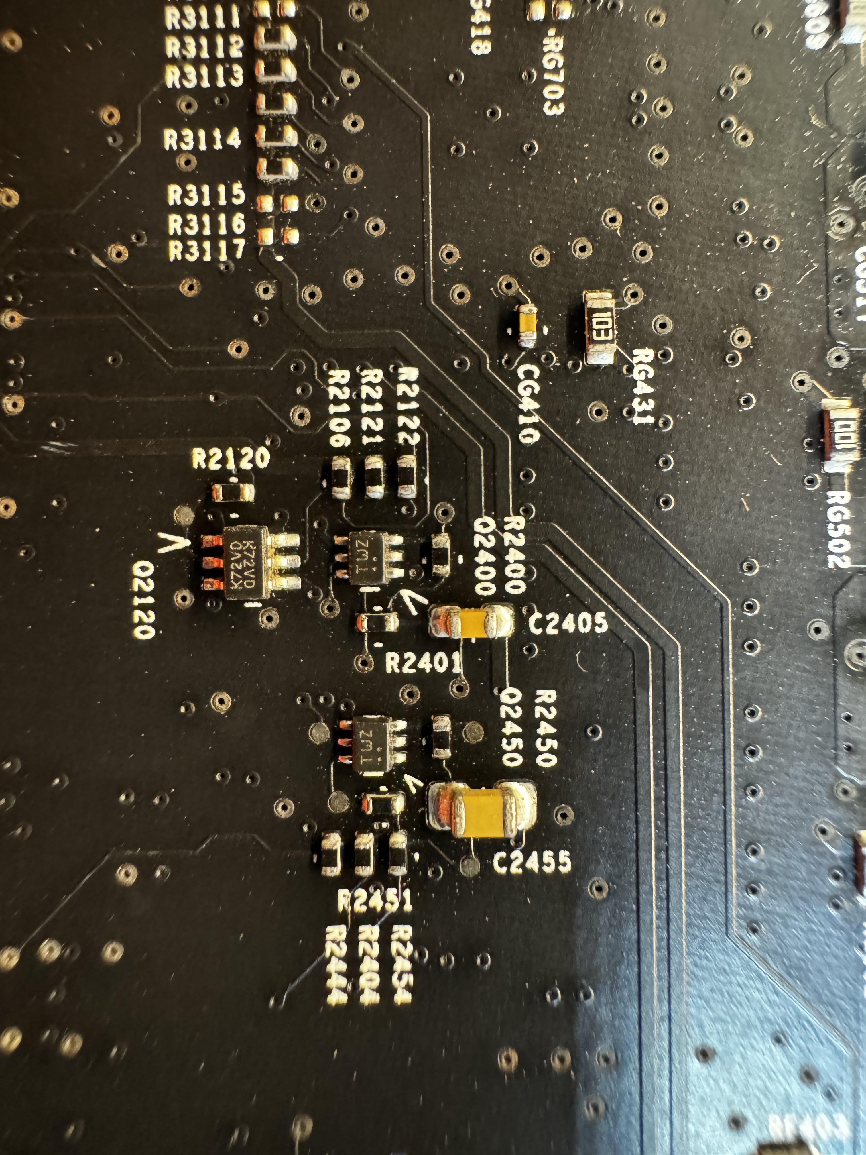

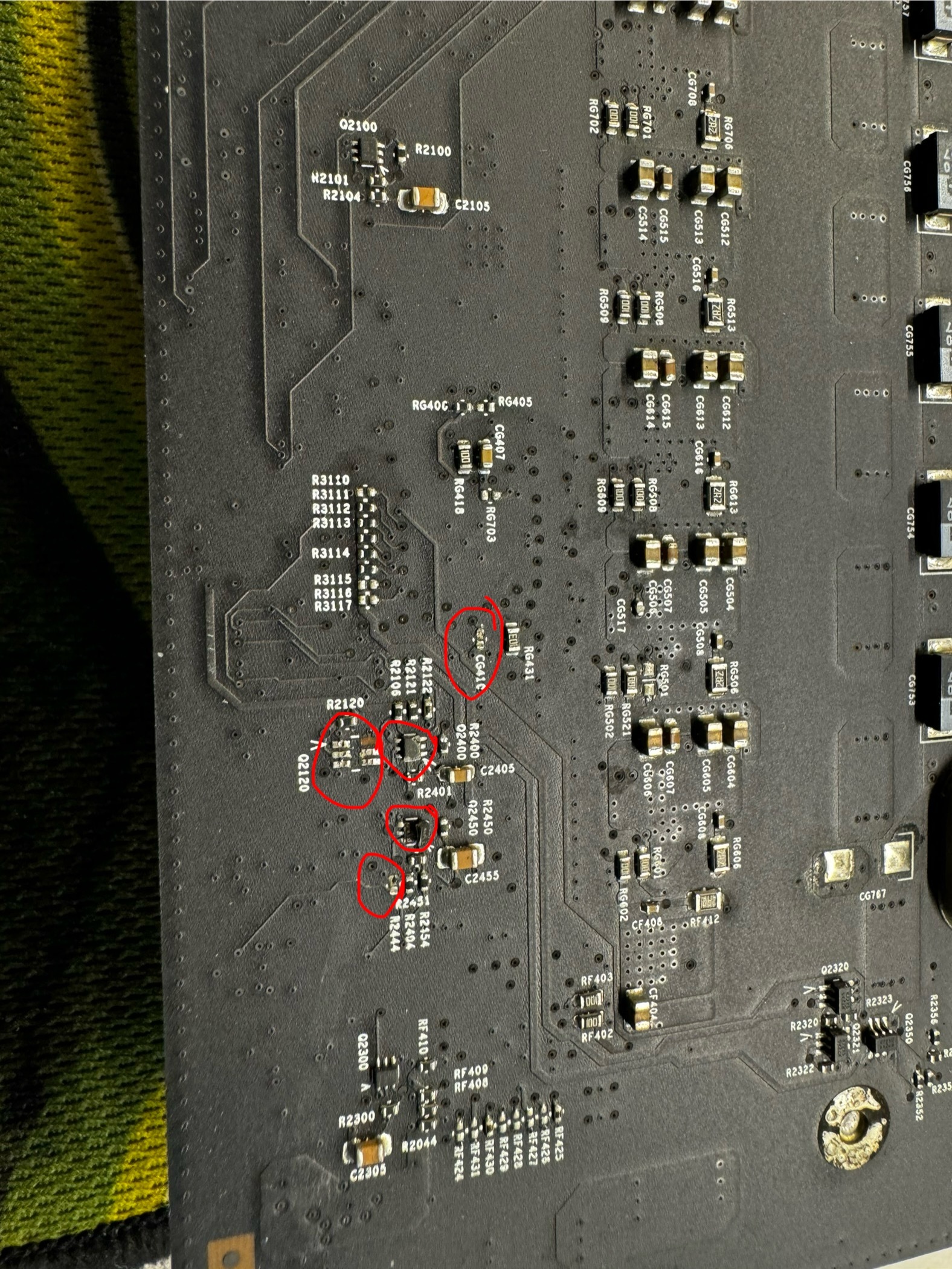

    Hey guys ,
    Need assistance with a Mac Pro 2010 5,1 single cpu , cpu tray .
    Ive bought the computer used , it’s really been through a hard time.
    Someone has managed to pull components off the bottom side of the cpu tray!!!
    I need assistance in identifying the components and the values of
    1. CG410(missing)
    2. Q2400(TWN. Marking on it) , Q2450(TWN. Marking on it) (this marking does not correspond to any specific IC as far as I can tell , need help to identify!l )
    3. Q2120 (missing) ,
    4. R2444(missing)
    Im attaching a couple of images of the section of the board they are on(I mean should be on , but a not there ).
    Any help would be appreciated.

    Mac Pro 2009, processor "tray" 820-2482-A
    For anyone else who might be on the same boat as me with these images r2444 is 10k ohm , q2400/q2450 is the (TW sot563) NTZD3155CG , q2120 is (K72 sot-363) is 2N7002DW .
