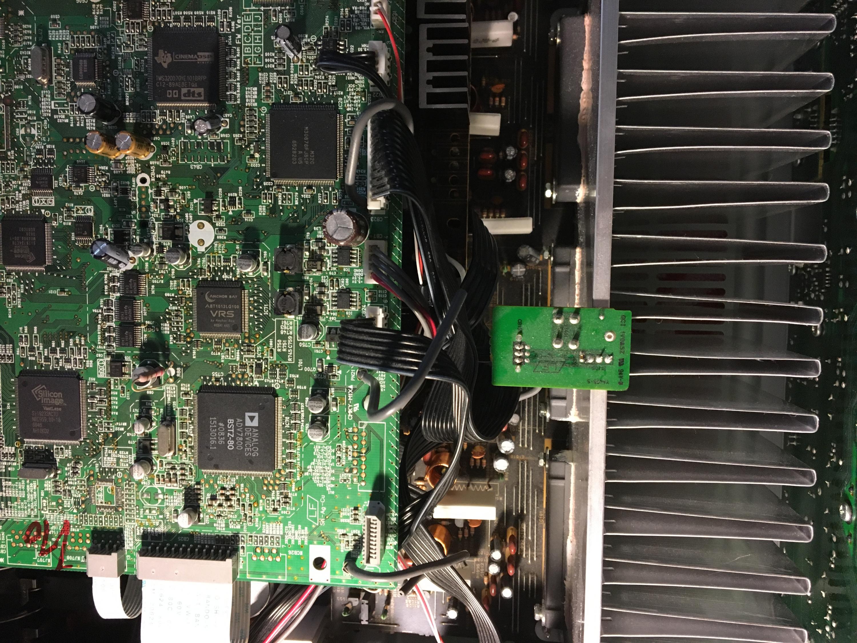

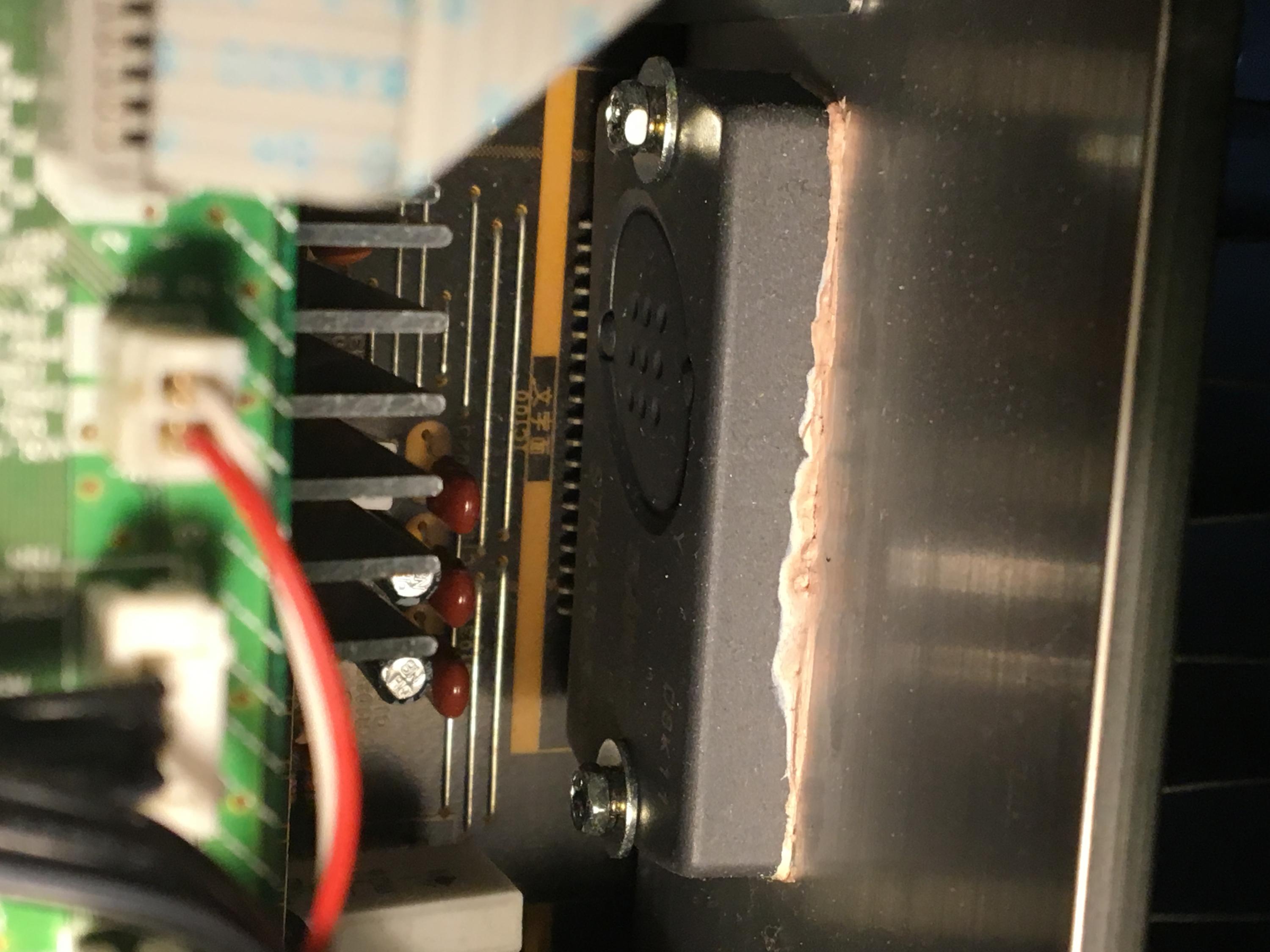

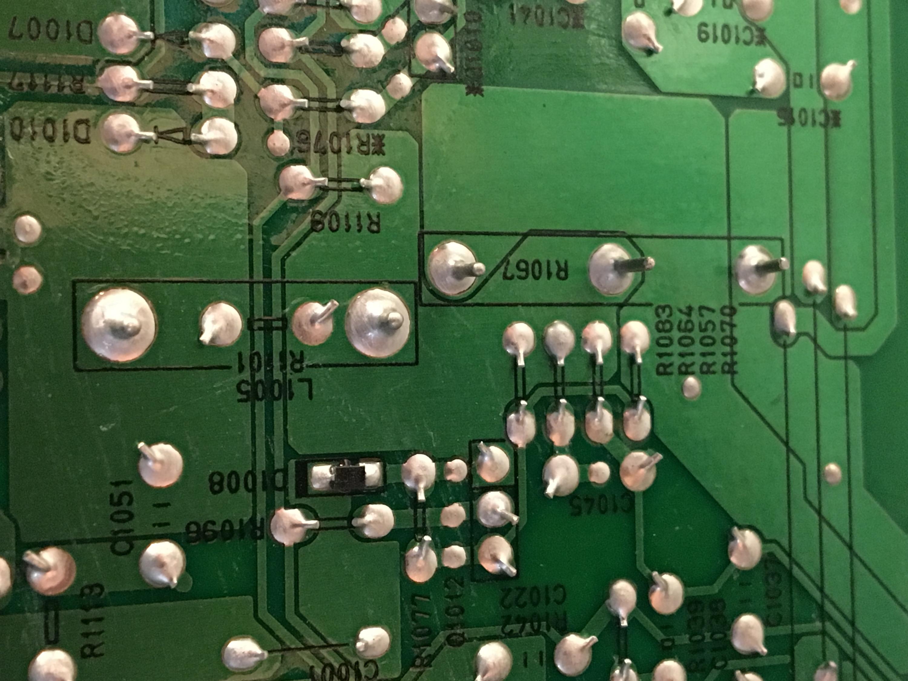

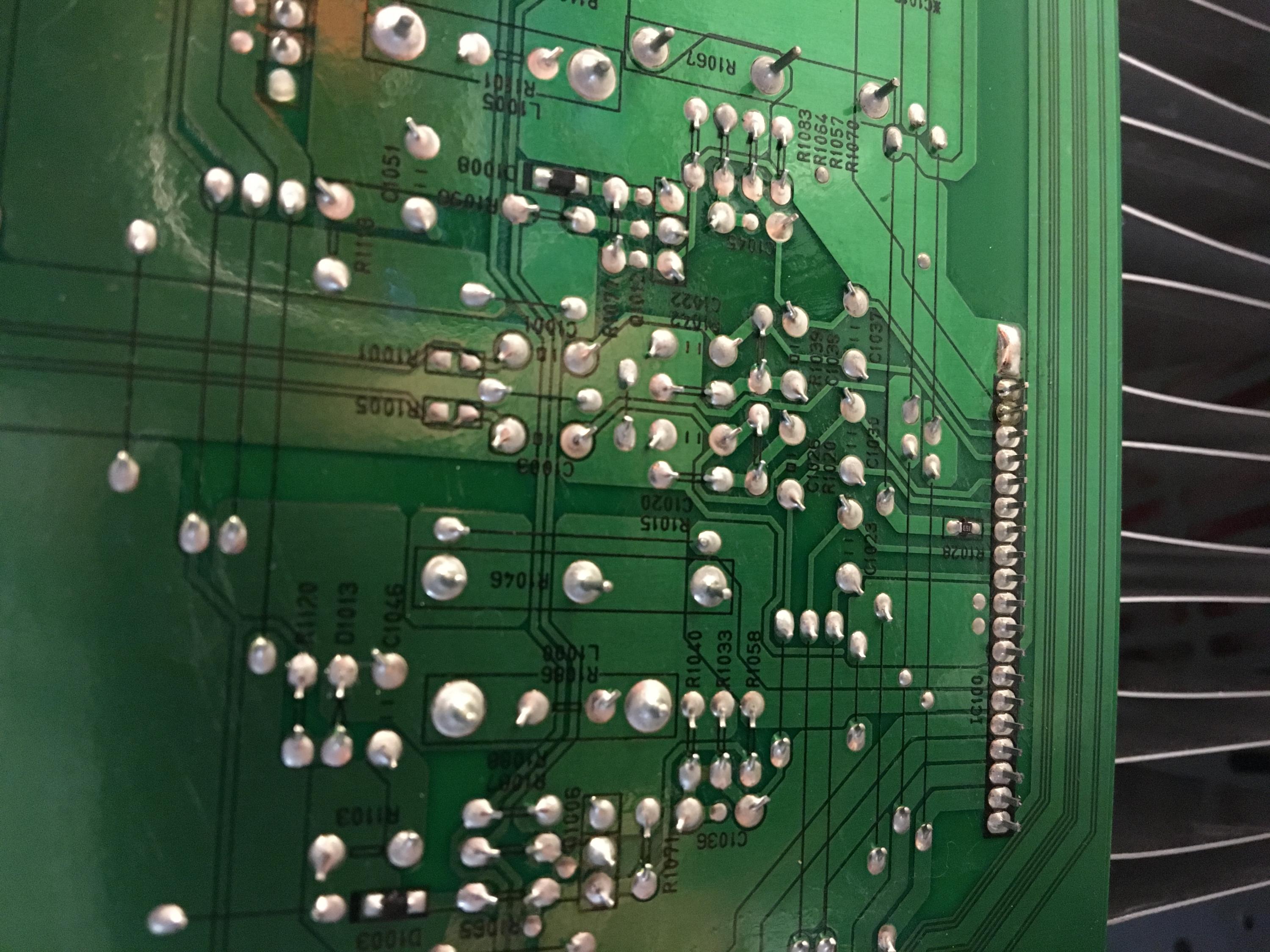

              [ATTACH]144281[/ATTACH]
              [ATTACH]144282[/ATTACH]
              [ATTACH]144283[/ATTACH]
              • linksys1127
                • Sep 2016
                • 121
                Re: Yamaha RX-V665 After 3 sec. shuts down
                Here's a pic of the three large IC's and the white ceramic resistors I checked for voltage during power-up. The one on the right is IC100. The one in question. Thank you again for your help on this!
                  Well, it flipped my picture. It's the IC on the top right.
                    Look at the PDF page 116. There are the three output bricks. R1068 is on the Right channel output. So if you have 50V on that (or pin 4 on the brick), the IC100 is bad.
                    You need to find a replacement brick.
                    IC100:
                    pin 4/5 right speaker output
                    pin 6/7 center speaker output
                    pin 18/19 left speaker output

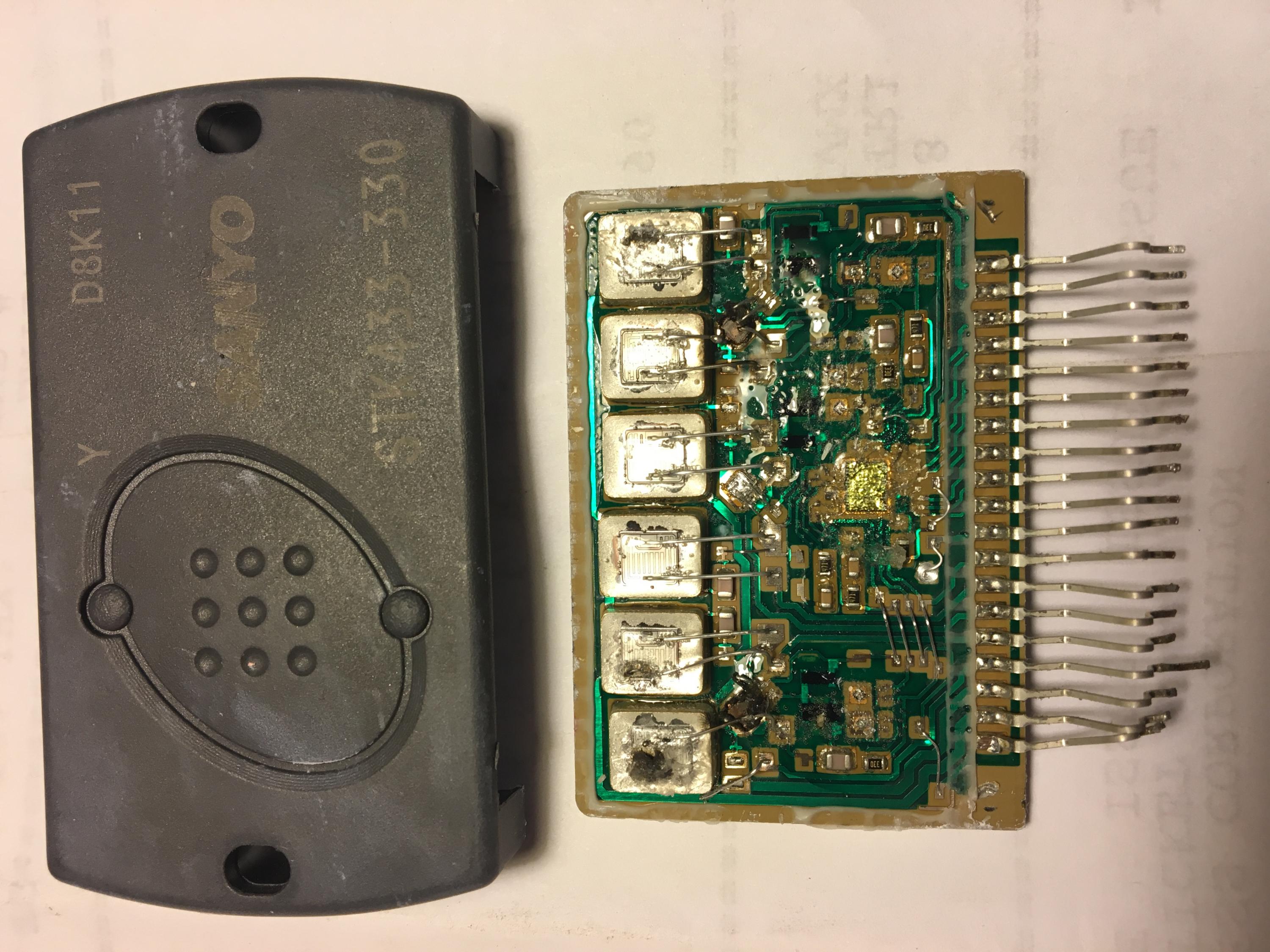

                        This is what the inside of the IC looks like. You can see several burned spots. Thanks to Capleaker's help in troubleshooting I replaced this IC and my in-laws are back in full surround sound. Thank you sir!
