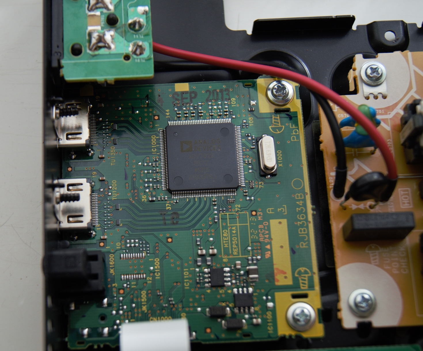

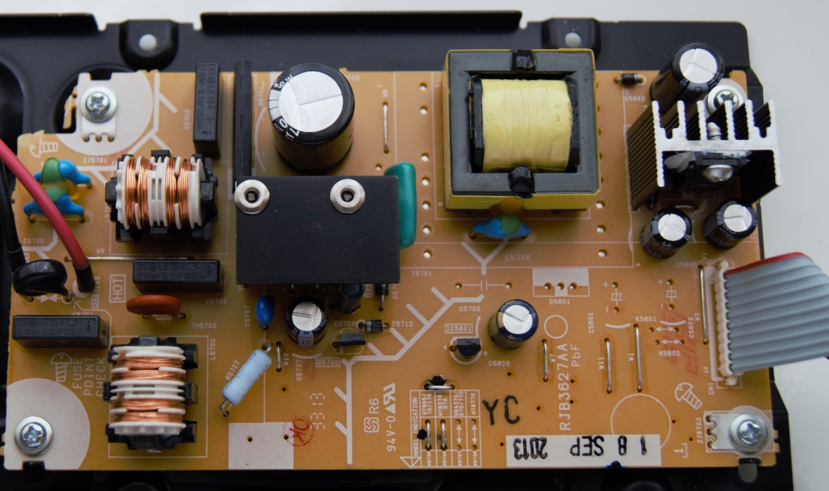

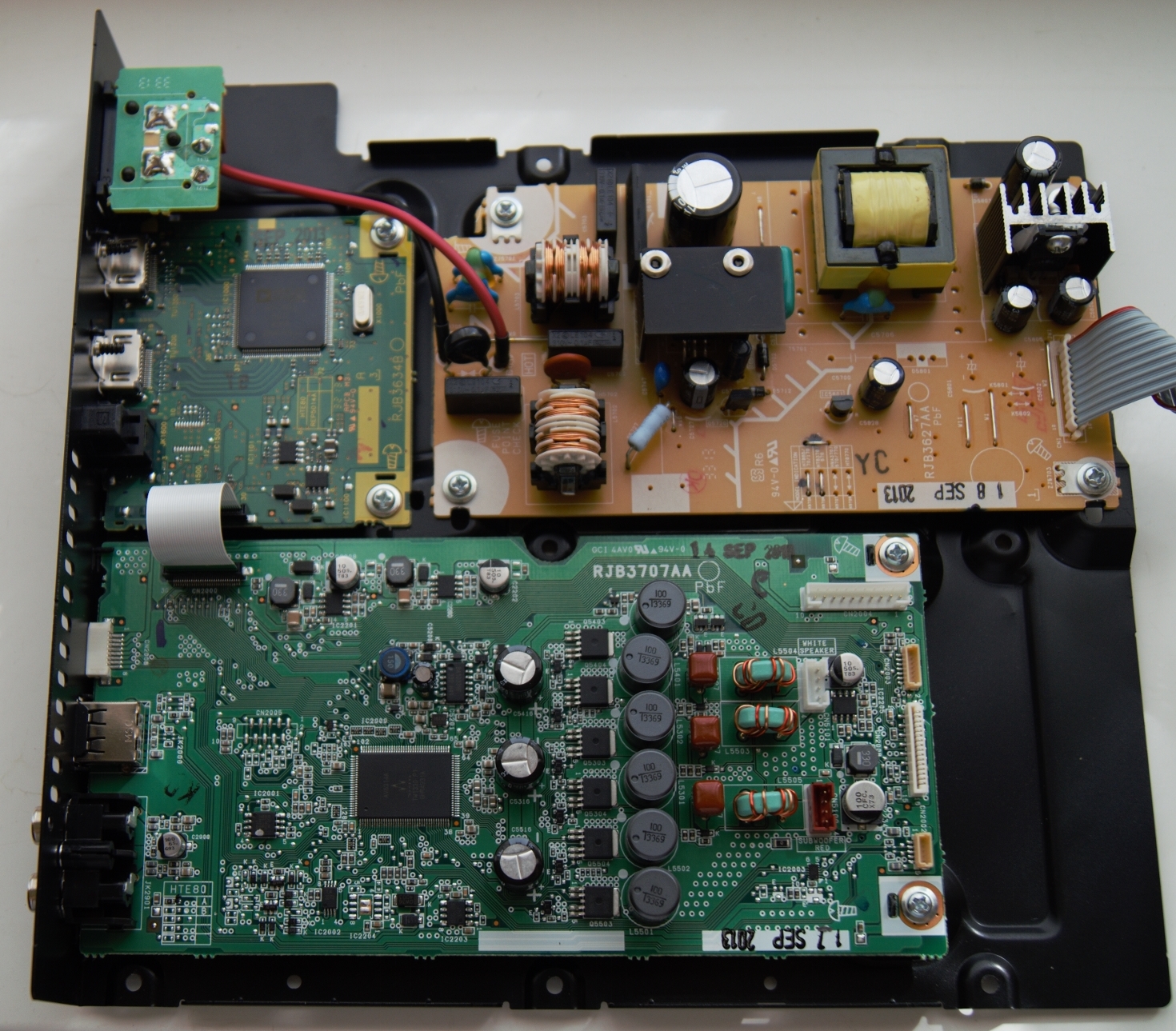

    Anyone had any experience with the F-61 error on these sound station / bars?
    It turns on then displays F-61, shuts down and makes a bit of a popping sound.
    Ive already replaced the Capxon caps as a couple were out of spec but problem still persists.
    From a google it seems an issue with the power / amp board, similar models a fan issue but this unit doesn't have a fan.
    Any suggestions where to look?

    Re: Panasonic SC-HTE80 Soundbar Error F-61
    The out IC faulty !F61

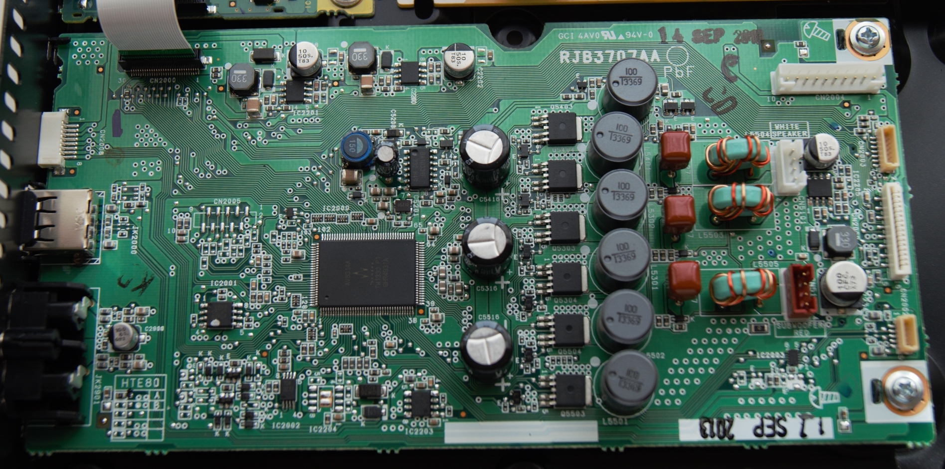

      Measure the 6 big transistors shown in the 2nd picture
        Amplifiers Error. Probably DC OFFSET.
        What are the P/N of those 6 output devices with 5 legs (middle leg is trimmed)?
