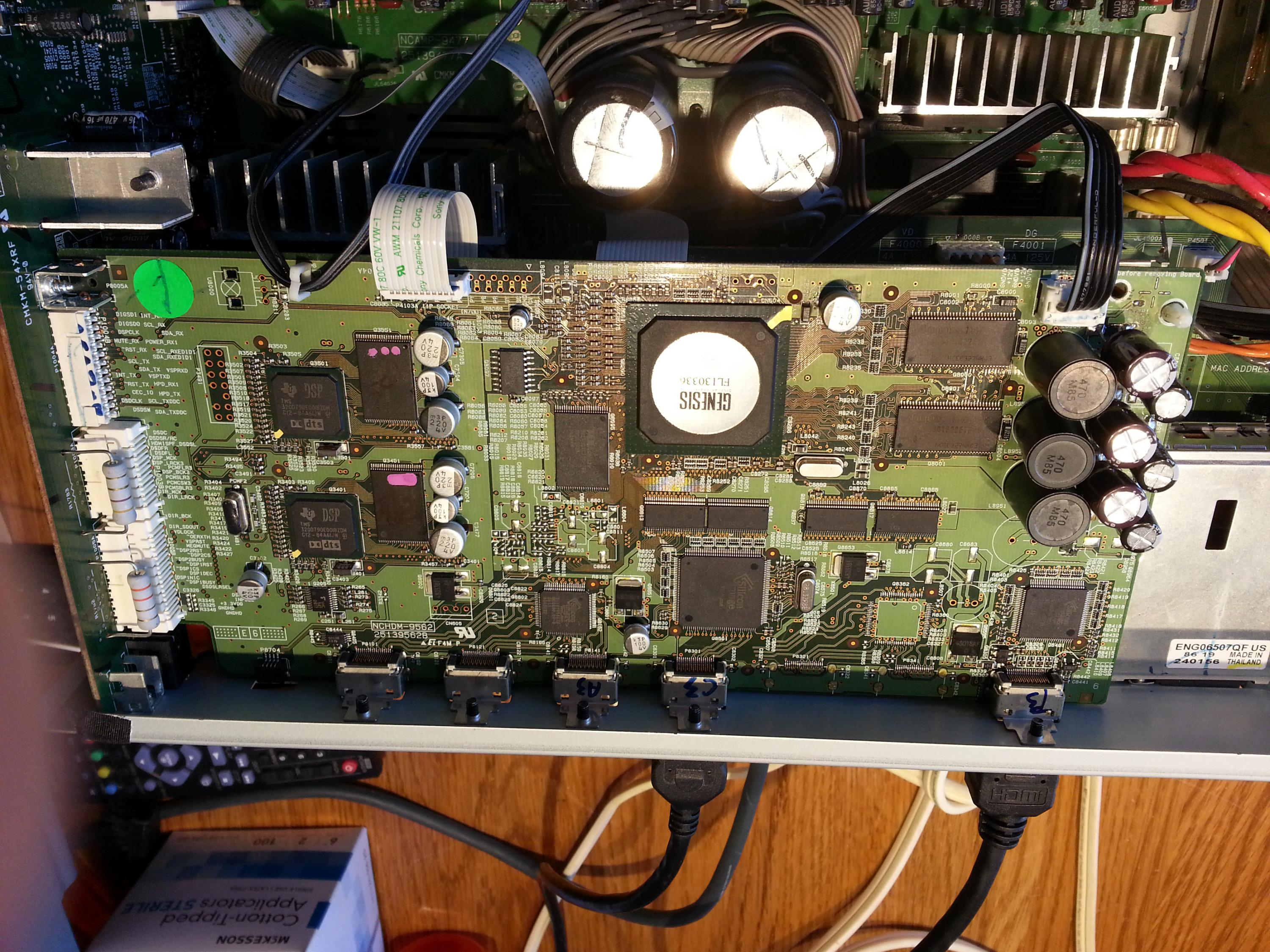

                        #31
                        Re: onkyo tx-sr706 hdmi board
                        pic of board

                          #32
                          Try HDMI pass thru option to see if you have video and we will go from there.

                              #34
                              If you have no video on pass thru, you need to check Q8162, Q8501 and Q8401.
                              Q8162 and Q8501 are multiplexer (input selector switch) and Q8401 is output for HDMI ports.
                              Since you don't have scope, let check power supply for each chip first, then clock and data.

                                #35
                                ok I have 1.8 and 3.3 volts on each chip. ok if I put the receiver in setup mode and if I press down on the genesis chip which I guess is the video chip, the setup mode comes on, I can read it, but it has streaks through it. I think the problem is the video out, not the input.

                                  #36
                                  The caps you need to replace are the 100uf surface mount ones, especially the ones across the voltage regulators. Others can also be bad as well like the 22uf's. The eeprom chip has a bad habit of wiping itself when the caps dry up causing no OSD but seems you still have.
                                  Double check your work on the caps you already replaced.

                                    #37
                                    Your dc supplies may look good because your dmm won't capture the ripple. Make sure to focus on the bottom of the board as well.
                                    There is lots of info out there on this if you google "onkyo hdmi switching headaches" for instance. Main thread will come up regarding the 606 and others but applies here.
