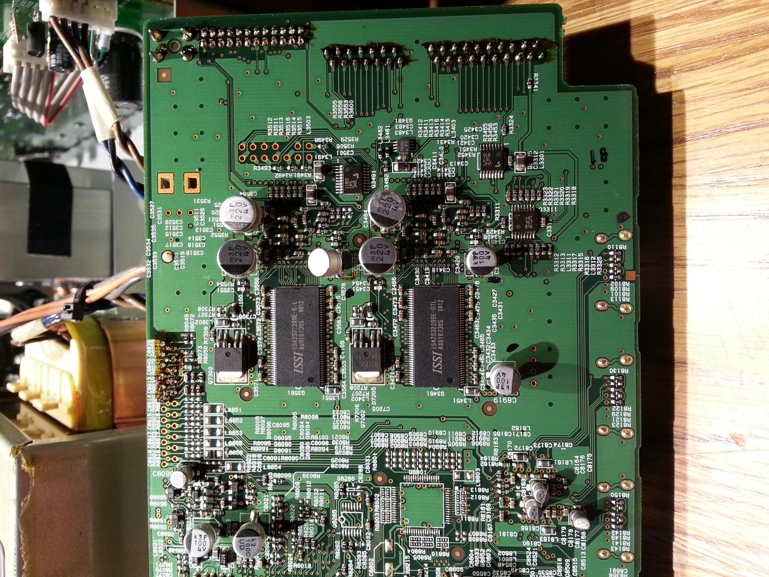

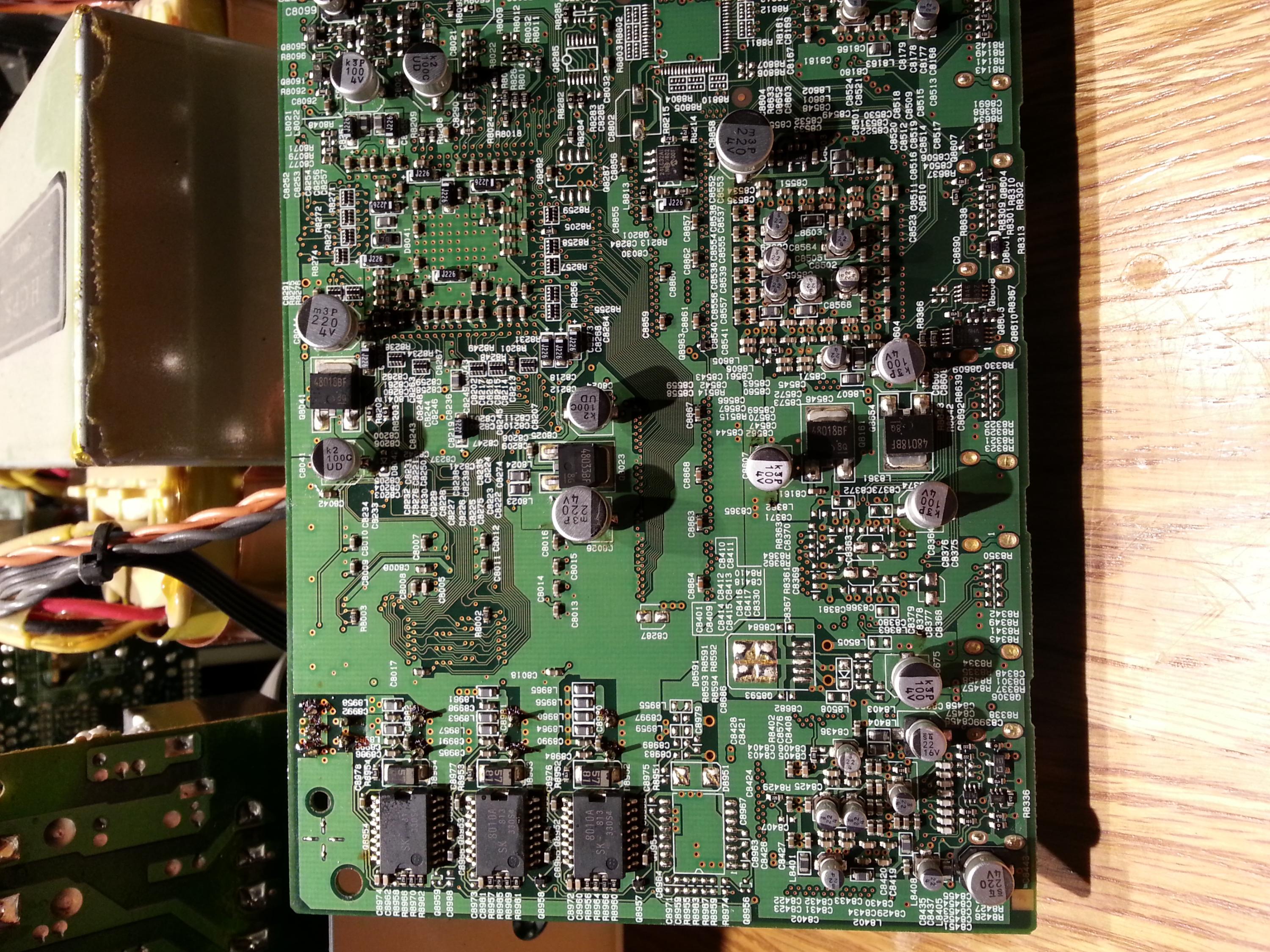

    Pic of the bottom side of the hdmi board ? And do you have an esr meter ?
      #42
      Re: onkyo tx-sr706 hdmi board
      I have cap selector on my fluke meter.
        #43
        pics
          #44
          Are you sure hdmi board you bought is a good working one?
          Since you had good audio on old hdmi board, which means the rest of other boards are good for audio.
          If you replace another good hdmi board, you should also have a good audio.
          Originally posted by harleyman58 View Post
          ok I bought another hdmi board. when I hooked it up I had video and very faint audio. I replaced all the 100x4v caps and the 220x4v caps, but I still don't have any audio. hdmi or radio. the first board had good audio but no video . this one is just the opposite. is there anything else I can change to maybe get audio?
          thank you kenny
            #45
            No I'm not sure the board was good. it was just for sale as is.the first board that I got with the receiver did not have any audio on it,but when I changed the caps it worked. I'm just asking what else I could check for audio. I did order an esr meter,it will be in sometime this week.
