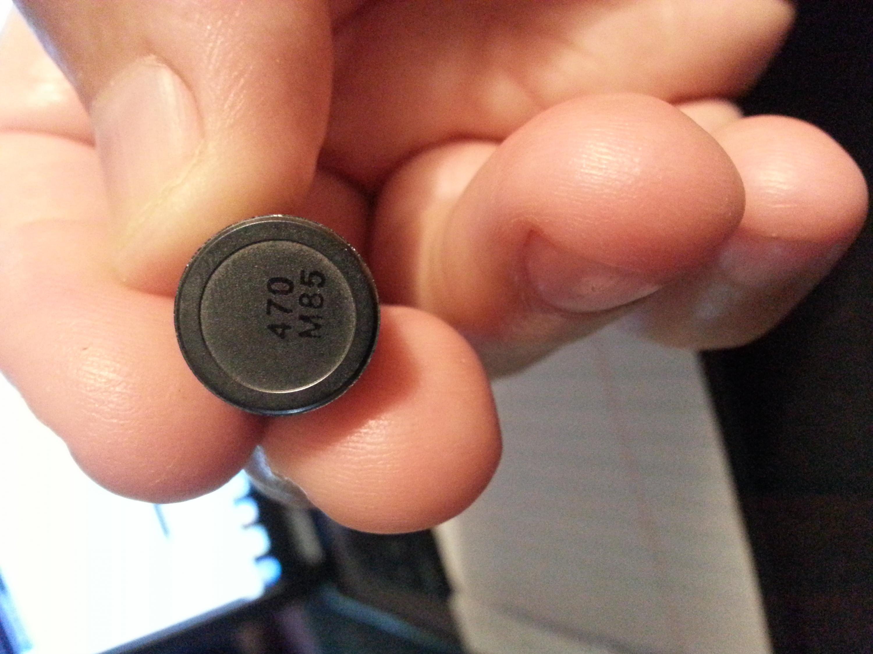

    ok I have some bad chokes next to the power supply input but I cant find the part does anyone know there I can get these chokes?
    rcp1317np470m fixed ind. 47uh 3.3a 69 Mohm ferrite core

    pics of the ind.

      Try digi-key, search for 47uH, then filter down to 69 mOhm.
      There is no thru hole part though, only surface mount.

        cant use surface mount, I have already went through all the normal channels to find the choke. digikey will order some but 100 pieces min, and 6 months order.

            Can we see the location where this inductor is used on the board?
            Does it show open circuit? Shows wrong inductance? It will show very low DCR.

              Can you tell the problem you are having with this unit?
              There are 3 power supplies for this board, 1.8V_CORE, 2.4VDSP and 4VHD.
              Each section has this coin for filter L8952, L8953 and L8954, so you can jump for testing purpose.

                  the number is l8953. it was broken off the board??????

                    I have receiver in dvd mode saying no signal, the speakers fl and fr showing output but no sound, or video. also no sound with radio,but no output on speakers lighting up.

                      L8953 is filter for 2.4V DSP which is power supply for DSP chip.
                      Try to make a jump to see if you get sound. Make sure you get +2.4V at this rail. BTW, check other power rails also.

                        I have 3.9 on the 4.0 rail , 1.8 on the 1.8 rail , 0 on the 2.4 rail with jumper. no sound

                          That's reason why you have no sound since DSP chipset and RAM have no power.
                          Check pin 11 of Q8953 (Vin) and pin 7 (Vout). Also check L8961, L8963 and L8957.

                                will this work for the choke? digikey #2000-470-v-rc-nd
                                  Yes, this part works. However, you need to work on 2.4V rail first.
                                  You can buy this part but it won't fix your problem since you have 0 on 2.4V rail.
