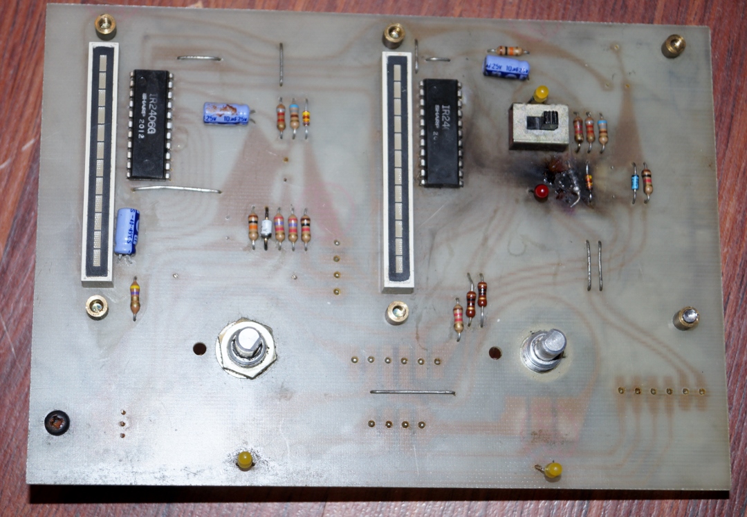

    Blown resistor, cant figure out what it was.
    So I wired amp back up wrong after taking apart to clean pot, one pin up on connector and have blown a resistor.
    have spent two hours staring at it and at screen of what is supposed to be the service manual but cant make heads or tails of it.
    Any help would be greatly appreciated.

      Re: Blown resistor, cant figure out what it was.
      It looks to me like it should be one of the 10Ω resistors which connect between the switch, and the left and right inputs.
      Edit: If this is even the correct schematic.
        Perhaps, but the other around it aren't 10ohm. You would think there would be 2 10ohm close by each other. Ill have to have a go at reading the ones in there again tomorrow. Heres the front of the unit
        The blown resistor is in between bridged mono stereo part

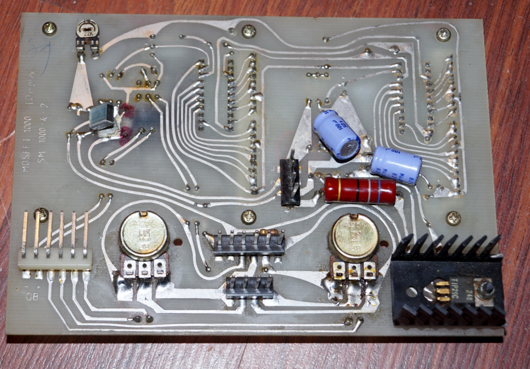

            Originally posted by budm
            Is that the complete circuit of the board? I do not see any 680 Ohms (two of them on the board) resistors in the diagrams.
            That's just the front panel board with the volume controls, I think schematic might be for a different model or revision. Its similar and looks familiar but a few things look off to me.

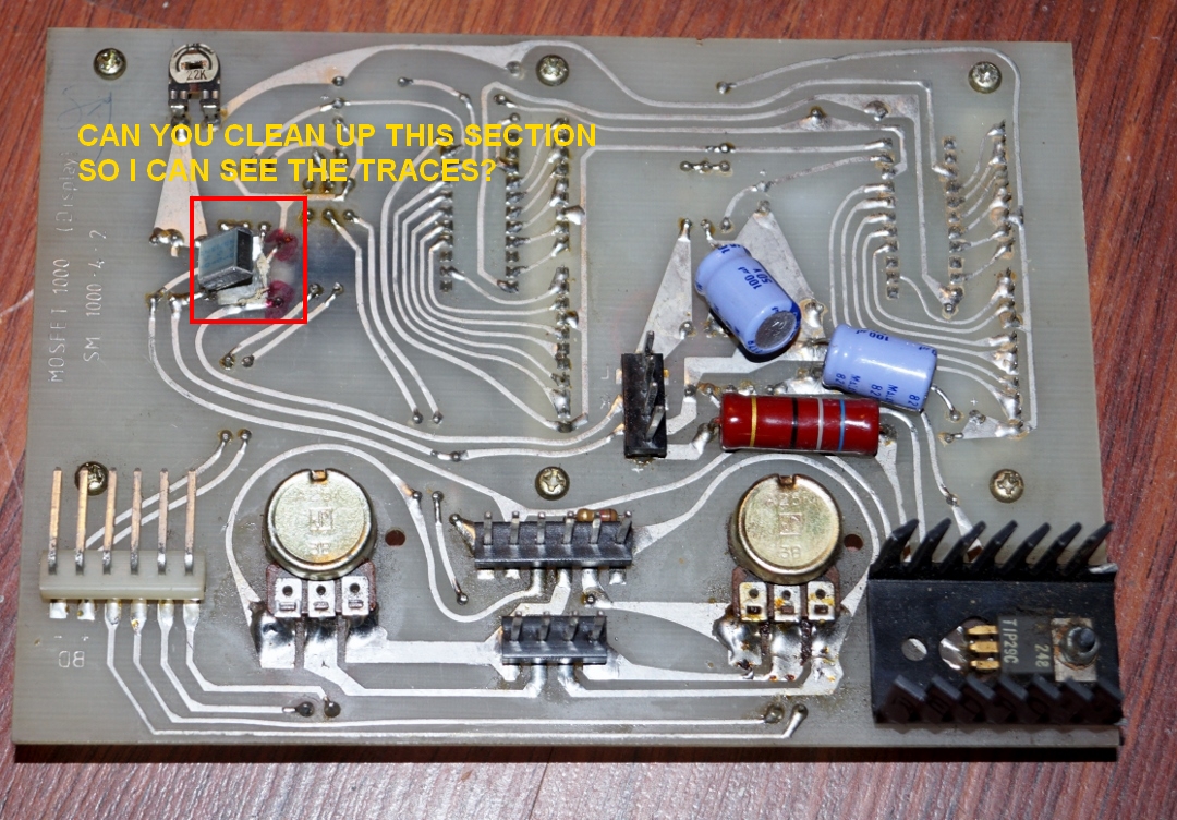

                Can you please clean up the section I marked so I can see the traces? The cap and the glue are in the way.
                    It looks like it bridges over to a pin on the switch

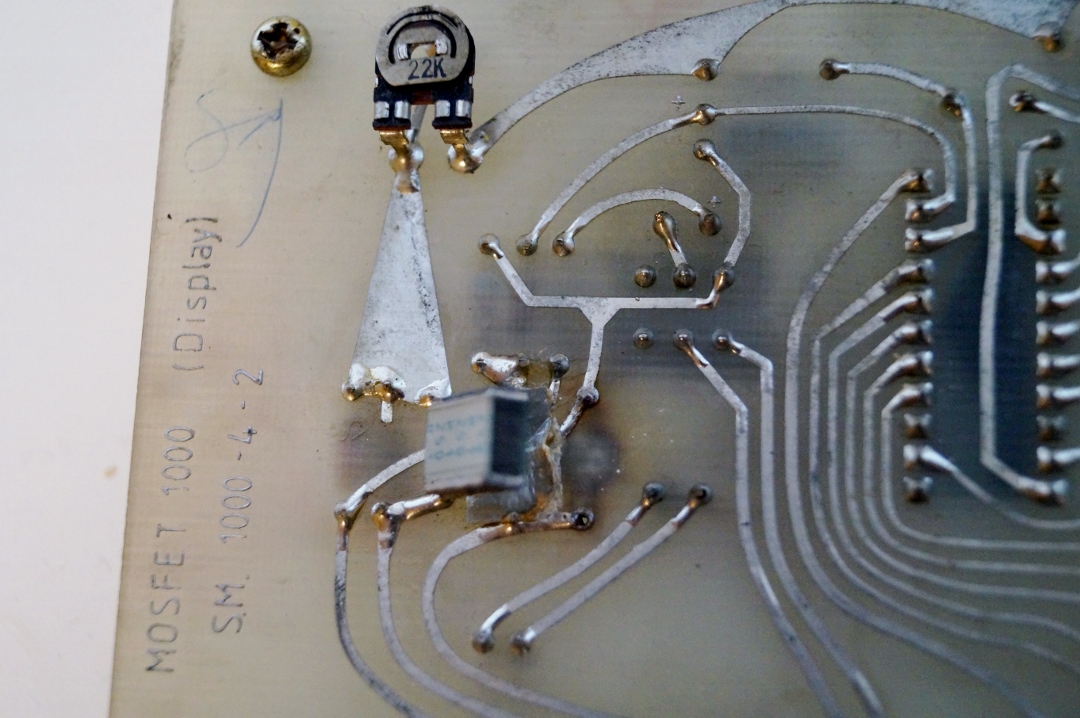

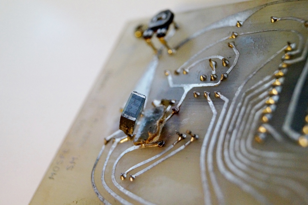

                      I'm thinking using the other half of the board I might be able to figure out what the resister was as looks like two half of the board. Looks like the resister is linked to pin 21 on the IC. So drawing a path on the board on each side should reveal its identity
                      This is how far ive got but sides are slightly different so struggling a bit
                      Edit think I'm nearly there found a similar patern
                        Am I on the right path here? Gets a little confusing on left hand side from the 25v cap and is a little different to the right hand side.

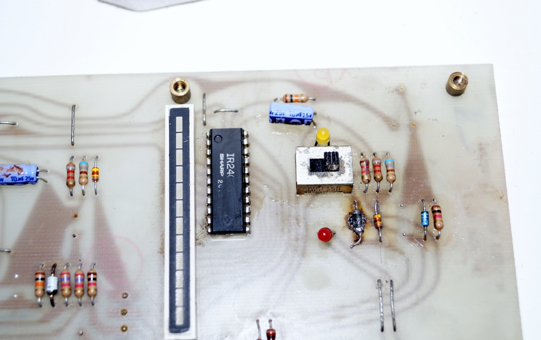

                          'Am I on the right path here? Gets a little confusing on left hand side from the 25v cap and is a little different to the right hand side.' As you can see, the burnt resistor one end is connected to the Negative leg of the cap and another end is connected to the second pin from the top of the connector. That was my thought too is that the resistor for the left circuit (looking at the bottom side of the board, will be the same as the one connected to the top pin of the connector but the top pin connector is connected to the Diode not resistor. I can trace the connection now since you have clean up the board.
                          The cap on the right has Negative to GND (PIN 3 of the connector) and the positive is connected to the pin 21 of the IC, PIN 21 of the left IC is also connected to the positive of the cap on the left.
                          PIN 4 of the connector looks to be for VCC.
                          The burnt resistor must be quite low value. Do you know what the VCC feeding that pin 4 is? Did you check the Yellow LED to see if it is OK?
                                What is the function of the slide switch?
                                  OK, after looking at your new pictures and my virtual PCBA, yes both L and R are set up the same, the resistor is 1K Ohms, one end of that burnt resistor is connected to GND (pin 3 of the 4-pin Black connector), the other end is connected to pin 2 of the connector, if you look at L CH, you will see that it also has 1K resistor between pin 1 and GND (3).
                                  The mistaken connection must have had high Voltage enough to burn 1 K resistor.
                                  Good pictures always make tracing the circuity much easier.
                                      Check the Diode next to the burnt resistor, the ICs are probably OK.
                                      pIn 21 is the signal input pin, the diode is for rectifying the audio signal.
