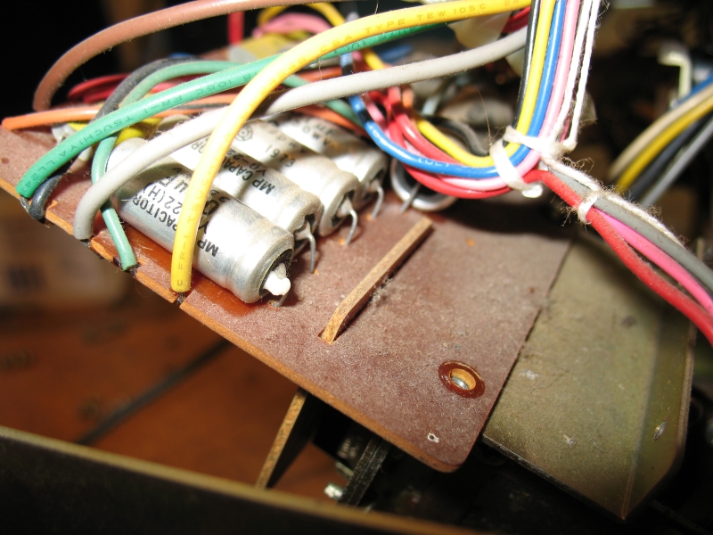

    I am working on an Akai GX-260D reel to reel that I need some caps for.
    The service manual calls the caps "MP capacitors". They appear to be bipolar electrolytics from 250-350v ac.
    The problem is, a couple of them are large multi-section caps that I can't find anywhere. The one I need most is 1uf/3uf 350vac, with radial leads.
    Can I replace these caps with mylar or poly ones?
    Also looking for the cover that goes over the heads.

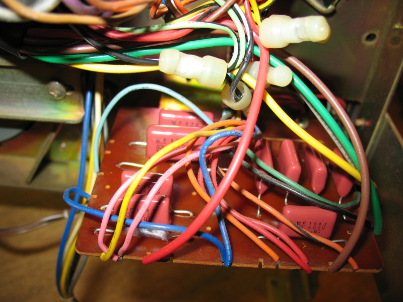

              Re: Akai Reel To Reel Capacitors
              I found what I needed at Digikey. I'm going to use Metalized Poly caps.
              See a quick video here:
              http://www.youtube.com/watch?v=gNVOpESi9uQ
              • Maxxarcade
                • Jul 2006
                • 973
                Some progress... Notice the leaking cap on the end
                Before:
                After:
                Now I just need to find some low DC leakage 10uf 50v caps for the audio circuits. They are UCC LL series now, but I don't know if Panasonic FC is good enough. The UCC LLA's are the only low leakage ones I can find, but they are hard to get. Digikey doesn't have them even.
