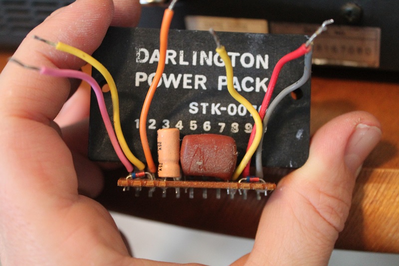

    hello:
    I have a sanyo plus-75 receiver i'm working on and i have been recapping the power supply board to remedy a fuse fault. seem to have narrowed it down to the Left power amp IC. the amp is an STK-0070 this is a picture of the power pack.
    https://www.badcaps.net/forum/attach...1&d=1429452486
    this is a picture of the schematic.
    i have a meter with the capacitance setting and plan to remove and test the caps on this small board.
    but how do i go about testing the IC itself?
    thank you.

    Re: Audio Power Output Module testing questions
    The only way you can check the STK is in curcuit with vboltage supplied mesure the out puts and compare with the voltages shown on circuit dia.

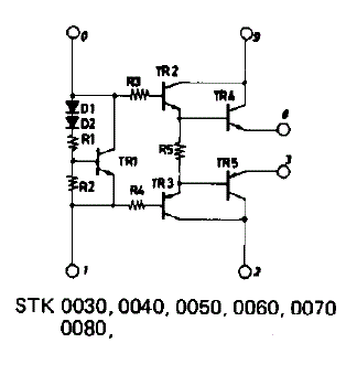

      You can check the resistance between Emitter and the Collector of the output transistors TR4, TR5.
      There should also be two low Ohms resistors for the output transistors that you also need to check and see if they blown open.

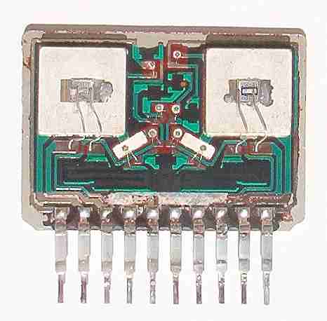

        I test STK's (out of circuit) using diode-test and schematics of the internals. Usually, output transistors short or open or both. Here's a pic of the insides.
        I have also seen shorts in the output STK's go back and damage the driver (i.e. STK3042/62/83) if your amp uses one. I also use diode test to find any faults there.

                the left channel module read 0 to .3 Ohms across both output transistors.
                the right channel module read nothing across both outputs.
                the left channel module is short so i will need to replace.
                I plan for the sake of balance to replace both the left and right.
                is the right channel module indicating a fault with no reading across the outputs?
                to my surprise i noticed that the right channel module is an STK 0080. the manual lists them both as 0070 so this must have been a repair.
                can you recommend the ideal replacement modules?
                thank you for your help
