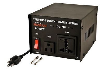

    Anyone does it, I have the schematics but there are quite a number of components to add?
    And the power transformer seems to be the killer
    Re: Converting RX-V373 110v to 220V
    Unless the primary side of the transformer has dual windings, then there is not much you can do.
    • R_J
      • Jun 2012
      • 9568
      Get a seperate step down transformer with the proper wattage and just use that.
