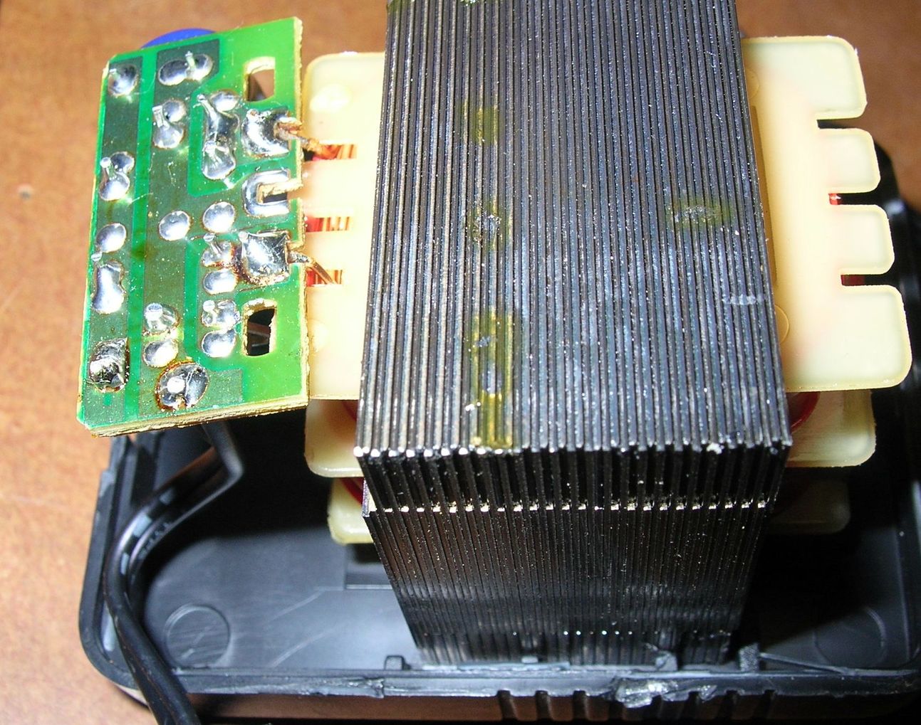

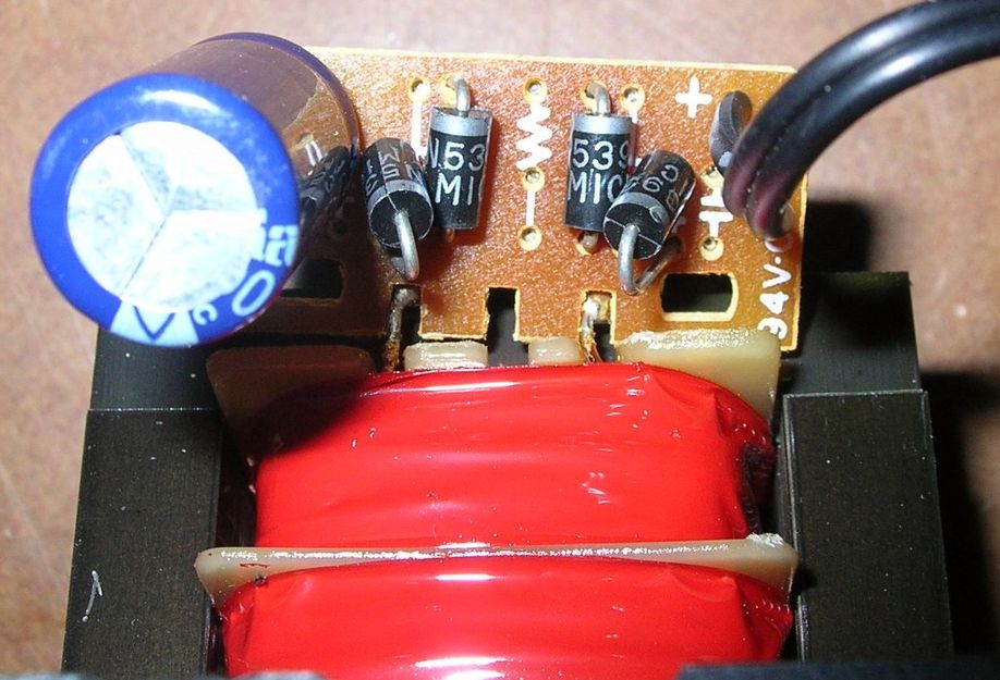

    I need an AC transformer because the one I used is burned. Since I have some unused DC transformers, I wonder if it is possible to just remove the bridge rectifier from it to convert it to an AC transformer. I measured voltage before the rectifier on this one - it shows 13 VAC, and 16 VDC at connector without load. Rated 12VDC 1000mA.

    yes remove the board and try a load test .

        This is not for electronic devices, just LED lights. I know it sounds weird since LED is meant to work with DC I have a set of garden lights, originally the wiring and power were for old iridescent bulbs, during the years I had it I changed it to LEDs, added more, replaced some, etc. A lot of it soldered to wires. I never paid mind to polarity since it still worked from the original AC transformer. But lighting killed the transformer after many years. I replaced it with another AC transformer. But one rodent chewed wires under the porch (not buried), at the soldering point. Not sure why. It had heatshrink tubing with adhesive on it - does anybody have any idea why the rodent likes it? I have a field near my house, blueberries, etc - Im sure herbivore creatures can't be that starving in the summertime. Anyway, it shorted wires and destroyed the transformer. I can resolder all wires to proper polarity and use a DC adapter, but this will be too much hassle and time-consuming. Getting an AC transformer is a lot easier at this moment (maybe one day I will get to it )
        I removed the rectifier from that DC transformer, and connected it to the lights - it reads 12.6 VAC, 0.42A (measured with a fluke clamp meter). One that the rodent killed was rated 12VAC, 1000mA, and connected to lights measured 14VAC, 0.50A. Is it OK to use it?

          I just opened the damaged transformer, and found a thermal fuse in it. Jumped fuse wires, plugged it in - it works I guess, I can fix it, just need to find a fuse.

            Re: Converting 12VDC transformer to 12VAC
            I would caution you against leaving it this way if you plan on keeping it plugged in the outlet 24 hours 7 days a week 365 days a year
            If you plan on using it like that put another thermo fuse back in for safety reasons
              I do not know what possess rats to be attracted to low voltage wiring but they are I have seen this a few times in the past
              As far as the question about the replacement transformer probably be ok but make sure that you are not over driving the LED lights current because as you know this kills them earlier than was intended even if this means that you put a current limiting resistor on each LED circuit
              Those transformer that you have in the picture above are terrible about over heating when loaded lightly I have some of the same type and I personally do not use them other than for testing purposes only
