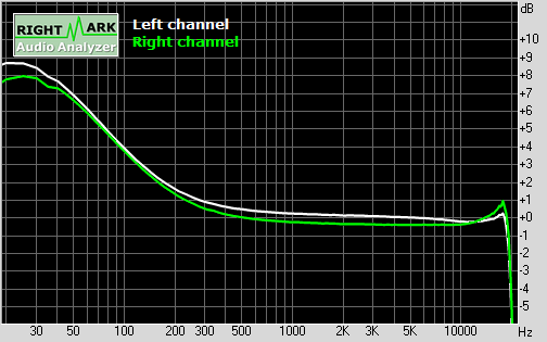

      I have found a few things that I can change. The coupling caps on the outputs of the sound chip are only 0.1uF, and my calculations with a 10K ohm load give me exactly the same result I'm seeing directly from the output of the op-amp. Next, I can remove the caps in the feedback of the op-amps and increase the value of the caps in the feedback for the speaker amp to get the bass boost where I want it. It's more of a midrange boost now. Finally, there is another RC filter between the op-amp and the TDA1515BQ that causes the big dip at 300Hz. I'm going to find some of those surface mount caps and resistors to take care of that stuff.
        Re: Improving sound quality from computer
        I can reduce the high frequency peak by putting a cap in parallel with the feedback network for the TDA1515BQ. It looks like a 2.2nF cap will be the best for that. I think I should try a cap in the feedback for the op-amp next.
        Also, putting a larger cap in place of the one that is already in the feedback for the TDA1515BQ reduces the low frequency peak, but the peak doesn't move like it did earlier. I don't know what happened.

            The problem with this amp is the op-amp mess on its input and the low-frequency peak in the frequency response. If I connected a good audio source to the input of the amp, it would have a more normal frequency response. The high-frequency peak seems to be caused by something in between the amp and the op-amp circuit. There's nothing wrong with the audio output from the sound chip either since the headphone output sounds good (aside from needing bigger input coupling caps).
              Here is what I get after bypassing the op-amp mess. The amp is now connected directly to the sound chip output. I also added 0.047uF caps in parallel with the caps in the feedback circuit. There really was nothing wrong with the amp or audio chip (even though this is an ESS chip).
              Unfortunately, the output is quieter now. I might modify the op-amp circuit so it works as a simple amplifier instead of the pointless mess it currently is. Actually, it might be a tone control circuit to get the best sound quality from the Compaq/JBL monitor-mounted speakers. I think I also increased the value of those caps too much. There is a little midbass missing.
