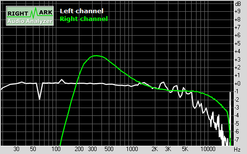

    Improving sound quality from computer
    The sound from my computer's built-in amplifier (based on a TDA1515BQ) is really lousy. The frequency response chart is the output from the amp with no load.
    I figured out how to take care of the bass boost, but I don't know where the dip at 300Hz or the peak at about 18KHz come from. My crappy speakers need a bass boost, but not at such a high frequency.
    I have a partial schematic that I can post later, but it is impossible to make a full schematic on a multilayer board. For now, you can make fun of the horrible frequency response. I didn't know RightMark had a "very poor" rating.

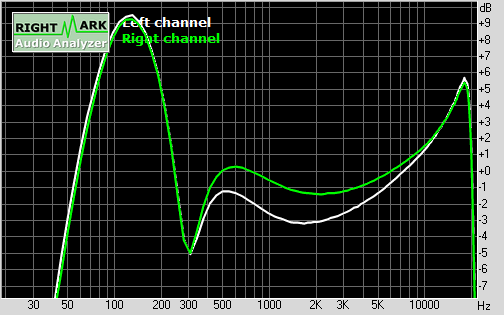

    I wonder how that response would look with, say, a 4 or 8ohm dummy-load resistor...

            Re: Improving sound quality from computer
            Looks like it's dominated by AC hum!
              What kind of software/hardware for the tool you are using to check freq. response? It looks interesting.
                That wouldn't be 150Hz. That is caused by the design of the feedback network for the amp, which resembles this:
                Increasing the capacitance moves that big peak to a lower frequency, but that also makes the dip at 300Hz worse.
                RightMark Audio Analyzer
                http://audio.rightmark.org/index_new.shtml
                I don't have access to professional equipment, but that is good for a free program.
                  Looked like it was right around 125 Hz.
                  I can't 100 percent tell with that graph.
                    I would like to see the graph with load (8 Ohms) connected. to get peak response like that has to two resonance happening. Simple RC filter as shown is just a low pass filter circuit, the higher the frequency, the less output you will get due to XC goes down and give more negative feedback. There must be something else in the circuits that causes the resonance to be happening. Are there ZOBEL network at the output of the amplifier?
                    http://sound.westhost.com/amp_design.htm
                      It is kind of hard to tell with the logarithmic scale.
                      It does have the Zobel network, and it appears to use the same component values as the circuit in the datasheet (4.7 ohm resistor and 0.1uF cap). The caps are surface mount ceramics, so they don't have any markings. I don't have any resistors that I can use as a load, but I could connect the speakers. It's difficult to connect everything since the output of this amp goes through a 3.5mm jack.
                      • lti
                        • May 2011
                        • 2551
                        With a load connected, the frequency response doesn't change much. Also, the input to the amp (the second graph - only the left channel is actually shown here) looks similar.
                        I'm guessing that the circuit was designed for the computer's optional internal speakers or the monitor-mounted speakers that were available for Compaq's monitors at the time. However, the amp circuit has already been modified because the original circuit had almost no output.
                          So the signal generator output sweep signal looks like that also? Also, the signal is measured right at the + or the - input of the amp? Should measure at the left side of the resistor feeding the input.
                            That was measured at pin 1 of the amp, which appears to be the inverting input. The test signal has perfectly flat frequency response. The op-amp circuit between the audio chip's output and the amp is the problem, and it's a huge mess. I don't know how it works at all.

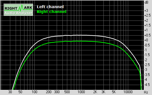

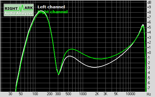

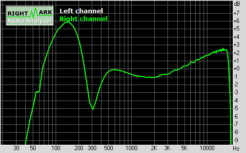

                                        Here are some more charts.
                                        On the first one, the white line is the output measured directly at the sound chip. It jumps around a lot because it was taken at a really low volume and contains a lot of noise. The green line is measured directly at the output pin of the op-amp leading to the TDA1515BQ amp. The second image is the frequency response of the headphone output with no load. This is driven by a TDA1308 clone.
                                        There is a big string of crap between the op-amp and the speaker amp, and the circuit for each channel is completely different. I think I just need to start over and design a new audio distribution circuit.
