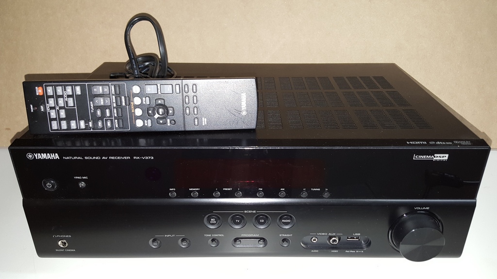

            #45
            Re: Yamaha rx v373 - no power
            All, I have a RX-V373 to sell for parts. At first was not booting, used the 10sec button press to start it, worked for a while, then stopped for good. Checked the transformer and primary power board... all good. I decided that I don't have more time to spend on this, so selling it.
                            Hi guys! For the ones who has the RX-V375, after suffering for hours, following circuits, tracks, cables, checking voltages, signals... I finally found out how to "fix" (it wasn't damaged, just locked) mine!! Just press and hold buttons TONE, INFO and POWER for 3 seconds (if it turns on in less than 3 seconds, don't release the buttons yet, hold them for 3s!), after that, turn the unit off on the Power button and turn it on again, it should work fine now (if nothing else is damaged inside). Good luck!
