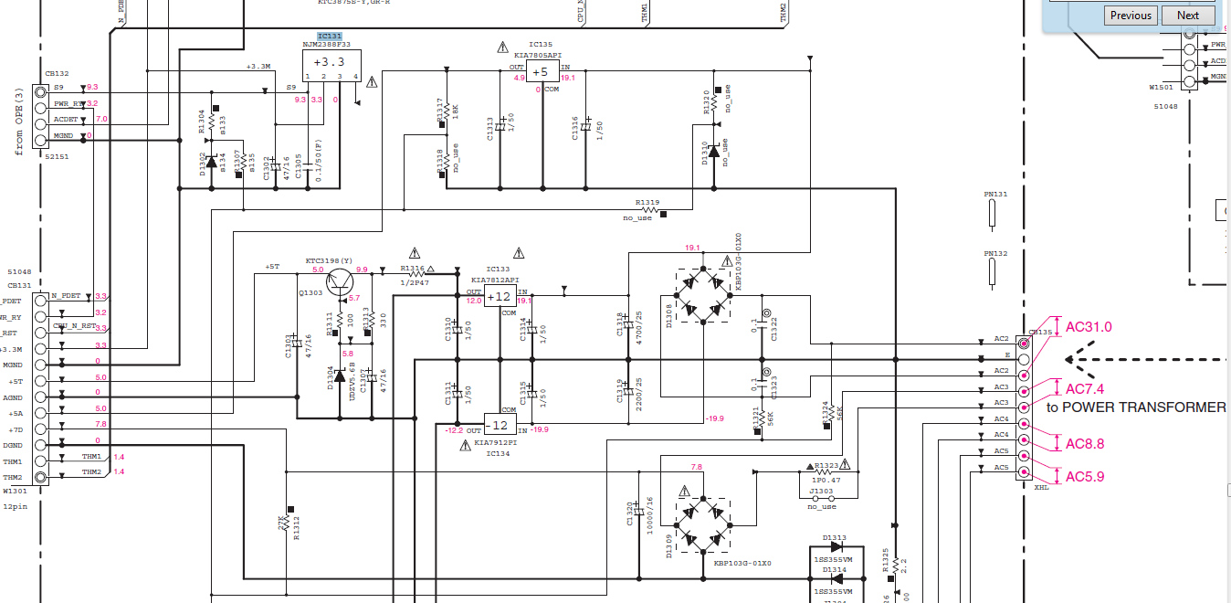

    I am still hunting this down but on IC131 the first leg shows 12 volts when i should have much lower. Anyone have any ideas. I have included schemetic to show all the voltage drops. I tried to look at the pwr_ry but confused on which ic is actually doing that job. i did test most of the IC's out and did a continuity on the legs and they checked out fine.

      Re: Yamaha rx v373 - no power
      I wouldnt worry about the regulator input voltage being high. The 3.3v output is the important thing.

              I am hoping someone here can give me some direction here. I am tracing the circuit trying to determine where the fault lies.
              SYMPTOM: Power on button causes relay SW151 to switch. About 1 second later the relay will switch back.
              REPLACED SO FAR: Capacitor C1507
              Here is the diagram:
              From my understanding of this transformer, I should be able to test resistance across the "gap" of T1501 (BLUE ARROW). When I test this I get 0.F on the display of the MM. There should be pretty heavy resistance across these paths correct? This is being tested in-circuit btw.

                            mmoore5533, I have a RX-V373 with the same problem, no power, relay clicks on/off immediately. I found that 3.3vdc supply to IC225 pins 120 and 121 was shorted, causing it to go into protect. Holding down "INFO" AND "TONE CONTROL" while plugging in AC cord cause ac power relay to click. Still trying to find short, I really need diagram of the HDMI/CPU circuit board layout. Do you still have the schematics?

                                    Thanks for the service manual, mmoore5533. I found the short was in IC202, the HDMI receiver. I tried applying 3.3vdc to the circuit trace after removing Digital board from the unit and the HDMI IC started getting hot, drawing over 5A!

                                          It is a Silicon Image SiI9573CTUC, but there is no listing in the parts list. I would not look forward to changing a SMD 176-pin IC.
