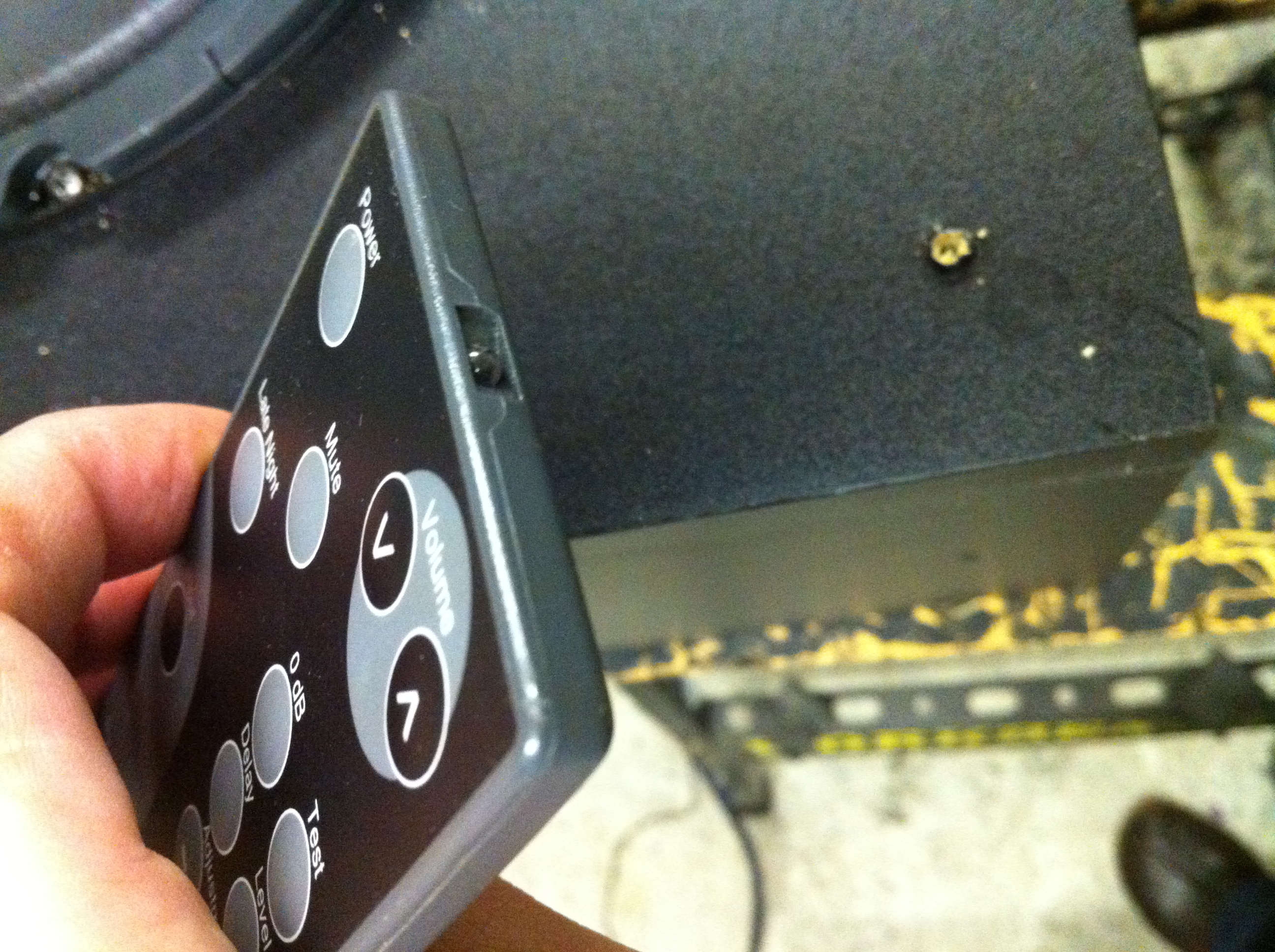

    Now, when i try anything from the remote, it doesnt work at all. Its one of those wee credit card remotes so there isnt much scope to pull it apart and see inside either.
    I did however check it out in front of a camera and could see the little IR light flashing, all with anew battery but still, it wouldnt do anything to the unit, even if basically touching the IR receiver eye.
    Would appreciate any thoughst on testign the actual output of the remote or likewise, testign what the little receiver eye is putting out in response to the ir signal.

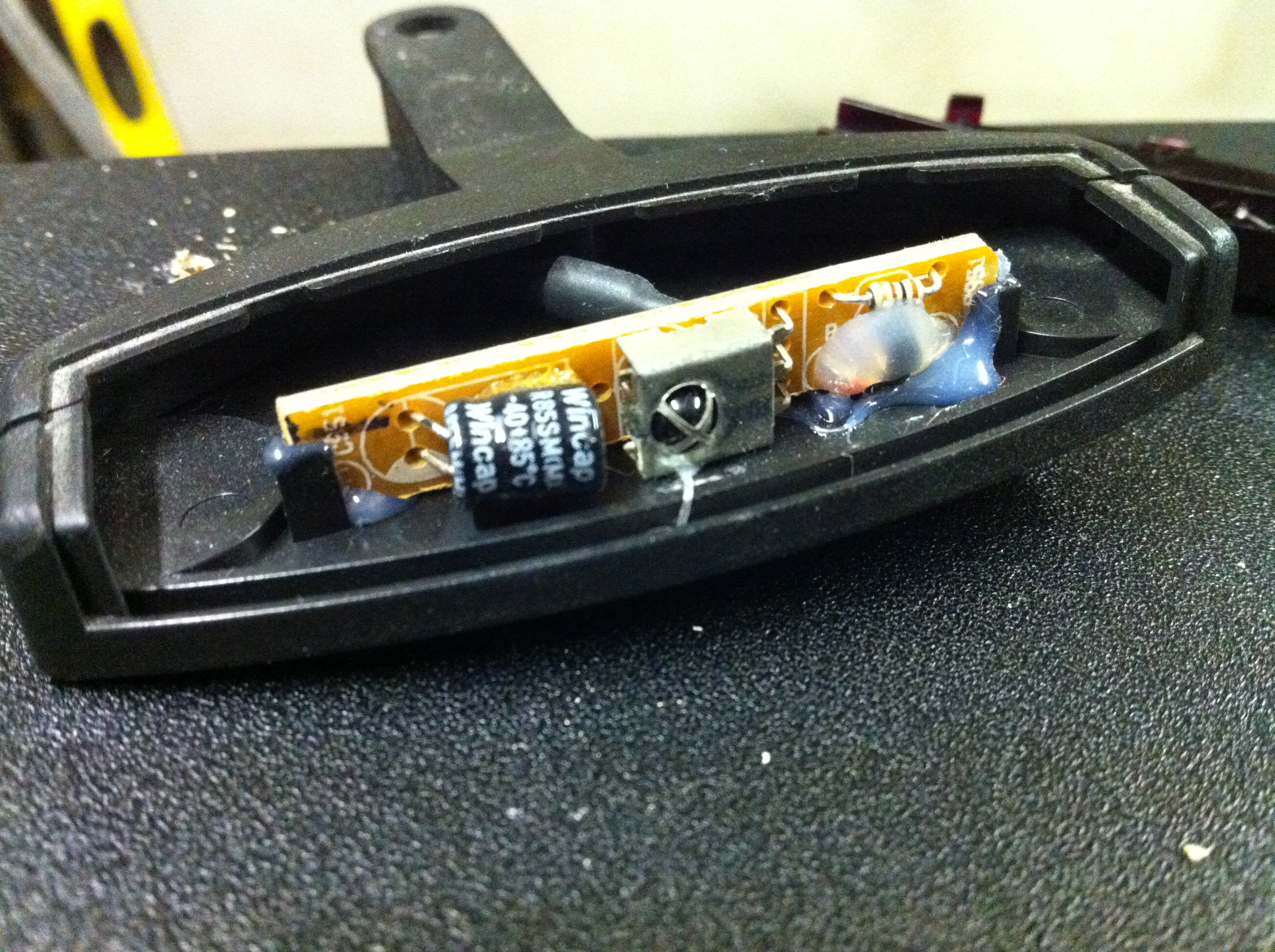

        On the remote receiver, one leg will be ground, one will be the B+, and one will be the output. Put your meter in AC mode and monitor each pin to find out which one is the output pin, you should see the readout on the meter jumps around on one of the pin when it receives the signal from the remote, signal will not be big, but if you have a scope, then you will see better signal wave form.

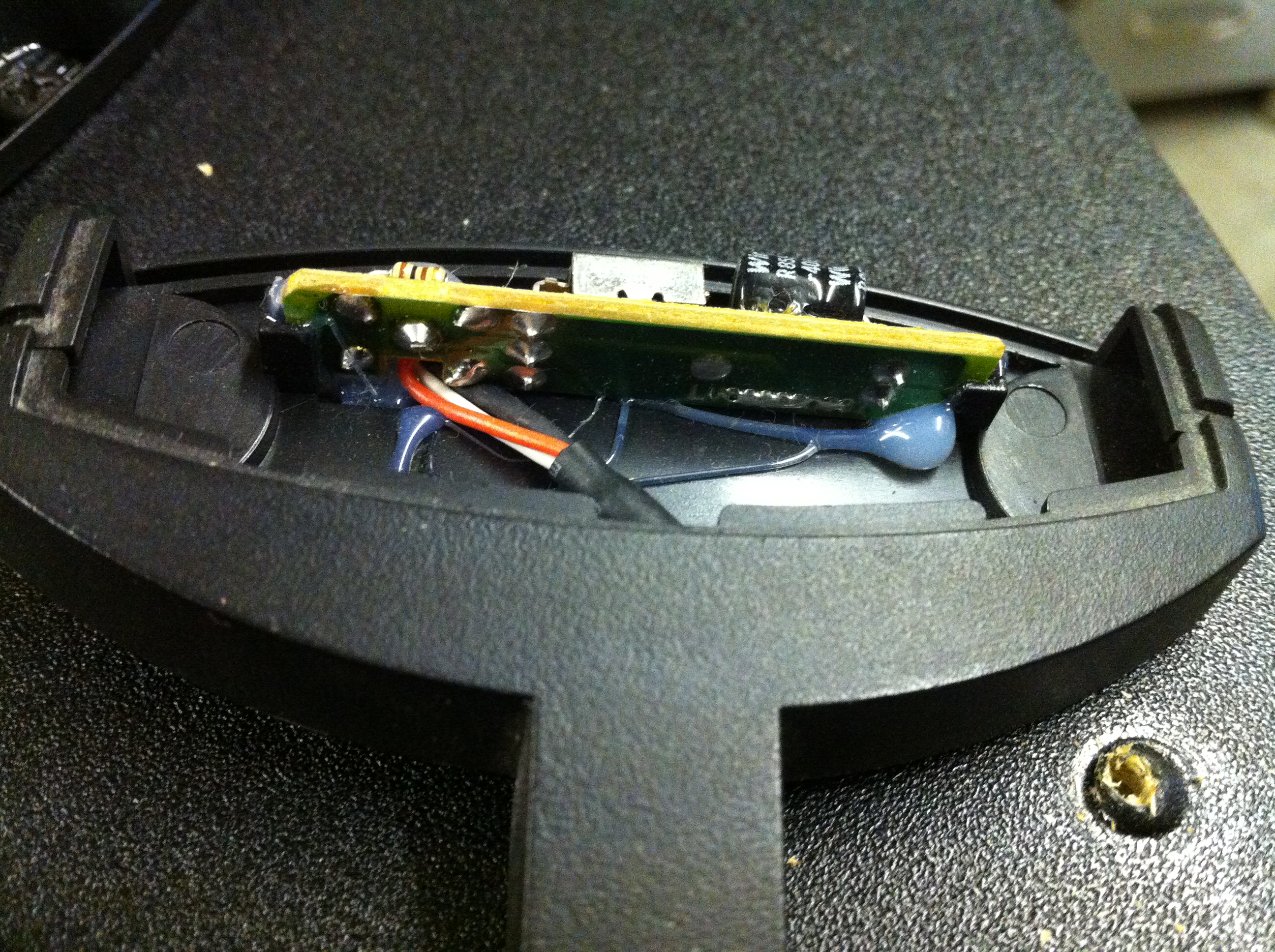

          Re: JBL Home Cinema Problem - advice?
          OK, dropped a few pics here for you to see, sorry if they are huge. Still getting to grips with a cyanogenmod touch pad.
          The original failure was that the remote wouldn't turn the volume down, that's all. This is what made me originally think that it was a remote issue. Common sense would have suggested that at that stage, I look at the ir sender in front of a camera to see if there was an output but I didn't do that I'm afraid.
          However, all remote functions seem to be putting a signal out right now
          Could it be that this is just garbled?
          I should also clarify that I am far from being good with electronics but as ever, I am keen to learn and have a go
          But bear in mind, I have the soldering skills of a gorilla on speed :-)
          I do have a solder station though just not a very fine tip, will try to source one today
          I must say that the solder joints on the ir receiver look OK, no dry joints or cracks that I can see with the naked eye

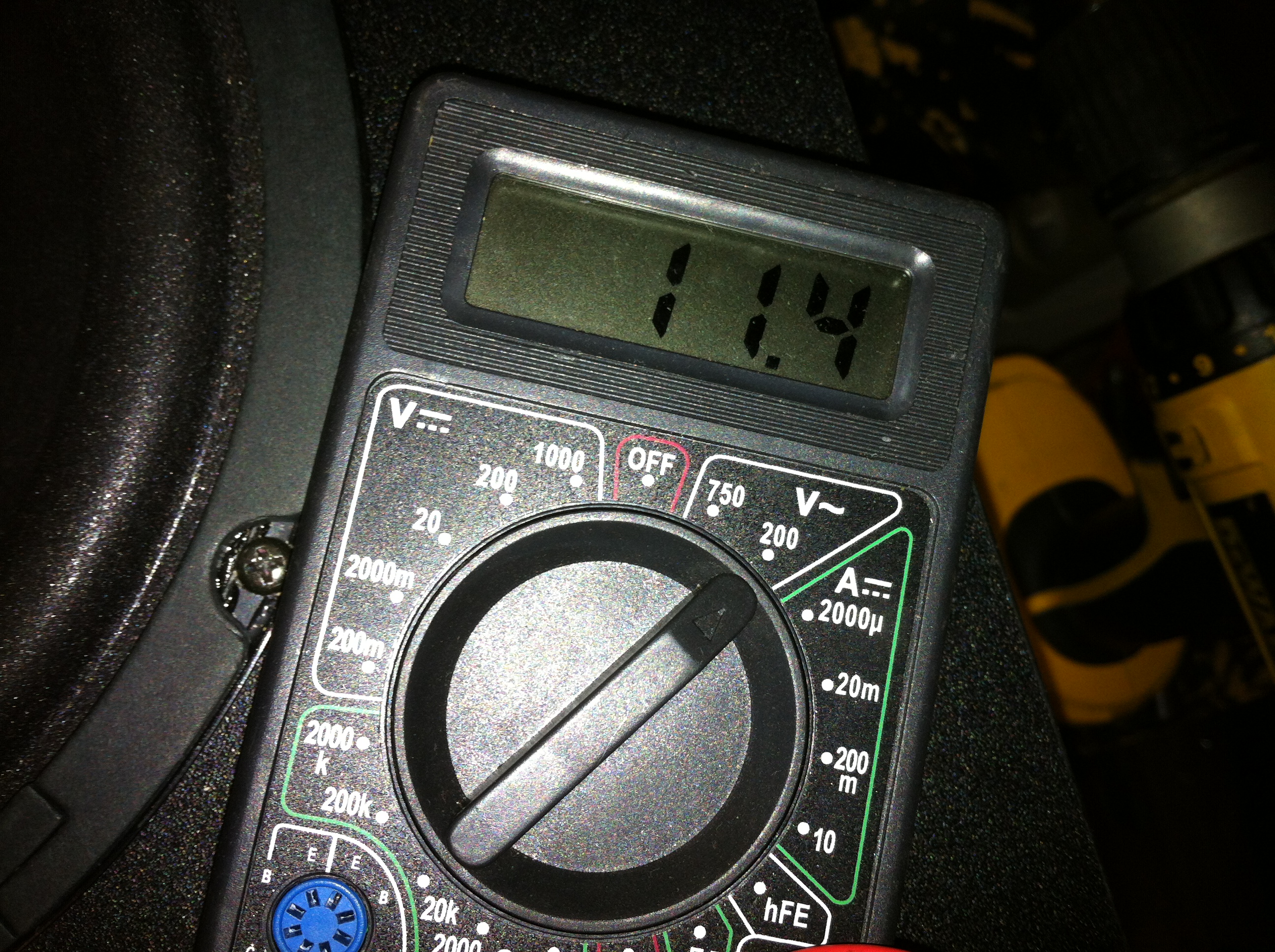

            OK, so I took my little (cheap) multi meter to the ir receiver last night.
            I found that the middle leg of the IR receiver component seemed to be earth, correct me if I am wrong.
            So, I set my multi meter to 200v ~ which I am assuming is AC?
            OK, with black in the centre pin and red on the top pin, I saw about 11.4 v with no change upon the remote being pressed
            With black on the centre pin and red on the bottom pin, I saw 11.4 again which dropped to 8/9 when the remote was pressed
            Does that sound like normal behaviour for an IR receiver?

              Try measuring it using the DC setting.
              Another possibility is that there could be a loose connection in the wire/connector that connects the remote receiver to the amp. Over time bad connections usually get worse and worse. Ofc, capacitors will too.

                I use AC mode on 2VAC scale, if you see changes every time it sees the remote signal, then that is an output pin, black probe should be on the metal chassis. Basically, it is seeing IR signals from your remote.

                        Now, I dropped the meter to the DC setting and I say the same behaviour albeit with power values of 5 ish volts.
                        So, if the top pin maintains steady voltage and the bottom fluctuates, we are saying the it receiver is behaving as expected?
                        Does this start to shift blame to the remote or the processor within the unit itself?
                        How likely is it that the remote will be putting out a faulty signal but a signal nonetheless?

                          Sorry cad....I pulled the remote apart and it is minty fresh inside

                            Likely. The ceramic resonator or crystal could have cracked and now it's working on the wrong frequency. I have a remote for my Samsung TV that didn't work anymore after it was dropped. It definitely puts out a signal, but the TV doesn't pick it up. A new remote worked fine.
