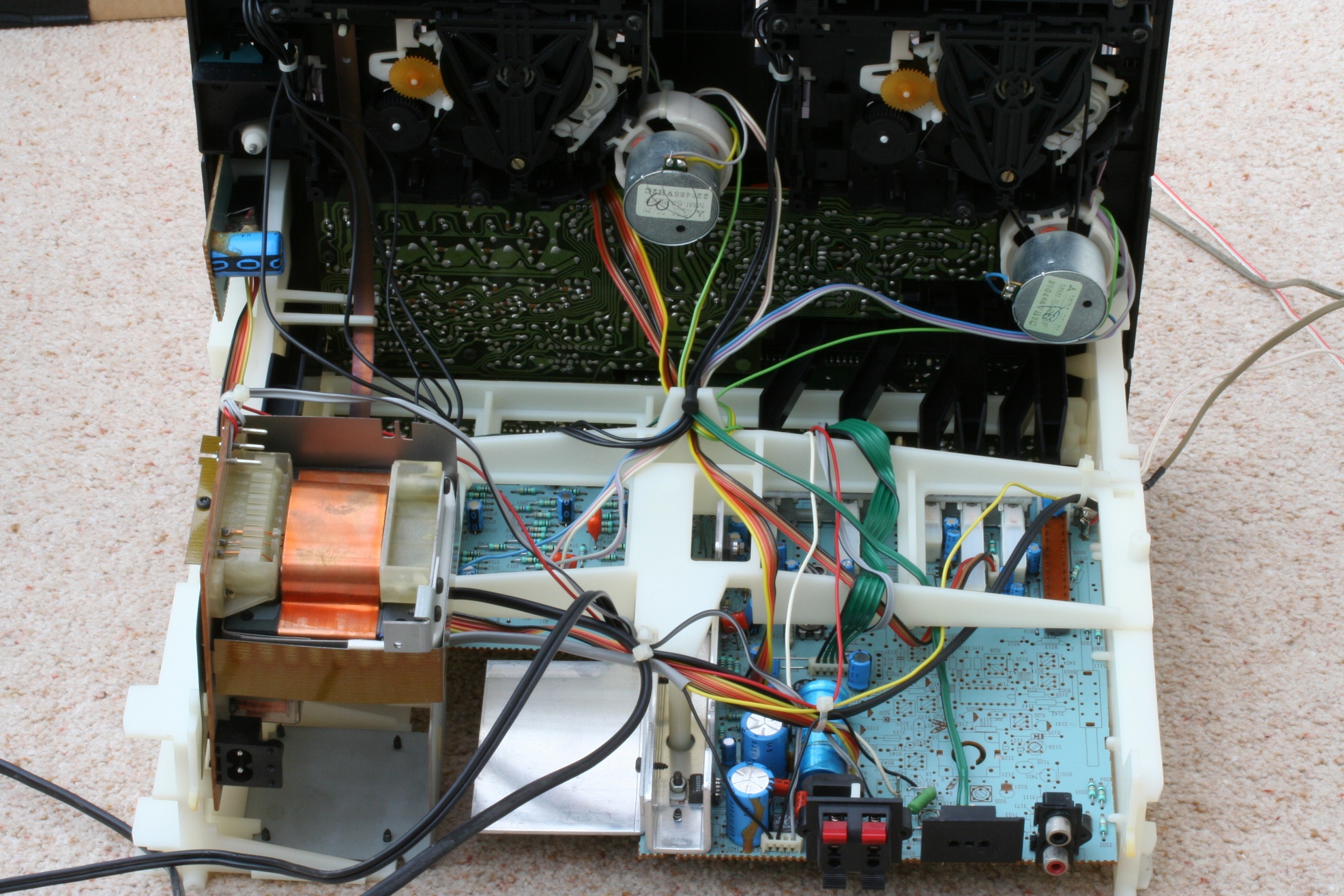

    Philips FCD565 midi system ~1987 - Transformer buzz
    Model: Philips FCD565 midi system (1987 ish)
    Faults: Transformer buzzing occurs with no load after 10 minutes or so. Also tuner display does not light up
    Observations:

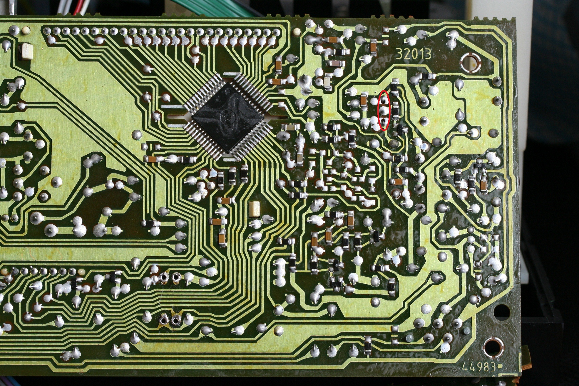

    1. Diode wires 6527 & 6528 are broken these have a 4 8 T designation
    2. One of the bulbs for the crystal display appears burnt out

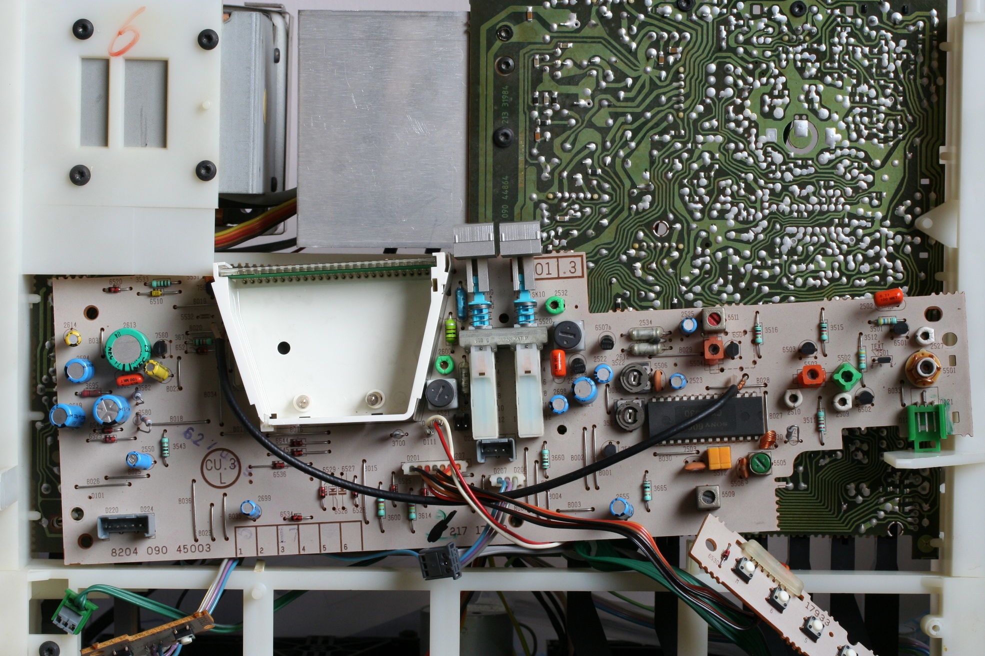

    Testing so far:
    1a. All caps on the top circuit board tested with esr meter - 7 found to be out of tolerance:
    Position on board
    2594 - 25v 100uf (74.10uf & 0.46 esr)
    2698 - 10v 100uf (30.98uf & 1.29 esr)
    2521 - 10v 220uf (141uf & 0.49 esr)
    2522 - 10v 100uf (33.86uf & 1.11 esr)
    2655 - 63v 10uf (6.62uf & 3.0 esr)
    2523 - 63v 2.2uf (open / low cap)
    2525 - 10v 47uf ('leaky' & 11.6 esr)
    2a. - Diodes - these tested fine
    3a. - Resistors - values matched almost perfectly - except 2 which I will ask about in a moment.
    Questions:
    A) Are the orange components film capacitors or resistors? ( some have 0.27k and one has 0.1k on the top)
    B) The resistor at 2534 measures at 100k but the one underneath shows no continuity and shows as open when testing resistance - is this because of the component in between the two of them?
    C) I make the resistor at location 2600 a 100ohm resistor (brown/black/brown/silver) but it is testing at 2ohms - have I interpreted the original value correctly?
    D) Is the original soldering of the transistors acceptable, or should I redo these? (marked in red)
    Any other suggestions or observations greatly welcomed!
    They look like capacitors.
    If you get suspicious readings, remove them and retest out of circuit.
    In circuit readings are not 100% reliable as they could be affected by other components.

      Yes the orange components are film caps, 0.1uF and 0.27uF
      I'm not so sure those 2534 and the one below it (2612?) are resistors. They look more like fuses or inductors to me, or even capacitors more than resistors.

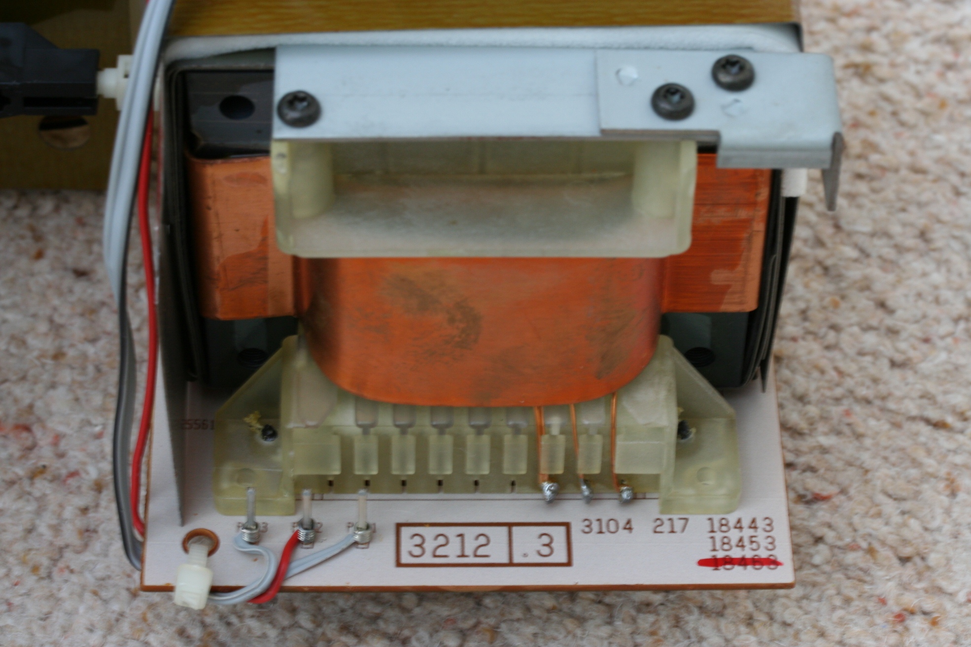

                • Longbow
                  • Jun 2011
                  • 623
                  Re: Philips FCD565 midi system ~1987 - Transformer buzz

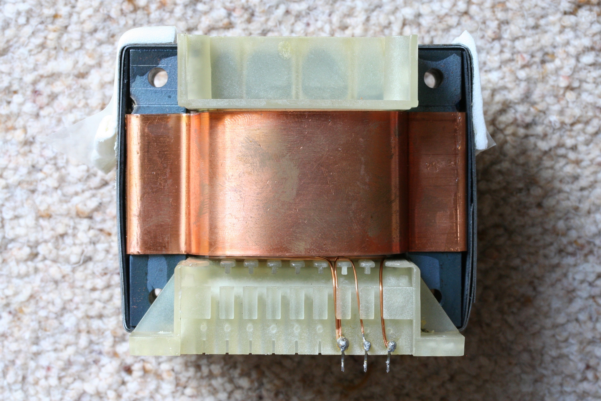

                  Good photos. Are you referring to 60 cycle mechanical buzzing in the transformer? Mechanical buzzing happens because the core plates are physically vibrating in step with the magnetic field. There is little you can do short of finding another transformer. Sometimes mounting the transformer on rubber feet, etc will cut the noise down a bit.
                  Is it plugged in?
                  • selldoor
                    Slow Learner
                    • Dec 2010
                    • 7870
                    If it was that would injecting it with superglue help?

                      IMO, that's not a very common fault but you could desolder the transformer, submerge in hot lacquer, cure and resolder it.

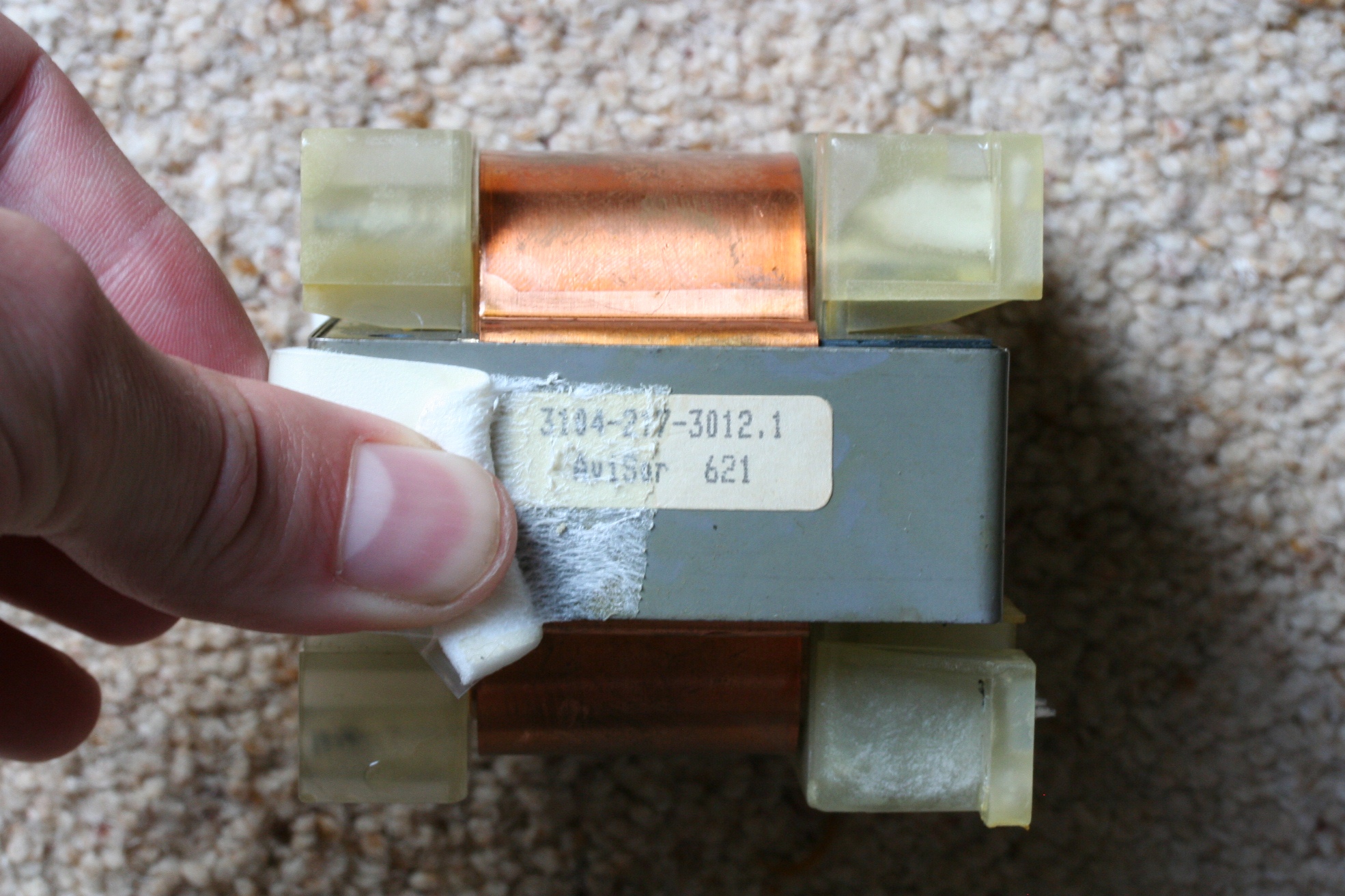

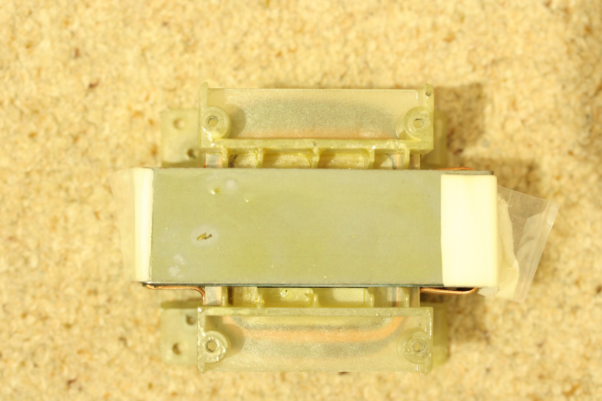

                          It is a mechanical buzzing that starts as soon as I turn on the unit. It gets progressively louder over about 25 mins and then stays at that level.
                          Questions:
                          1. I have desoldered the transformer, now should I remove the outer strip of metal and copper section to reveal the core?
                          2. If I do need to apply lacquer does it have to be of a certain spec?
                          3. If I am looking for replacement transformers what are the key specs to check?

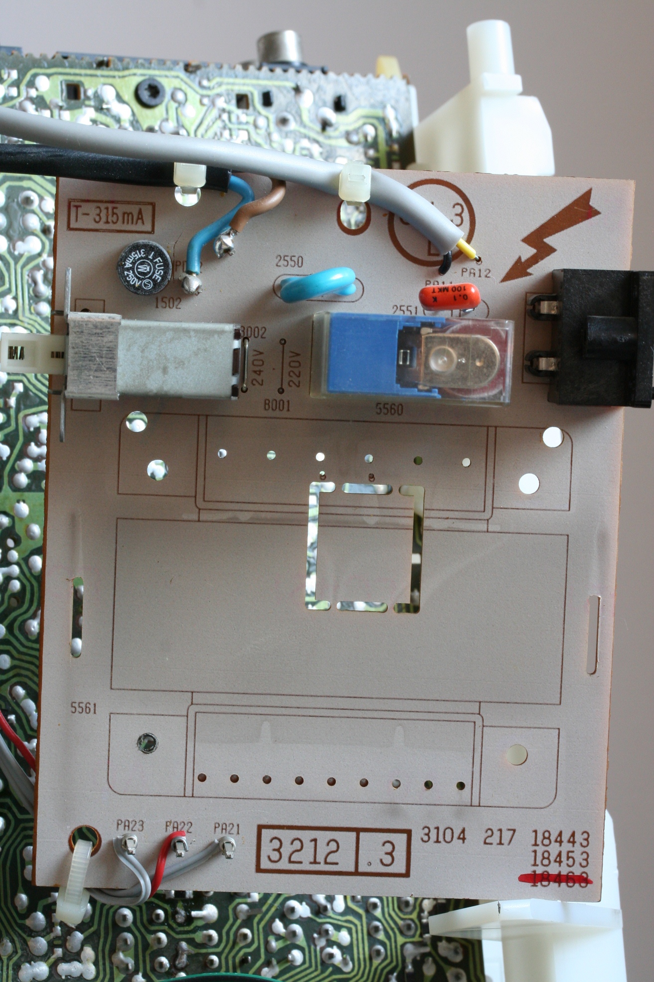

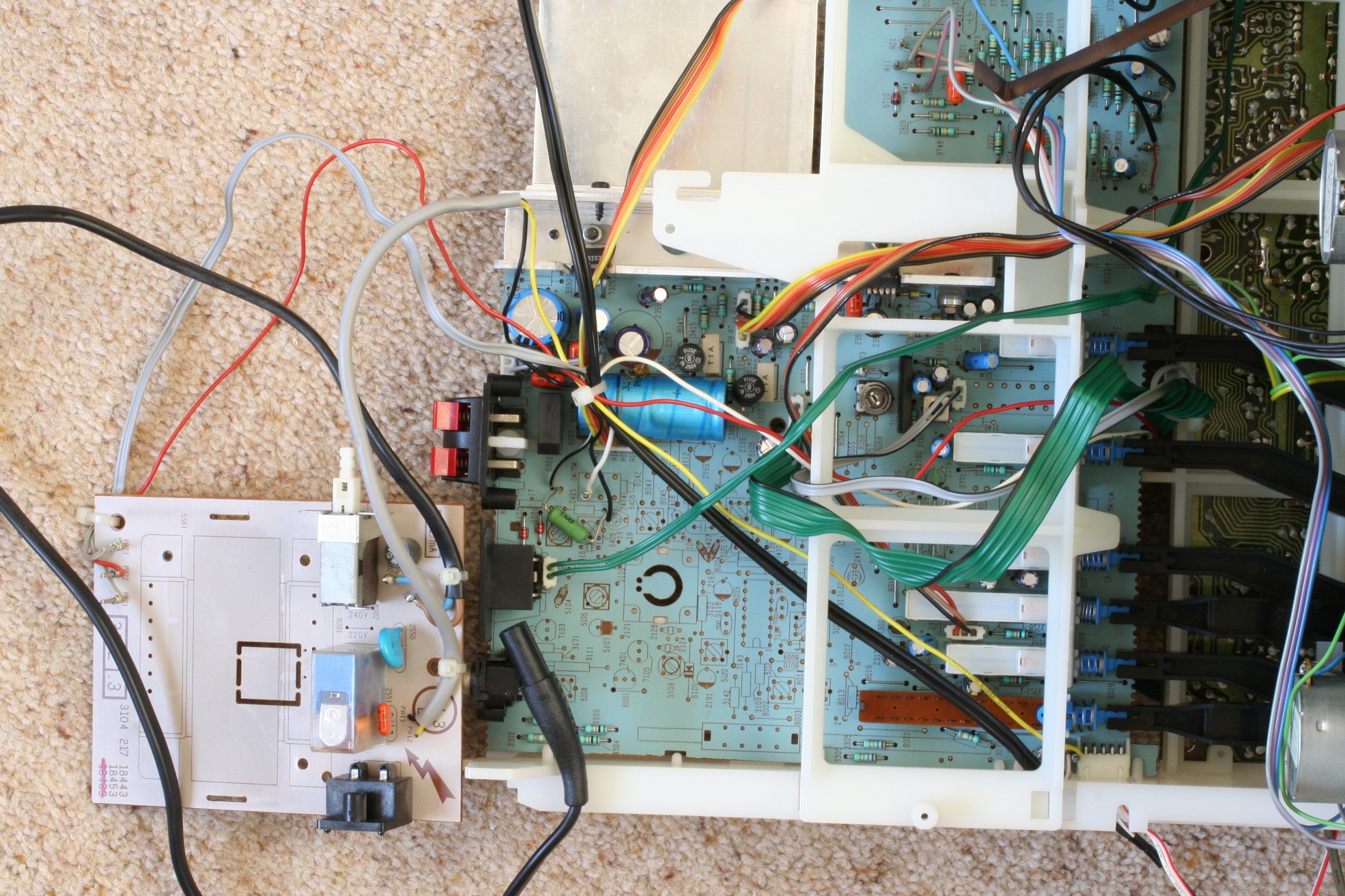

                            Do you get hum if you just have the primary side hook up to power only?
                            • quattro alex
                              • Mar 2012
                              • 92
                              Budm would you mind pointing out which connections I should disconnect to carry out this test?
                              Fixed so far: GNR TS902W monitor, Sony Game Gear, Philips FCD565, Arcam Alpha 10, Memorex SA 404amp

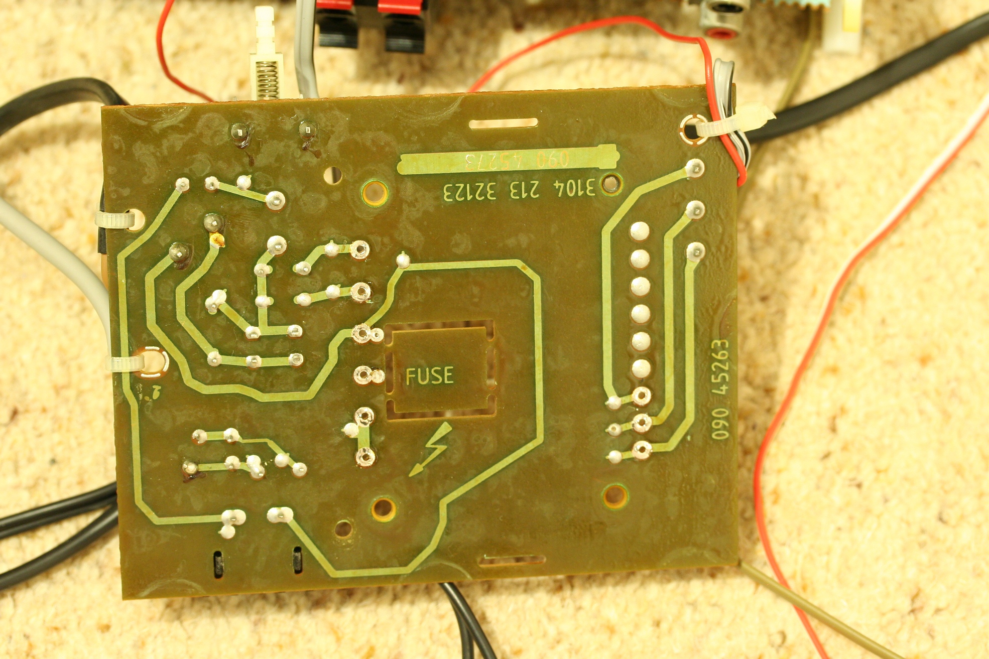

                                I need good picture of the bottom side of the the board as shown on post #13 picture #3, and the other side of the transformer of th pic #1 in post 13 (the picture #1 seems to be showing the secondary winding of the transformer).
                                  Questions:
                                  If there is a sufficient gap somewhere so you can use a spray varnish with sprayer nozzle that has a straw, you may not need to remove anything. Otherwise, you may... dipping the entire thing upside down is the typical approach but that may or may not be enough.
                                  Electrical lacquer or varnish can be found at electronics supply house, here are a few from a UK supplier as an example:
                                  http://uk.farnell.com/jsp/search/bro...atchallpartial
                                  Since this transformer has a plastic frame on it, you should probably avoid any varnishes that need to be baked rather than air dried.
                                  The hardest part in finding a replacement would be that it's the same form factor given it is mounted on the PCB. Otherwise you could remotely mount the transformer and connect it with wire to the PCB. Key specs are the same voltage and the same or higher current rating, or at least close (depends on how loud you want this to be capable of).
                                  Measure the voltage to determine if you are dealing with +/- rails of the same value and ground (for example +18V/0V/-18V) or dealing with a single higher voltage rail like +18V and a second lower voltage rail that powers various lower voltage components on the board(s) rather than the audio output stage. Based on its physical size I doubt it is rated for more than a couple amps current on the highest voltage rail(s), if even that.

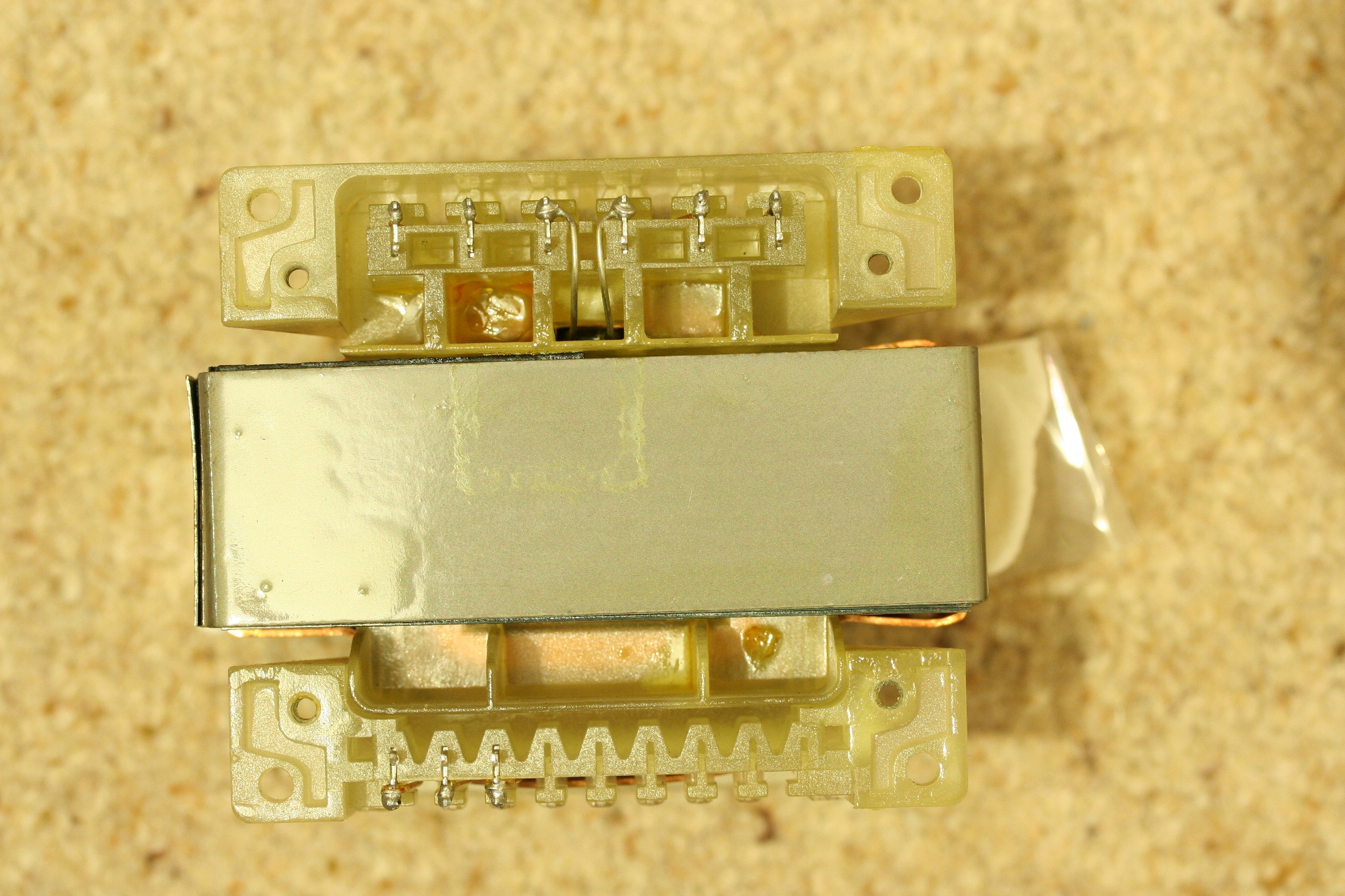

                                  To hook up the primary side alone to see if it buzzes then, it appears all you need to do is connect an AC electrical cord to the primary winding pins, the two on the side of the transformer closer to the AC outlet. By that I mean a leftover/salvaged power cord from something that you cut the product end of the plug off of and striped back insulation and modestly soldered to the transformer pins, if you don't have a more secure way of using aligator clip ended jumper wires or similar. Either way be careful working with HV AC, and confirm which pins are the AC primaries by looking at the back of the PCB to confirm those solder pads trace to the AC power socket.
                                    Hopefully these are ok, unfortunately too late for daylight shots so I've bumped the ISO up a bit.
                                      This transformer has mutiple windings on the primary side, There is a black recetacle and then there is also a balck cord (with Blue and Brown wires) iwth female IEC at the end of it. Can you tell me where that black power cord goes to and the black receptacle is for?
                                      • quattro alex
                                        • Mar 2012
                                        • 92
                                        There is a black recetacle and then there is also a balck cord (with Blue and Brown wires) with female IEC at the end of it. Can you tell me where that black power cord goes to and the black receptacle is for?
                                        The black recepticle is the mains AC input for the unit. The black cord I think is for the CD player section or turntable which my colleague hasn't given me.
