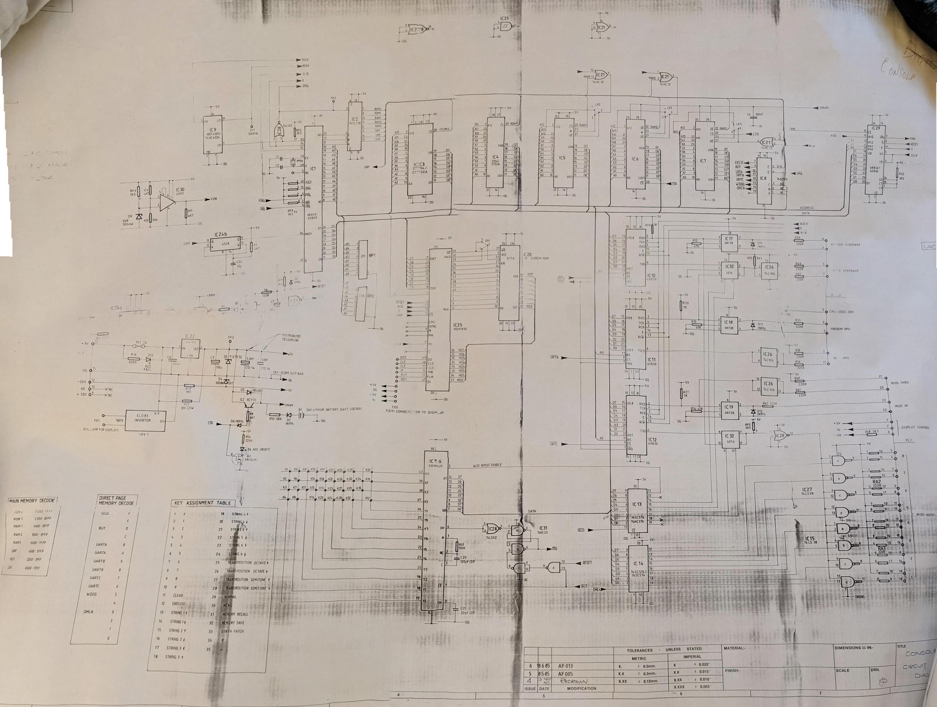

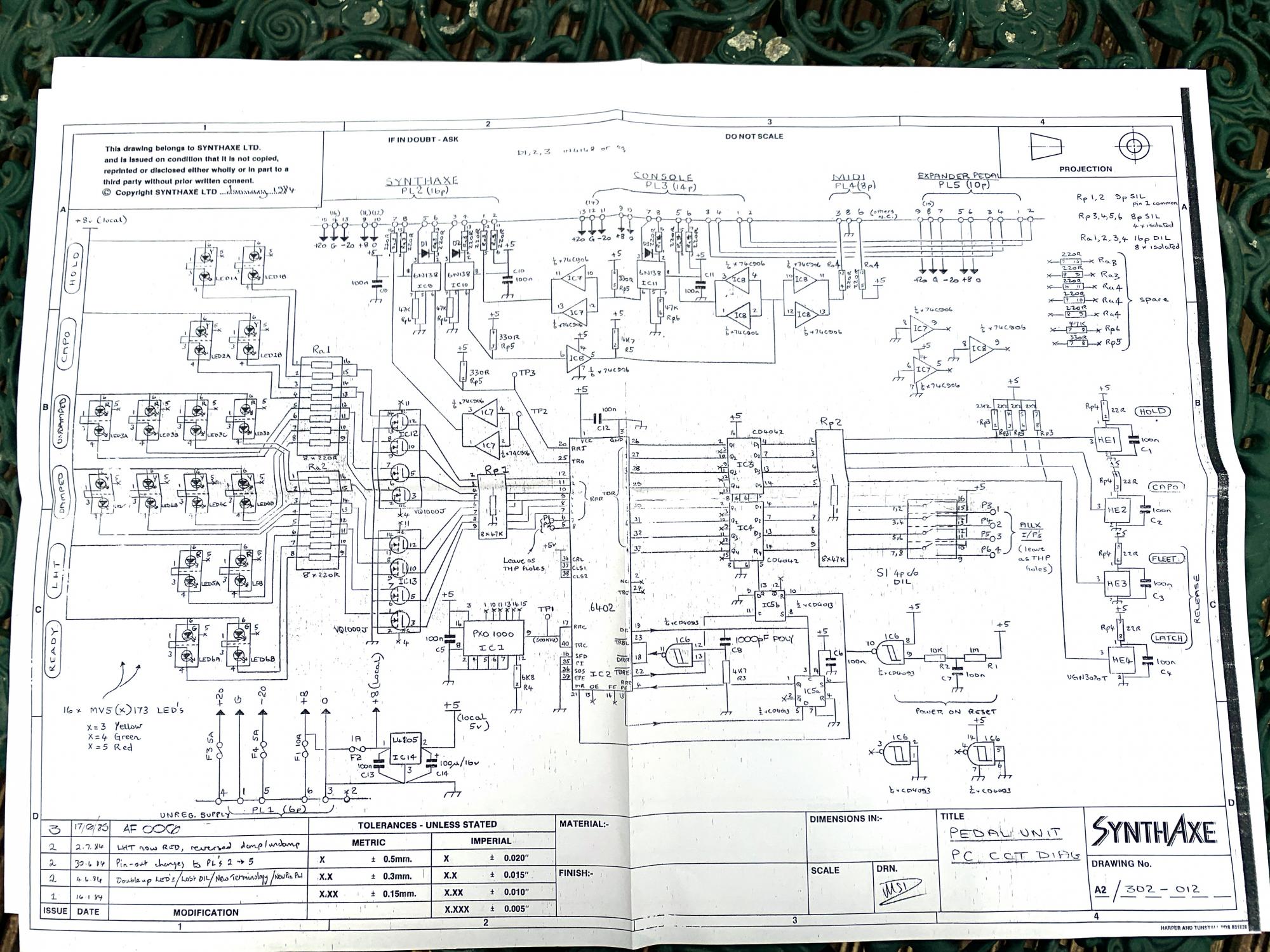

    Hey all, I have one last thing I'm looking to fix with my Synthaxe. This time, the schematics I have are actually the same as the PCBs I have.
    The Synthaxe, works as its a guitar midi controller hooked up to a floor pedal. Thats the most basic way of using it, and it has a midi output. You also can connect a console to it, that stores your tunings and other things. The console has 8 midi outs, as well as a midi in and midi thru.
    When I first got the unit, I thought I was using it wrong, but it turns out its just broken. The 8 midi ports on the console don't output any data, but the midi port on the footpedal DOES. The console also works fully as Ive tested everything on it. If I remember correctly, when I tested the broken ports to
    a real keyboard, I could remotely change patch banks on the keyboard from the console, but it wouldn't produce any midi data.
    So here are the schematics, one is for the console, the other is for the floor unit, but you can see where the working midi output is located. Ive also connected the continuity to everything as well as the resistance.
    I believe the fault is between IC12 (63B50) and the midi outputs. I believe IC14 (74HC574) only turns what output you want on (you can sent the console to have any combination of outputs on). IC12 also has all the data coming into it properly and most of the connections are bussed to IC10 and 11, which work. I replaced IC8 because it looked like the UARTC line wasn't working, but that didn't fix the issue.
    My problem is, I'm not sure how to test if the Tx line of IC12 (Pin 6) is outputting data? Because if it is, the issue could be IC32/IC28 or maybe IC13. To a smaller degree, MAYBE IC27/IC15 but it would be very suspicious if they both were bad.
    Again, midi DOES work, as it can output to the footswitch, it just doesn't output from the 8 ports.
    Thanks again for all the help!

    ic14 selects which ports will be driven,
    data comes from ic12, goes through a switch (ic32) and is then buffered by ic28.
    the switch is controlled by ic13 and appears to be to create a loopback between ic12 and ic10 - maybe for a diagnostic check.
    what test gear do you have?
