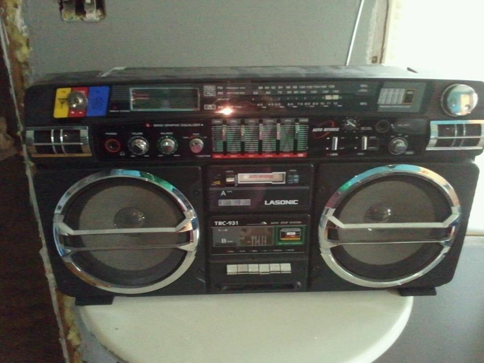

    Well here we go. A blast from the past hehe. A good friend of mine paid a ton of money on ebay for this dang thing. It was taken to another repairman becuse of some issues and when he got it back, not only did it still have issues, now it has a bad fugly toggle switch on it lol..
    so i get it, heres the issues:
    - left channel quieter than the right.
    - left channel pops and cuts out, comes back
    - left channel sometimes cuts out, comes back popping like a machine gun
    - tape a does not work, bad belt.
    - power switch hacked in
    - broken antenna.
    I go ahwad and tear it apart. THeres cold solder all over this thing, worst at the audio amp ics. I then notice the heat sink on the left channel amp is is loose. So i tightened it. Now the heatsink gets BLAZING HOT almost immeadiately. I get to looking some more, the left external speaker jack is broken and has a intermittent short..
    SO i think what happened is the ic was alteady struggling with basically no heat sink and cold solder, add the shorting speaker jack, its a wonder this thing works at all.
    The ic is a toshiba ta7270p. I plan on just replacing both ics to make sure theyre fresh. I will reflow any other questionable solder, and remove that shorted out external speaker jack.
    Ive found the ics and replacement whip antenna on ebay so im set there, which leaves this power switch. He hates it, and i dont blame him.
    Does anybody know or anyone with lasonic boombox parts?
    Anybody know where i can buy replacement tape deck drive belts here in the states?
    Heres a pic of the beast.

      already making great progress..
      i figured id go ahead and reflow all the solder joints that were bad.(there were ALOT around the audio section and also a couple almost no solder at all joints on the control board.
      I was happy to now feel the left side audio ic cool to the touch, but my left speaker still crackled.. Not so sure its an ic issue now, i poked around some more. Theres 3 terminals going to the external speaker jacks. Ones ground, ones audio in, ones audio back out of the jack. With speakers connected, the contacts inside open up, shutting off the internal speakers to power the external ones. Without external speakers hooked up, theres a contact thats supposed to connect the audio in to the audio out( so the speakers in the boombox work) There was a really poor connetion there due to rust/dirt/pop. I cleaned it out very well, SPEAKERS NOW WORK PERFECT.
      Previously the adjustments all kind of crackled too, thats gone. Id assume some bad solder was the true reason for it.
      so i guess that leaves me to find an antenna, possibly some belts for the tape a player if he wants that fixed, and figure out what to do with this horrible power switch.

            heres where were at so far..
            I still want to get a little pbr can charm, drill out the center, install onto the toggle switch to make it a little more his style but its getting there. The audio is great now, so progress at least. Waiting to hear back to wether he wants to fix the other tape deck antenna and a couple other odds and ends.
